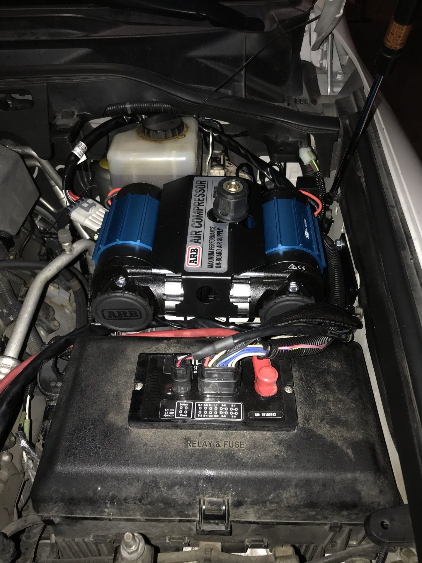

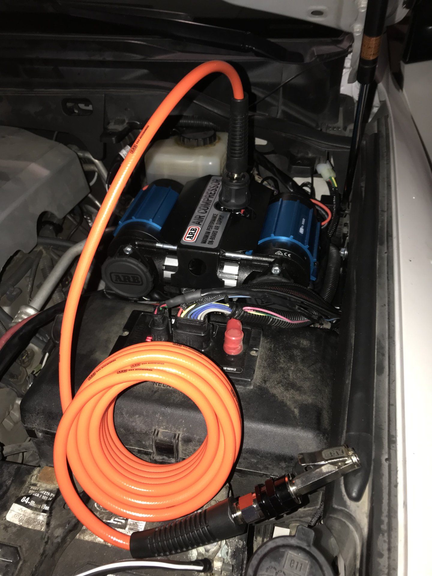

Compressor/Slee bracket is in
That’s the SwitchPro bracket with all switches pre-wired for accessories. Only four are occupied: left rack light, right rack light, dust light, and compressor. Switches 1,2,3, and 7 respectively.
Ahhh... Thanks!

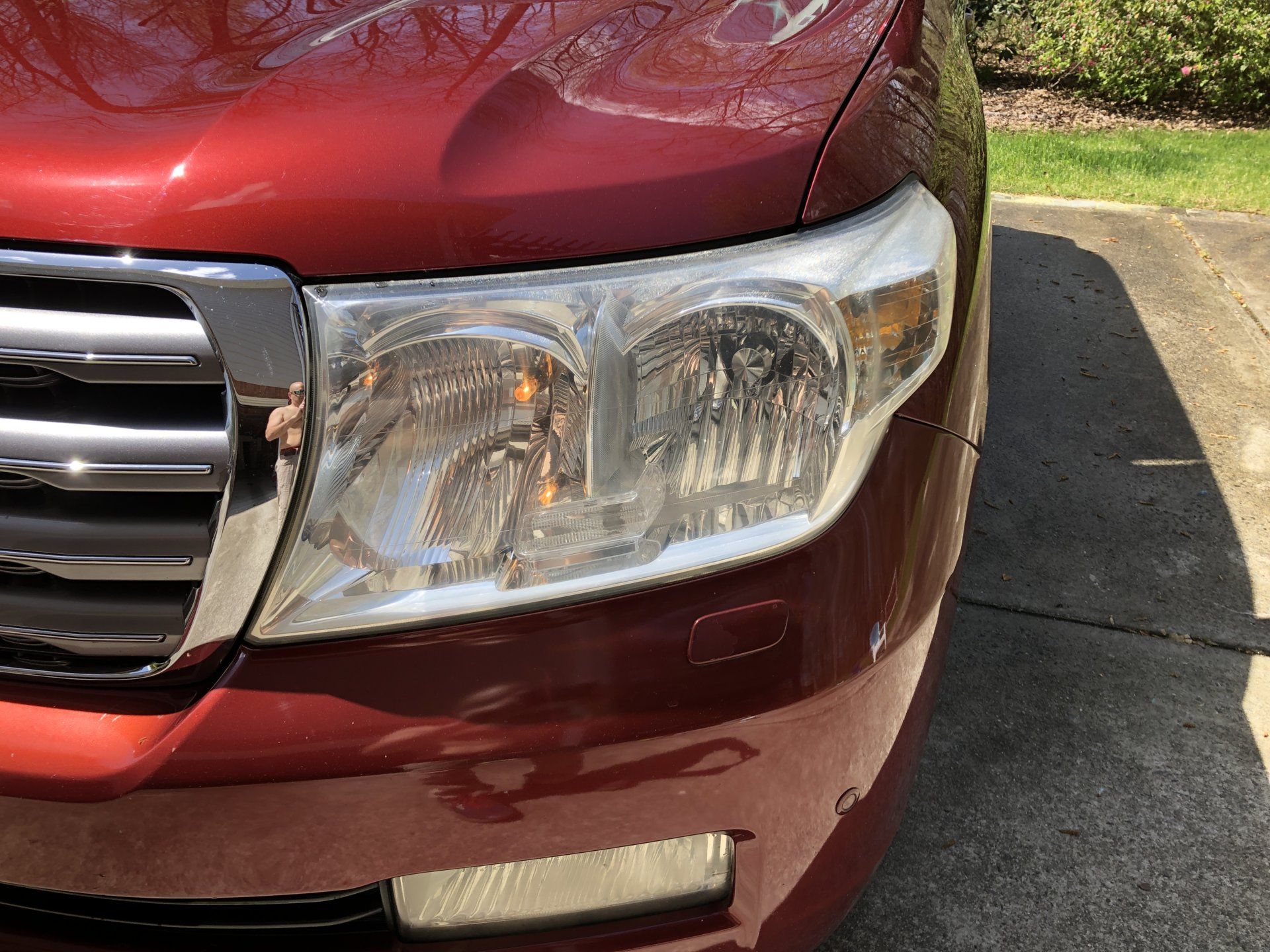

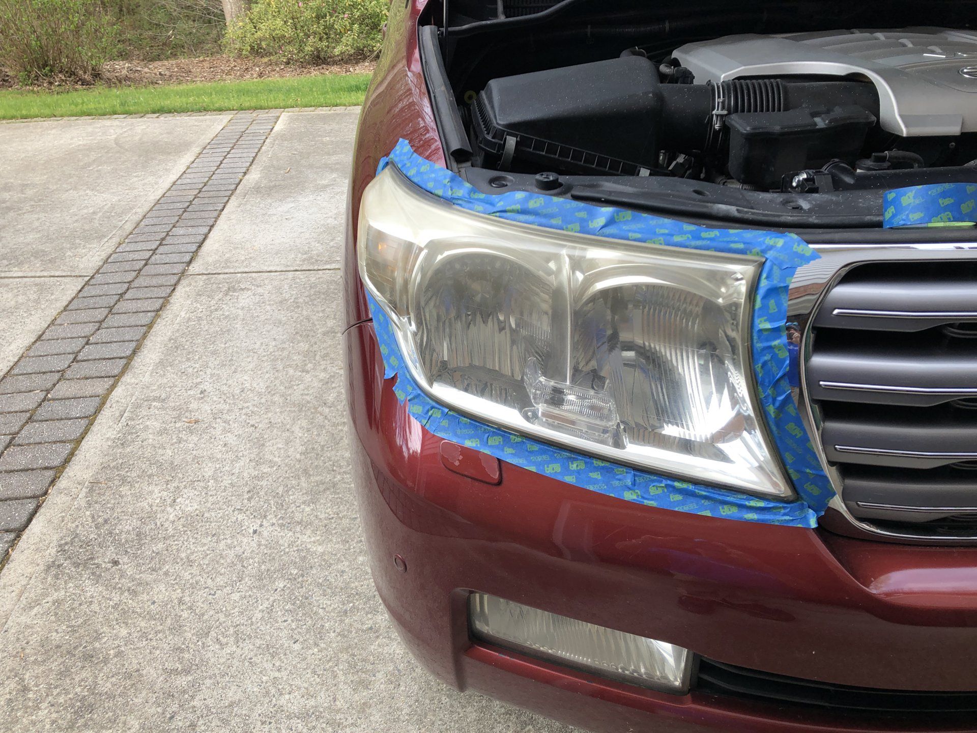

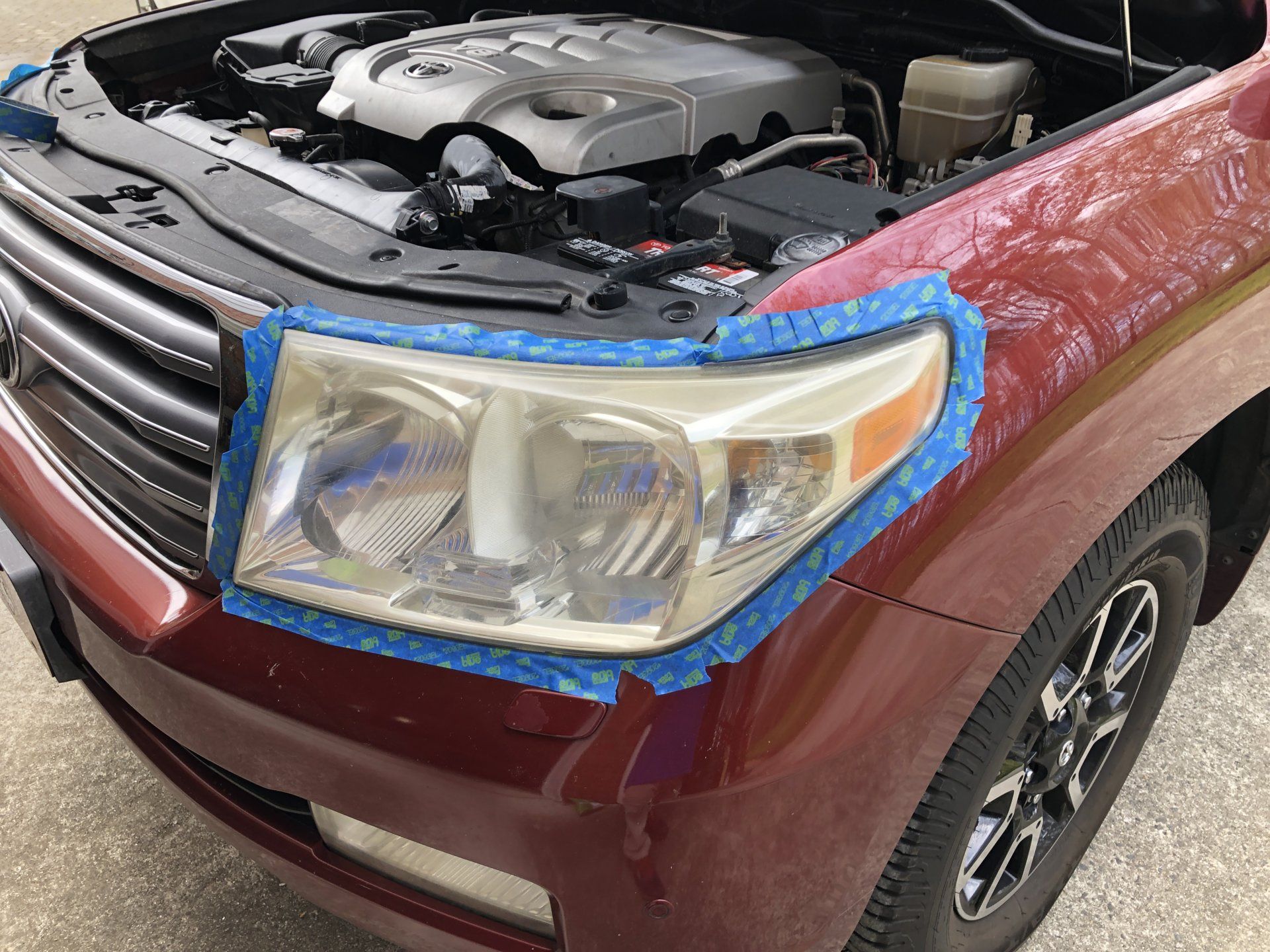

What did you use? Need to restore 1 of mine.
I used the Sylvania kit from amazon. The only thing I did different was used a Meguires power ball on the drill for the last step with rubbing compound. Mainly because my arms were toast at that point! But it did provide some added cutting action as well.
Finished with a coat of 303 Protectant. Will reapply at least monthly, if not after every wash

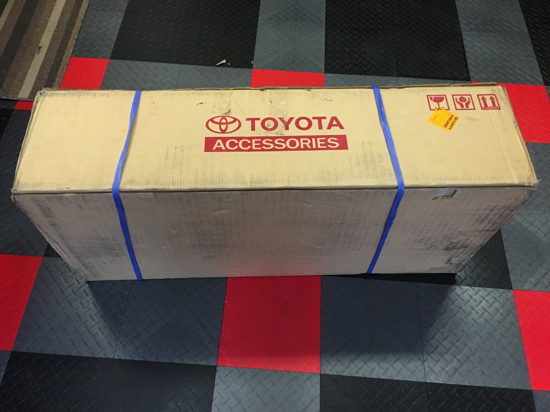

Hey Luke..that nudge bar looks really nice. where did you get and what brand is it..Toyota? thx
