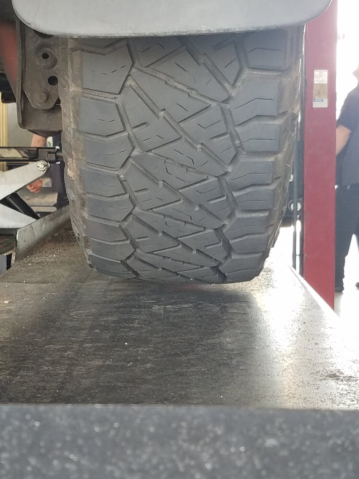

Hey is this normal?!
1944635
Oh, you mean it's not?!
Guess that explains the roar I've had from my RGs. Anybody want a spare 285/75/17? Cus I'll have 4 in a month or so.
What do you mean by “4 in a month or so”?
I'll be replacing the tires at some point before LCDC, mainly waiting for a good sale. These 4 are trashed for daily driving due to the noise they make, but would make good spares. In case you can't tell, they're about 6/32nds on the inside and 12/32nds on the outside. When I just balanced them, the fronts were out 3.5oz.
Yes. I saw.
But...Looks like you have an alignment problem. If so, no tires will wear evenly until that’s fixed.
About balance... On Ridge Grspplers, balance guys screwed the up royally. Like 6 oz off! I had to immediately go to another shop to get it done right. Believe it or not...it was a Wal-Mart tire shop on a road trip that identified just how badly my prior ship screwed it up just two days earlier. Seemed ok til they changed to their “dynamic” balance setting on their machine...and it was then drastically better.
All that to say...some balance guys have no idea what they are doing. Case in point...my first installer who was off by 6 oz!
Looks like you have an alignment problem though.
About balance... On mine, balance guys screwed the balance up royally. I had to immediately go to another shop to get it done right. Needed a dynamic balance...not run-o-the mill. Believe it or not...it was a Wal-Mart tire shop on a road trip that identified just how badly my prior ship screwed it up just two days earlier.
The alignment is being checked and set by @Taco2Cruiser before I put new tires on, as yea, not playing this game again. Just waiting for my BudBuilt parts to be finished up and then I'll be dropping my truck off.
To give you an idea, the tires have nearly 12k on them (I think) and have never been rotated AFAIK. Also the cold tire PSI when I picked the truck up 2k ago was set in the high 40s, so about 10 psi higher than needed. We'll get it sorted, no worries.
