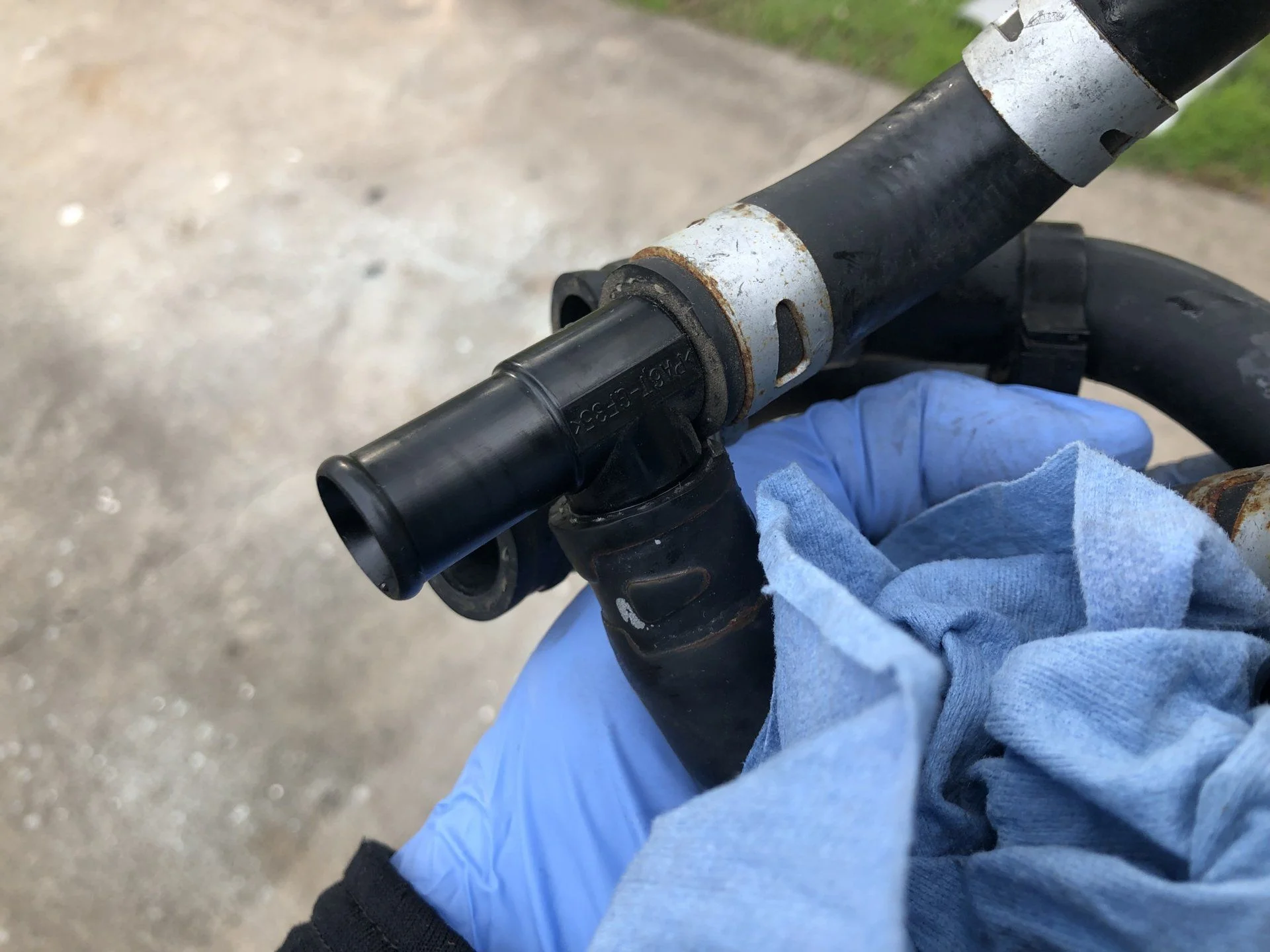

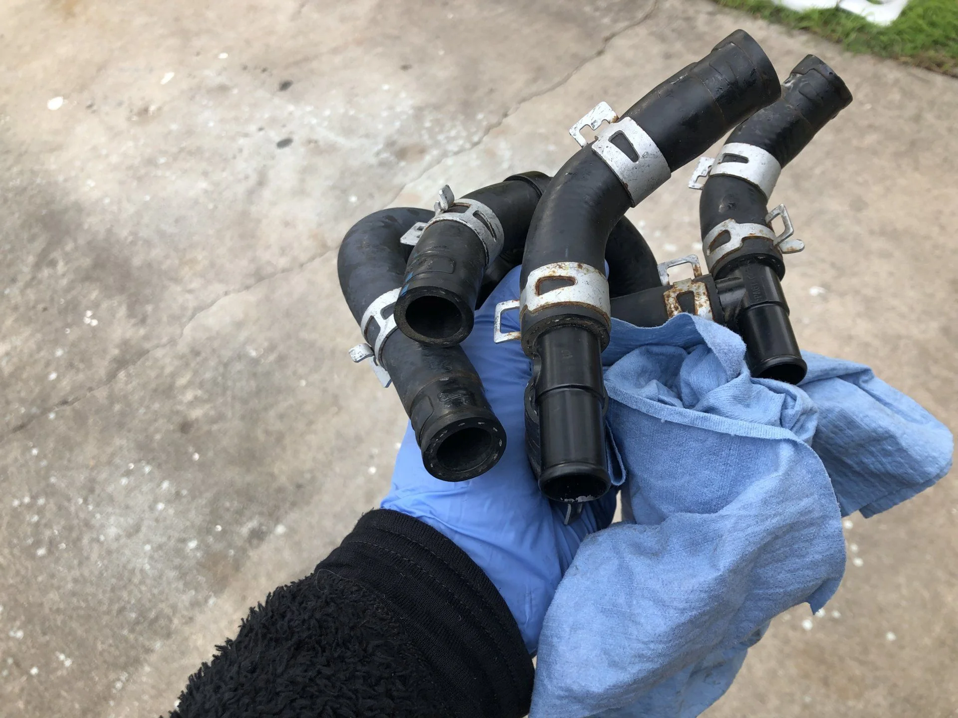

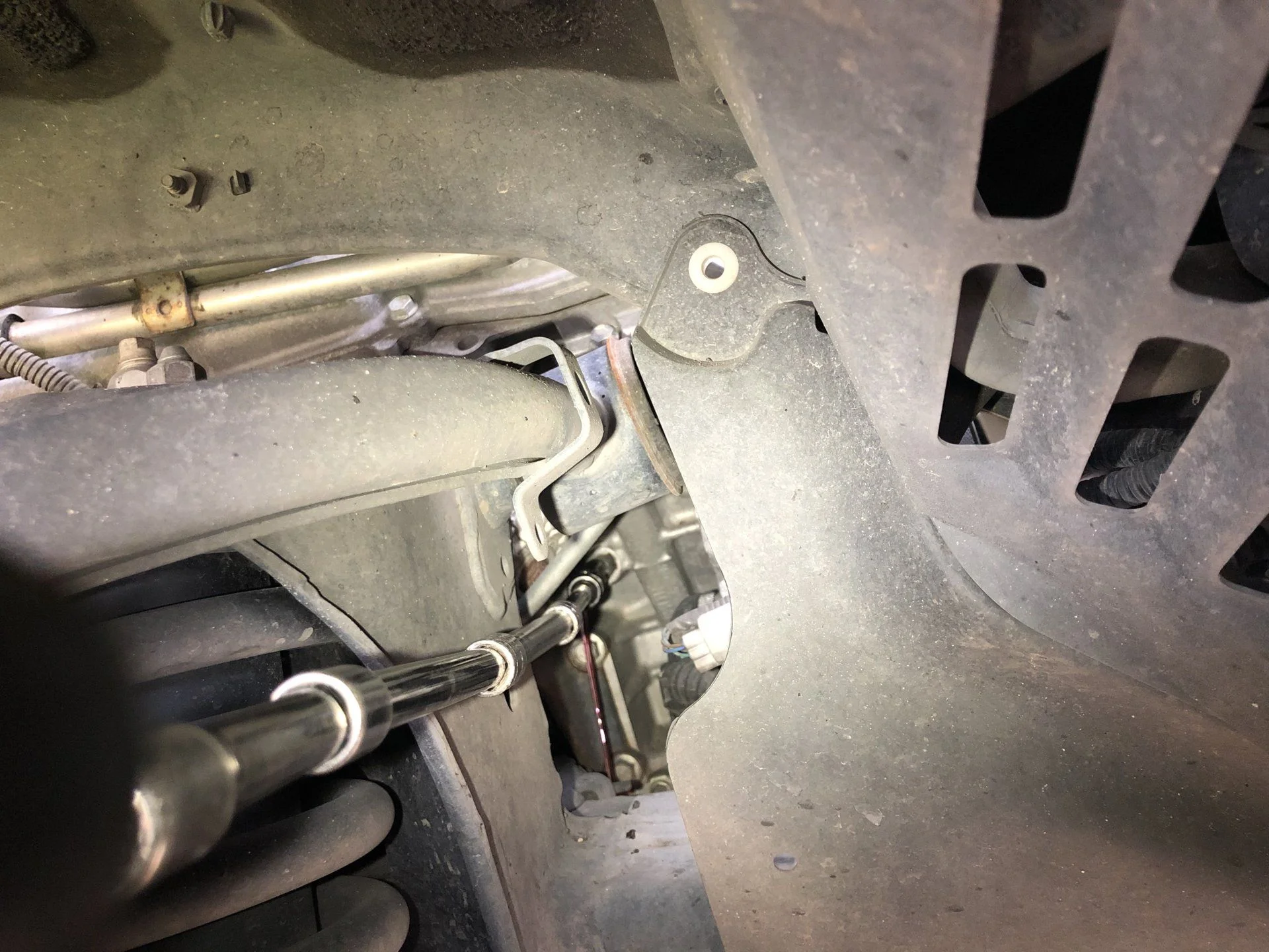

Nearing 130k miles on my 2013 cruiser a couple days ago I changed the coolant with factory stuff and intended to change the plastic heater hose T’s but didn’t need to once I got it all apart.
Pretty straightforward.. just drain the radiator and engine block via the drain on the passenger side. It is 10mm and needs a lot of extensions.
Reading about coolant swaps in tundras apparently there is another block drain on the drivers side but a couple posts indicated if you drain the pass side first very little comes out the driver side.. and with the DS location not being obvious or easy to get to I left that side alone.
Many people know of the heater T’s in 100s failing and it seems like I had seen a couple posts of ours being far better but still prone to degradation. I ordered the parts but once I got mine apart they were literally perfect with 130k miles. Seeming to be better quality than the replacements (the originals had less visible “fibers” within the molded plastic and were molded slightly different) I just put it all back together.
I used low pressure compressed air not sealed onto the lines to push old coolant out of the long heater lines to the rear AC unit. Some old stuff definitely remained but I’m betting 85+% of the coolant now in it is new.
I didn’t do any testing but the old stuff looked really good, if a little more cloudy than the new. All the lines I saw the interior of were free of corrosion or any problems. Hopefully this change keeps it that way
Used a bit over 3.5 gallons.
Edit: I posted the above before I had a chance to drive it. Guess some air was trapped in the rear heat lines, as I couldn't get the rear to blow warm or hot. Some spirited driving must have provided enough water pump flow to get things pushed through.. it's working after a little driving around controlling the gears for some RPMs.

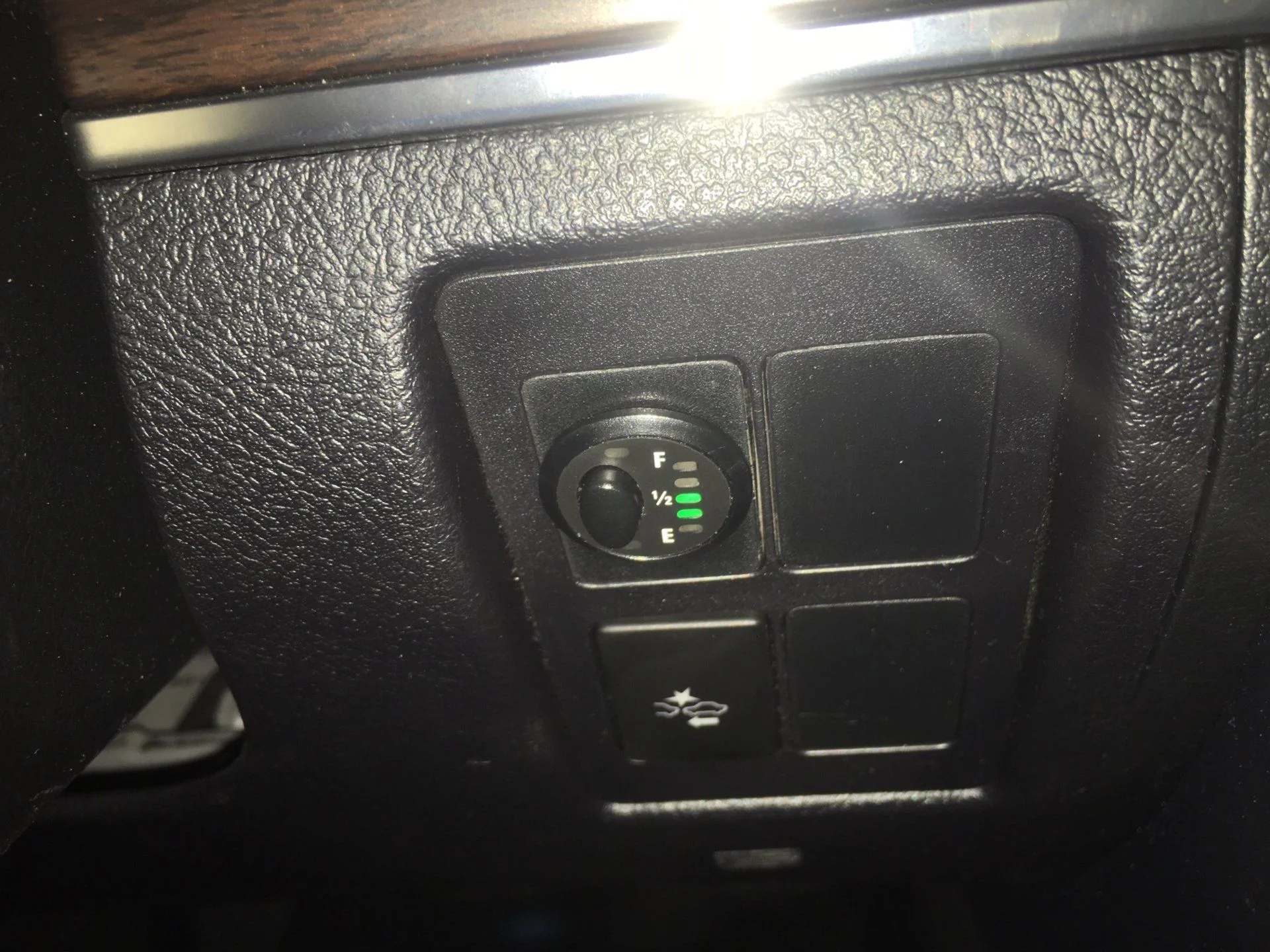

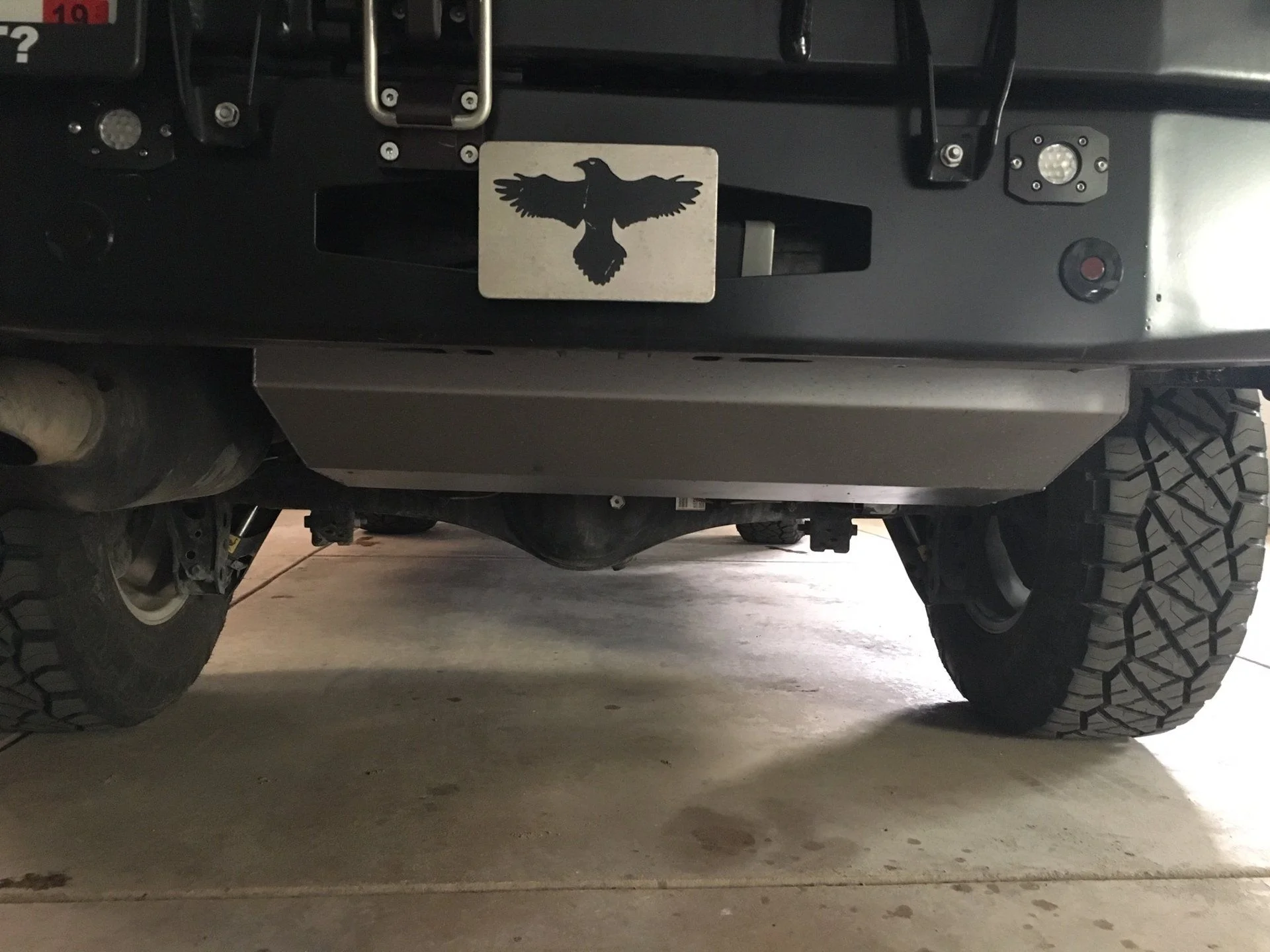

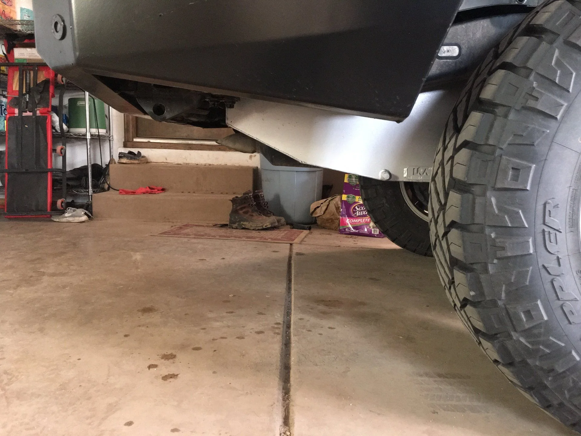

40 gallon sub tank! I also had diff breathers done too!
Wow. Looking forward to a tank photo...shot from behind at the level of the lower bumper...to see how much is visible below that level. That looks SUPER tucked for a 40...which will have me thinking I could have happily bumped up another 16 gallons from my 24. :)
40 gallons gets responses of being too heavy, etc, but it’s not like you have to keep it full. :)
@Markuson , here you go.
Profile shots from rear and side:
1897265
1897265
1897266

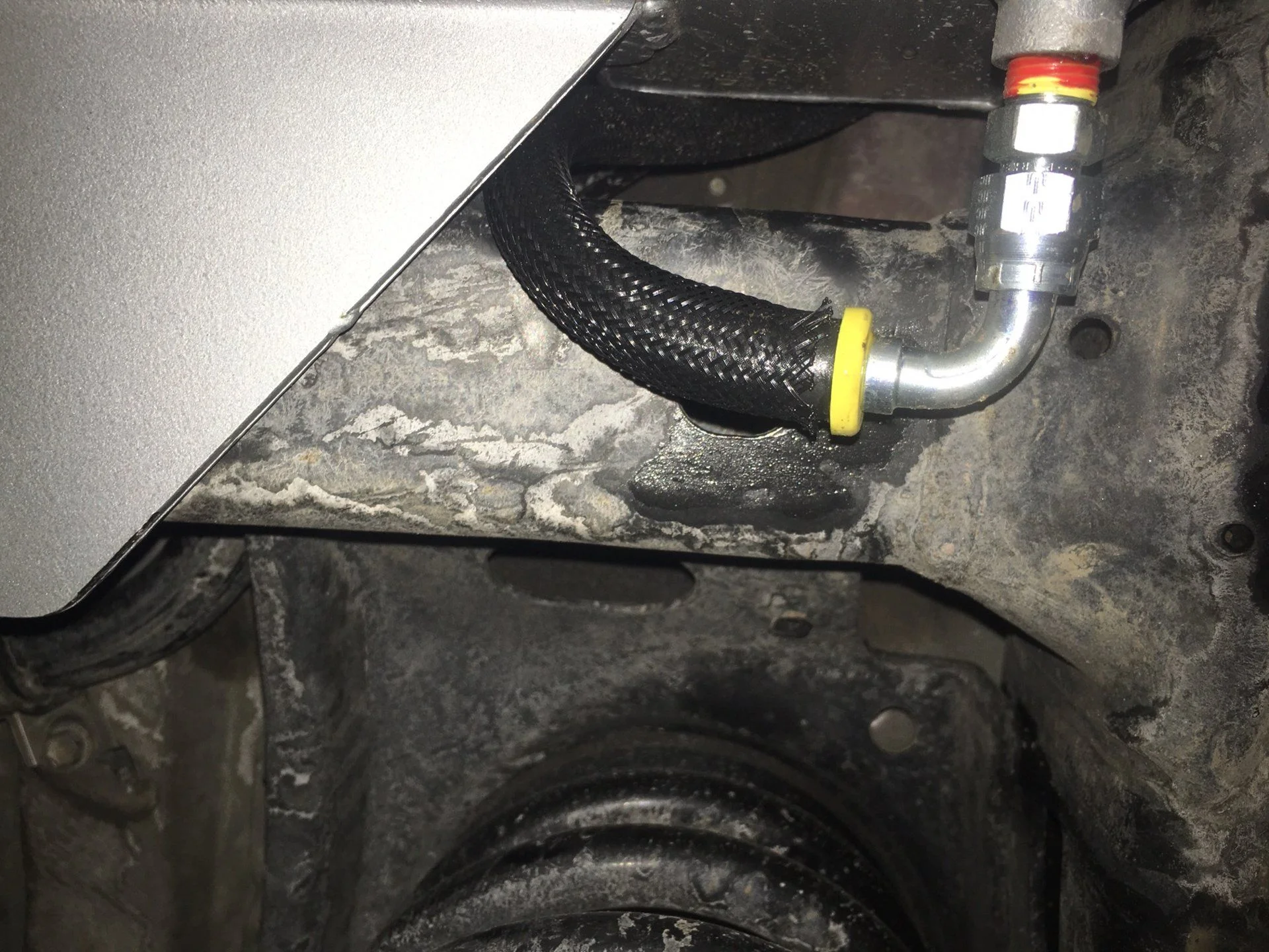

Slee significantly upgraded the hoses and fitting for the tank. I think this is a huge improvement over worm driven hose clamps:

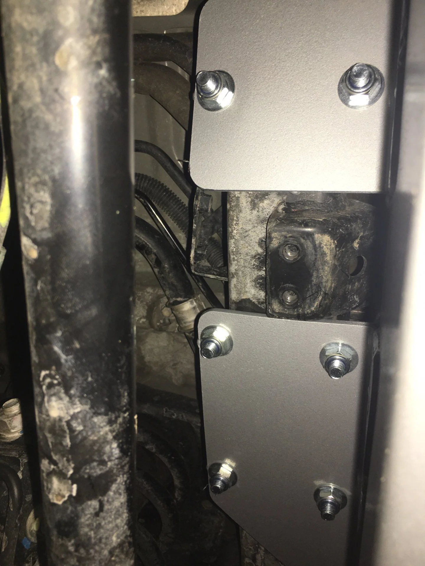

They used rivet nuts and bolts to hole the tank in place:

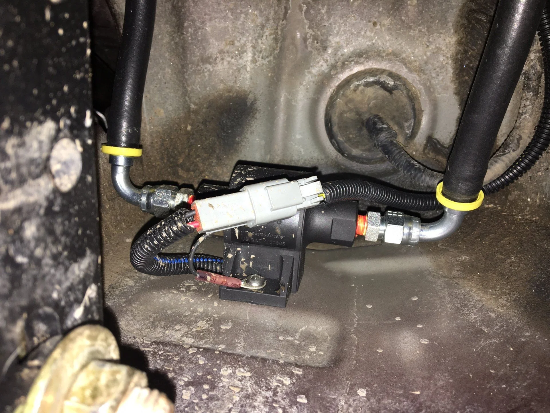

@Mendocino , what does your transfer pump sound like?
What I THINK he means is...does it sound like a woodpecker...or sound like a pump. :)
^Hahaha. Perfect.
Meh, its fine.
Ya, that was my pump he’s referring to.
The regular pump is fine.
-My motivation to fiddle with a faster pump is just because I hope to eventually modify & create a “fueling station” ability to redirect fuel from my tank to an external fuel need like a motorcycle, buddy’s tank in a pinch, generator, etc. That way I could skip a jerry can even if toting some other engine to feed. Speed would be great for that since I’ll be standing there waiting. Otherwise...totally fine as is.
