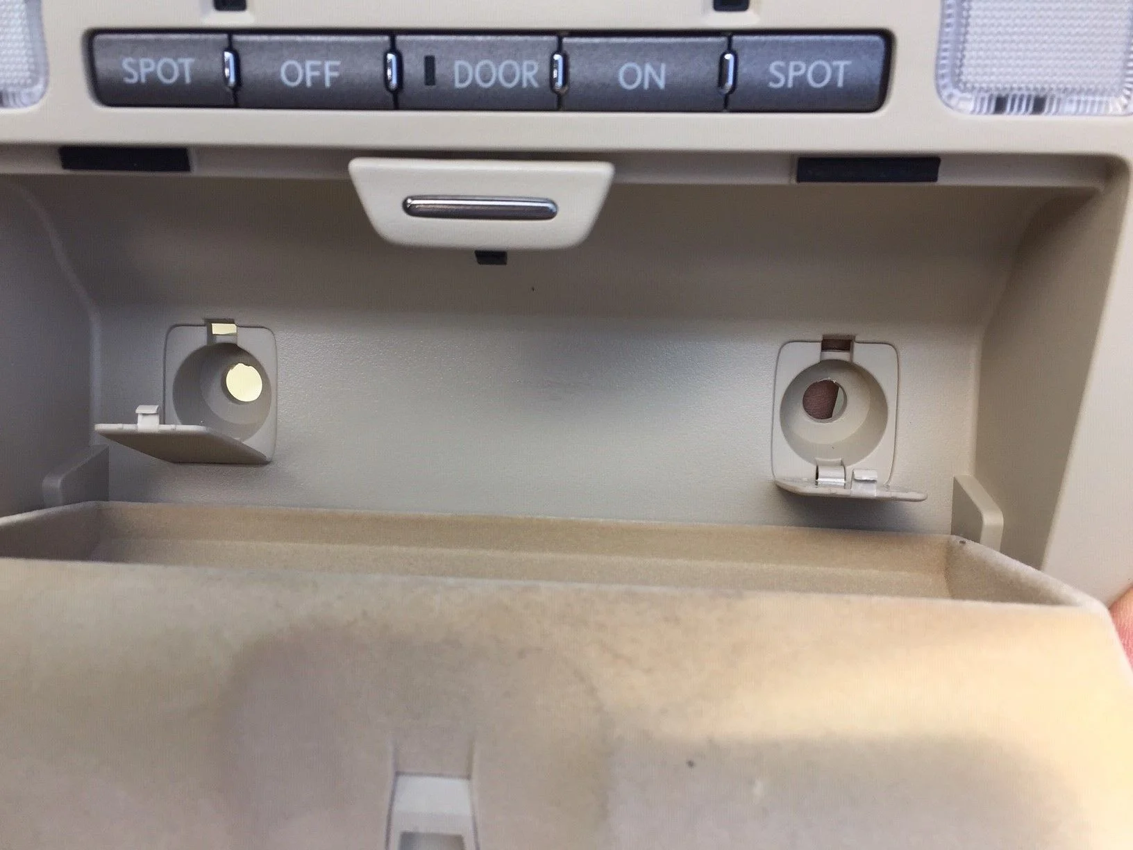

It turns out the front drivers seat is incredibly easy to remove. Just for bolts, disconnect three plugs, and then just tip it back and out-of-the-way.
And from now on if you ever have to get to that pesky screw you can just lift the lid!! Good stuff. That's a lot of expense and execution by Toyota for something I may never use!

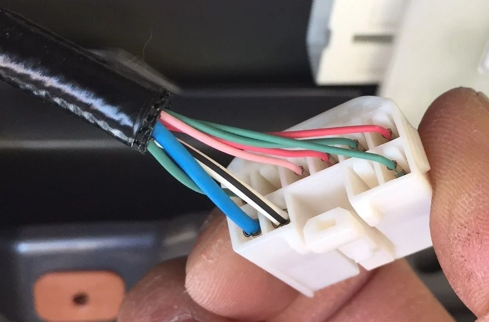

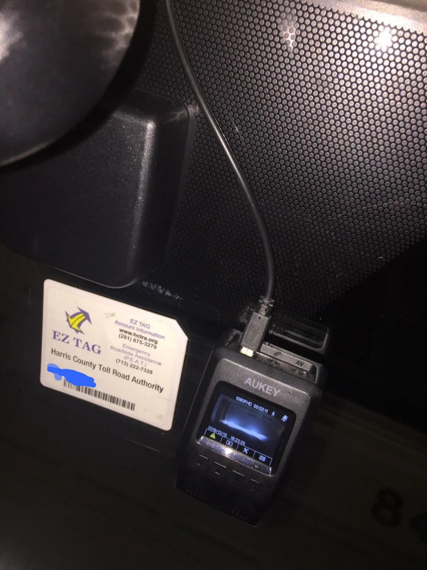

I've wired the dashcam directly from the moonroof motor power. The power are the 2 larger wire which expose once the sunglasses holder is removed.
