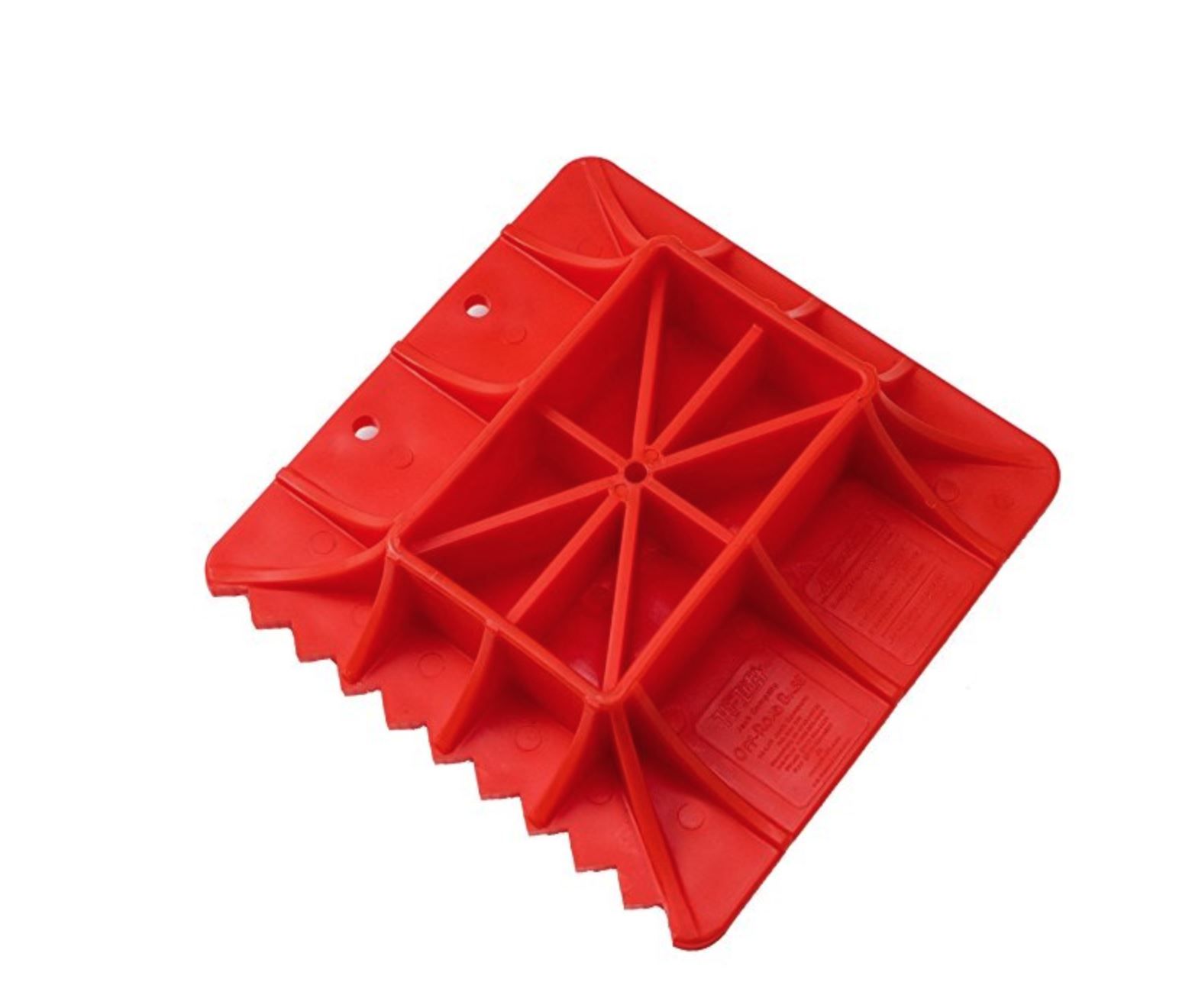

one more thing. When I was replacing the first flat I was using the bottle jack and it wasn't tall enough. Fortunately @Markuson had a Hi-Lift Jack Base and that made the difference. First thing I ordered and added to my kit when I got home. It is much safer changing a tire with a bottle jack when you can, plus it will help the Hi lift be more stable from a ground perspective. $38 on Amazon
I have one of those that I got years back for driving on the beach. Haven't used it yet.

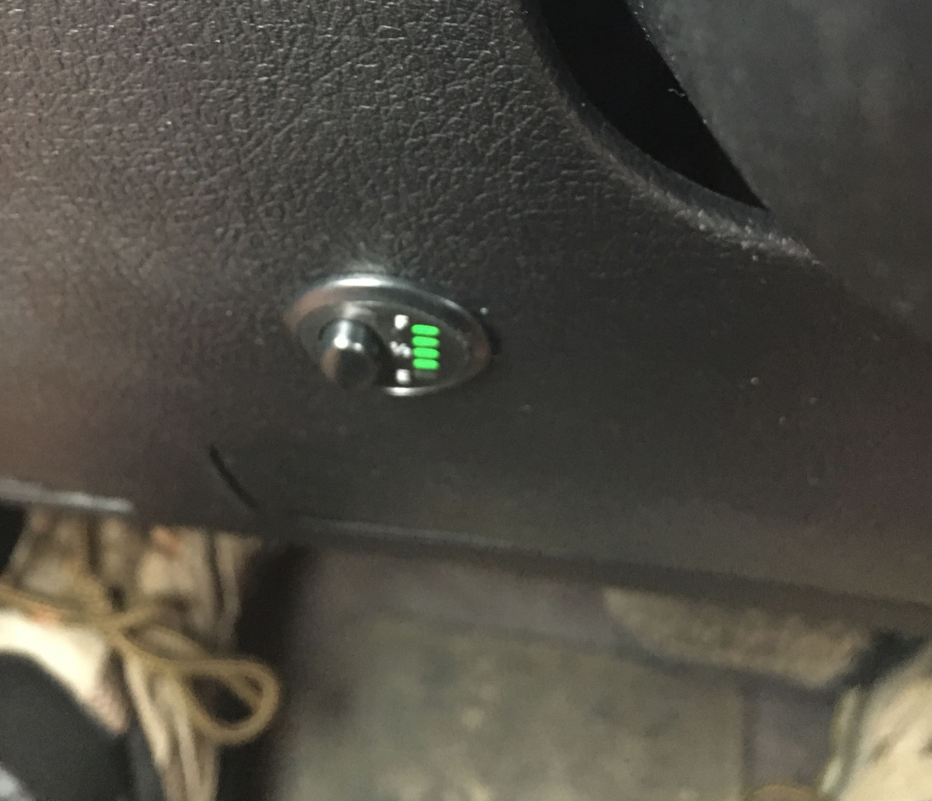

Tech question on this switch on the tank from from Long Range Automotive.
The black/white wire from this switch is suppose to t-tap into the main oem fuel sending unit, and then this little computer can be programmed to auto fill, turn on at 1/4 tank and off at 3/4 tank when refilling. Where did it tap in? and what color is the wire coming from the sending unit up at the cluster? or what part of the harness? You push 4 times on the switch fairing quickly to get into the program mode.
Thanks .. I'm installing one and do not have the 200 series wire diagram.

I don't know anything about an autofill function or programming the "little" computer. Slee installed it, but I would assume based on my inspection and having installed one on my 80 that the switch connects directly to the pump with a senor connected to the fuel level sensor. It automatically shuts off when the tank is detected as empty for I think 2 minutes. I would ask Ward Harris any further questions in his thread on the tanks for 200 series
