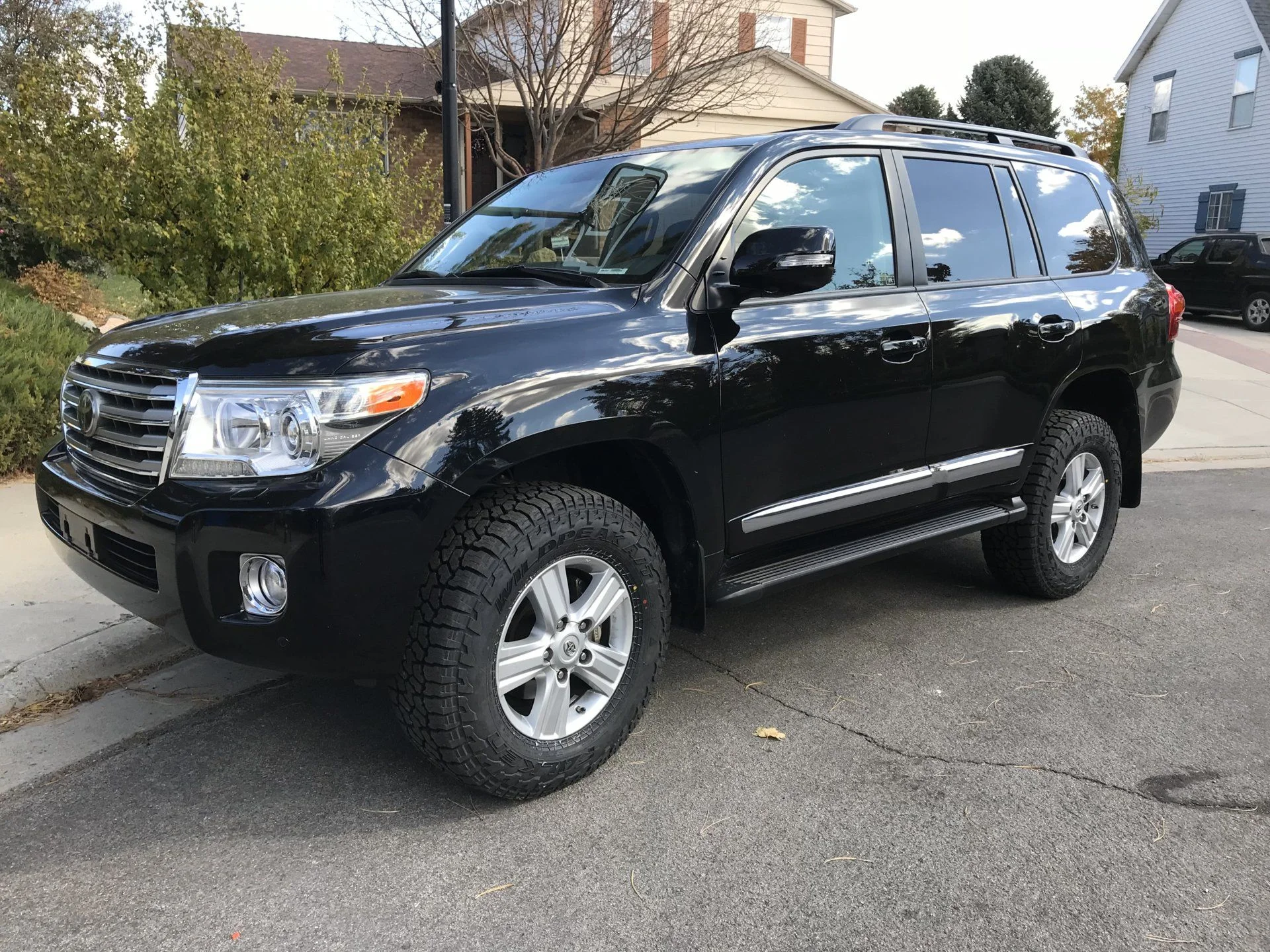

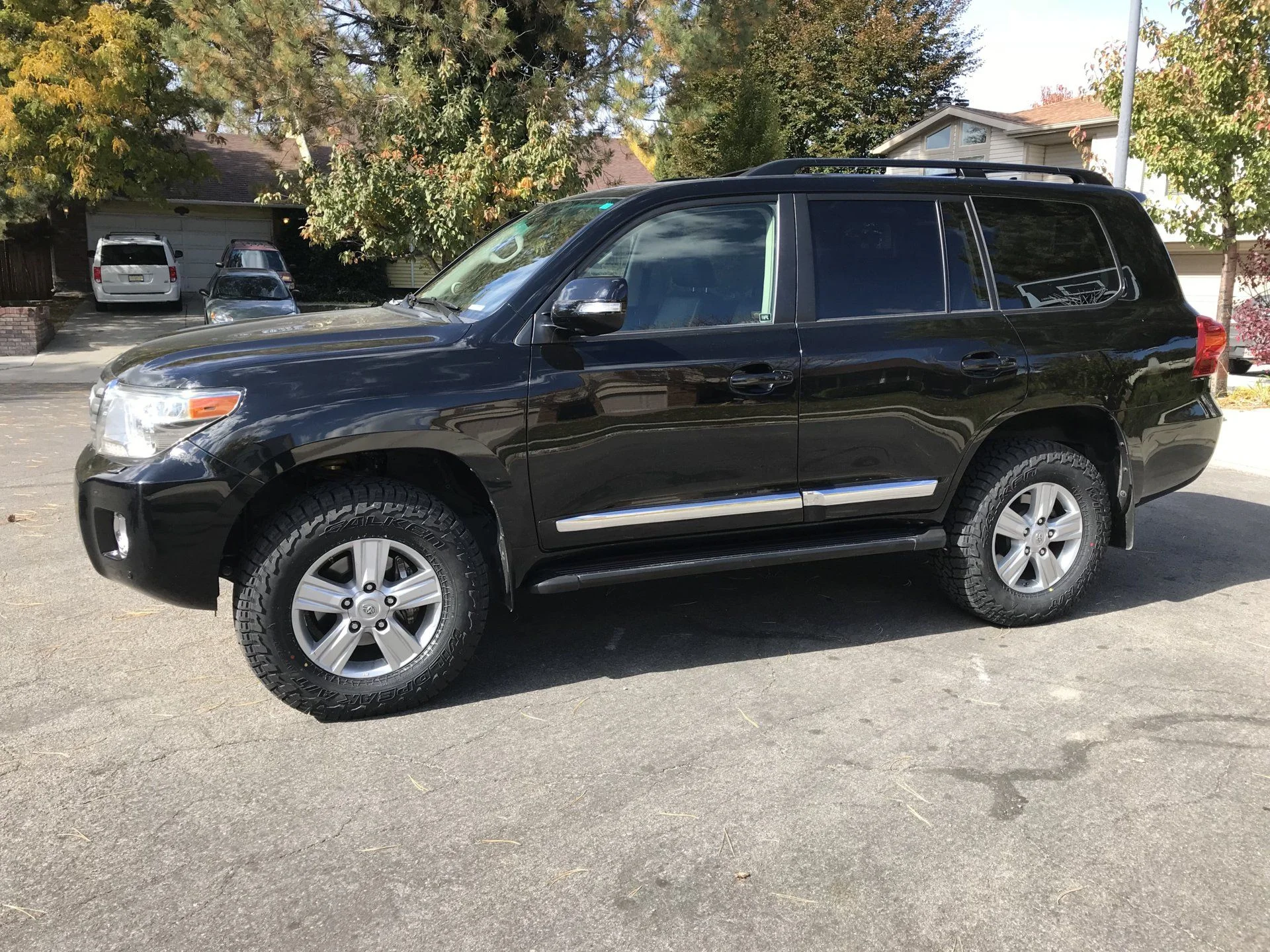

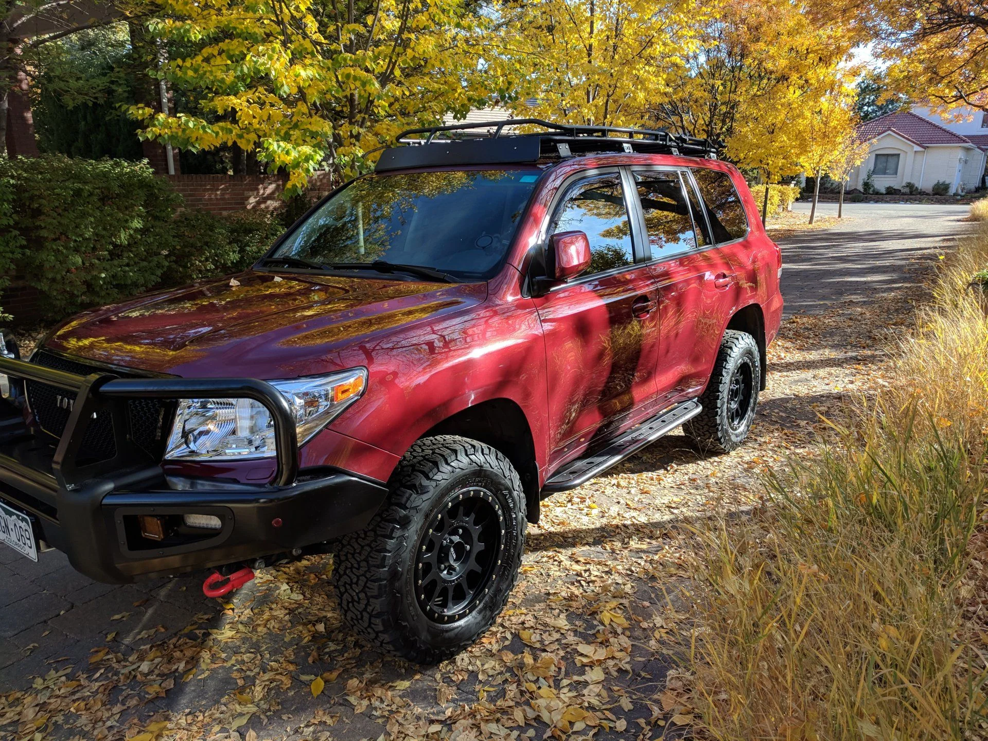

put new shoes on her today. 275/70R18 KO2's. Much better ride and handles way better with the stiffer sidewalls. After day 1 of city driving, gas mileage is unaffected. After seeing it with the new tires, now i am not sure if i want to lift it or not.

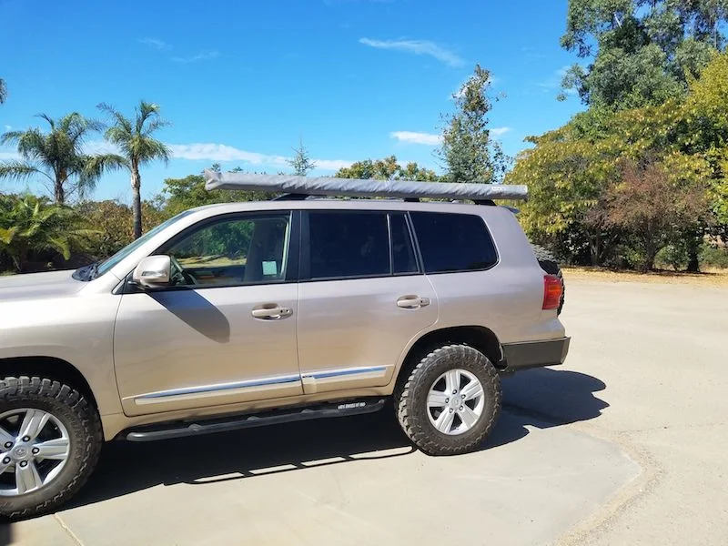

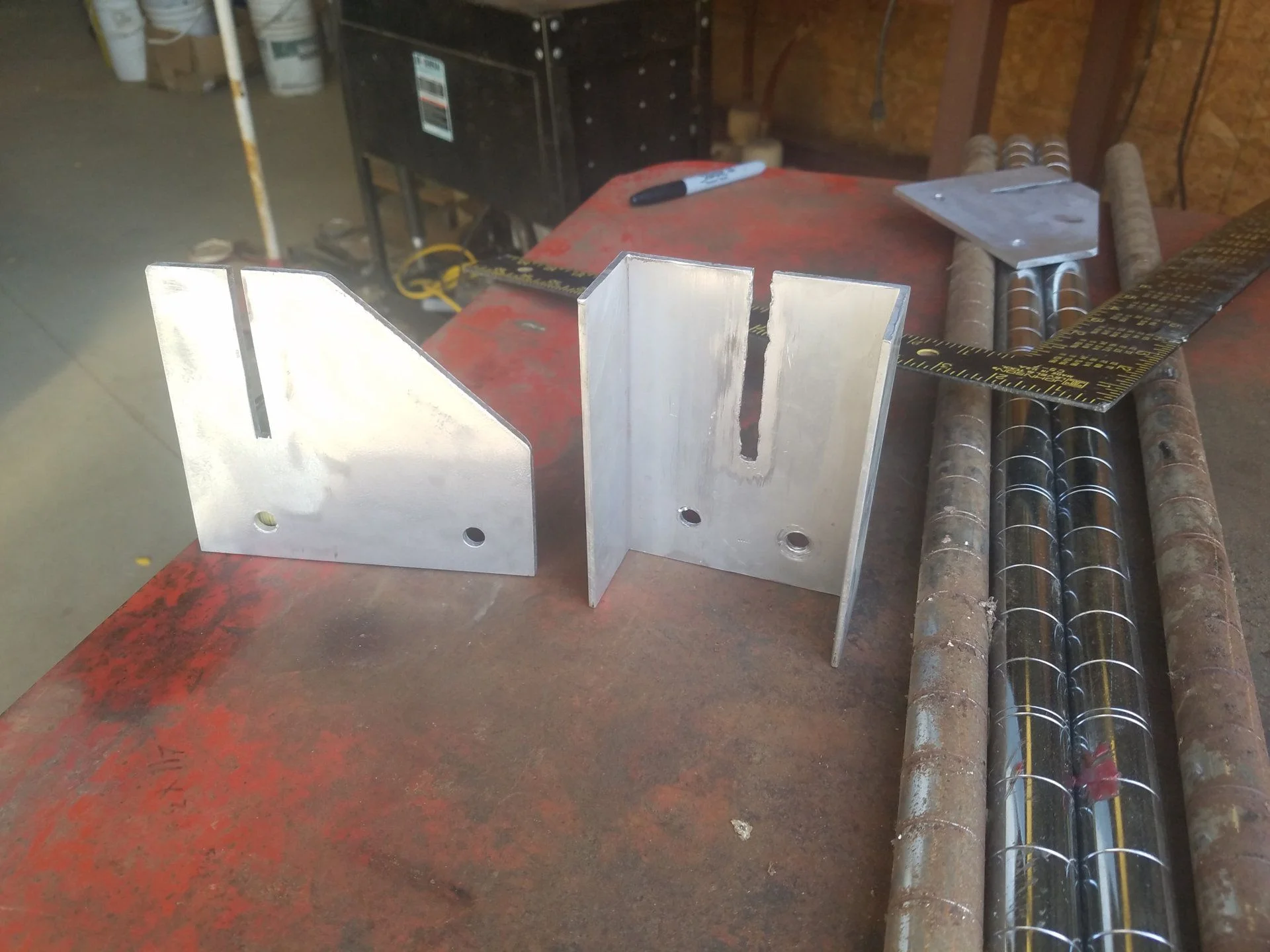

Fabbed a couple brackets to attach my ARB 2500 awning that utilize the stock roof rack rails. Easy to make can be used on either side without compromising the use of stock rack. Total cost about $13.00. One of the shots shows first and second generation attempts. Final material was made from 6061 aluminum 3/16 thick

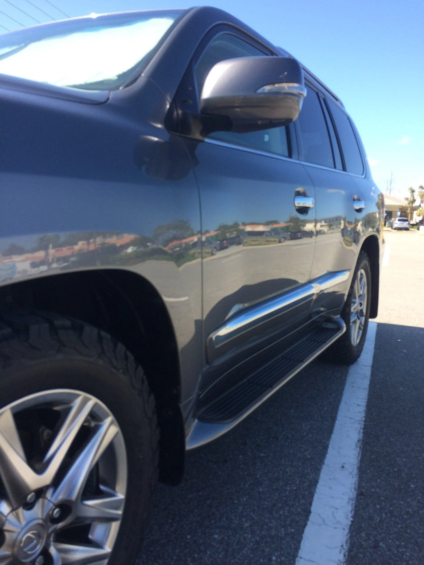

A little paint correction treatment...
- painted the RLCA skids & frame with Rust-Oleum auto enamel
- painted sliders with Krylon Rust Tough (black matte finish matches the Slee Sliders really well)
- body paint & clearcoat for very deep pinstripes, outright scratches to metal, and some pesky pockmark-like gouges
- clay, v32, v36, v38, jetseal, butter wax from Chemical Guys
- total effort: about 16 hrs over the course of 4 days (stop and go largely due to my conflicting schedule)
All in all, happy with the results, but it's probably only 90% where I wish it to be - some scratches just wouldn't buff out, and the body touchup paint looks good from a distance, but up close it's obvious... For my amatuer skills and protecting the metal from upcoming snow & salt, I'll chalk it up to a 'win' for now.
