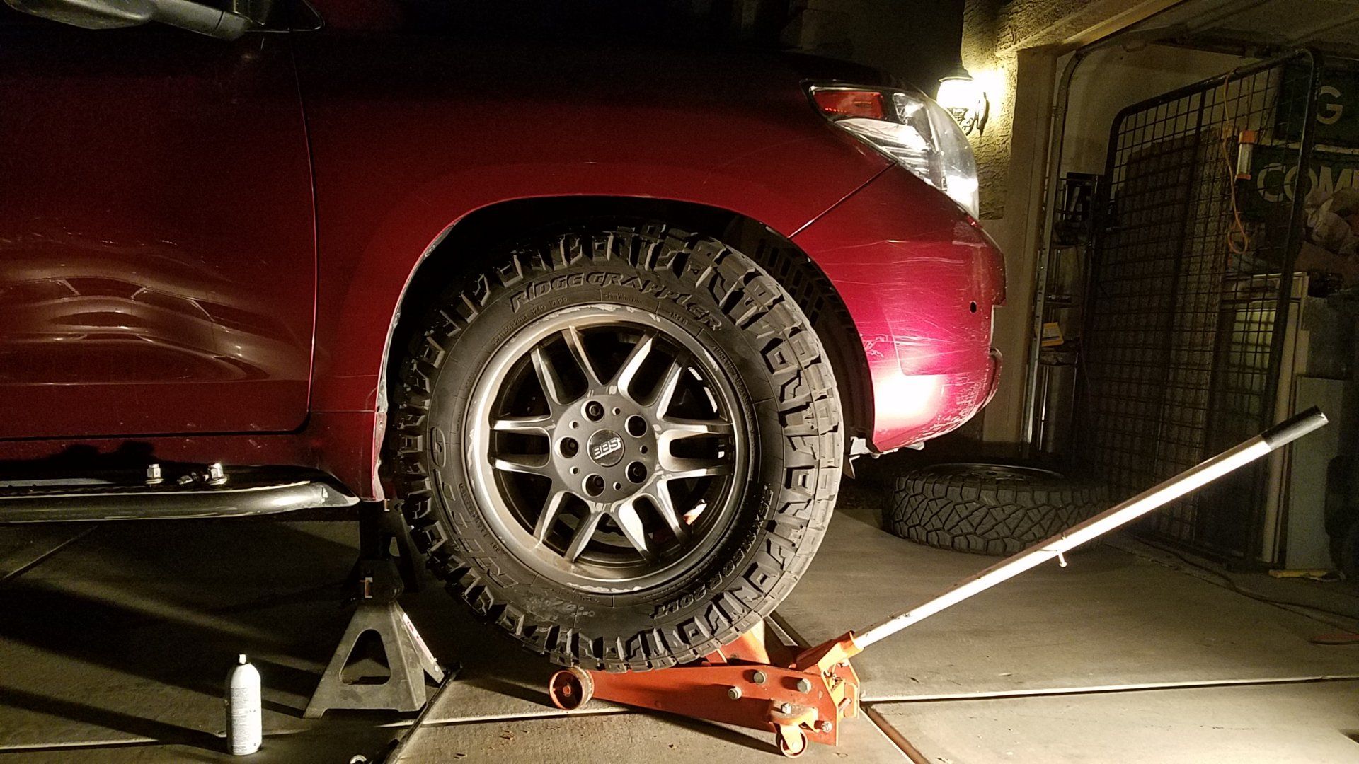

So without the shocks in, I jacked the wheel up to the stops and started tinkering and measuring. Nothing scientific, just a bunch of feeler gauges and trying to keep the wheel in the same spot turned to the worst clearance.
with the lower control arm all the way forward (front cam all the way in, rear cam all the way out) clearance between the wheel and the fender over 1"
with the cams set to neutral, clearance 1/8"
I set the cams at 1/4-1/2 between neutral and the limits and settled on 7/16" clearance.
Running 100% Toyota OEM hardware and dialed back the alignment, so hopefully no more driveshaft issues.

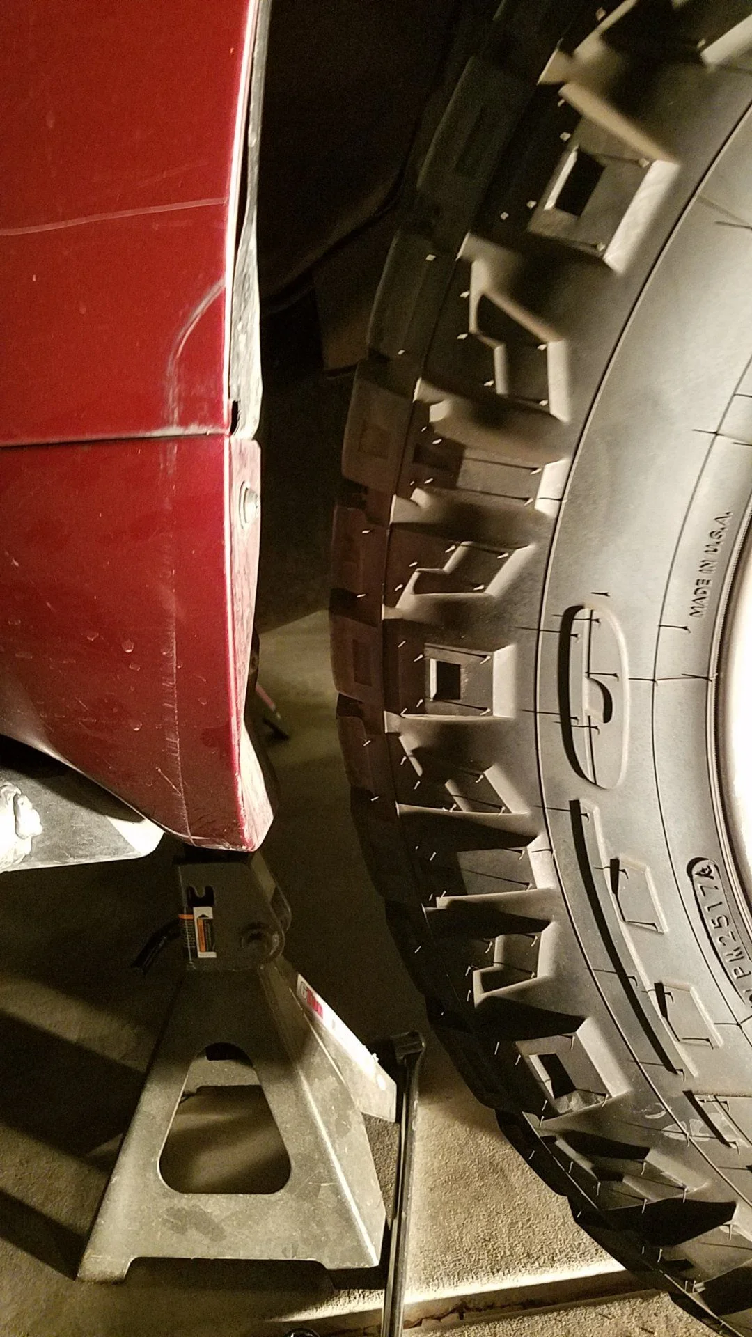

also, before Moab/Breckenridge I swapped the stock bumpstops for energy suspension extended bumpstops. As seen in these photos, the tire never hits the inner fender at full compression, 35" tire on 50mm backspacing on Tundra arms.

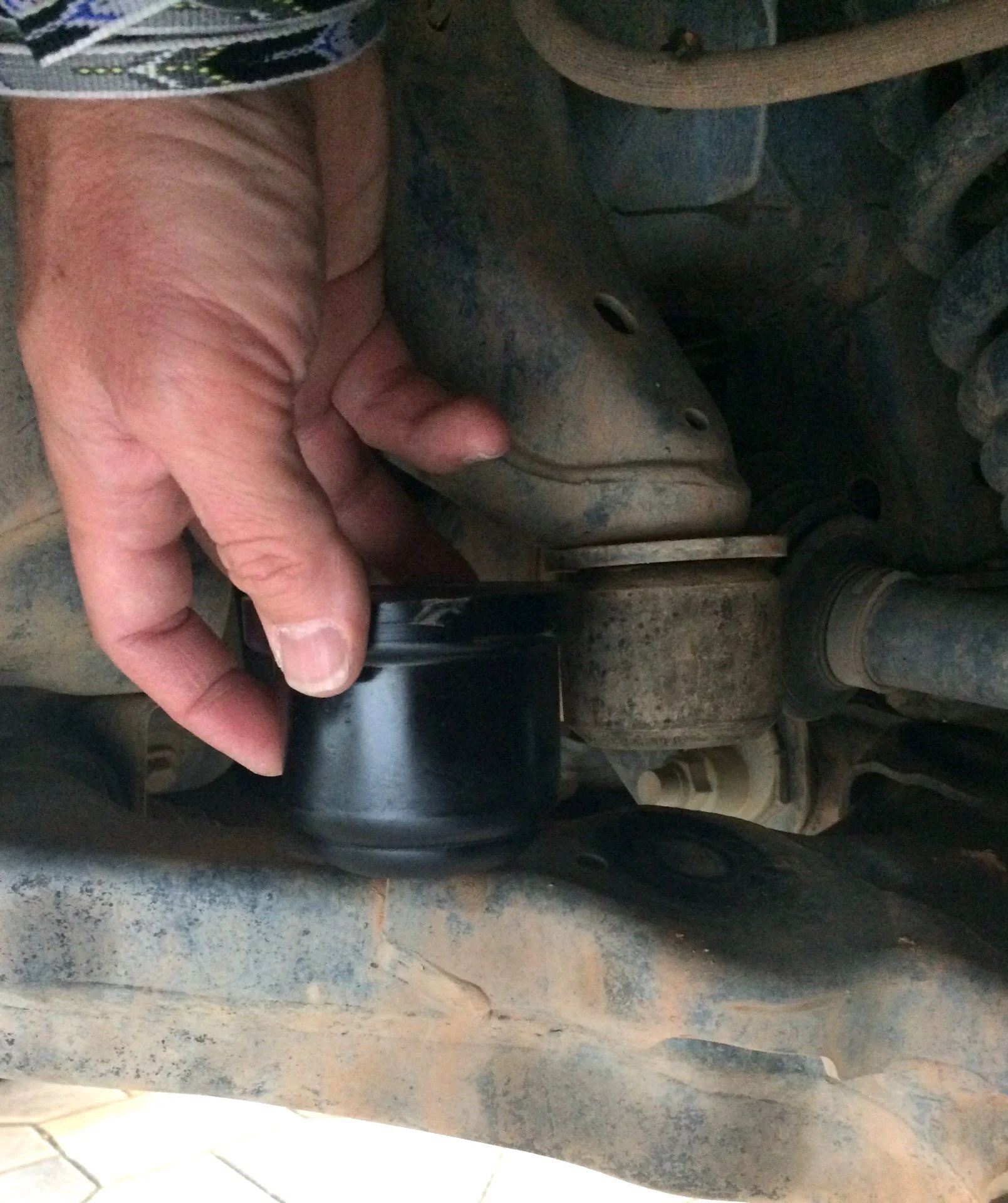

Wheeler's Offroad Bumpstops for 35's in front... Man these looks tall!
Hmmmm...
Wheeler's Front SuperBump™ Bumpstop Set
There you go Mark. I like these over Timbren and Energy. Made for off-roaders, unlike Timbrens which are made more for towing and highway applications. They are almost as tall as the others, but “smoosh” much easier and don’t limit up travel too much.
My FJ is visiting my garage right now (one of my LA buddies bought it, and is visiting) so if anyone wants a picture of the wheelers bumps, I can get one quick for yea.
Q for @Taco2Cruiser...

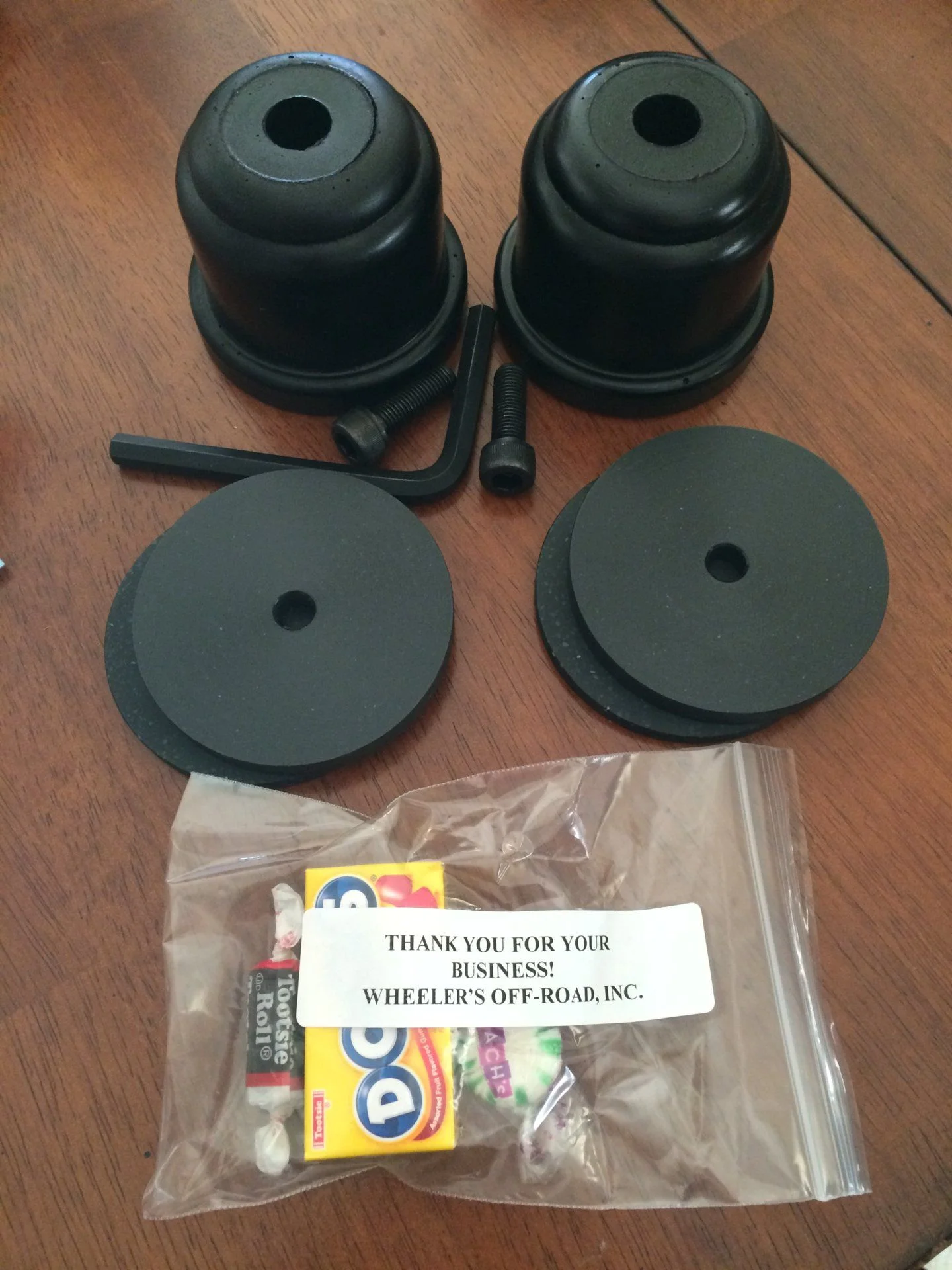

This is what came after ordering those...
Timbrens installed... Wheeler's on the left.
They are HUUUUUGE. Not sure this is gonna help...
What do u think?
Well, you'll definitely limit your uptravel
Hope those are squishy
At what point does the reduced articulation become a bigger drawback than the advantages of a larger tire? :confused:
Ya, these aren’t going in.
The point was to allow MORE uptravel than the Timbrens...which already limited uptravel more than necessary.
These are huge and even if super soft...they’d have to compress a full inch just to be as “short” as the Timbrens.
