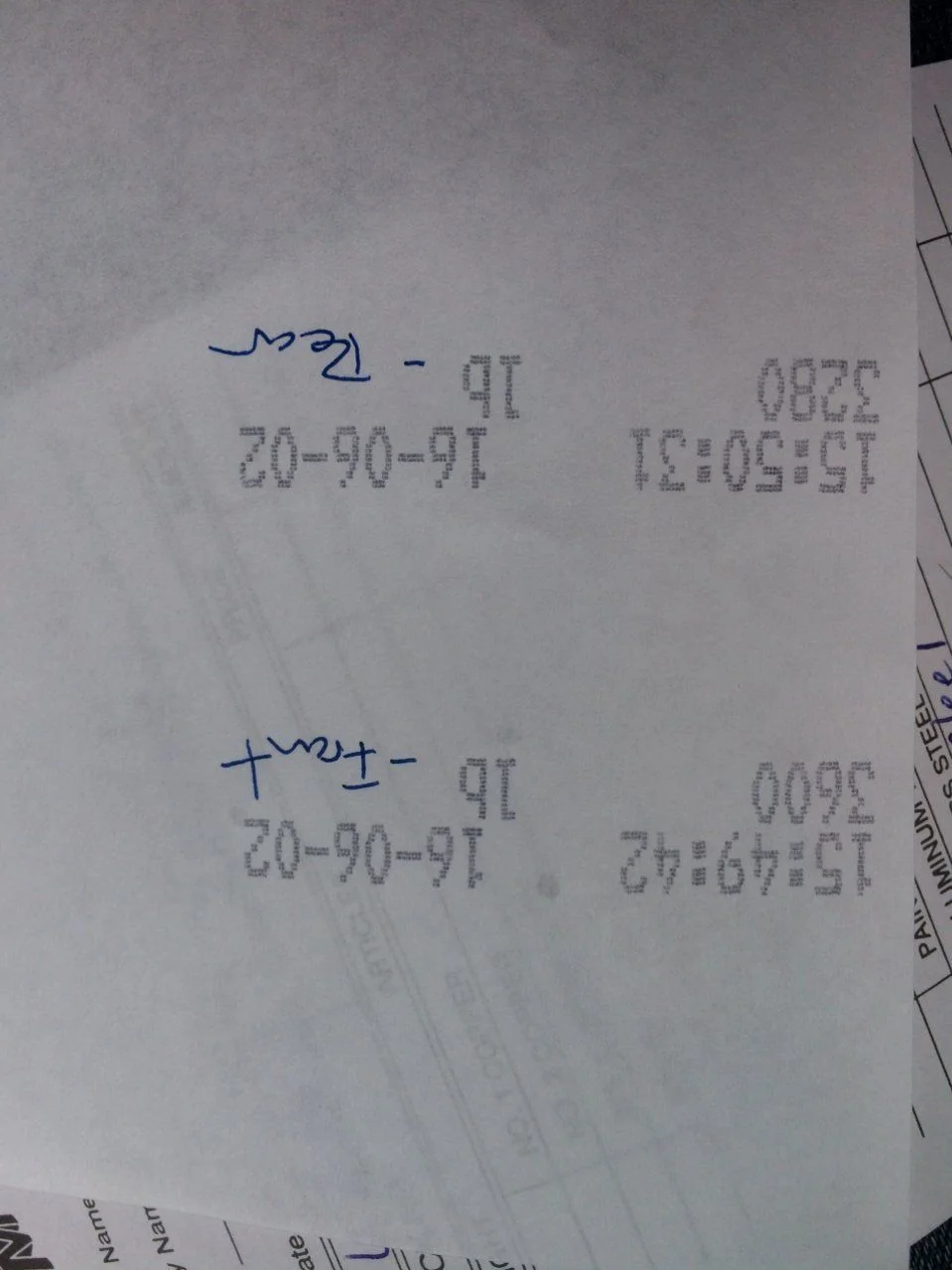

Weighed my truck today.
Take 190 lbs off the front axle weight because I was sitting in it.

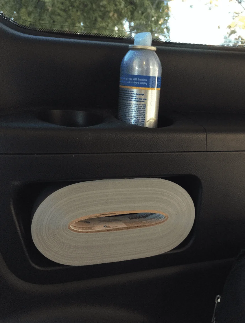

Finally found a USE for that right-rear hole that looks like it's made for something, but nothing ever really fits:
A squashed roll o duct tape...
I know... It ain't pretty... Don't care.
And... -You know how duct tape roll sides stick to stuff?
-This spot keeps the sticky side away from the inner surface! Tadaaaa!
And heck... in a pinch?
-Duct tape fixes...attaches...seals EVERYTHING. ;)

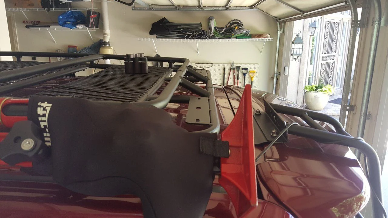

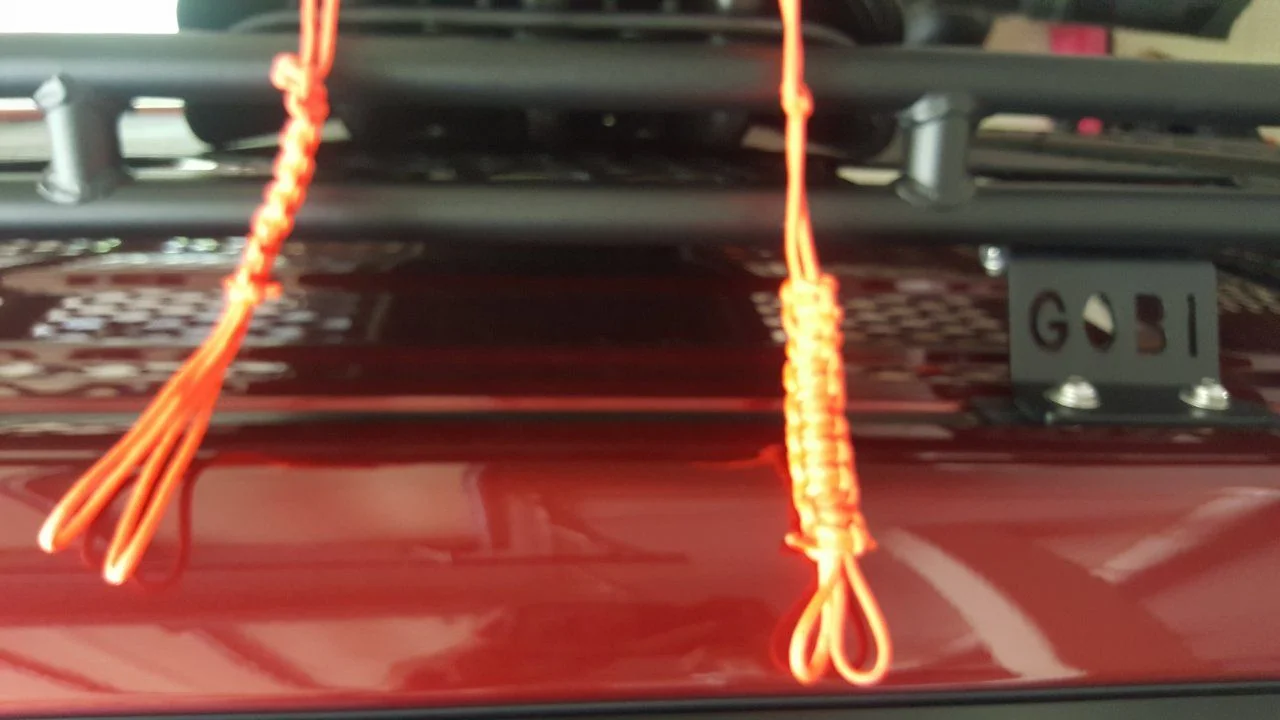

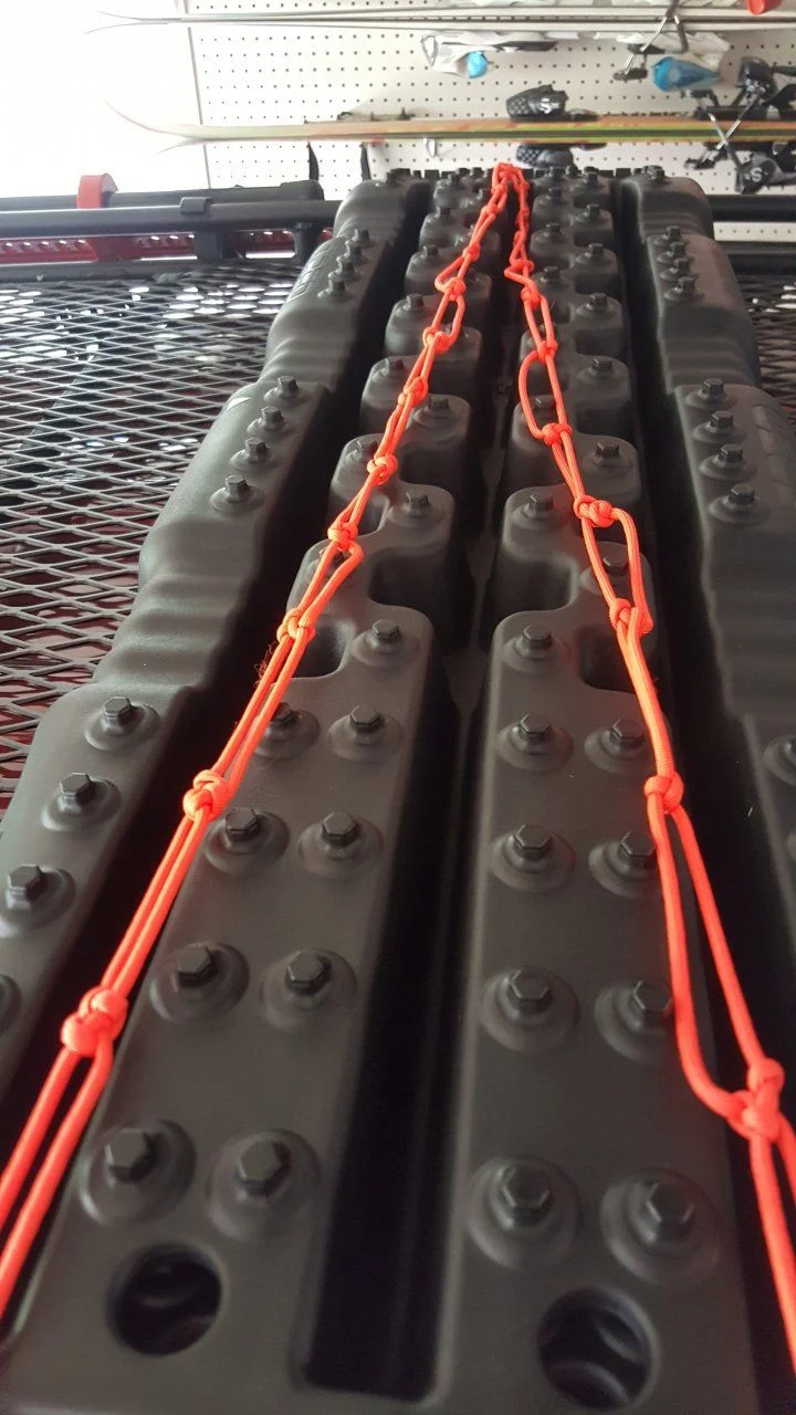

Got around to re-positioning the hi-lift so it didn't rattle so much - had to position the base plate far enough towards the rear so that the base plate doesn't rest on the top rail and rattle while driving (probably only applies to those with a gobi stealth rack). Also added a pair of TRED1100 with custom made 4ft leashes from paracord - used a combo of cross knots every 2 inches over 4ft then made the handle out of cobra braid. Used 20ft of paracord for each 4ft leash - didn't measure precisely enough so one handle is shorter than the other, but ran out of paracord to correct it. Good enough for now.

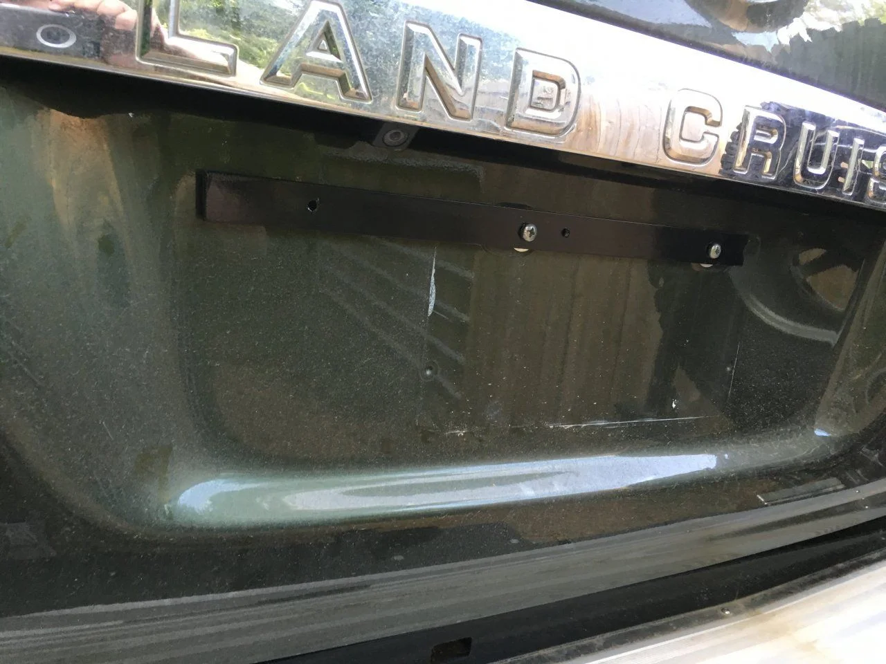

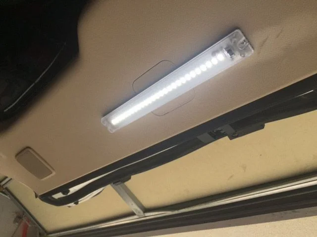

Installed a LED light bar on the rear door (upper portion). The cargo compartment is a bit dark at night so this will fix that!. Its wired into the secondary (fridge) battery, so won't have to worry about the main battery. Thanks @Equipt.
How did you run the 12V?
You have write up on that? This is exactly what I'm looking to do. Any help would be appreciated. Thanks!
I installed the Slee second battery bracket and an IBS system pretty much first thing after I purchased the 200. Ran that power to two places - first under the passenger seat for the HAM and then back to the rear compartment for the fridge. I tapped into the line to the fridge for this light install. Haven't started a build thread yet, as the exterior is still entirely stock but plan on a build thread in the future.
