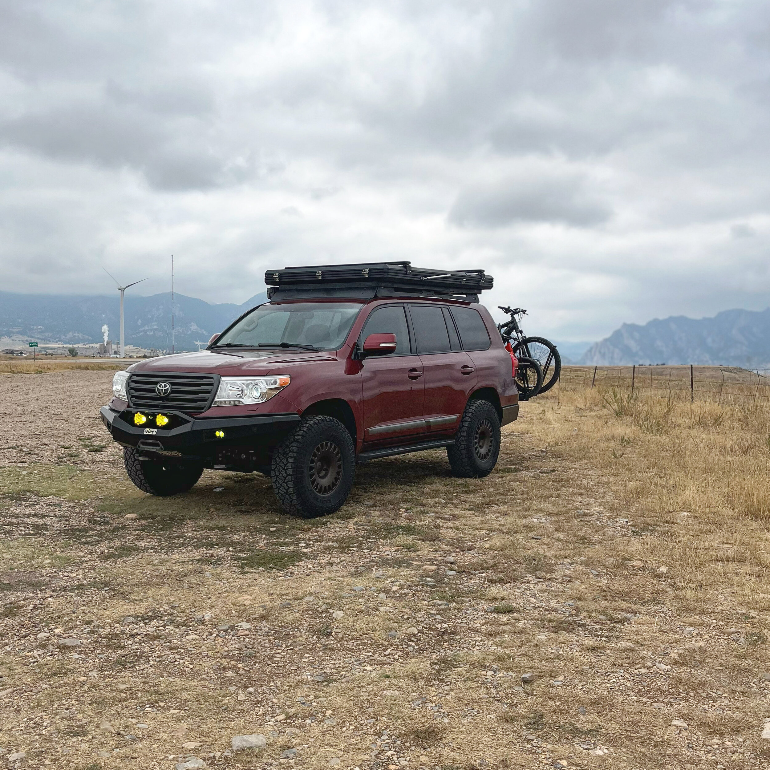

Decided to try some different tires for daily driving. 37” KO2s in C on my non-beadlock RWs rocking @turbo8 rings, which are sick. Compared to my worn KM3s, it’s like riding on a cloud
