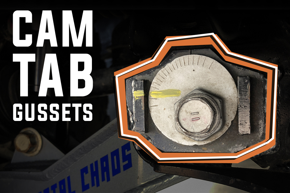

Yes, the little rounded tab thing can get bent out of shape when the eccentrics aren’t torqued to spec, the. You can hold alignment. Total Chaos makes a cam tab gusset kit that completely replaces the OEM tabs. It’s a bit of overkill… or is it? After some drama on a trip, including warranty replacement LCA’s while on said trip, I do not think it’s overkill for me.
Your link sums up my issues 1000%. I just experienced what this picture from that link is showing 3 times on our recent road trip. My last alignment at Toyota in Provo, UT was 2000 miles, mostly interstate, before the one I had this week. I lost a full degree of caster on one side and half a degree on the other.
I may do this on the LX we just got just for the simple fact that I want to idiot proof it.
