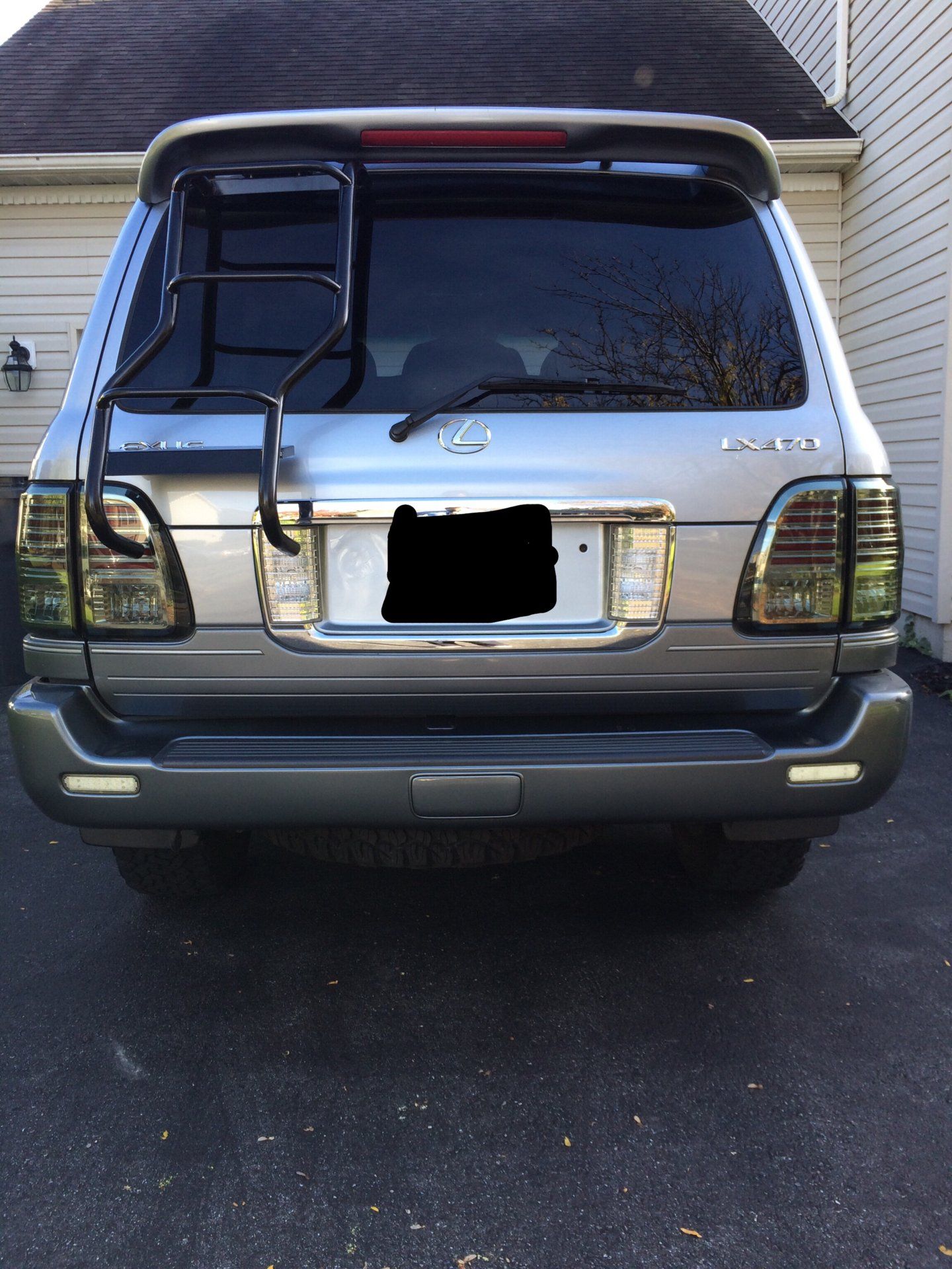

Replaced wheel bearing and found whoever replaced it last time forgot the thrust washer - no wonder it was shaking at highway speeds.
Where to find one at 9pm?? Stole off my FZJ80 (it might be a different part number but it works)
No shaking this morning!!

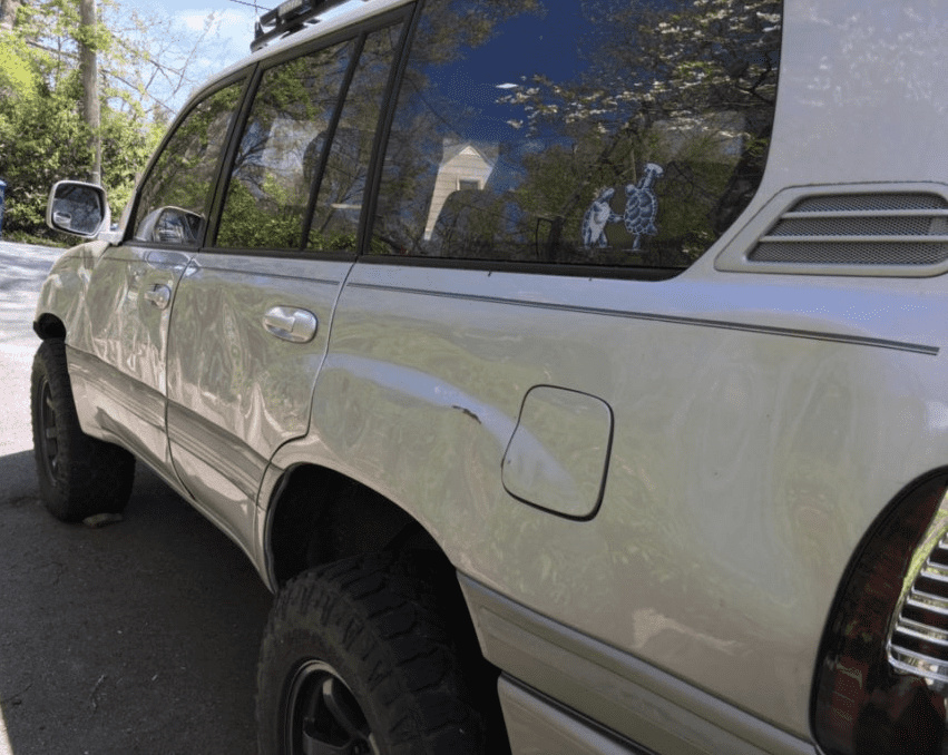

Went out wheeling with a local group. Ended up sliding backwards in to a bunch of trees and badly denting and scratching the passenger side
Oooof - we could be twins - I did the same to my driver's side (slid backwards in to a stand of trees), albeit without sliders at the time....
