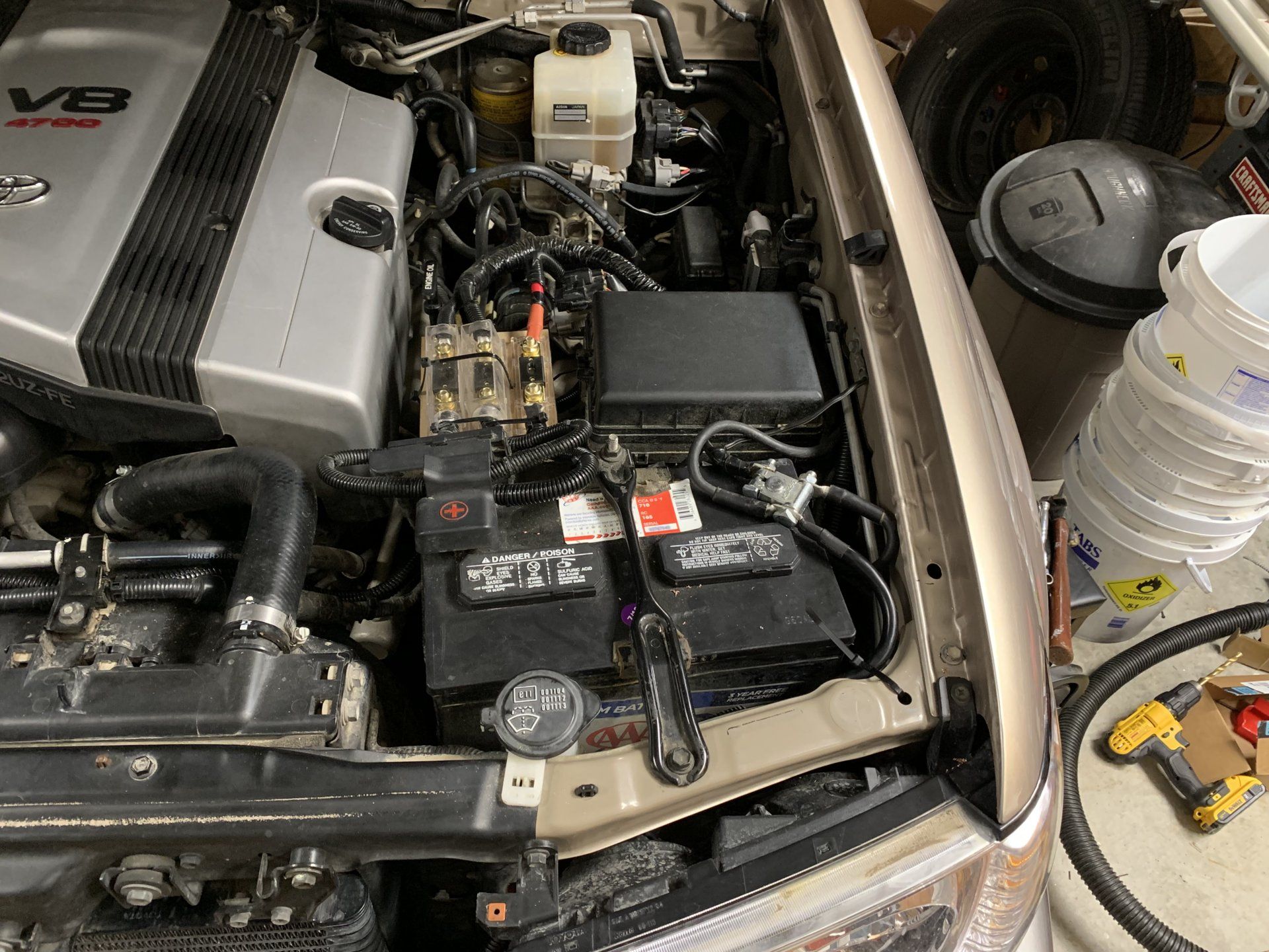

Finally finished wiring in my winch with a BlueSea disconnect. Wasn't a fan of having the winch connect directly to the battery in case something went wrong with it so I've been running around with nothing connected for the last 6 months. Excuse the dirtyass engine bay, a dry weekend and I will be cleaning it up.
Totally agree. I decided to go with a 400 amp fuse that I can remove when not in use. Installed it yesterday. I cringe when I see winches or really anything directly connected. to a battery. The military battery terminals are reasonably priced and make connecting stuff a bit easier than the smaller oem.

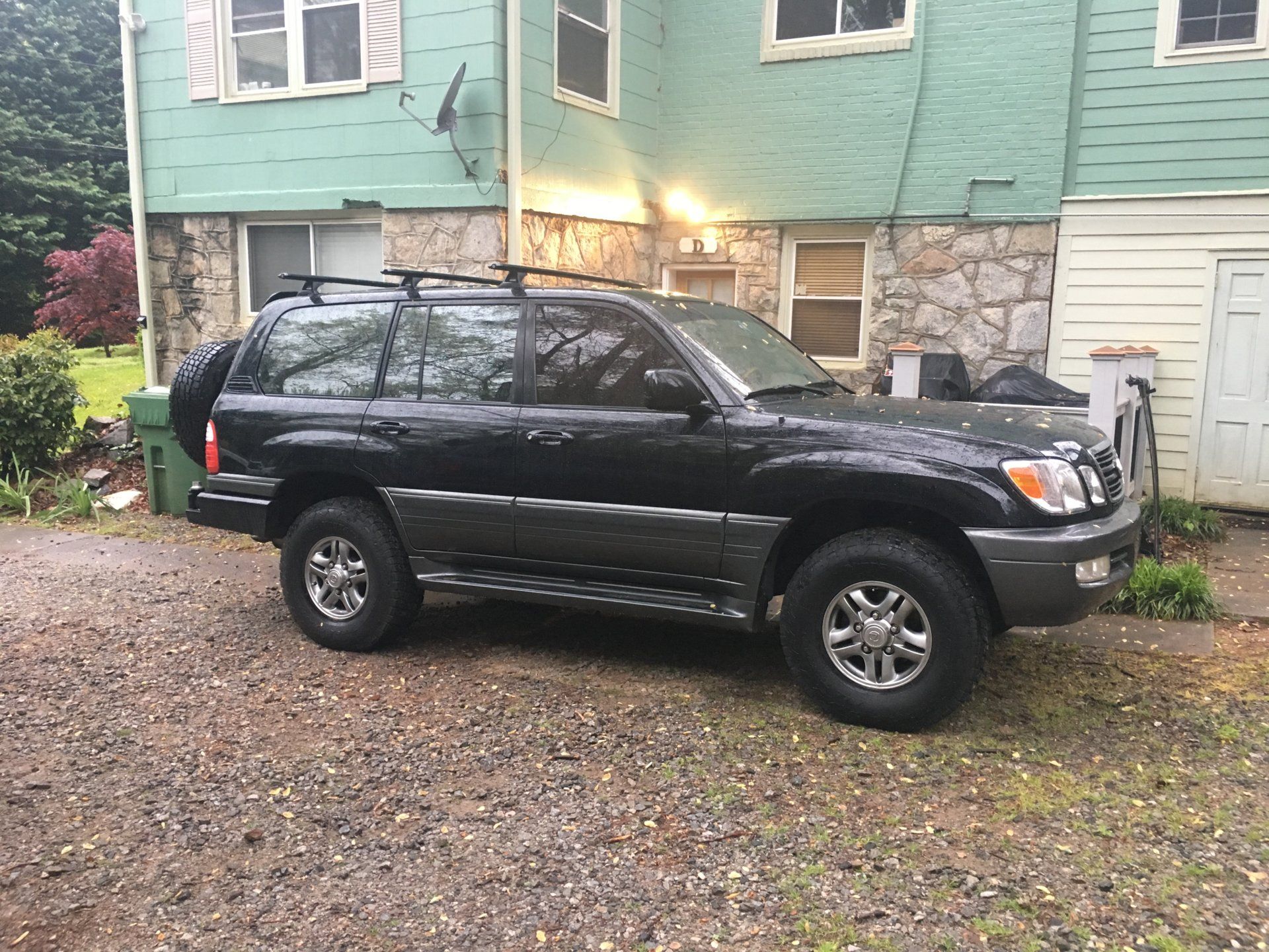

295/70/R16, AHC in poseur mode ;)
Awesome! Could you plz measure the ride height (center of the wheel to fender) in front and rear in high mode?
