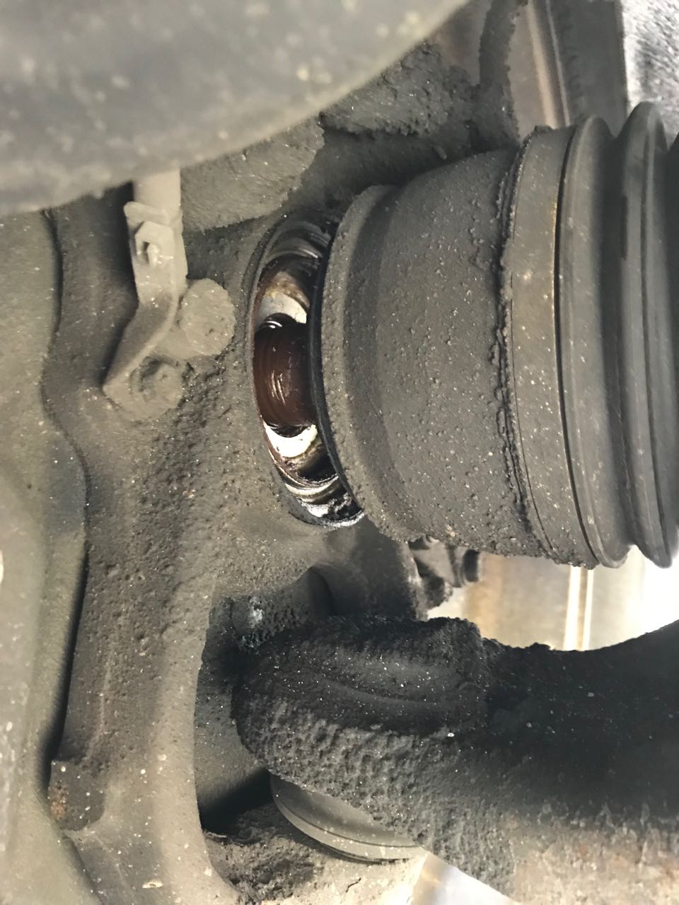

Changed cabin filter while waiting for air filter to arrive. Also oil and filter change, first since I bought her. last change unknown. Oil filter was Valvoline brand so probably not from dealer. Removed front skid to prep to fo rust repair and refinishing and fluid film. While crawling around under the truck I noticed huge gap at my left front spindle.

Hadn't noticed that before....:wtf:
Changed cabin filter while waiting for air filter to arrive. Also oil and filter change, first since I bought her. last change unknown. Oil filter was Valvoline brand so probably not from dealer. Removed front skid to prep to fo rust repair and refinishing and fluid film. While crawling around under the truck I noticed huge gap at my left front spindle.View attachment 1970103 Hadn't noticed that before....:wtf:
DO NOT DRIVE THE TRUCK!!! The snap ring is off the axle under the dust cap
I bet the snap ring under the grease cover has walked off.

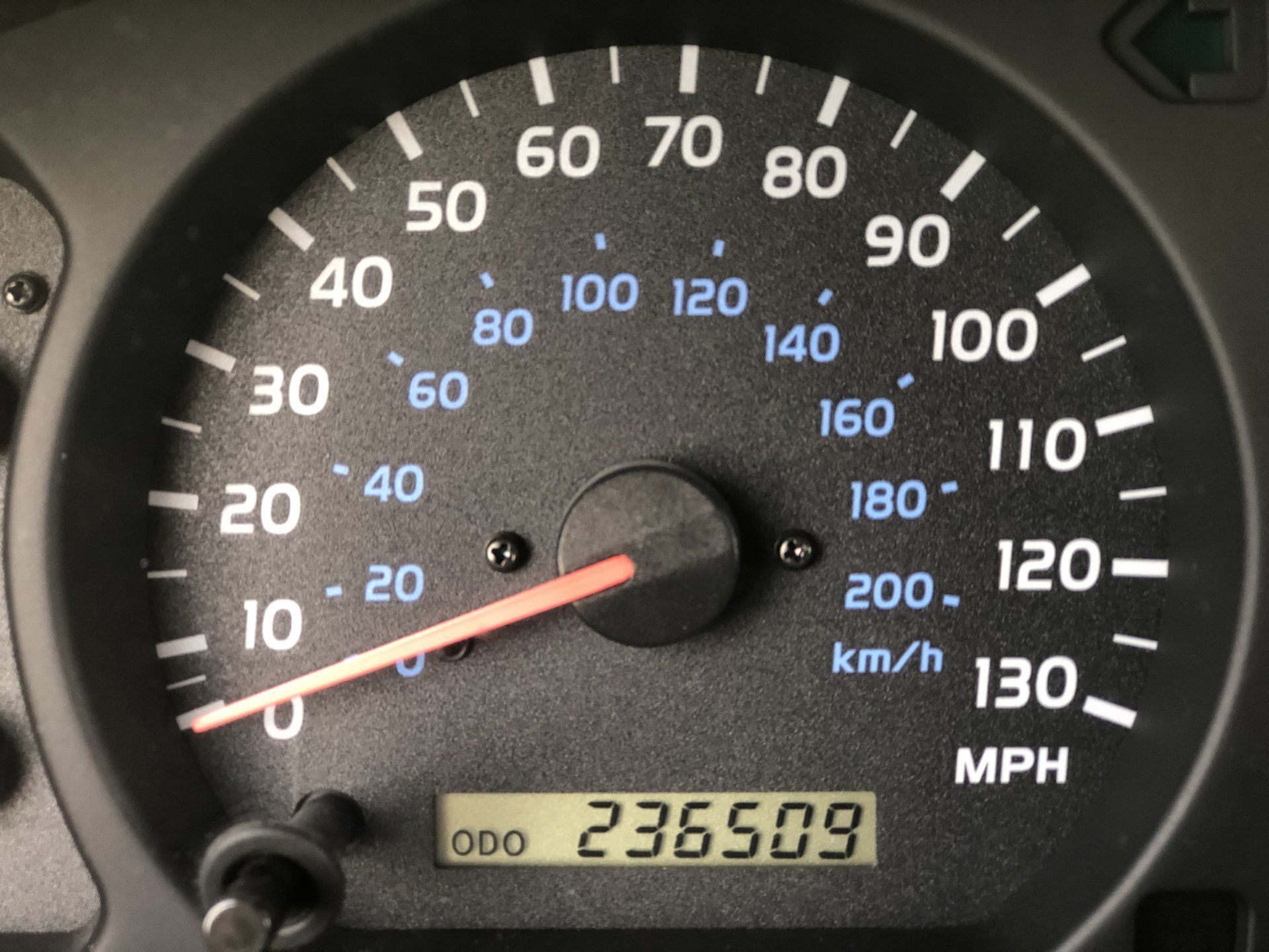

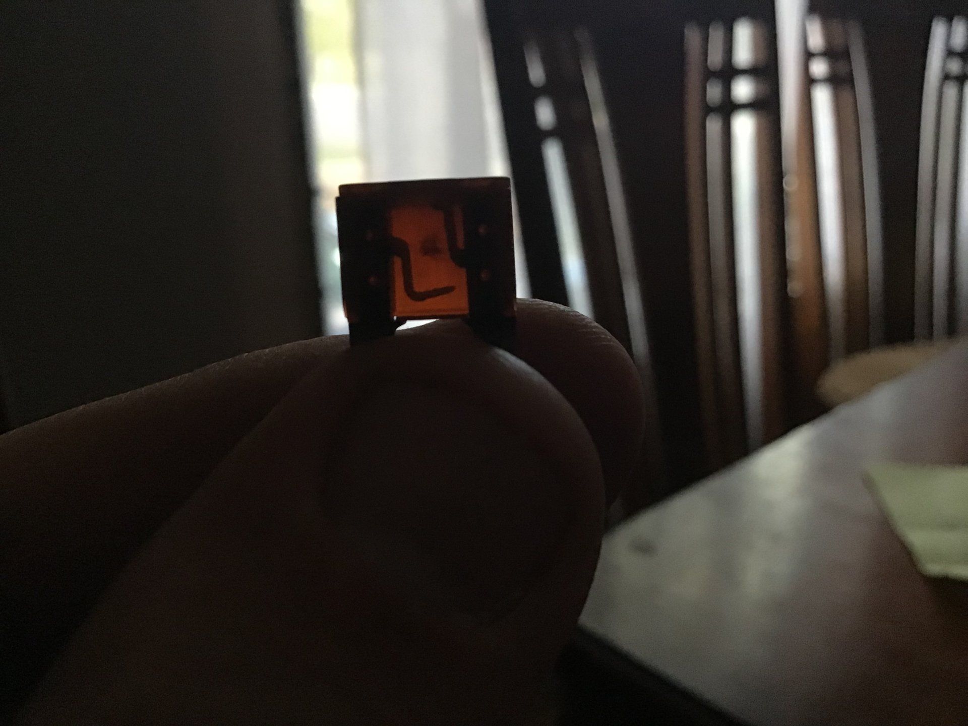

Finally got the time and tools to complete the front diff oil change. Man that old gear oil smells nasty! Checked around locally and the best price for a F,R,TC, and engine oil change was $230. All in including new tools, new crush washers, and oil was about $90. The new knowledge about my truck, and that it was done right are worth as much as the extra cash. Upcoming KO2s and 4 wheel alignment. (Tire guy tells me the BFG promo starts 5/15) Also, figured out that the cause of the blank Multi-Function Display was fuse #32-which is labeled as as a fuel injection fuse...thanks to another MUD user for the encouragement to keep looking, even though all the “right” fuses were checked.
