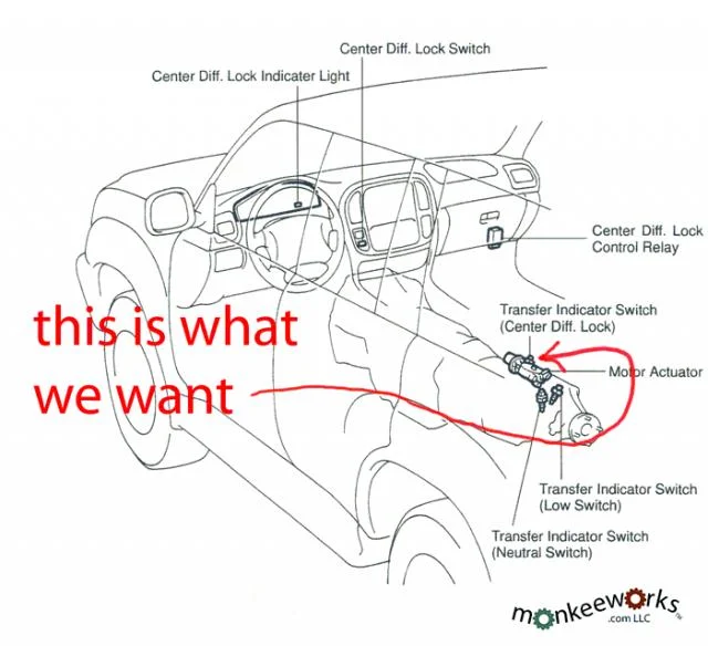

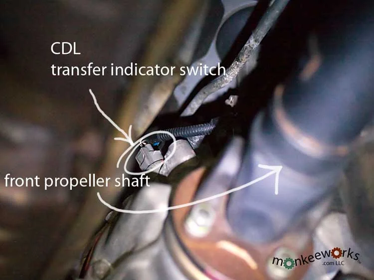

Just discovered I have this problem.
Found this web page that provides a good explanation/fix for the problem - Lexus LX470 (Toyota Landcruiser) 4WD Center Differential Lock Transfer Indicator Switch Problem
Anyone else ever had this problem, where the center differential locks, but the lights doesn't come on? And was the fix the same as this page describes?
Mine could be this...Just haven't been too concerned because it still locks...Hmmmm...I will use the page as a reference to see what I can find out. Thanks much!!!

IIRC there are actually two switches in the t-case. One is for lock the other for neutral?

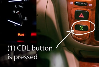

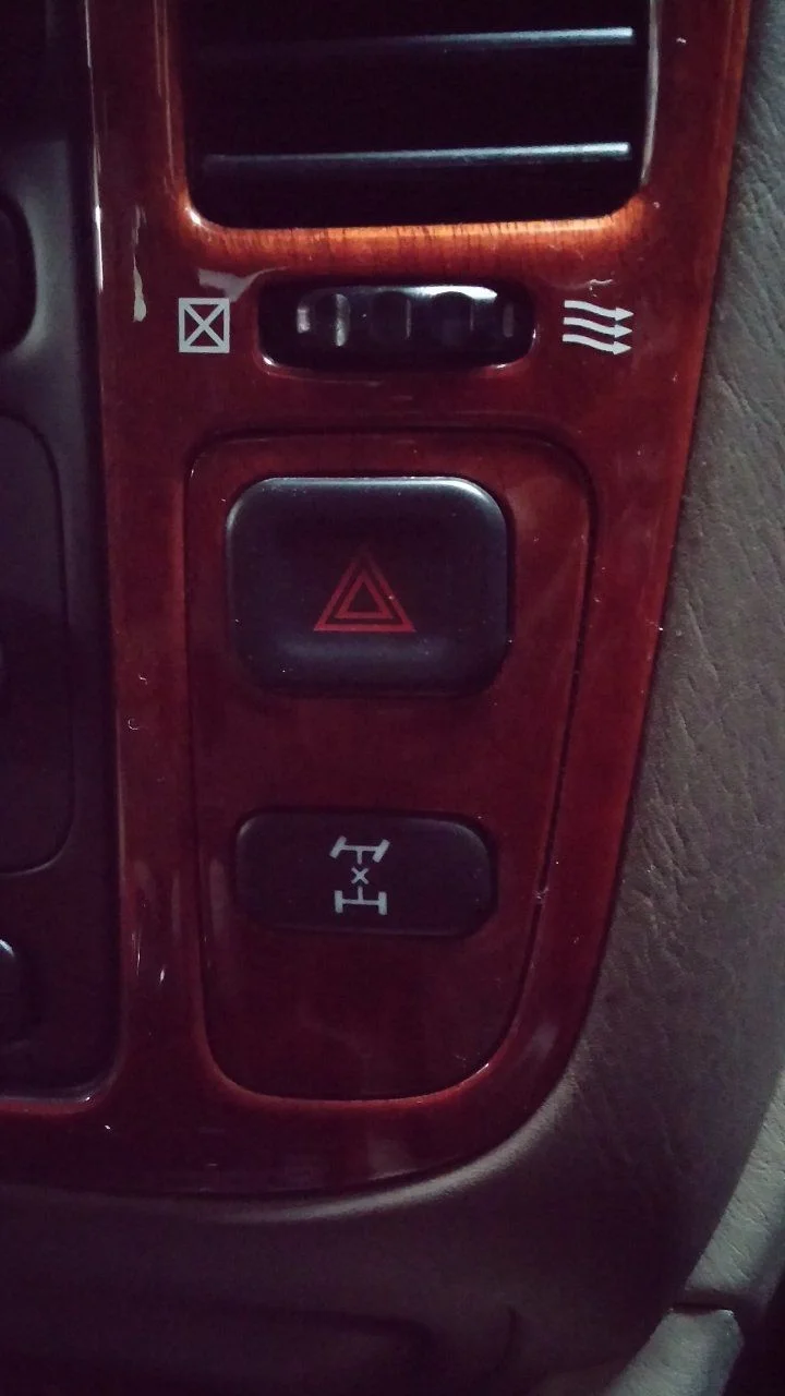

Is my CDL switch, by the radio, supposed to illuminate? My Dash lights work fine and indicate correctly but the little icon on the switch is just white or invisible if dark... That pic makes it look, lite up green.
Mine doesn't light up either. +1 on your question. Of course, the wheely light doesn't light up in my gauge cluster, either.

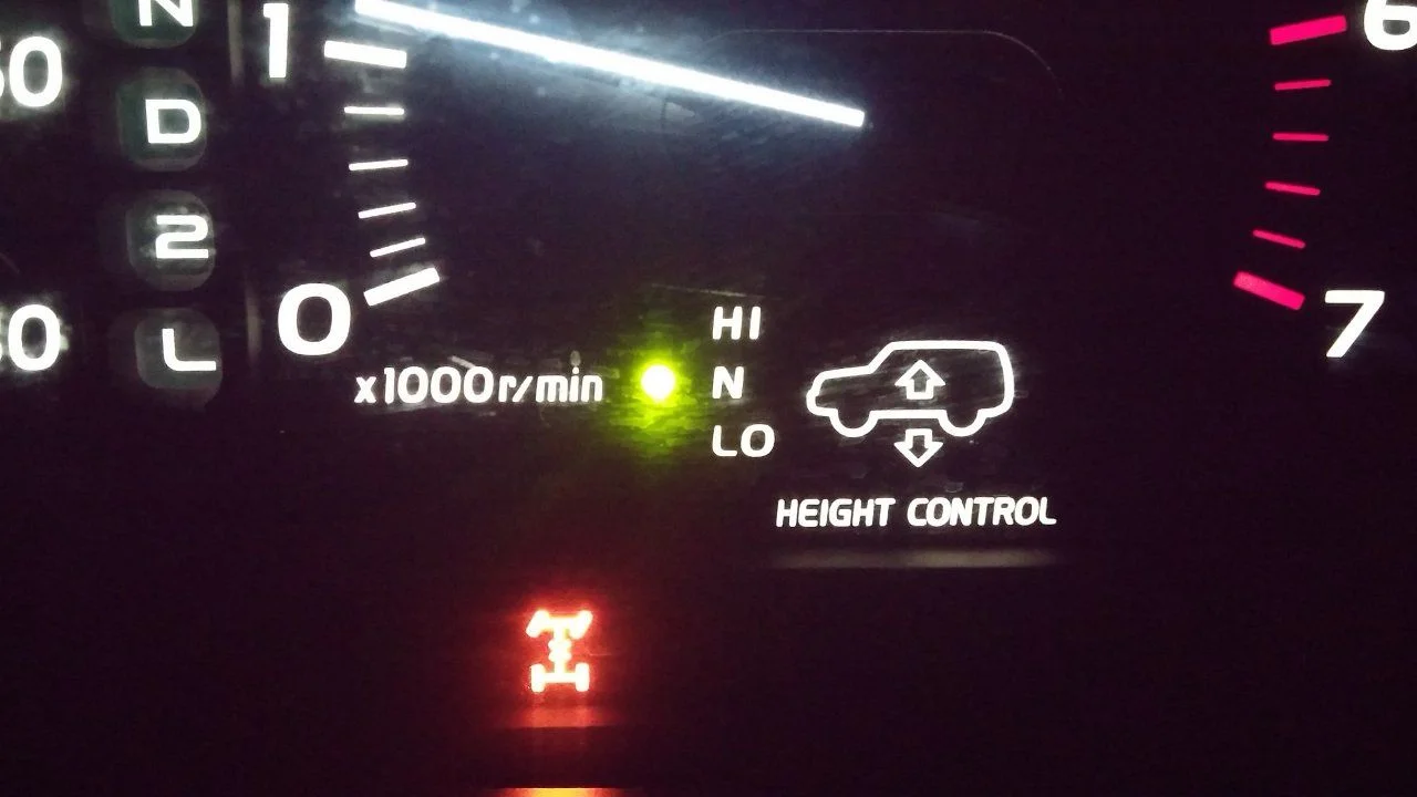

Weeniewheeler and blatant: I have the same. Light does switch on when pressed, not in the switch or on the dash. Even when going into low range the VSC OFF doesn't light up.

"the dash button, you push, for cdl, does 'NOT' illuminate, is illuminated when turning on the running lights, is always illuminated or illuminates when pushed?" sorry to nit pick, just want to be clear. -- - from the pic above, that cdl light looks like it should illuminate, or is illuminated(lit up) like the seat heater switches... again my original question for what almost seems like a thread hi jack...
does the cdl button illuminate like the seat heater switches? Mine is always not lit and just white and invisible in dark w/o dome or feel.
I would like to clarify that my LX470 do not have any light on the lower part of dash. Yesterday I tried to press the button (Attached please find the image), the light with the cross will be switch on of the dash and the car was run very difference, seems running faster. Does the front wheel is unlocked? I confusing this! THANKS for all!

can you clarify what you mean by :::light does switch on when pressed, not in the switch or on the dash::: what does that mean? What "light" switches on? I meant to type "light does NOT on", meaning the light on the dash for the CDL does not come on when CDL is pressed.

It was illuminated before and it suddenly stopped. Before when i pressed the CDL button, the light on the dash came on and when I selected low gear the other lights on the dash for VSC OFF and another one which I can't remember illuminated. Not anymore.

I attached the button and the light images. After pressing the button, the light on the dash is switched on.
thanks, i was just wondering if the button itself was back lit. Good luck!
