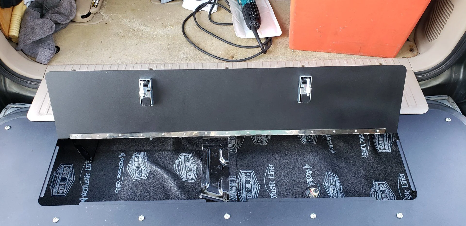

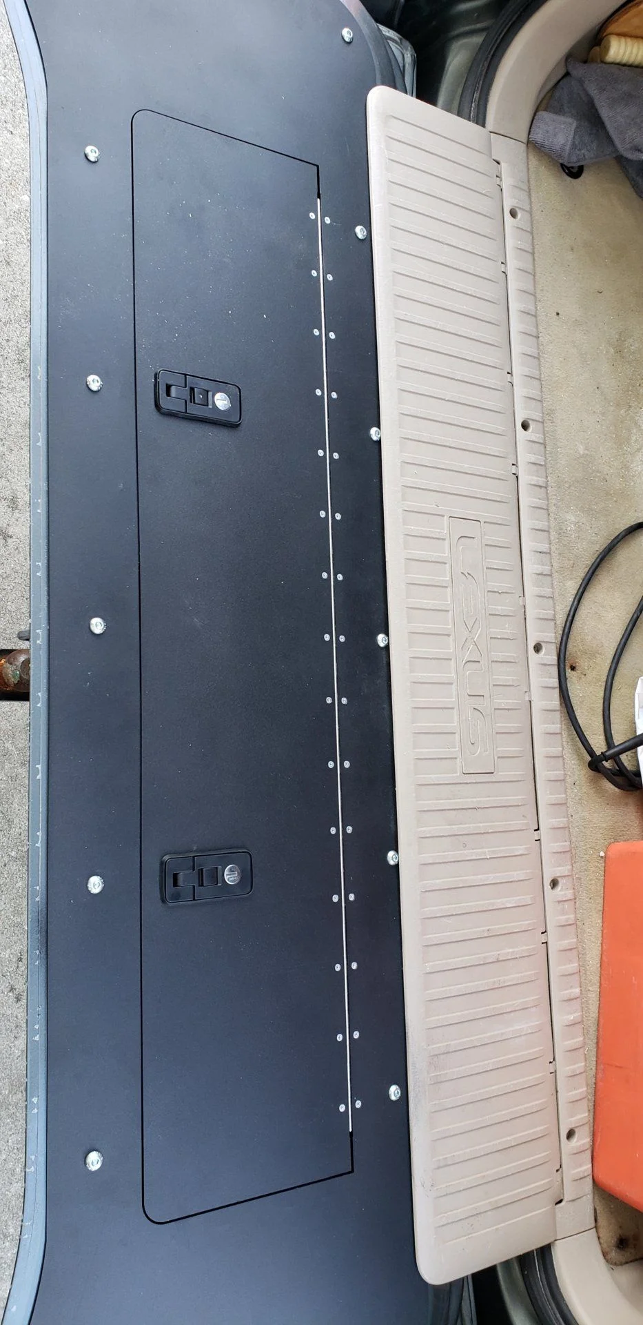

Buttoned up the panels, installed the switch for lift gate LEDs, wiring ready for futures, put the carpet back in...all set for Trekboxx install in a few weeks.

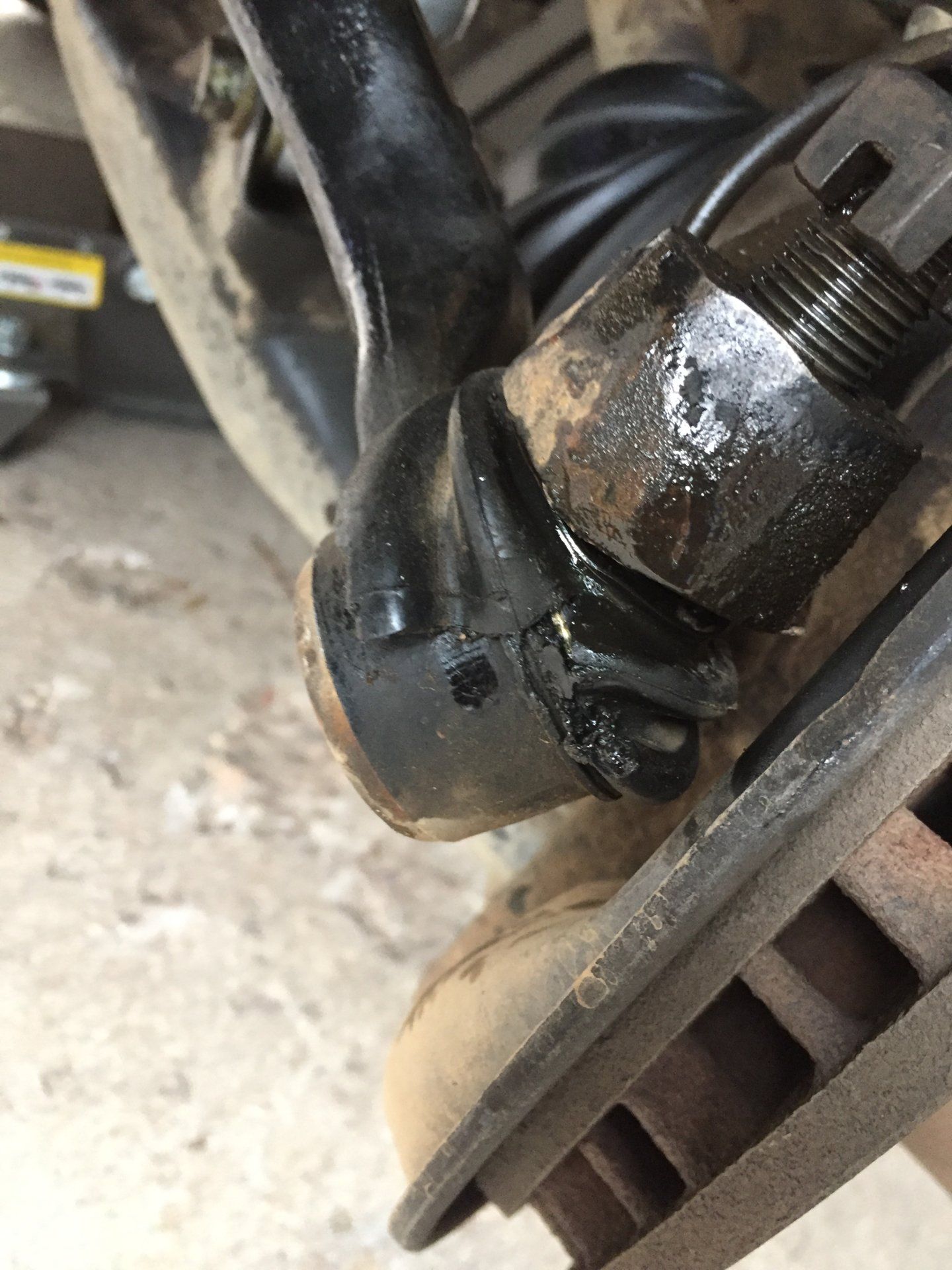

Replaced my outer tie rod ends. One of the boots was torn up and my alignment was a little outa wack since a run a couple weeks ago.
Was preparing for some torching and yanking, but it went rediculously smooth. Couple odd things. The DS which with the torn boot was significantly shorter (1 inch) than the replacement Sankie 555 from Cruiser outfitters. No problem, I just moved put the new end on 1" and then did the 6 turns to match the previous one.
Since it just makes sense to do tie rods in pairs I did PS too, although it seemed fine. Had a made in Japan on it and was closer to size of new 555, but still 3/8" off. Odd to have different ones on there. Checking spreadsheet from PO said they were done just 21,000 ago. I wonder which one they actually replaced. Will have to check the hard copy records to see if there are any notes on this.
What do folks prefer for folding the cotter pins. Around the nut (perpendicular to bolt, try to fold into crown), or over the top (parallel to bolt). Also I did not thing the 53 ft/lb found around was very secure. I saw @2001LC used the listed 90 ft/lb, which seemed very tight.
90ft-lbf is correct and over the top one leg and down with other is correct. (factory just does over the top with one leg of cotter pin). Also worth a note: If cotter pin hole doesn't line up tighteen to line up.

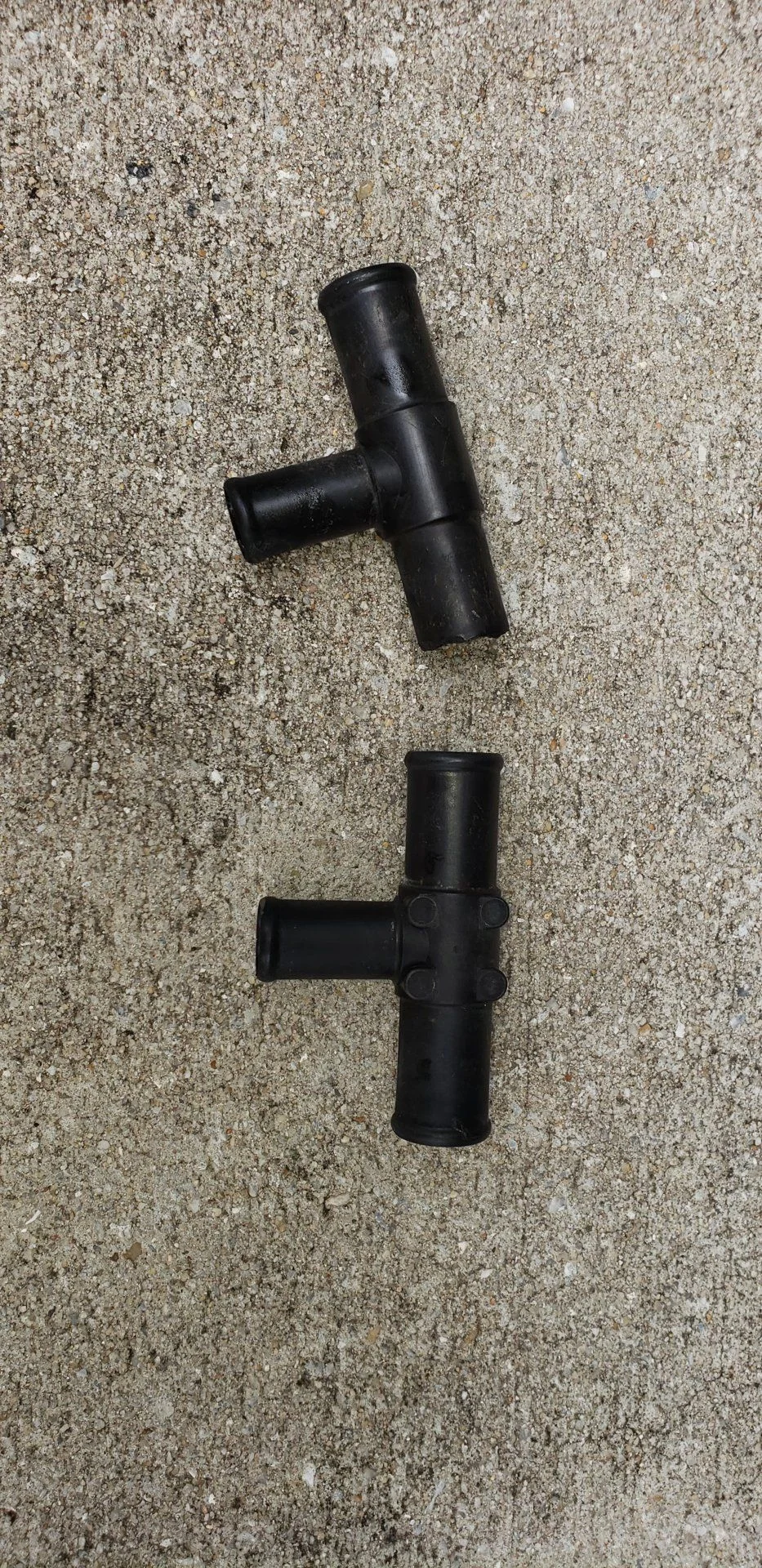

Replaced Heater T's on my '06 w/ OEM's from camelback. Originals w/ 147K. The best part of the job was when my wife came out and saw me laying in the engine bay and said "What the hell are you doing now?" 'Putting in new heater T's darling." :) Eyes roll.......ugh. "whatever."

3. Heater T's changed with 155k on them. Overall decent but the edge was missing off the hot side.
