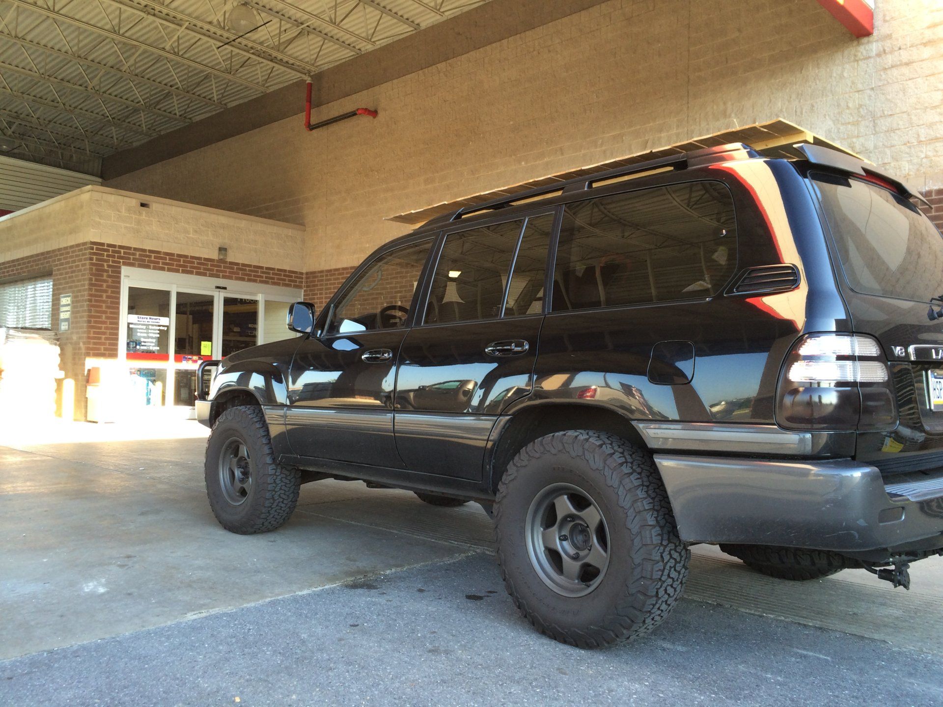

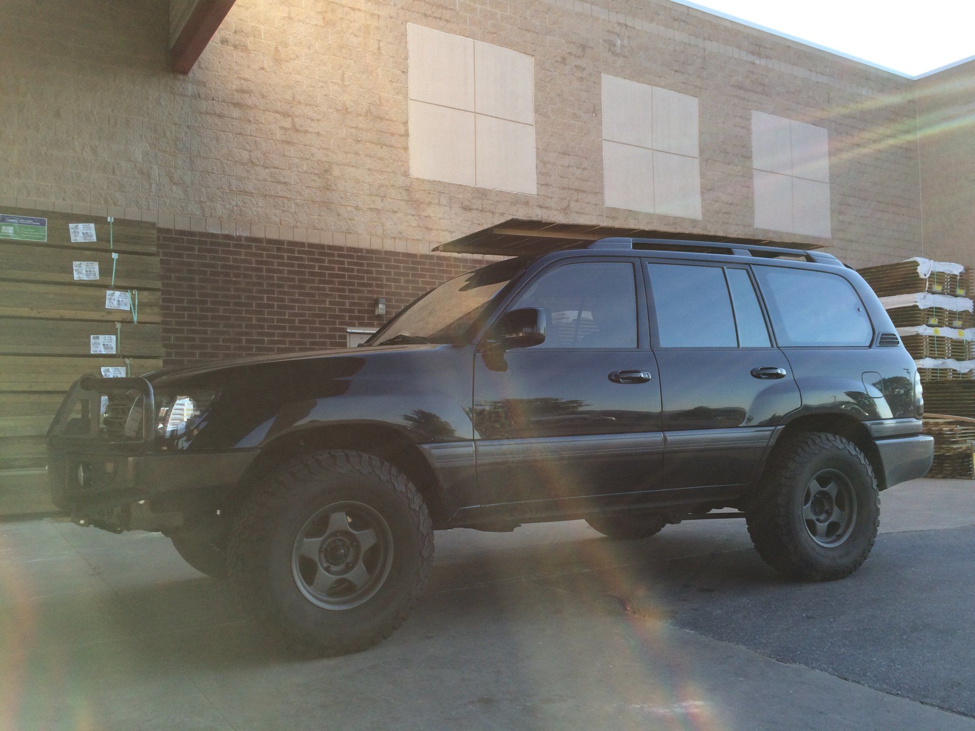

This is as close as I'll get to an aftermarket roof rack - at least for the time being:
View attachment 1755700 View attachment 1755701
Was pleased with how easy it mounted up!
Even cleared the rear spoiler!
And after seeing what a few others on the forum recommended with their Gamaviti I decided to go with the 1/2 grid as well.
