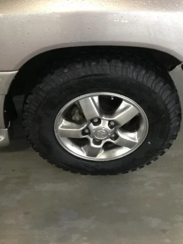

Also threw on 285 Goodyear DuraTracs and got them balanced. When they attempted to align the front end they found that my tie rods are shot and need to be replaced (another $800) and my CV Boots need to be rebooted. On top of that my power steering circuit may also have some problems and will need to be flushed.
Not a bad week since I got the tires on, but sure as hell was it expensive! Will start a build thread soon-ish and post pictures of what I've done and update on what I'm doing.
Installed 275/70/18 BFG AT K/O.

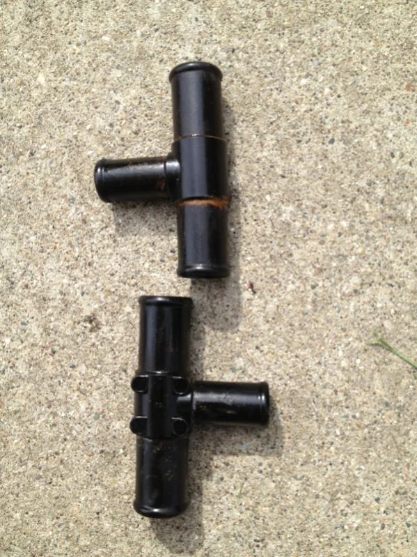

I also swapped out the heater water pipes (tees). They were still in good shape after 153,000 miles.

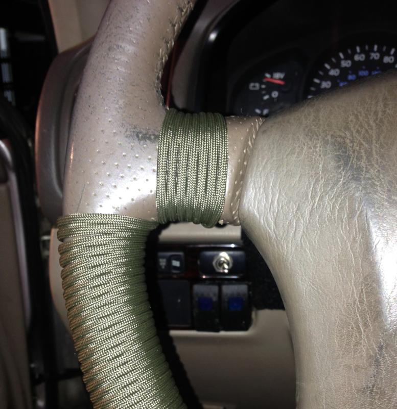

Started wrapping my steering wheel with 550 cord. I have a lot to learn about wrapping. This will be a test run to see how I like it. Already feels better than the peeling leather that gave you the goosebumps and dried your hands out.
Nice job so far. I'm liking the look of the cord. Very curious to see how that turns out.
Thanks! I have probably 1,000 feet of it sitting in spools downstairs. I figured they wrap breaker bars, knifes, brooms, anything that sees a lot of direct hand contact and its fairly comfortable. I googled it and a few have done steering wheels. I finished the rest this morning and it feels great. I'm going to practice on a bunch of broom handles and re-wrap it with the spokes fully covered. I do love the color, it fits the 100 very well. It certainly isn't perfect, but this being my first time ever wrapping something, I think I did alright.
Looks great even for the first time. How do you secure it.
I looped it around the back and burned it together. It's holding pretty tight so far
Nice work. I may have to give that a shot on mine too. The steering wheel is starting to look like its ready to peel
Would it work if you just tied it behind as well to the cord? Does it have to be burned? I don't even care how it looks, if it will keep me from having a nappy steering wheel, then this is a good idea.
