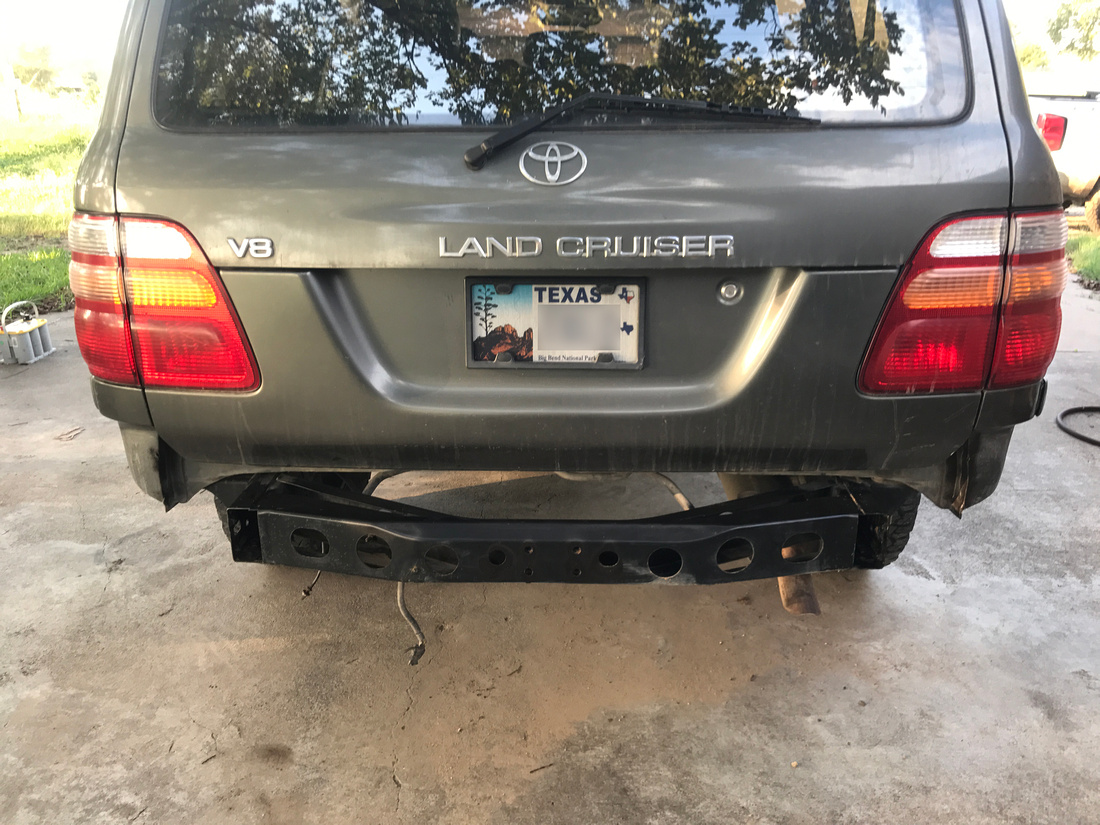

I started on the install of my Slee rear bumper. The bumper (of you want to call it that) was easy to remove. The receiver hitch should have been easy to remove. I don't know if the receiver hitch was factory or if one of the previous owners installed it (and screwed up one of the bolts). I flushed the sand and bs out of the frame rails and then when it was dry I hit the nuts with some PB Blaster. Even so one bolt wouldn't budge and the welds on the captured nut snapped. I ended up sawing it in half (yay SawZall) so I could finish removing the hitch.
I'm going to try to find a metric nut and install the bumper brackets later this week. Hopefully the bumper will still slide in with the front bracket attached.
