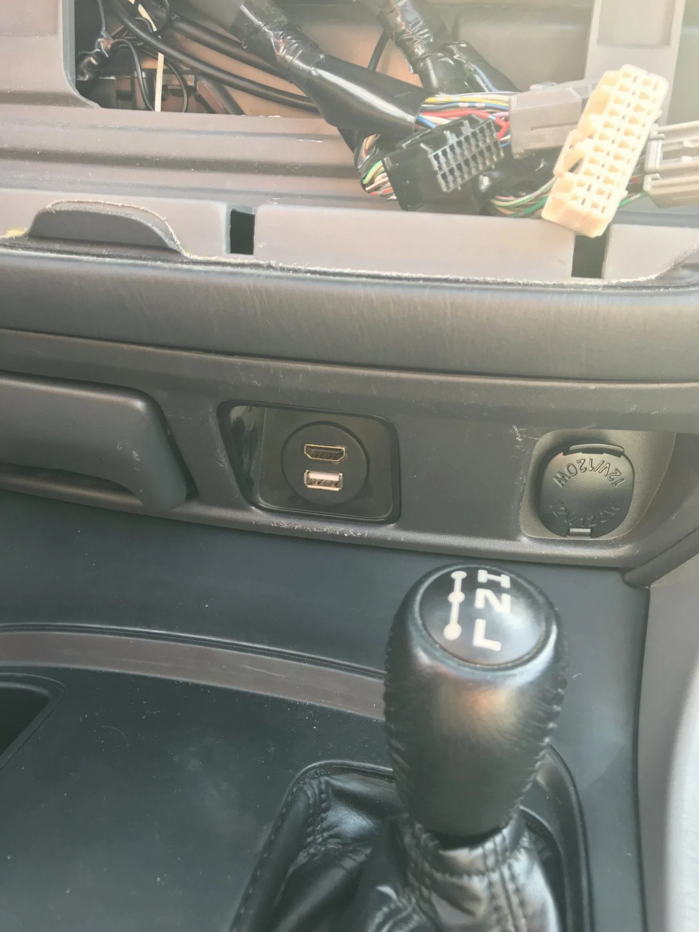

Replaced cigarette lighter socket with HDMI and USB port for my Aloine ILX-207

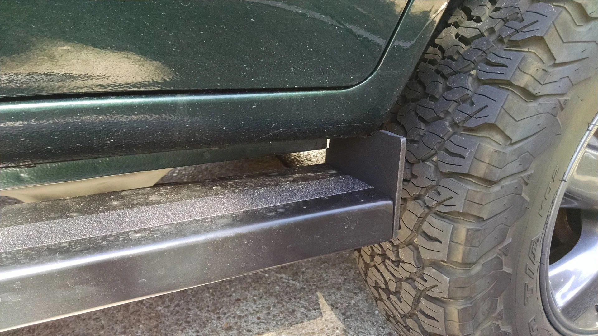

New radiator. Sprung a small leak at the top yesterday after a short trip around town. 315K before failure works for me. Getting everything together to delete AHC, install OME 2" Medium kit, put on Metal Tech sliders, and service everything I can think of to get the '99 set for a run at 500k.

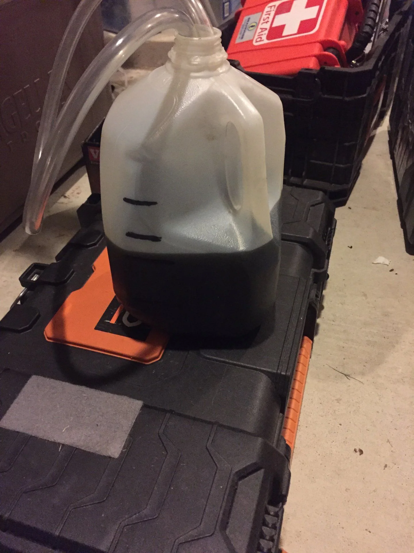

Flushed AHC. Fluid was dark brown but no froth! Looks like my globes are likely in good shape :) Thanks @PADDO for the GREAT writeup! Made things super super simple.

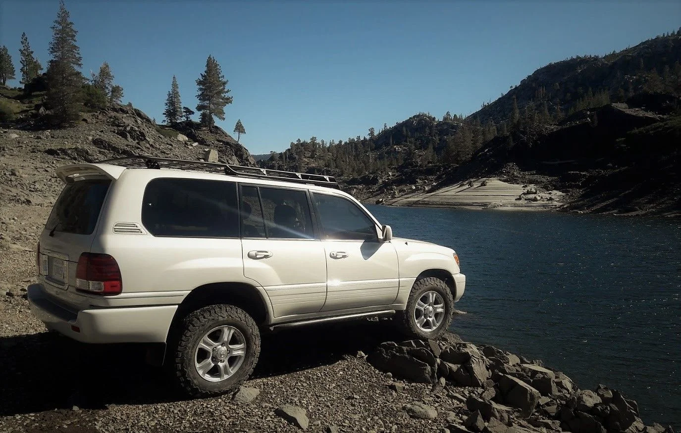

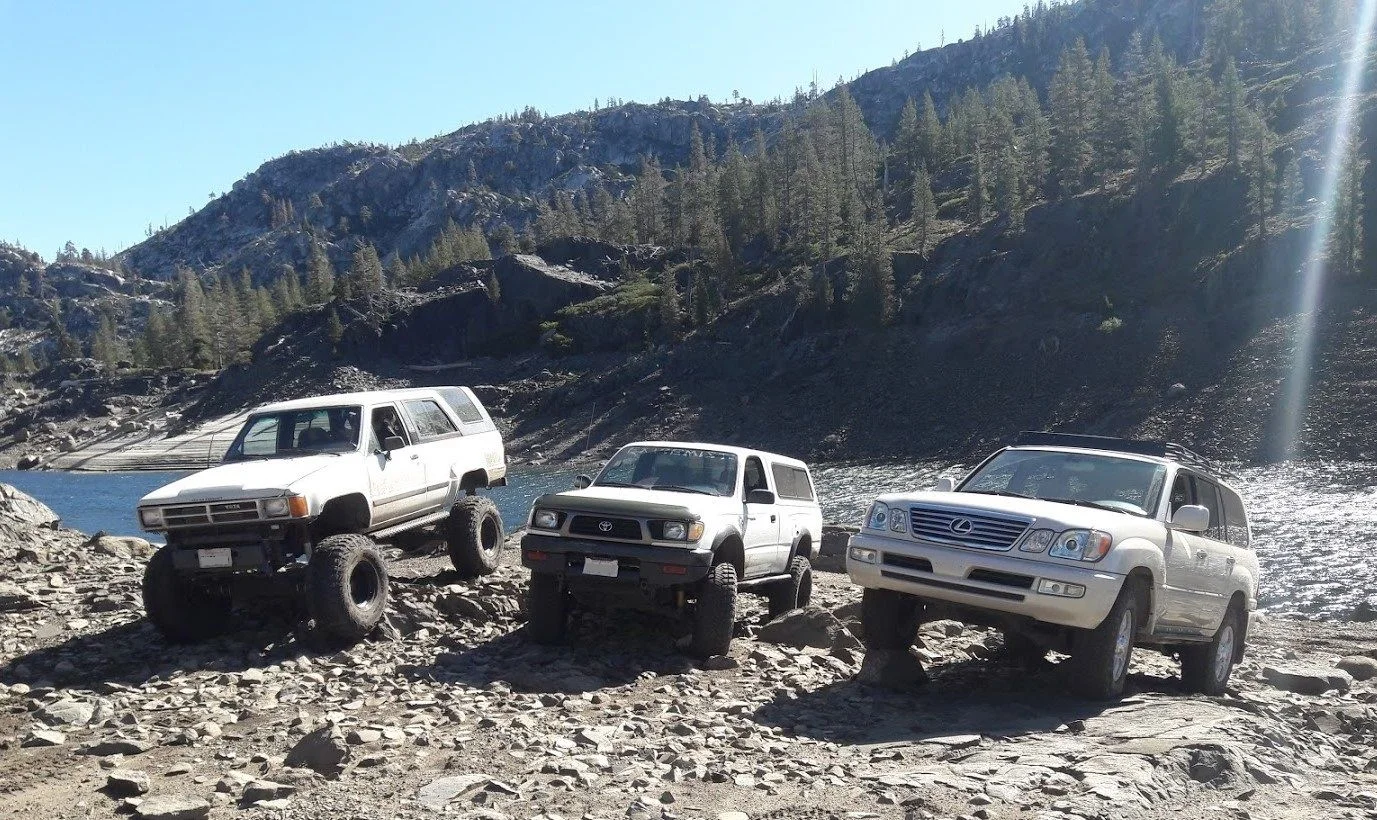

Took the trip in from Indian Springs campground up to Signal Peak Lookout and down to Fordyce Lake to camp. It was awesome and I was so impressed with my truck. It chewed up most everything I threw at it, only got a bit stuck once on some knee high muddy tree roots. Guys with me got out and spotted me through and on the 4th try it clawed right up!
Signal Peak 4x4 Trail
At Fordyce Lake:
One of these is not like the others!!:

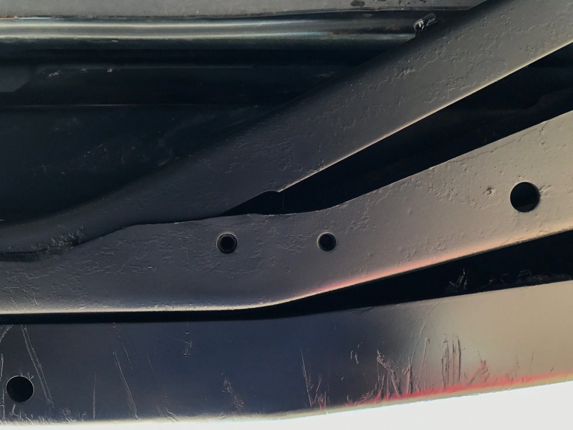

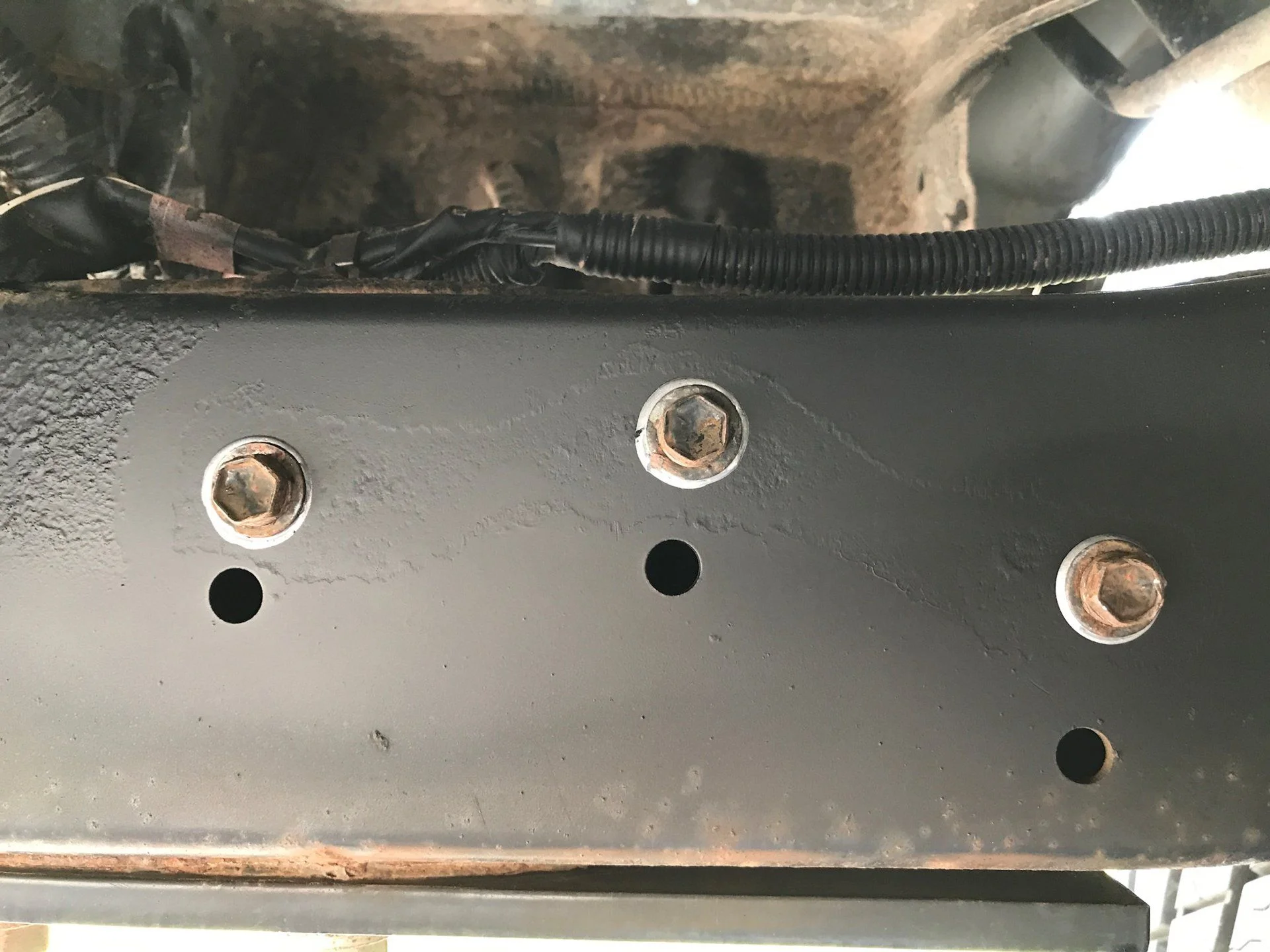

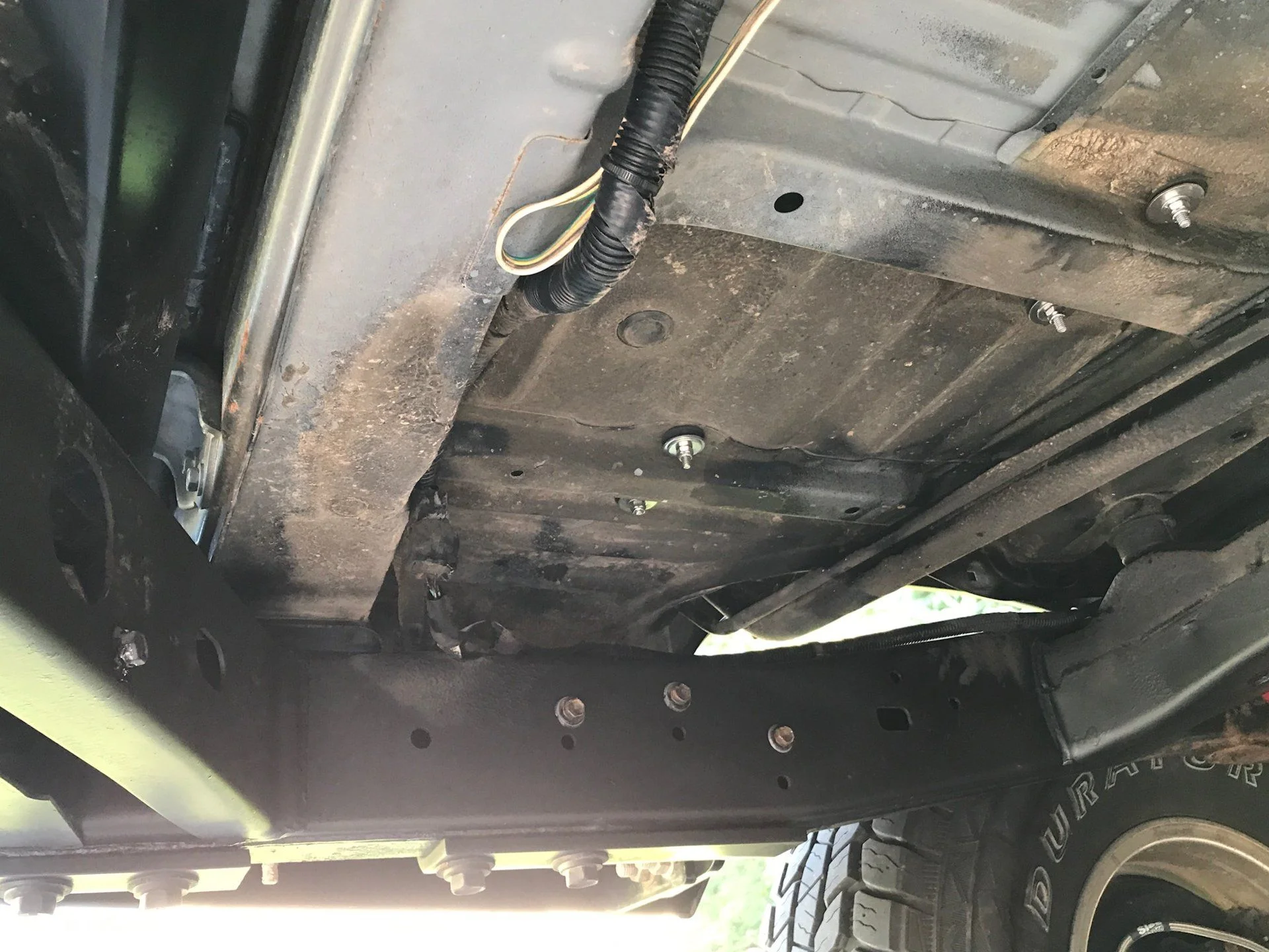

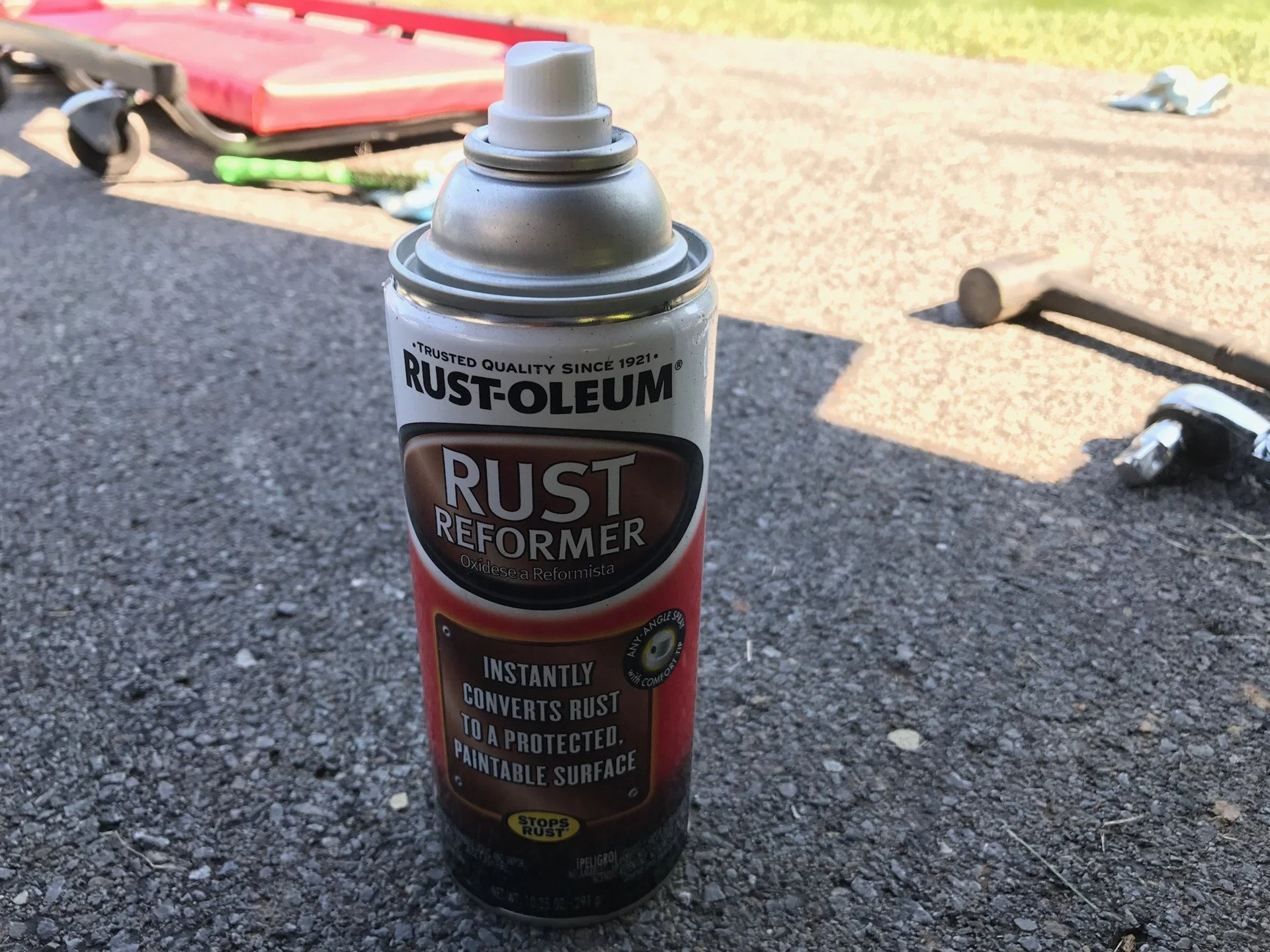

What product did you use. I need to get under my truck and get this started. Too many projects
Wire Brush on angle grinder, wire brush in hand for tight spots.....rustoluem rust reformer (no experience with this yet) and black paint. Once done removing and "reforming" some rust I'll spray liberal amounts of fluid film to keep bad salty winter stuff away from my nice metal truck. ;)
I have expert advice on the fluid film. The rest is a case of learning as you go...... I know what will happen if I don't keep on it every year. I bought the truck from the southwest so it's on me if it rots..... and I have an 11 year old buyer in 6 years when he turns 17 if he mows a lot of lawns.

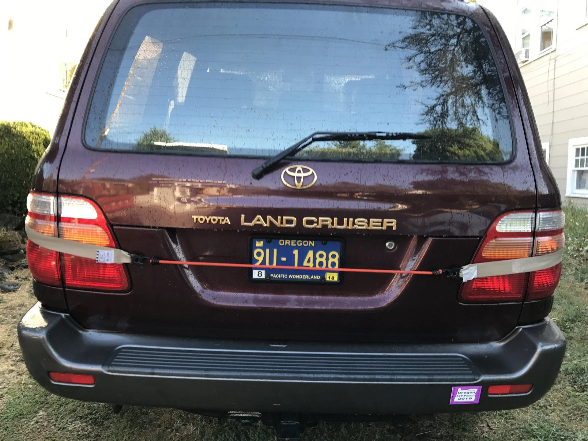

Next morning, pulled belts outside the car and around the back, held with a bungee cord, closed doors, and hosed them down:

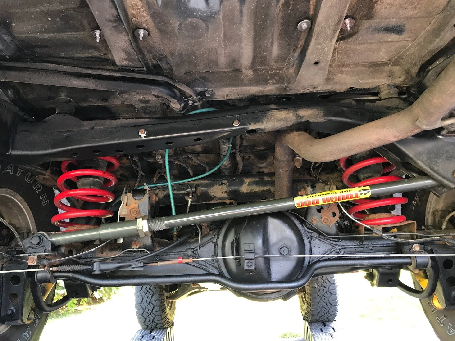

Installed new Tough Dog shocks all the way around.... And I did NOT cut holes! 45mm adjustables in rear, and 41s up front.
Thanks @reevesci! Maiden voyage tomorrow, will report back.
