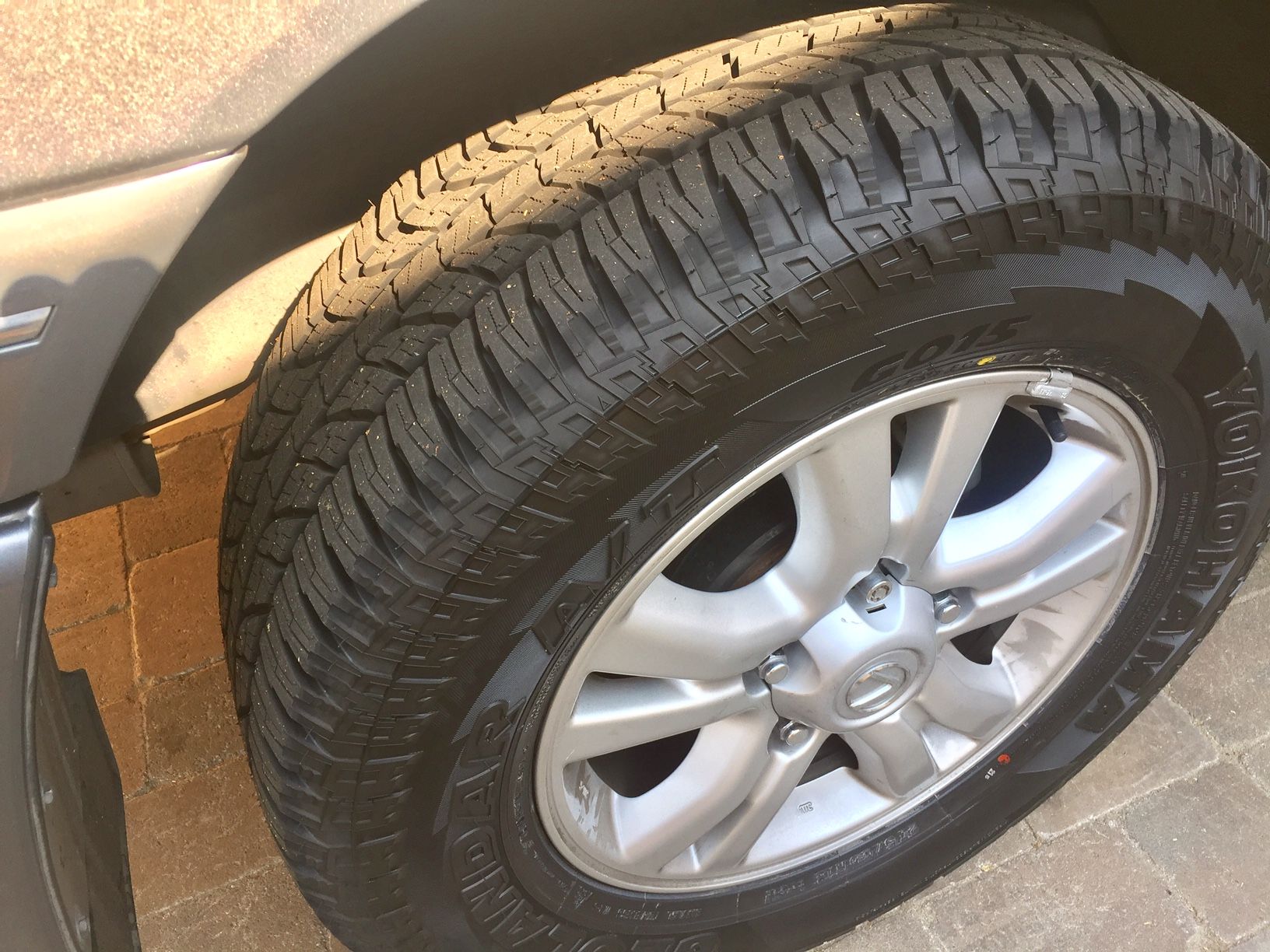

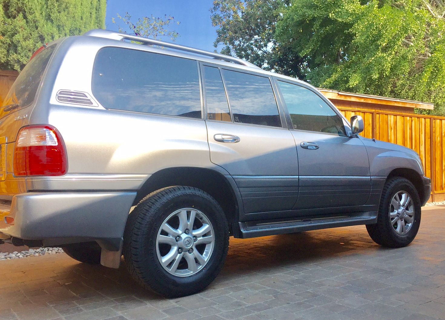

Took advantage of a Labor Day sale and installed some new shoes. Yokohama Geolander G015 in P275/65/18. Definitely not as aggressive looking as the BFG, but they look like mud terrains compared to the bald Bridgestone Alenza that were on the vehicle when I bought it last year.

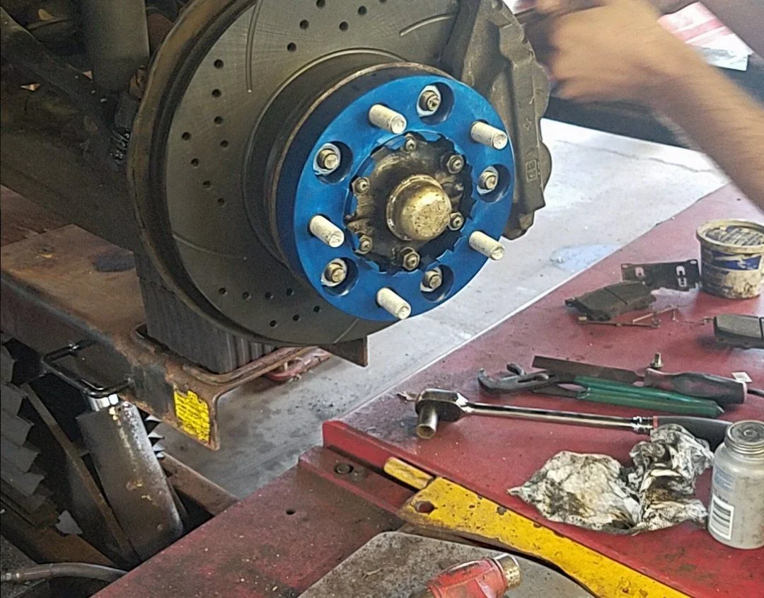

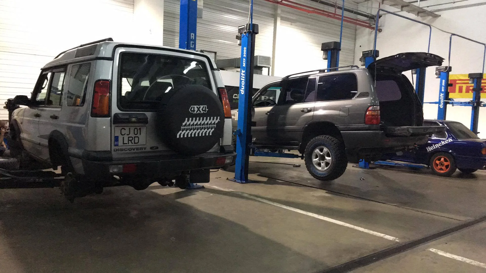

instal 285/75/r16 in my stock LC 100 2002
when is in low mode, scrach and rubbing when I turn left or right...I don't know where till I will go home to check (a friend did this for me)

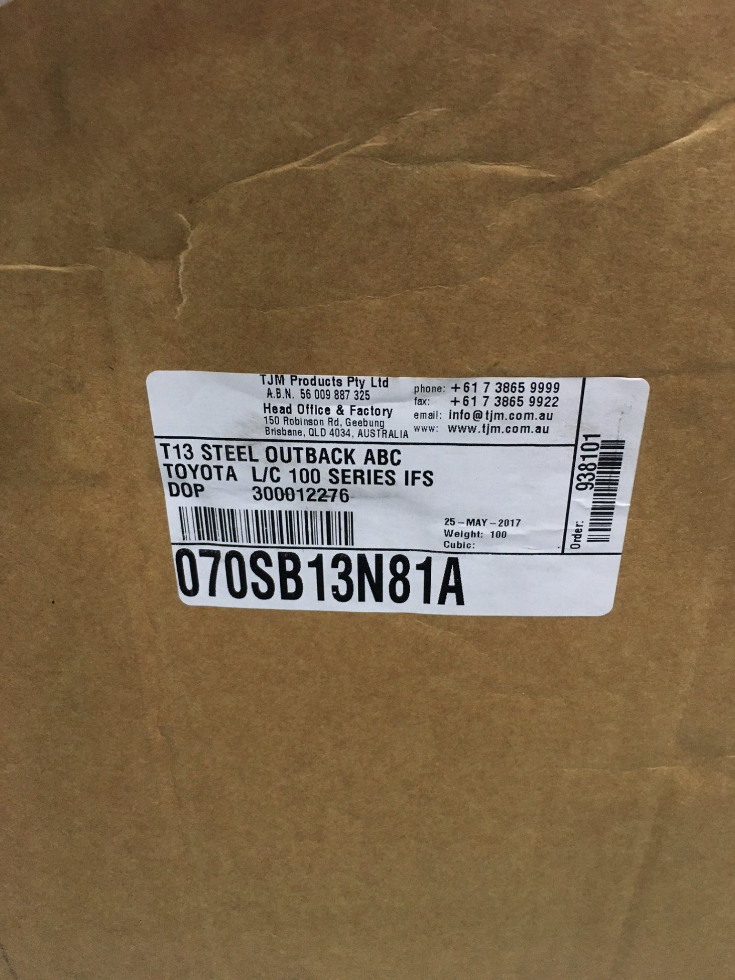

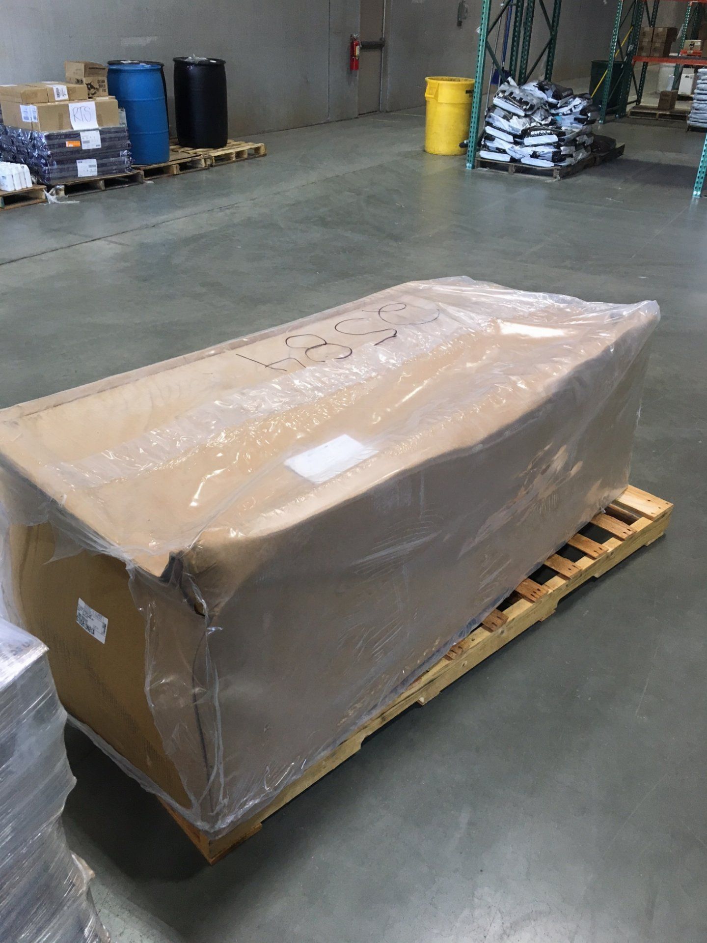

Awesome! I had the same box show up a few months ago! It was packed really well inside! I was impressed.
Nice! Anything tricky with the install, or pretty straightforward? I have an LX so I know about the grill/light tabs, but I can't remember if this one needs the frame horns trimmed, or not.

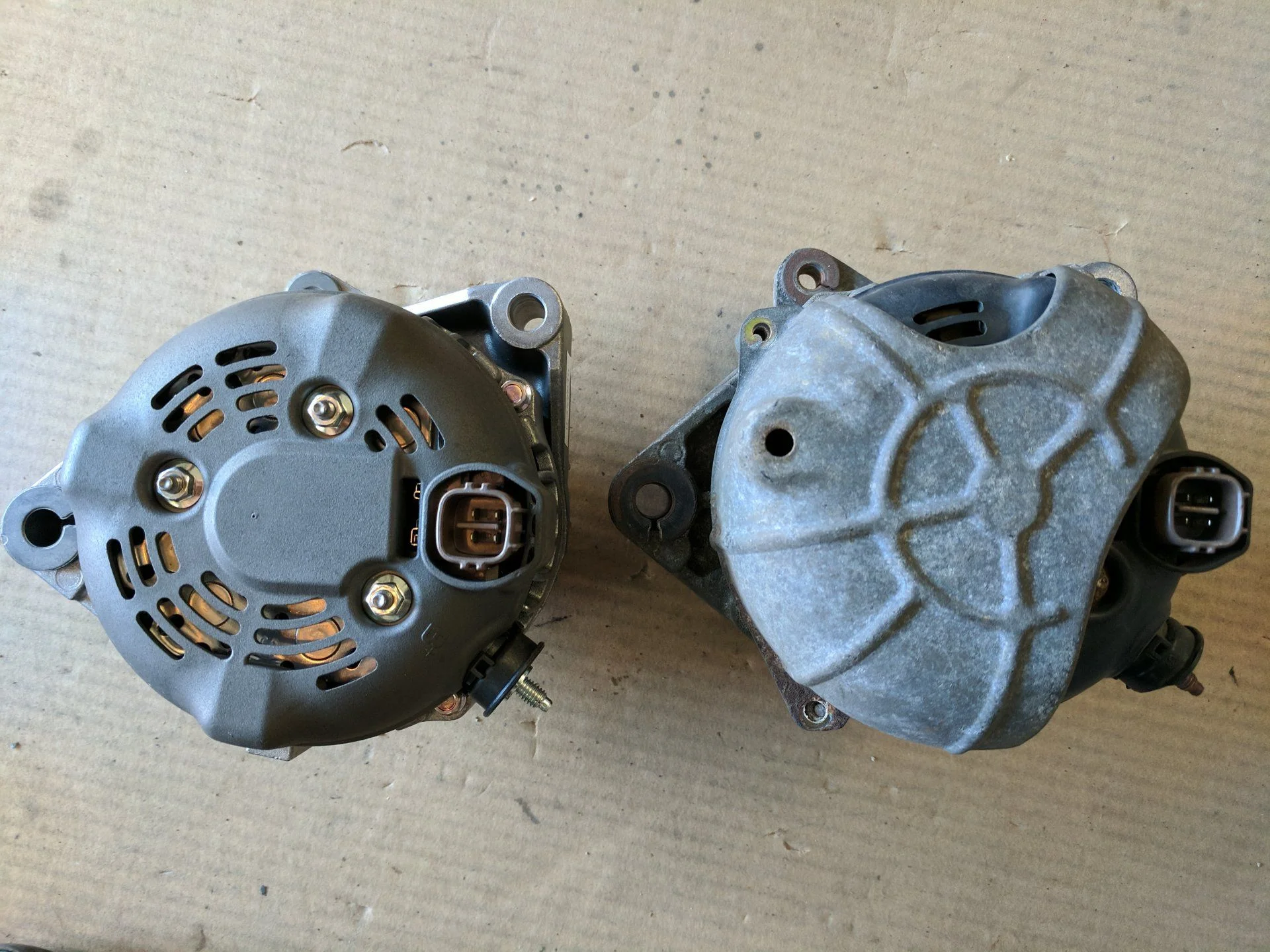

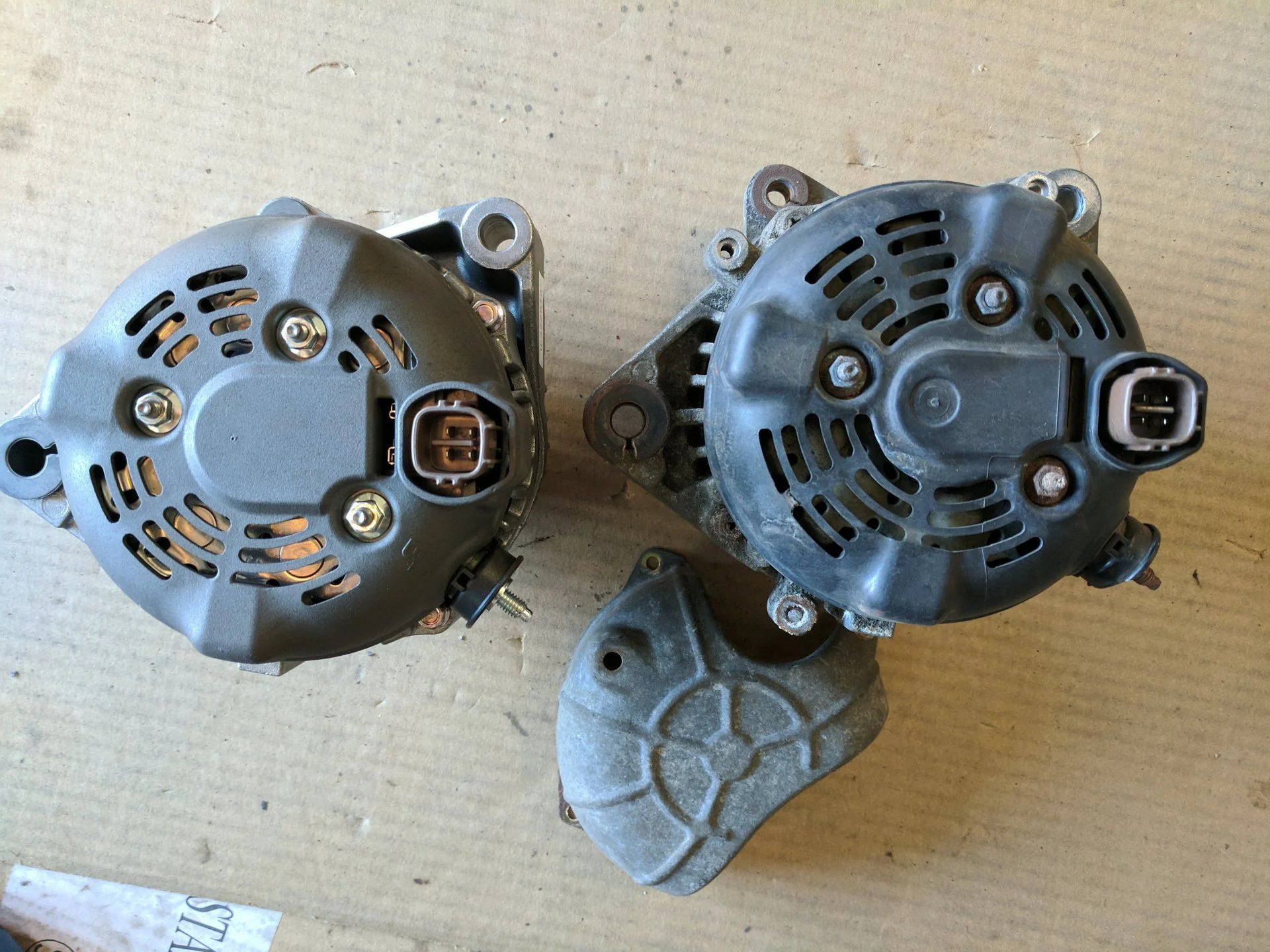

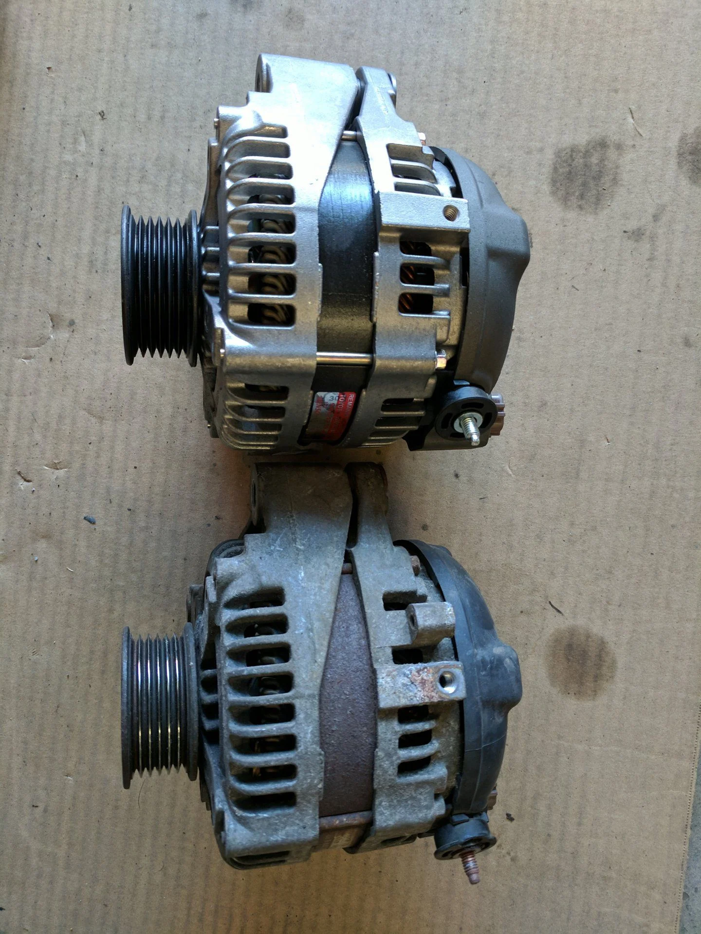

I replaced the alternator. I was having a loud whining noise from the engine bay that I couldn't pin down. Checked the charging and was barely getting 12.5 volts.
There are two different model numbers for alternators in the 2004 model year, pre and post June. Mine was built in March. Part number I had was 27060-50330. No one had that one available on Friday. So went with the later model, 27060-50360. The only difference is a shield on the back of the older model, which only seems designed to make it a complete pain to wiggle out from underneath the truck. New one went in super easy.
I have an 03 and the bar from my understanding was designed for 03-07. I was able to leave the frame horns on. It looks like you have a 2000? From others posts on here anyone who has installed it on a 98-02 model 100 , it seems they had to take the horns off. Don't know for sure but you might be in for some grinding!
Yeah, looks like I am- I need that extra half inch for the damn holes to line up! Other than that it looks pretty similar to the ARB we just installed on my brother's Tacoma, so it shouldn't be too bad.
