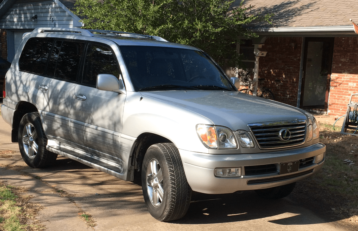

1.) Running board lift (prep for sliders, White Knuckle building them)
2.) Bracket fabrication for solar regulator mounting, decide on cable run from the panel, order solar cable
3.) Remove 2nd row seats
4.) Disable cargo door inner lock button
5.) Mount jack to rack
Before and after pics of work done over the last month prepping for vacation. I am just about tired, and ready for some R&R!
The running board lift totally changes the character, can't wait for the sliders, but I miss the courtesy lights. Thinking of rigging a cheap LED strip to tide me over til Ramathorn has kits available again.

Looks good, what size are your bfg's?

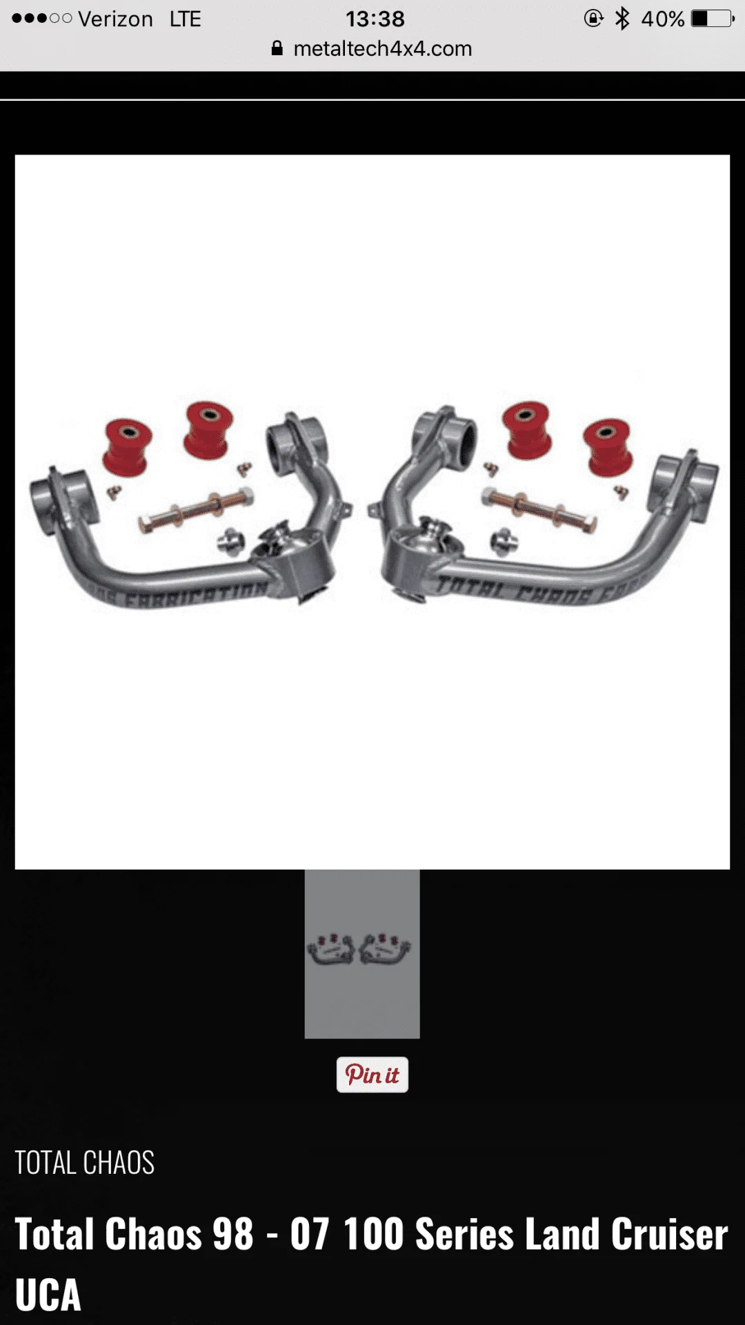

What are your caster range/limits with Chaos UCA?
Phil- I saw your post that you got 4.5 degrees of caster on your LX with the SPC UCAs- I am running 275/70-18 and my tires rubbed the backside of the wheel well (plastic guard) with settings at 3.2 degrees. Curious about your set up as I would like to set my SPC's to give a bit more caster with out the tire moving closer to the back of the wheel well.
