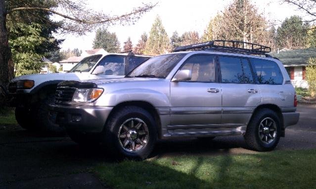

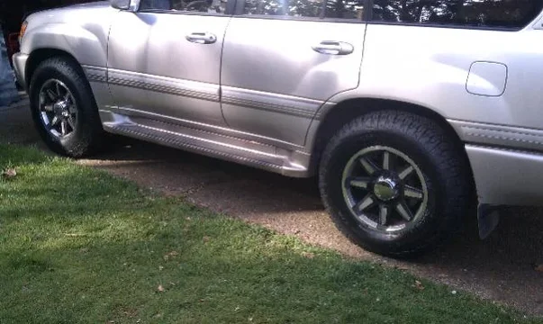

New shoes. 275/70/18 BFG Rugged Terrain.
I used the FAQ about rebuilding the MC to do just that and bleed the brakes. I may try bleeding one more time to be sure. The pedal is much firmer and no more 2 pumps to get the pedal firm. It took a few hard stops to get the brake and ABS lights to go out. I replaced the radiator original at 173K and 2 front end hits. I also flushed the cooling system and replaced all the hoses and the heater tees. One T looked brand new, one had some erosion on one end. They were not brittle and survived my brutal assault to remove them and the hoses. Quite a bit of satisfaction at the work.:)

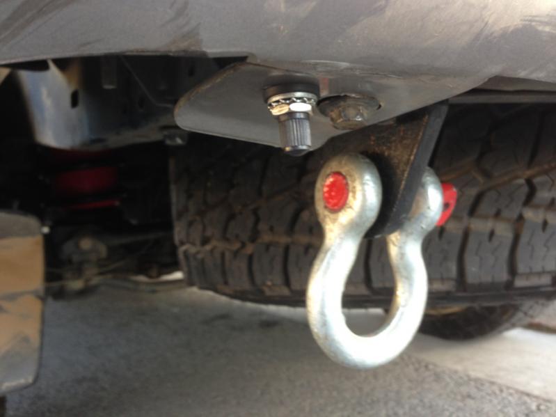

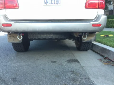

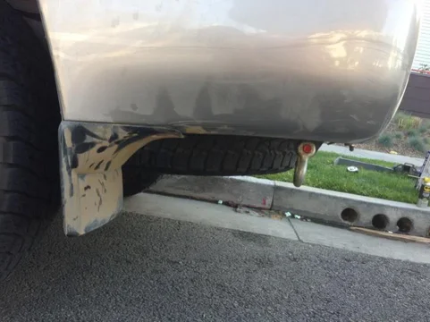

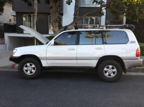

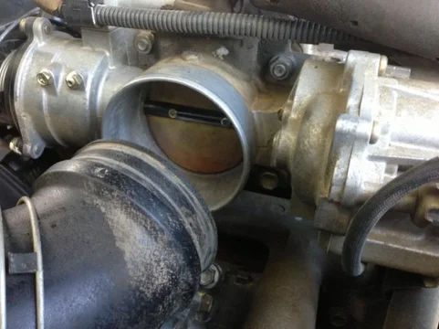

So far this week I've installed air lift 1000 (nothing like lifting your truck with a bike pump), removed the trailer hitch, raised the spare tire (295/75/16 fits with ease now) but I think it can go another inch higher, started reinstalling the dual battery system and Ham radio, installed cross bars on the LabRak, installed Spressomon's recovery brackets in place of the trailer hitch, cleaned the throttle body and MAFS (both were very dirty).
Hopefully that, the 0W30 and 75w90 Mobil 1 synthetics, DT headers fill help with the recently terrible gas mileage.
I wouldn't suggest leaving those shackles on the truck while DDing. For one, you will look every goofy J&&p guy in town with fuel cans, hilift, etc. mounted on the truck in the parking garage and more importantly, the shackles will become hard to get off when are constantly exposed to the elements and typically you need to remove a shackle when you use it...just an observation.
have you tried lowering your spare in case you need it? I returned my 295 to the OEM location since it was very difficult to reach the crank... I'll be getting a 255/85/16 for a spare...
I may also get a 255. Right now I haven't altered the crossmember. I just removed the rear bar and flipped the front bar over.
I had trouble getting to a friends spare when they did the lift mod. 1" seems like there would still be some room to slip the spare tire rod in. We'll see. If now. I'll run it stock and move the swing out rear bumper higher on the build list. Right now the tire still seems very vulnerable, especially without the trailer hitch there to protect it.
Mind your own business :p. They're on because I had to make sure I could get the shackles on and off with the hook in place. Left them on to make an expo approved picture.
