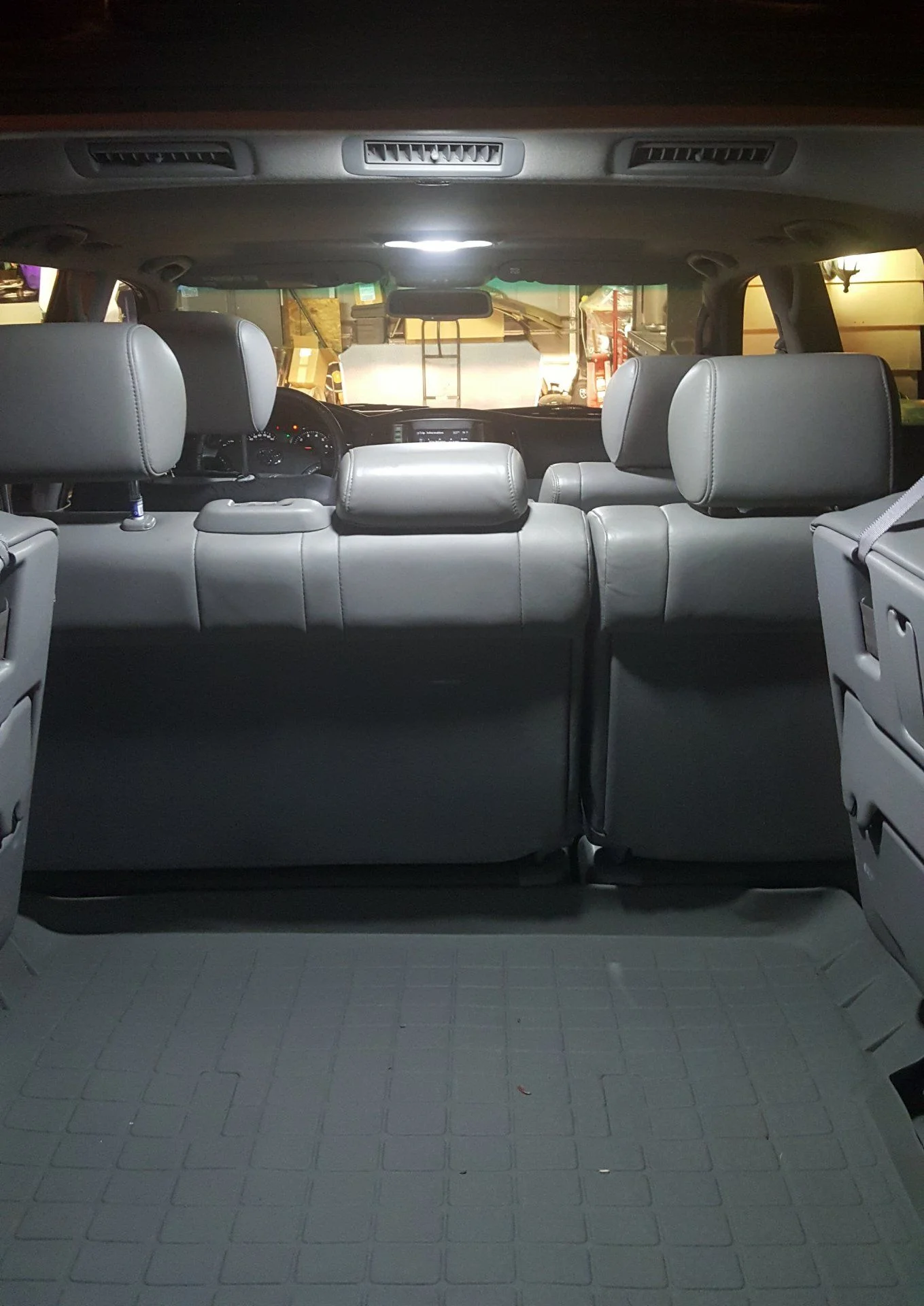

Pfrans interior LED kit and replaced the oxidized wiper arms and blades.

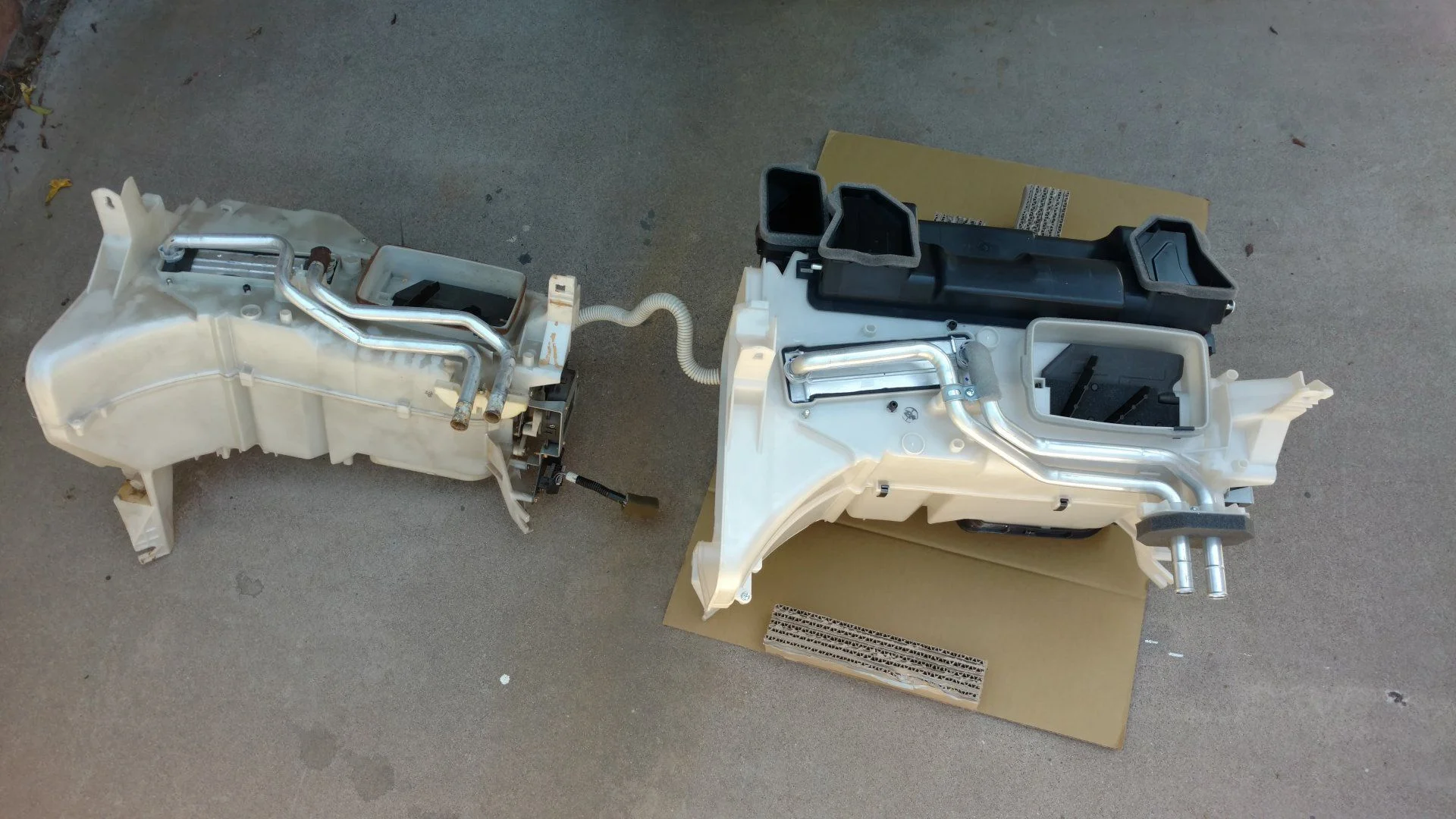

PO did not do maintenance... This was a mild PITA, and I used no beer.View attachment 1441856
Serious question (no serious, and don't call me Shirley). What type of maintenance? What went wrong? B/c . . . well, you know, I'm always looking for more PM.

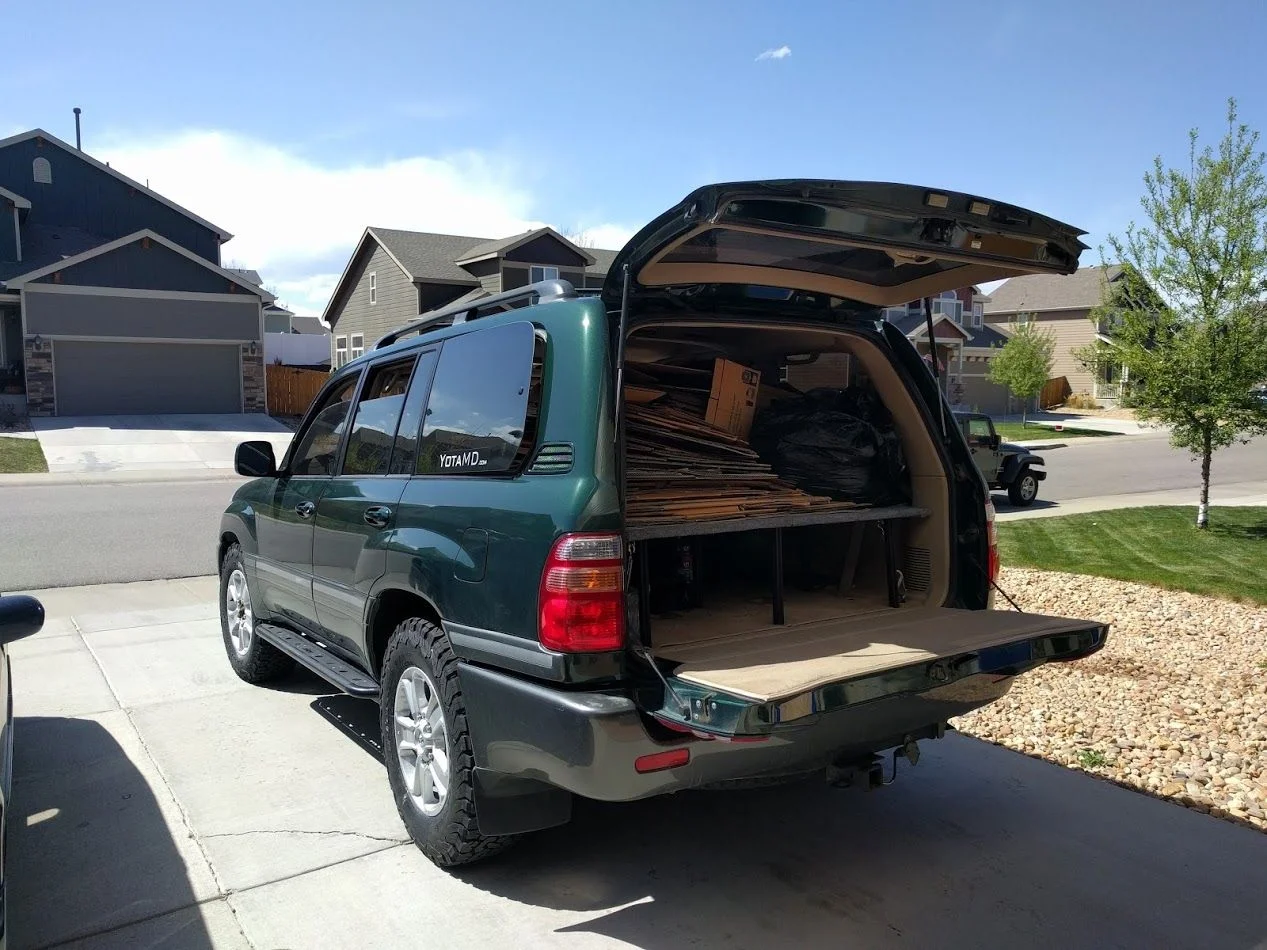

The platform system has been on "work" duty for a while and today was no exception. Post-move box drop-off load up.

Wow, good idea. How do you hoist the tent on top?
I have a front runner tent... Light for the most part at 90 lbs. I can muscle that up but had a friend helping out today. The other option would be to use two cushions from the outside patio seats leaned against the body of the rig with the tent against it and just push it up. It would definitely be a harder task working with a heavy tent. I can take off my tent in less than 10 minutes
Previous owner had not changed the engine coolant in probably 15 years. Or they just used water. Lots of rust developed and destroyed both heater cores, and one of the air mixer servo's. Consequently, I am changing out the entire coolant system

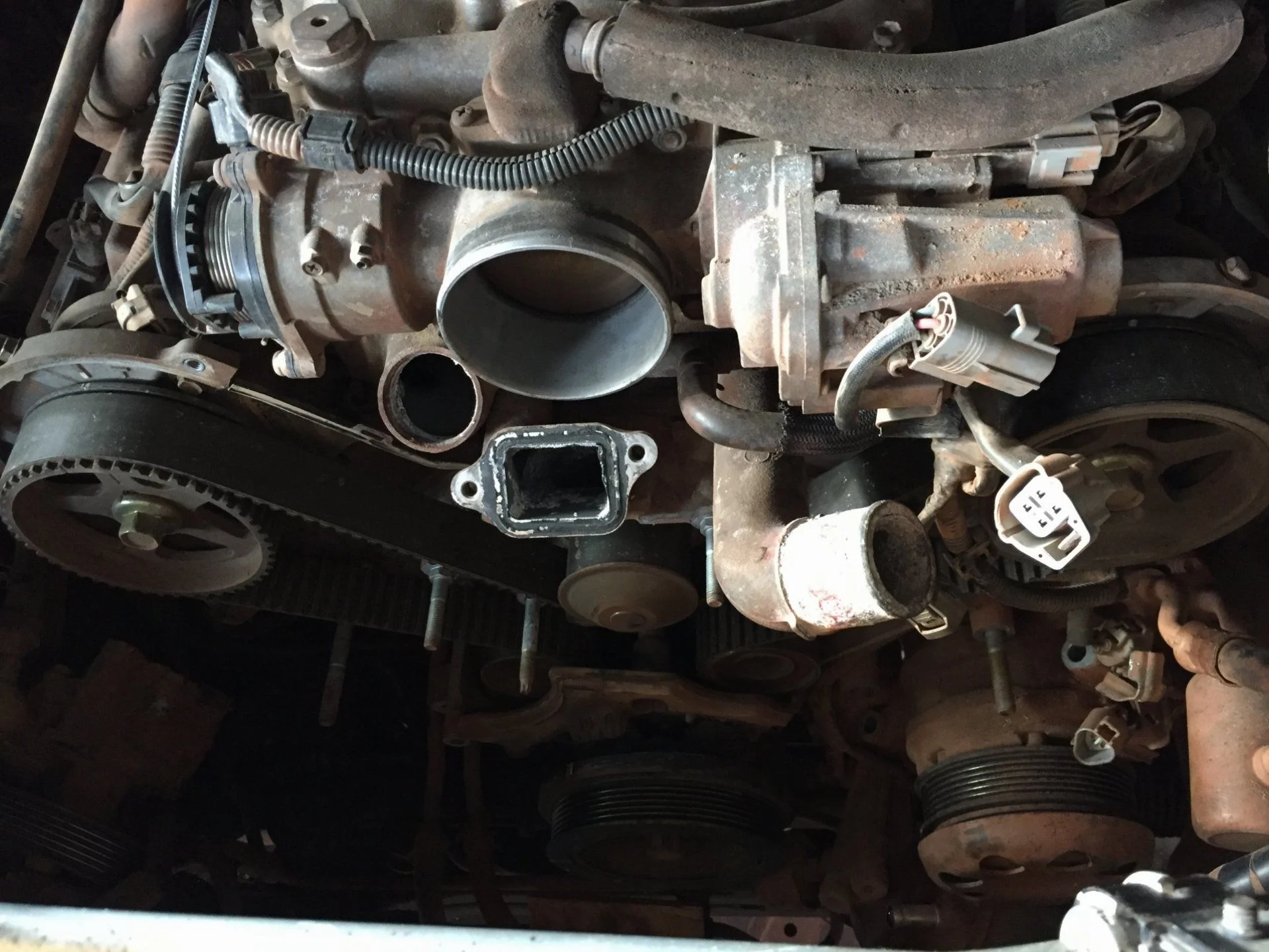

Busy with timing belt an while i am in there the bearings and waterpump etc.
the cam and crank pulleys dont allign. Keep rotating till the allign?
