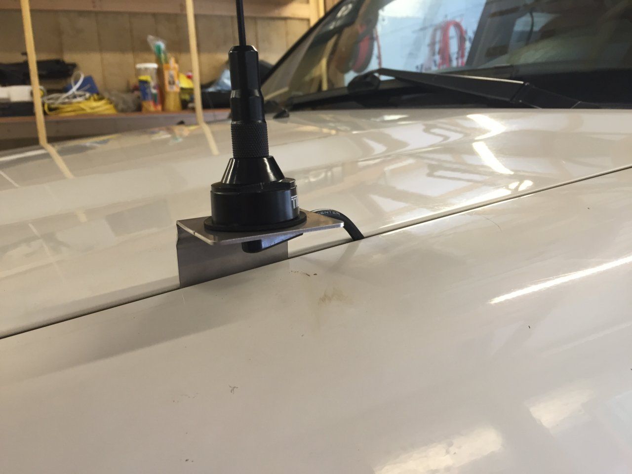

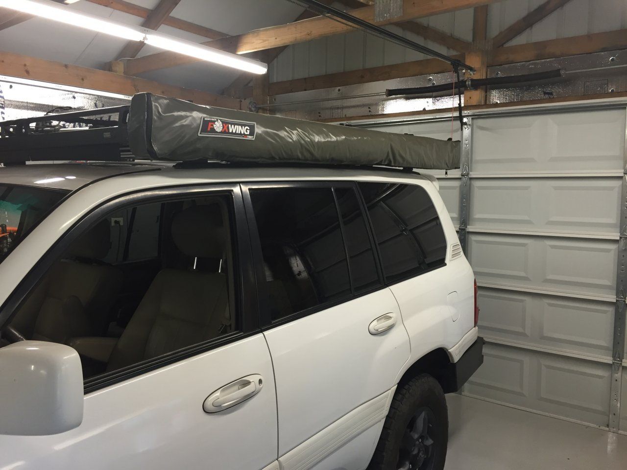

Added a fox wing awning and gamiviti antenna mount
Both inspired by seeing them at HiH

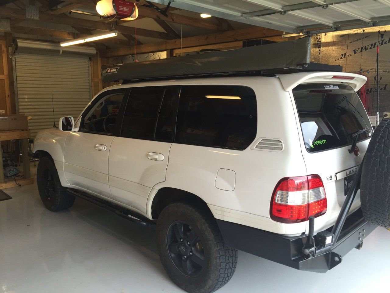

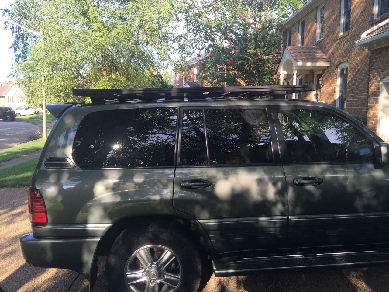

I received my LabRak roof rack this past week and got it on this weekend! I had some problems installing it and Shane WAS helpful in making sure I was satisfied. Now I'd just like to get some use out of it before summer ends!!

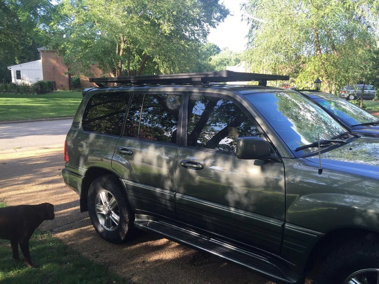

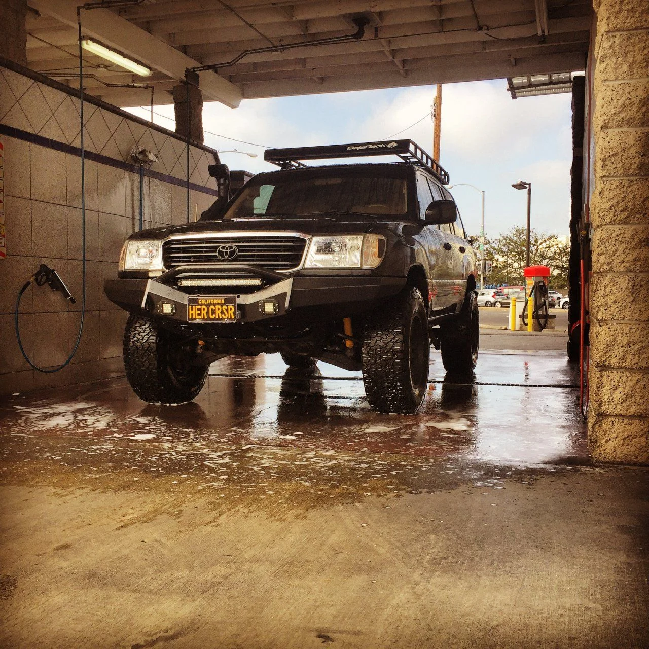

Gave her a much needed bath and removed my light bar. Had it mounted under the front of my Bajarack. Looked amazing there, but the 1/4" on the top and the bottom of the bar created a pretty annoying whistle at 65 +mph

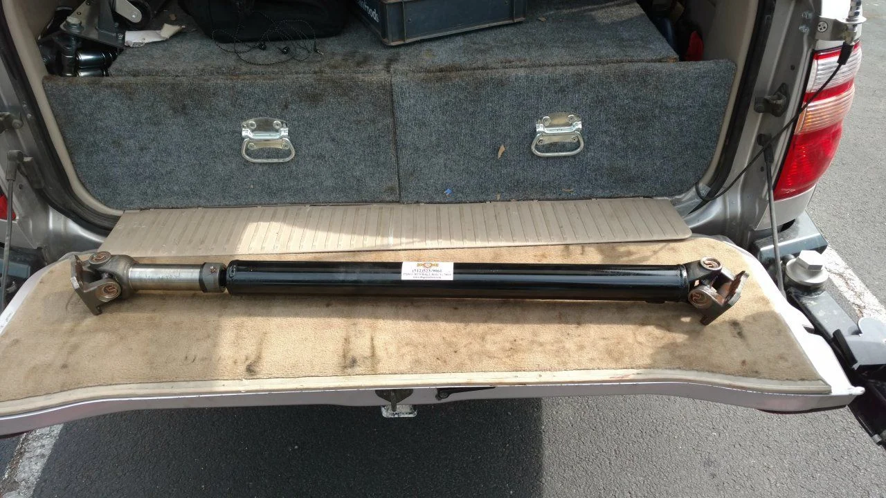

Also installed a custom Spicer 1310 rear driveshaft. All shiny and new, end to end.
1310 u joints are easier to source and replace. They're considerably stronger too. Most modern domestic pickups run this joint.
Interested in your work here: what are your lift specs? While the prop shaft was off did you happen to measure your pinion angles and make any adjustments?
Why the new spicer prop shaft, OEM not repairable? Edit: I just read your build thread and got my answer.

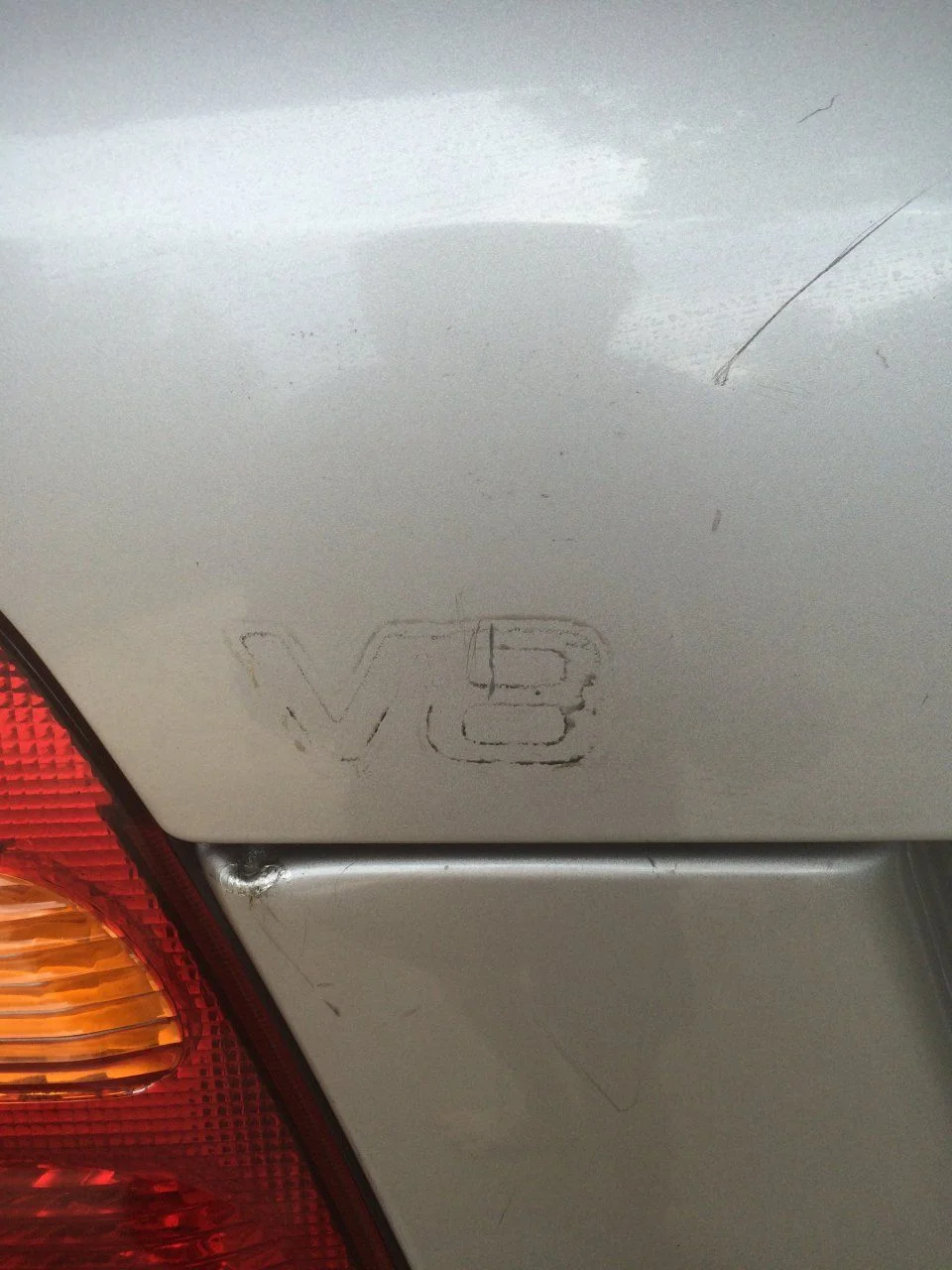

I attempted to remove the rear emblems after a bad plastidip job and there is a ton of residue. The paint is also scratched up any suggestions for covering it up or any cool ideas for new emblems? I thought that metal ones instead of the plastic ones may look cool depending on if someone could fab them up.
Just wipe over the residue marks lightly with thinners. Should come right off. Then wax.
