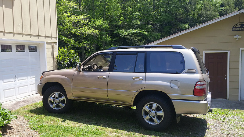

Cranked up T-bars to level out. Raised 7/8" with 4 turns on LH, 5 on RH. Now I need to put the drawers back on to see where I stand! Without them there I'm 1" higher on the back r now.

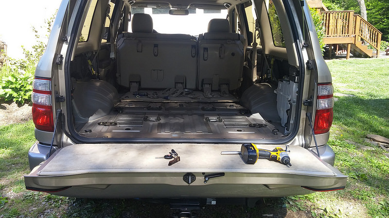

Yanked my running boards off (even though mine were aftermarket and not as ugly as the OEM version). Raised the front a littl earlier this week so it sits with an inch of rake then had it realigned. Removed the back carpet and cleaned about a pound of sand out. PO obviously enjoyed the beach. On the upside I found my OEM sub was replaced with a Kicker CompRT 6.75" microsub. Just need to wire an amp up to it.
Before:
After:
Carpetless:
