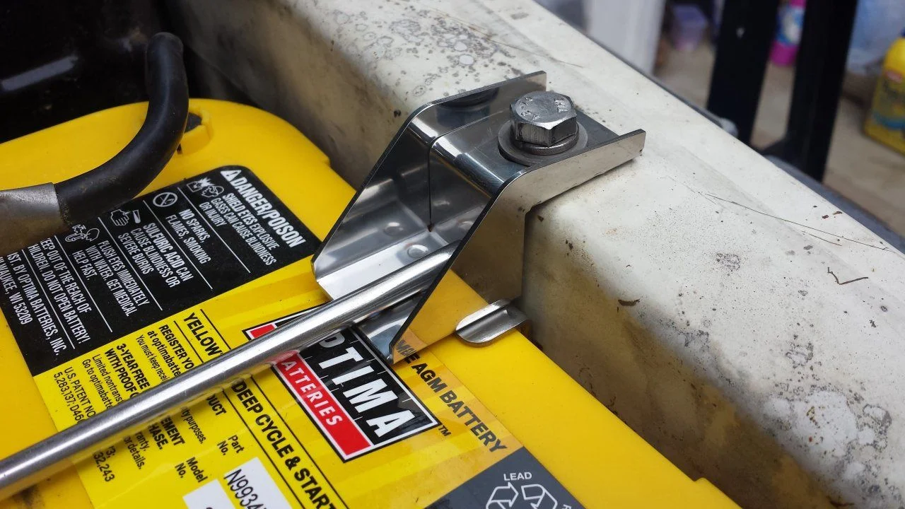

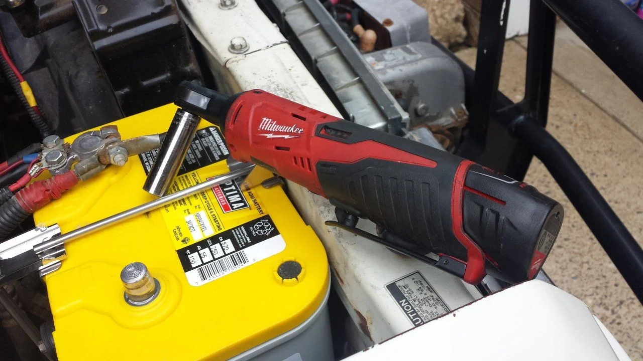

I had to get the proper holddown for my stainlesstrays.com battery tray. Used my cordless Milwaukee 3/8 ratchet to make short work of it. :)
Those Milwaukee cordless tools are pretty great...got a drill driver set when I did my oil pump & crank seals...absolutely couldn't have done it without it
^^ Agreed, I would be lost without my Milwaukee cordless impact.. Don't leave home without it either.

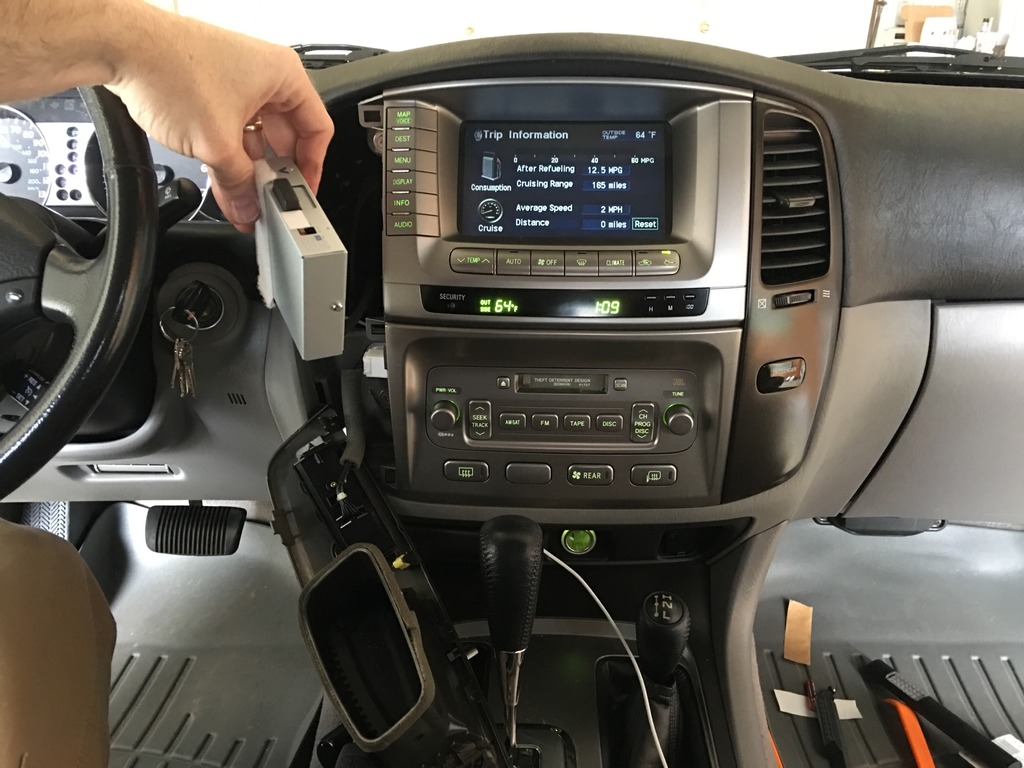

Got around to installing that VAIStech SL3b unit to play music from my phone.
Pic 1: The head unit is easy to pull. I used a set of those orange trim tools from Amazon to get the vent pieces pulled out, then 4 10mm bolts to pull out the head unit. Easy.
Pic 2: The wire has 3 plugs, 2 male/1 female. Very easy to figure out.
Pic 3: On LC's use the 12 pin plug where I'm pointing. Lexus version uses the 20 pin plug that's 2 plugs over from the right of my finger. You have to request the right wiring harness when ordering from VAIStech, they're easy to work with over the phone.
Pic 4: There's a flat spot between the driver side vent and dash gauge cluster. I used a 3 inch piece of velcro. This spot worked out well when I had to open it back up and reprogram the VAIStech unit.
Pic 5: I ran a short iPhone usb plug through the ashtray for recharging. It has no affect on the control of music, it only uses bluetooth for that.
Pic 6: I chose the wrong emulation mode when I first set it up. It worked initially, but after I restarted the LC, it was playing my iTunes music and a CD from the changer at the same time. This pic shows how easy it is to pull the driver side vent piece and reprogram if necessary. The white strip under my thumb is how much velcro I used, probably overkill, but it seems to be holding well.
This was a very easy mod. The worst part was dropping a head unit bolt in the dash and trying to find it. I didn't, so 3 head unit bolts will have to do for now. The bluetooth picked up immediately and switching from iTunes playlists and Spotify is very easy. Steering wheel controls will change the song within the playlist. I have very little music on my phone, so I'm not sure about changing playlists. The head unit will show the name of the song, but my audio info won't stay on very long before it goes back to showing mileage/mpg stuff. It's not that important to me anyway.
