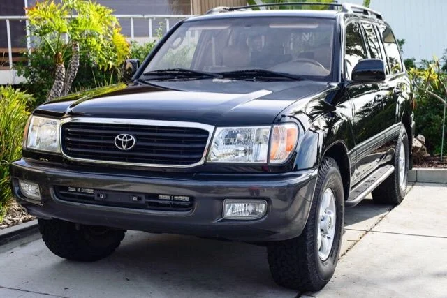

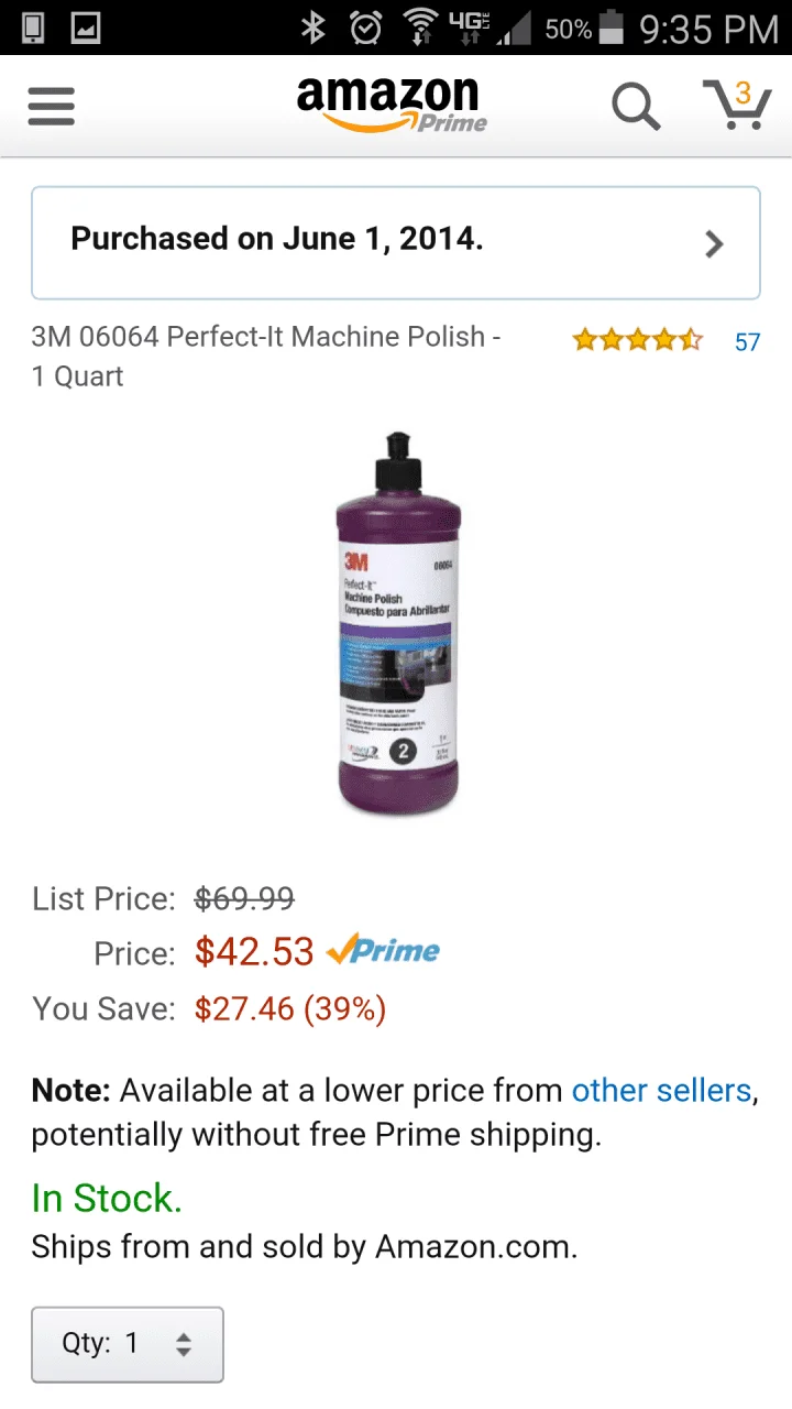

^that^ looks really good. Nice work! What type/brand polisher and pads do you use?
As long as we're talking DA's, I've really liked my Griot's Garage so far. I had great results on my old STI and so far so good on the black LC. I haven't done much research on compound brands as I usually end up with Meguairs 105/205, but I think I end up with varying grades of Lake Country pads if I remember correctly.
If you can spare a weekend of your time, your LC will never look the same! One of the best investments I've ever made.

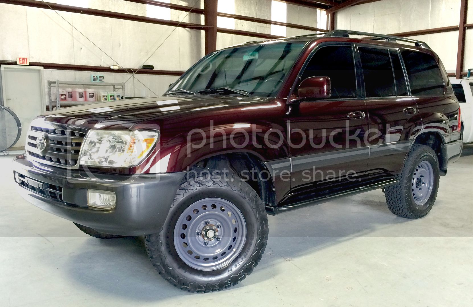

I thought my 100's paint was in good shape. A friend in the detailing/chemical business showed me what was going on via a bright light - millions of "micro-scratches".
He asked: "You've been using terrycloth to dry it haven't you?"
Me: "Uhh... is that bad?"
Him: "You tell me"
He said all those scratches - although basically invisible - refract, break up... kill the reflecting light. That equals less shine.
Several hours later...

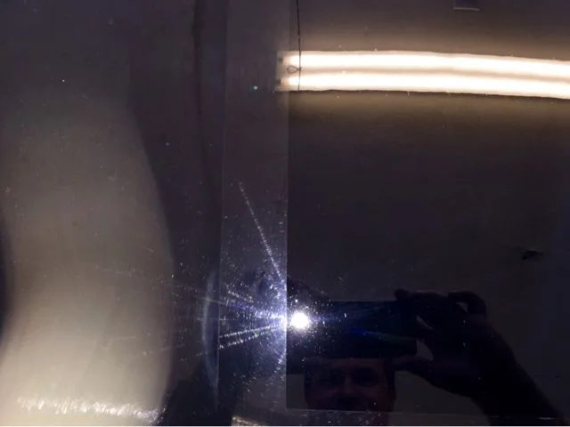

It's hard to capture with a camera/monitor... but the before and after was pretty damn impressive. I regularly got comments on the 100 - the paint looks great for X miles or X years, etc. "is that new? kinda stuff.
The "before" didn't seem that bad:
So, when i saw the "after" - and how the paint looked like wet fingernail polish, I was blown away:

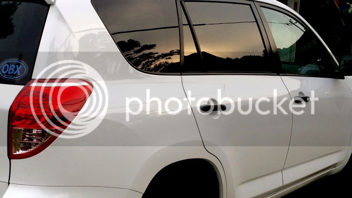

My 100 was done with a rotary buffer - a four-stage process, e.g. Cut-1 (mild compound), Polish, Swirl (very fine polish to eliminate swirls and holograms) then coated. The guys showed me how to do it, and I decided to tackle my daughter's Rav4... They made me promise to do a tape line so they could see the difference
I did the first three stages on one side of the hood to see if it'd be noticeable.
Then, redid the hood and the rest of the car. It made her 10-year-old car look new. And, as a bonus, she thought her dad was pretty badass... for a day or so.
Here's my obligatory 50/50 shot, and the finished product. I have settled on the Meguiars microfiber system for my 100, with a Porter Cable 7424.
