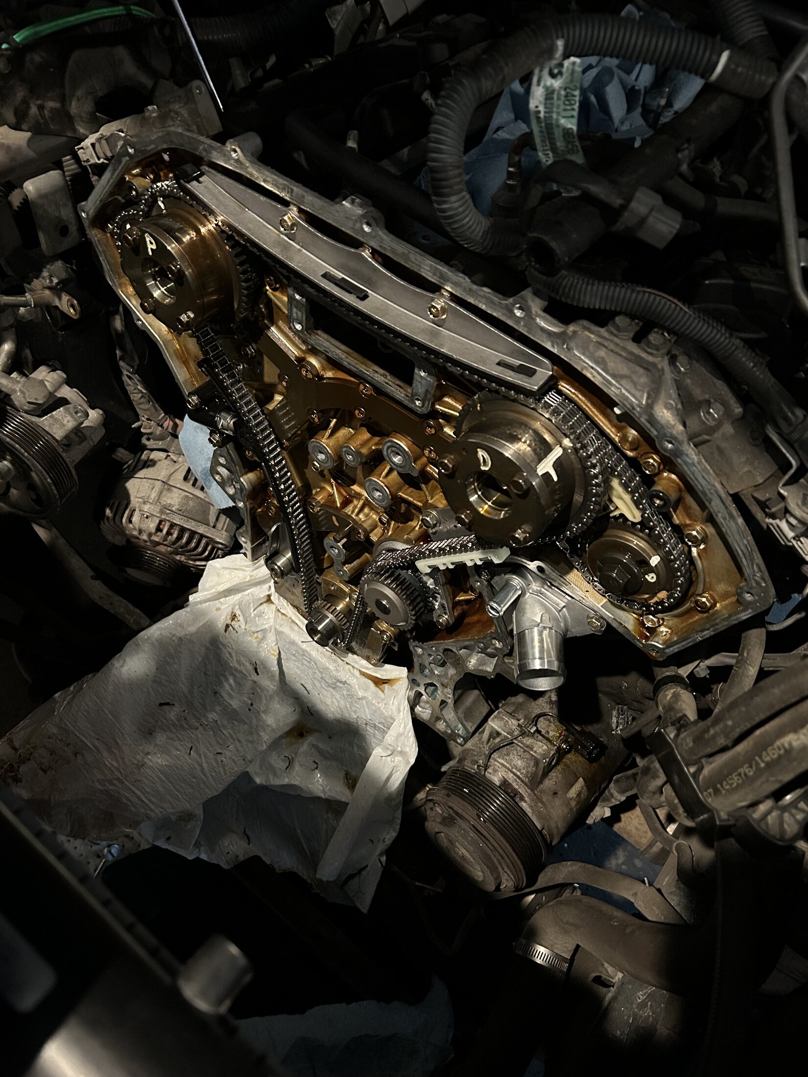

I miss working on the cruiser. I am putting new timing chains in my pathfinder. 14 hours in and finally going back together.

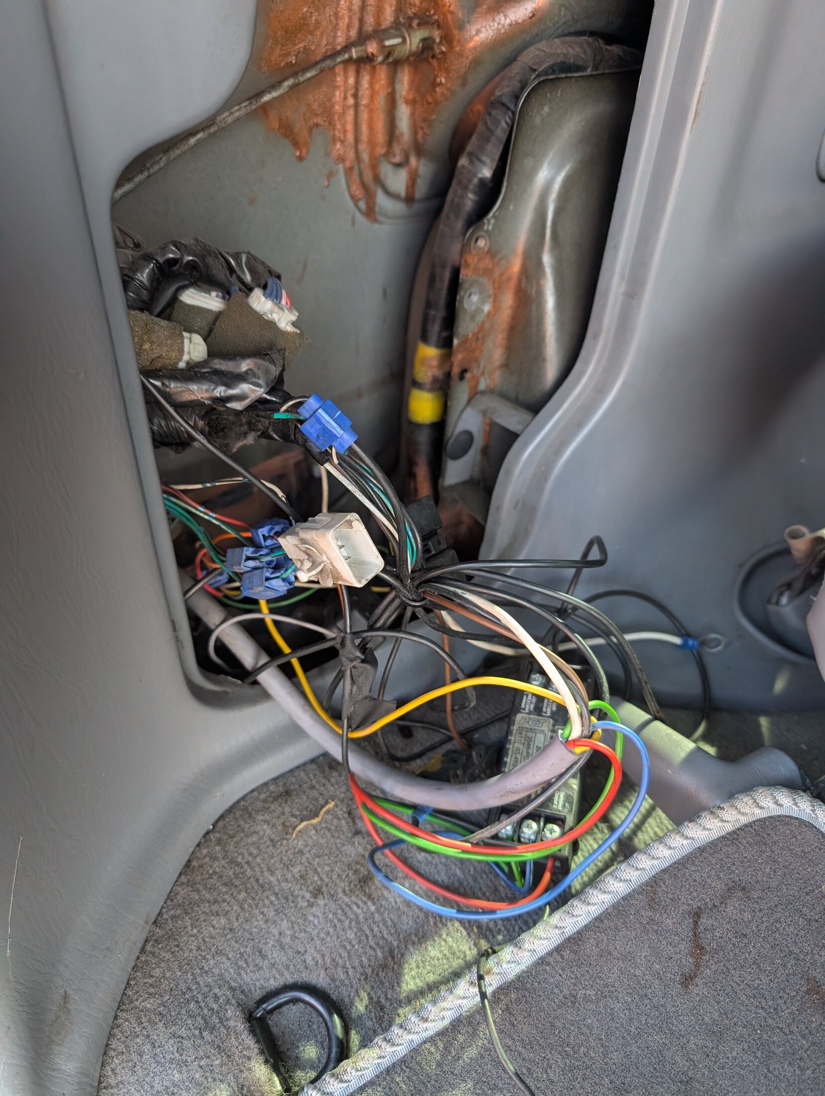

—aftermarket backup camera added
—attempted to add GROM BT3; turns out that even though the nav units for the US and JDM models look really similar, they have VERY different connectors….

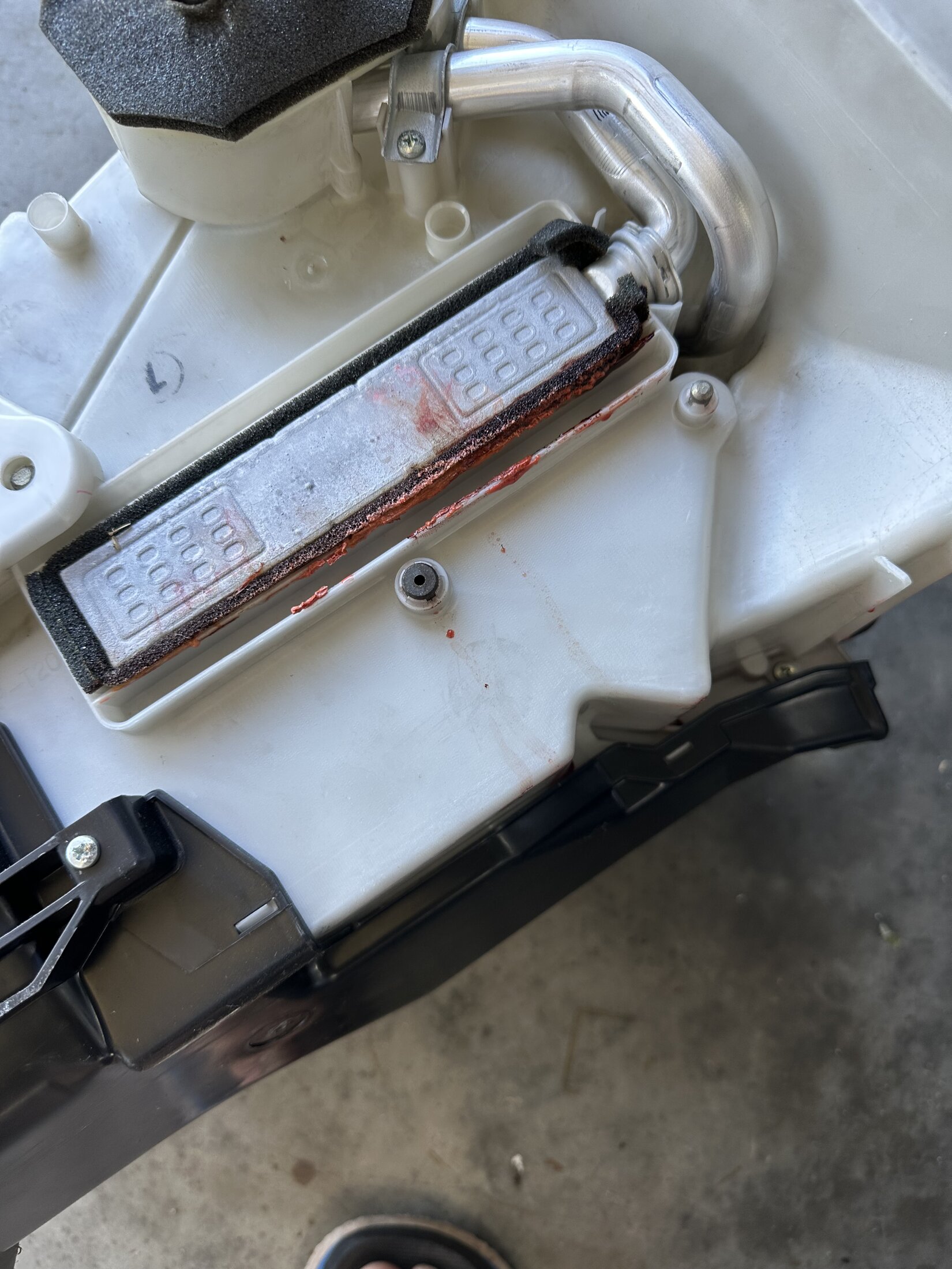

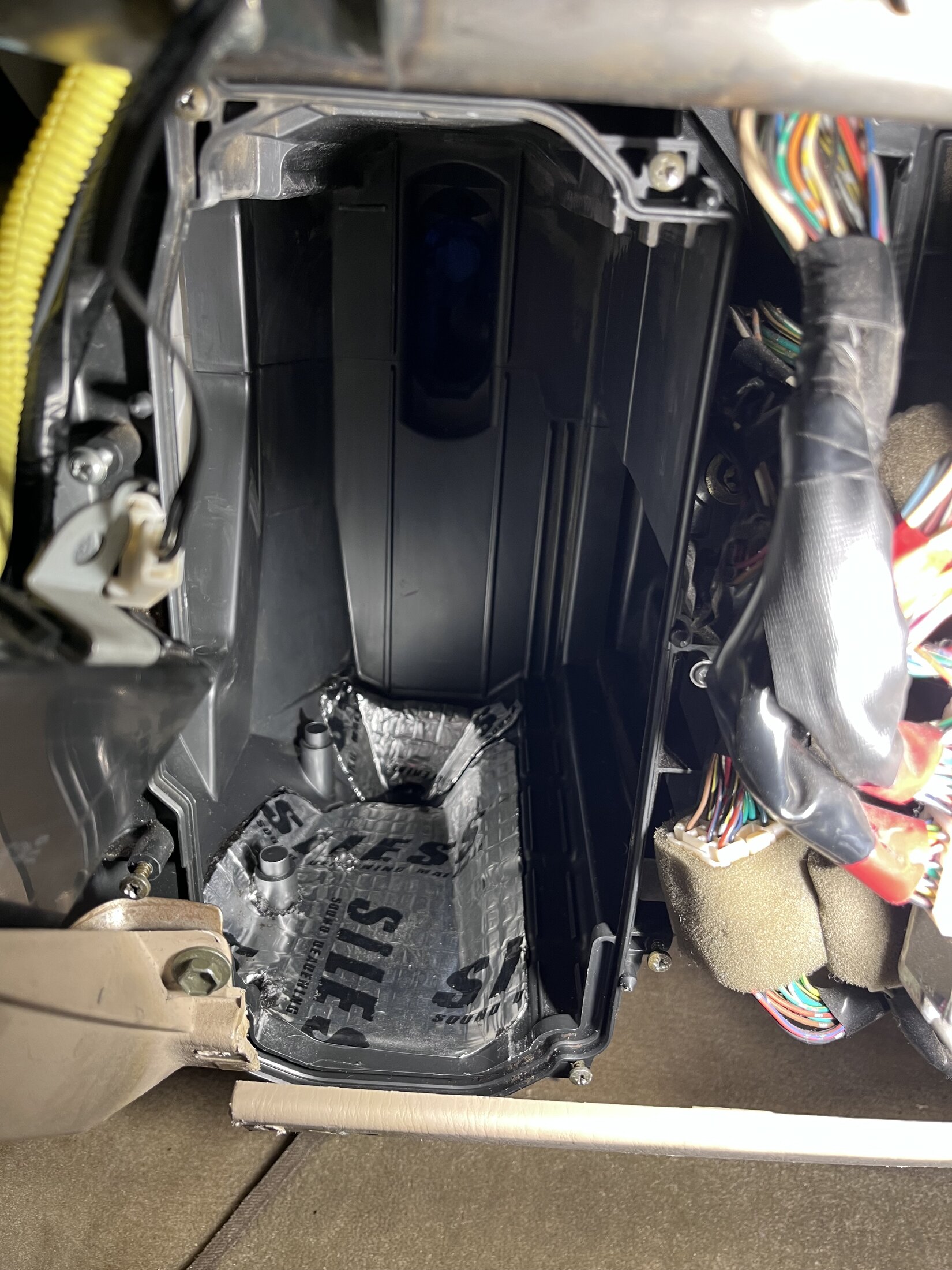

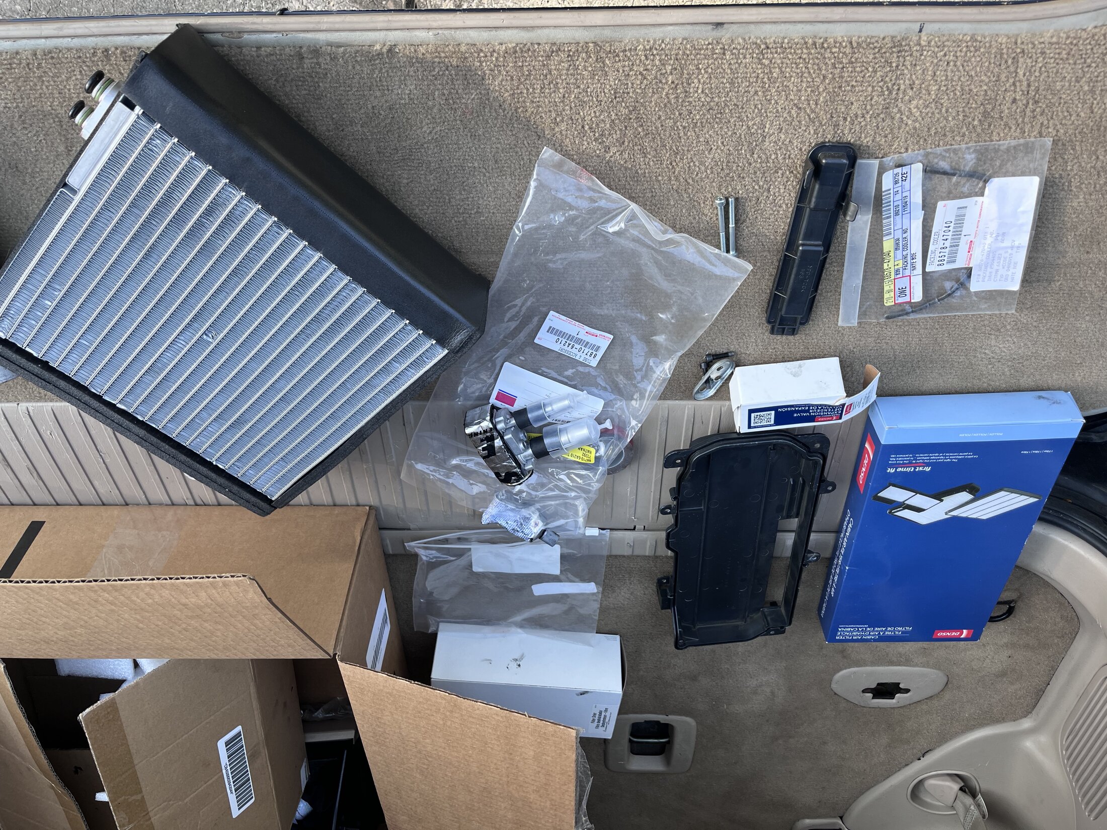

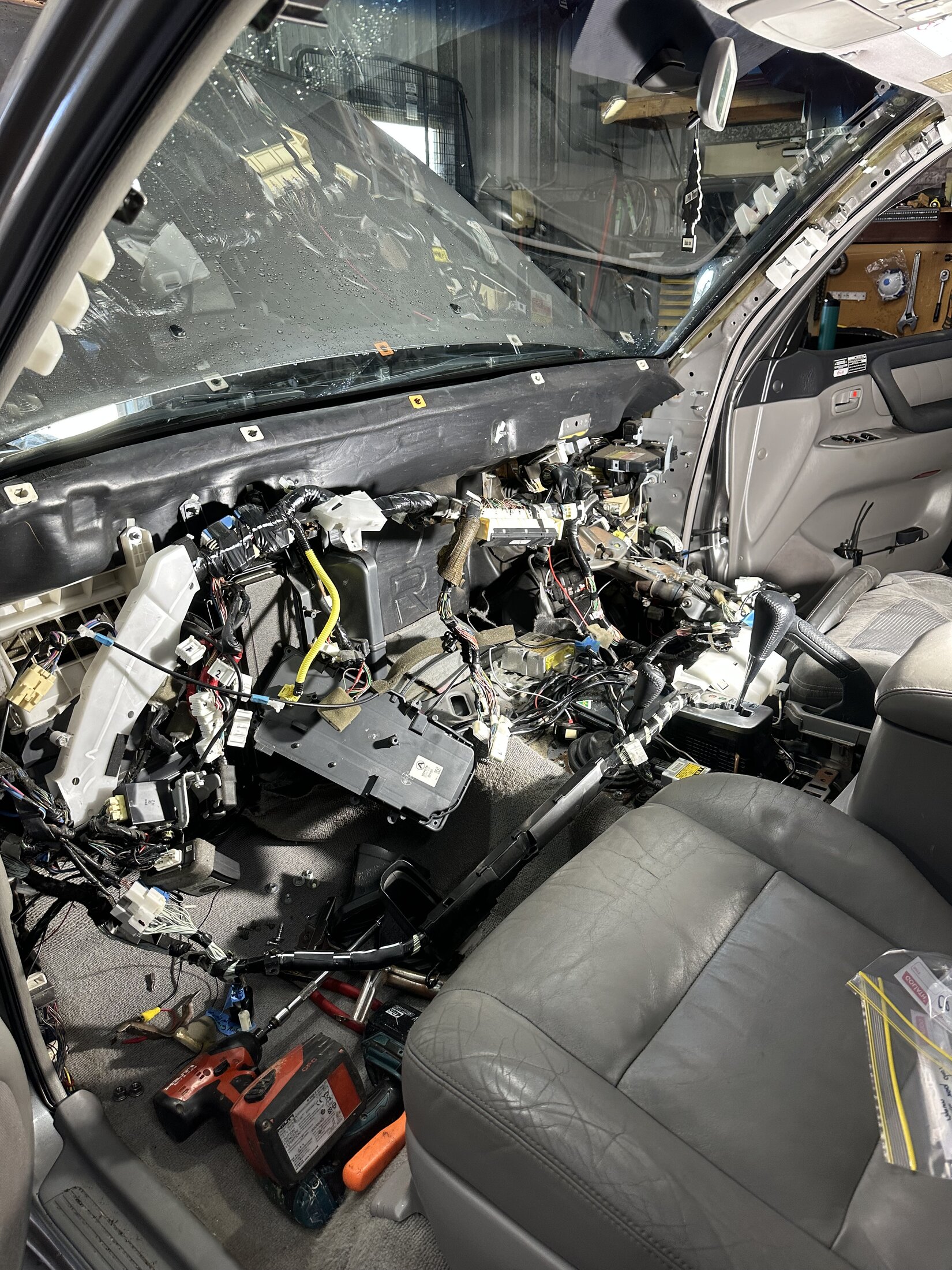

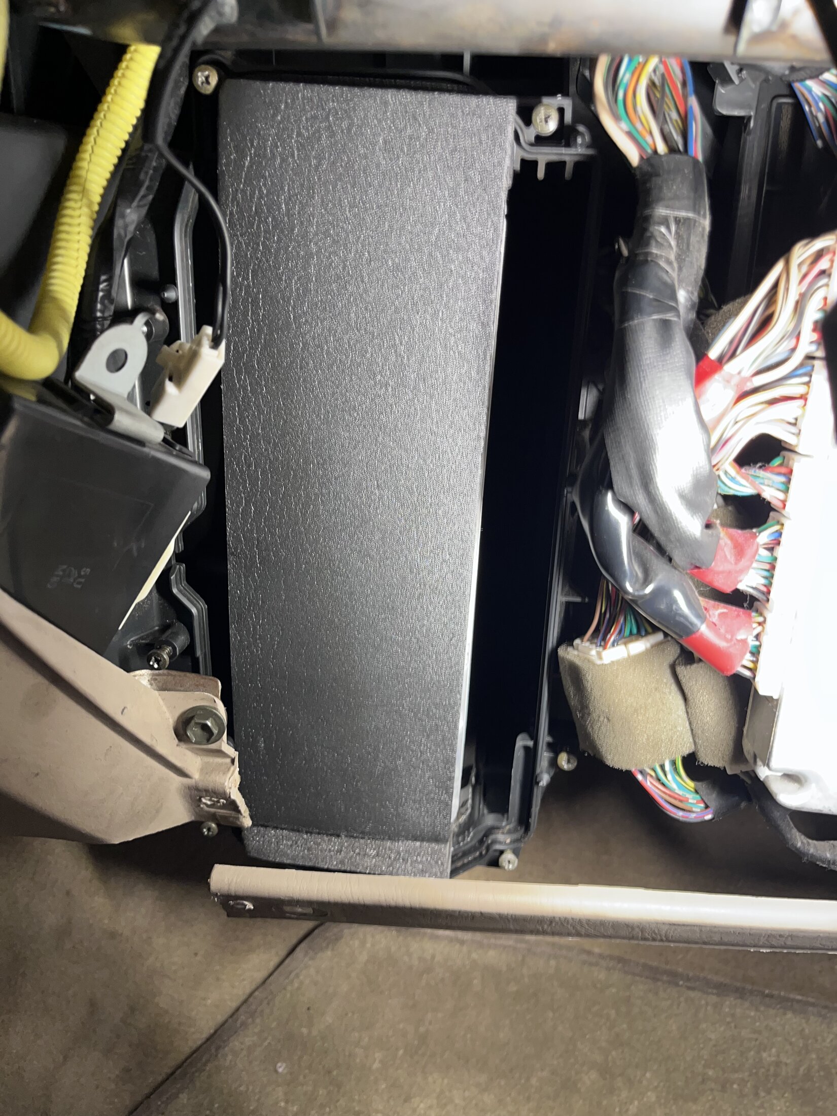

This is one of those while you are in there deals, holy 5hit!
Never again. Probably 2-3hrs on the tear down and about the same going back in.
Wasn’t too bad once you get your head around where everything goes back in. Only left with 2 screws after reassembly which was surprising 🤣
At least Nissan has timing chains on the front of the engine, unlike some German mofos where the timing belt is at the rear and requires engine out service!

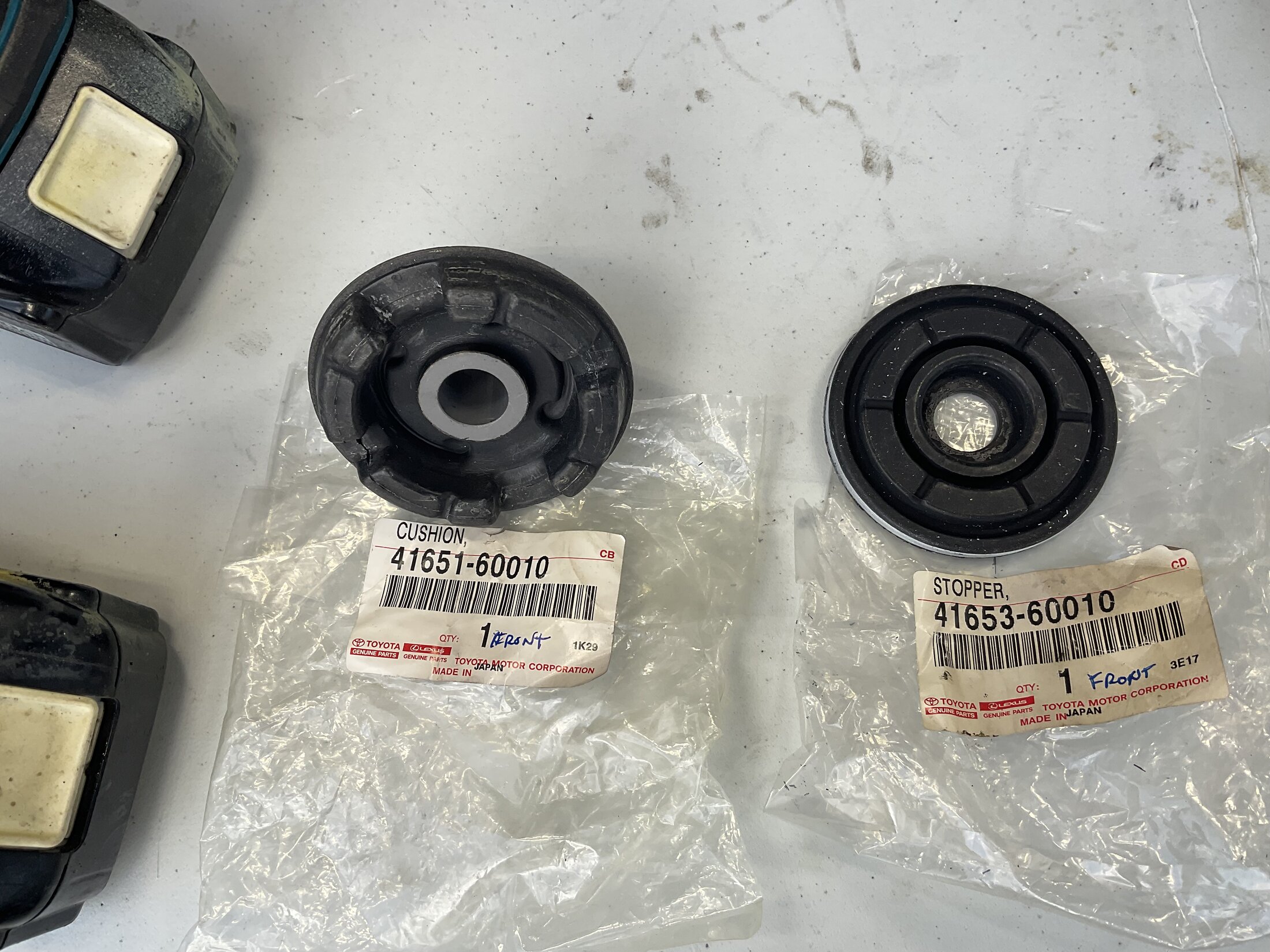

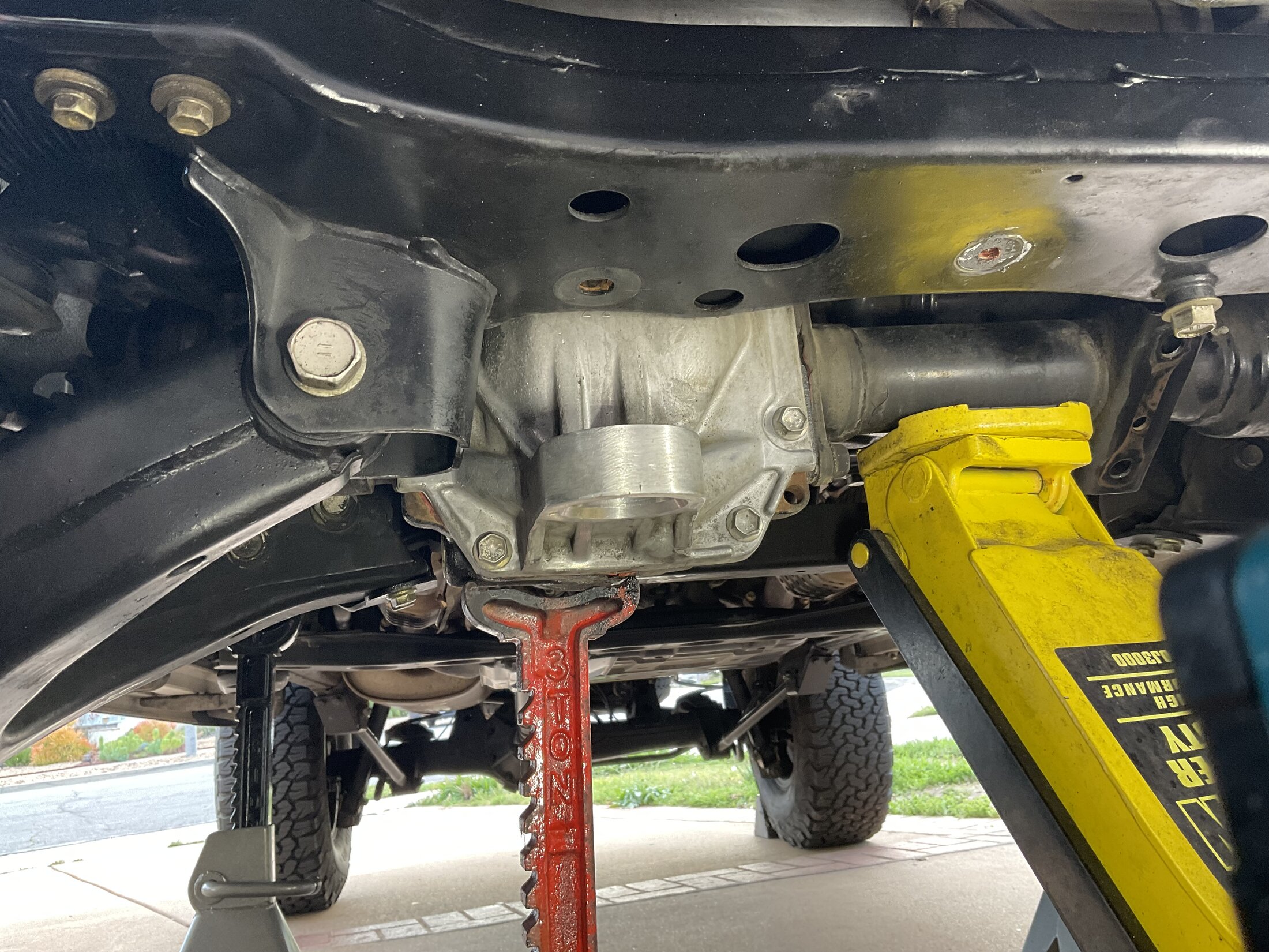

Had some excessive play in the front diff bushing…
Replaced the front, and the drivers side bushings. These bushings both had major deformation. And the driver side bushing inner was almost pushed to one side. Half of the front bushing inner was torn through.
I have the passenger side bushing ready, but the original looks and feels newish… no play and no visual indication of any deformation. So I’ll hold off on the passenger side bushing for now.

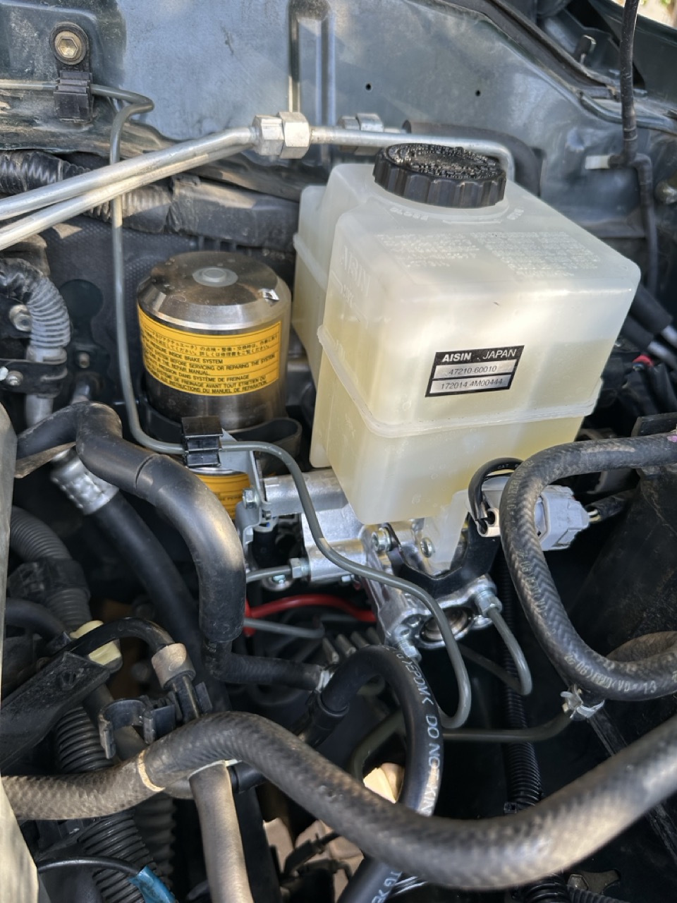

Welp not even a month after getting my front bearings repacked and needing a new steering pump since the old one started to leak badly...the brake master decided to bless me with a leak as well..was debating doing a rebuilt one but if the original lasted almost 30 years why not start fresh..crazy to think how expensive these things are..sure looks good tho

How much was it & where was it sourced from?
