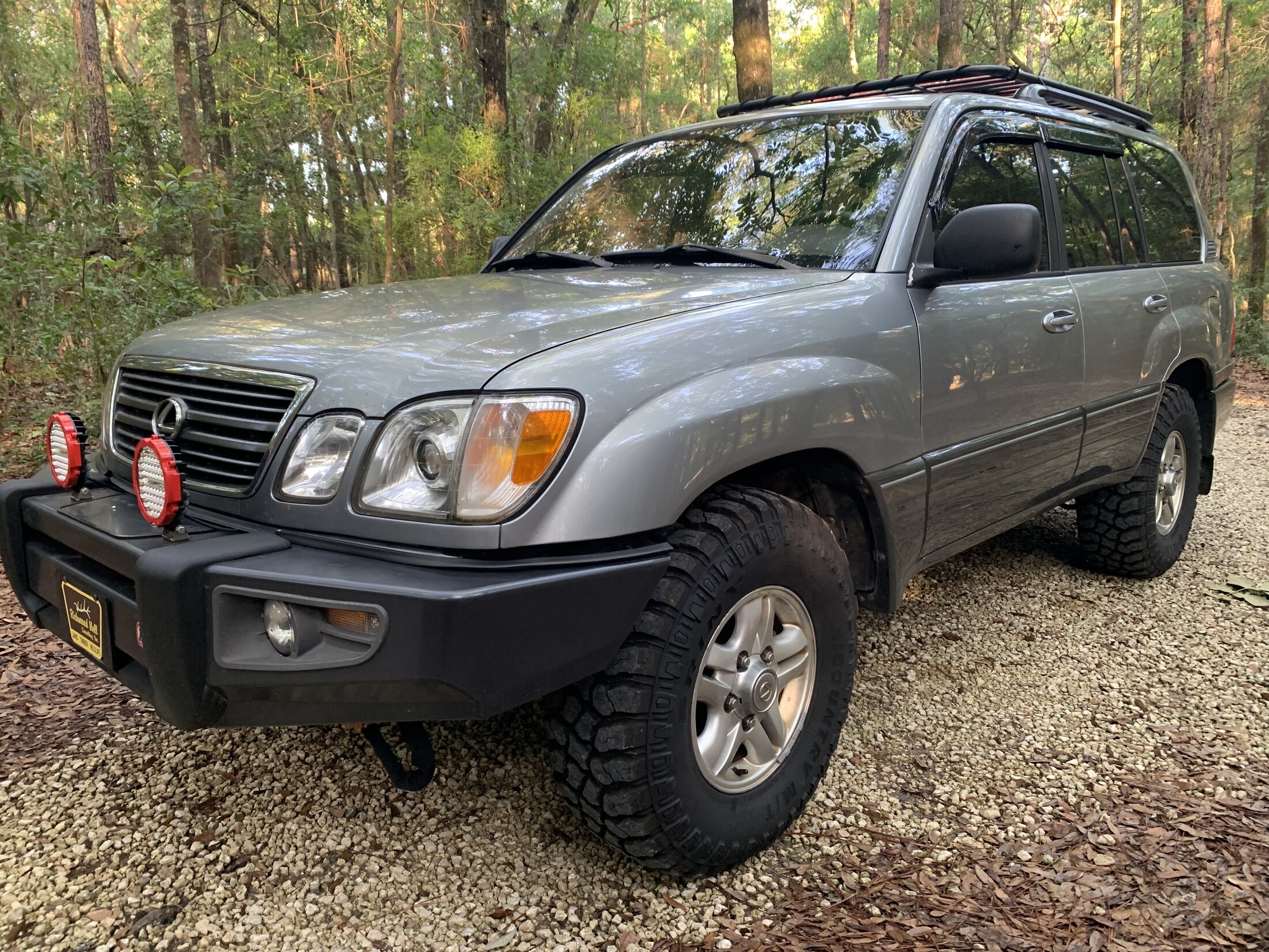

Added 285/75/16 Prinx MT and window visors.
