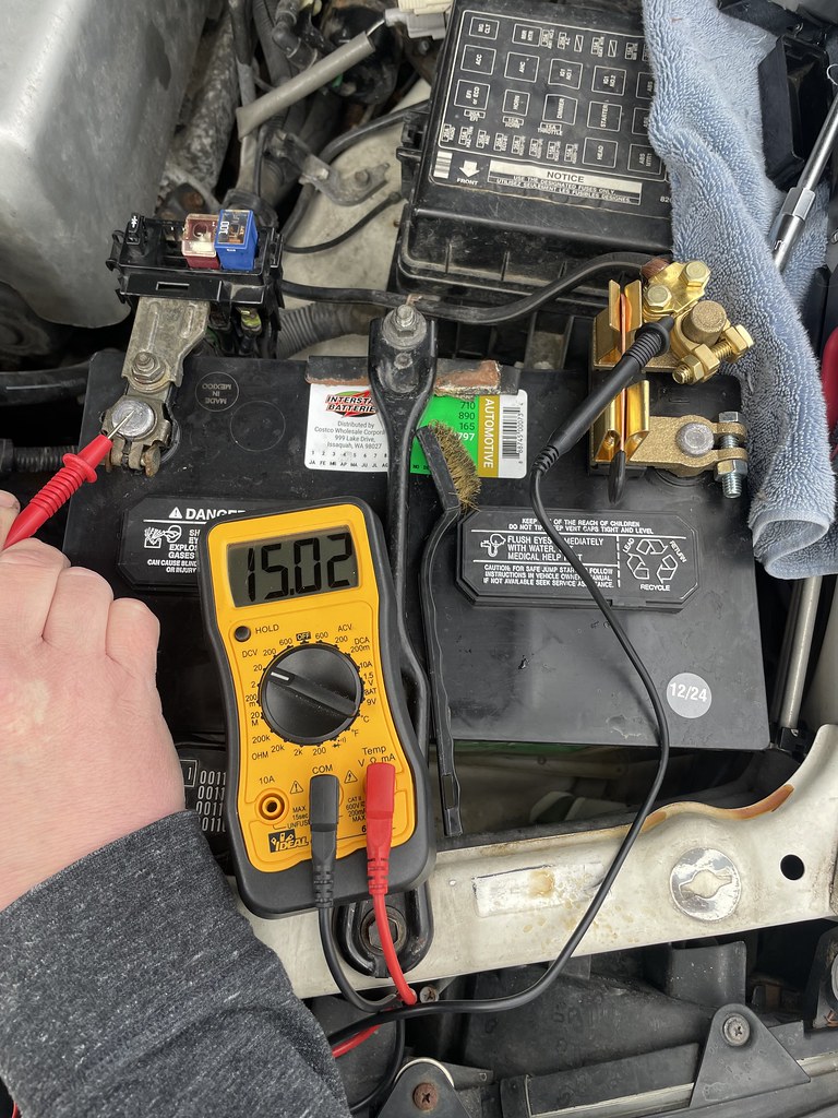

New to me '01 LX 470 was reading 16.5+V. I found the very helpful thread here that showed the problem was very likely a dirty/corroded fusible link and/or fuses. I cleaned up all the connection points and installed new fuses using dilectric grease on all metal-to-metal contact. I also took the opportunity to change the 7.5A alternator* fuse with a diode recommended in the thread to slightly increase the voltage to appropriately charge an AGM battery. Working great!
