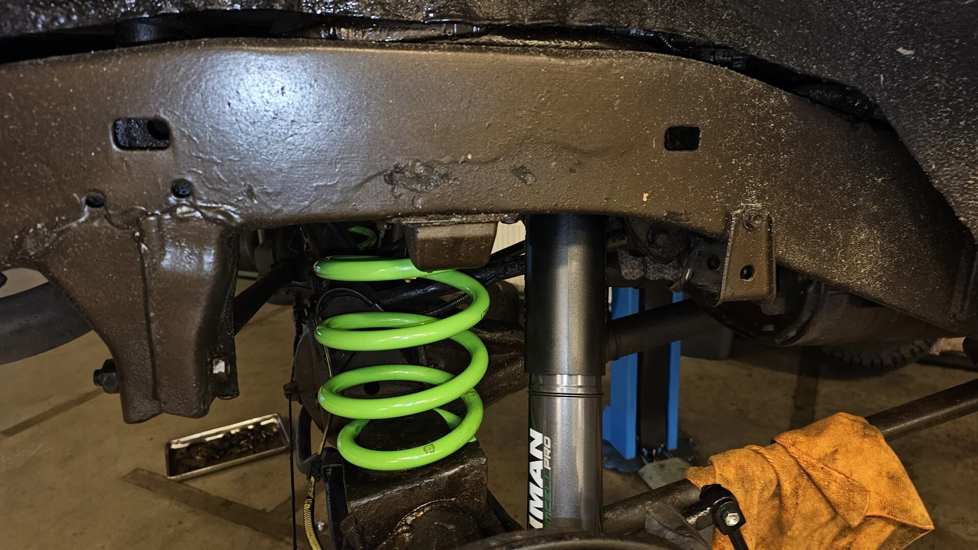

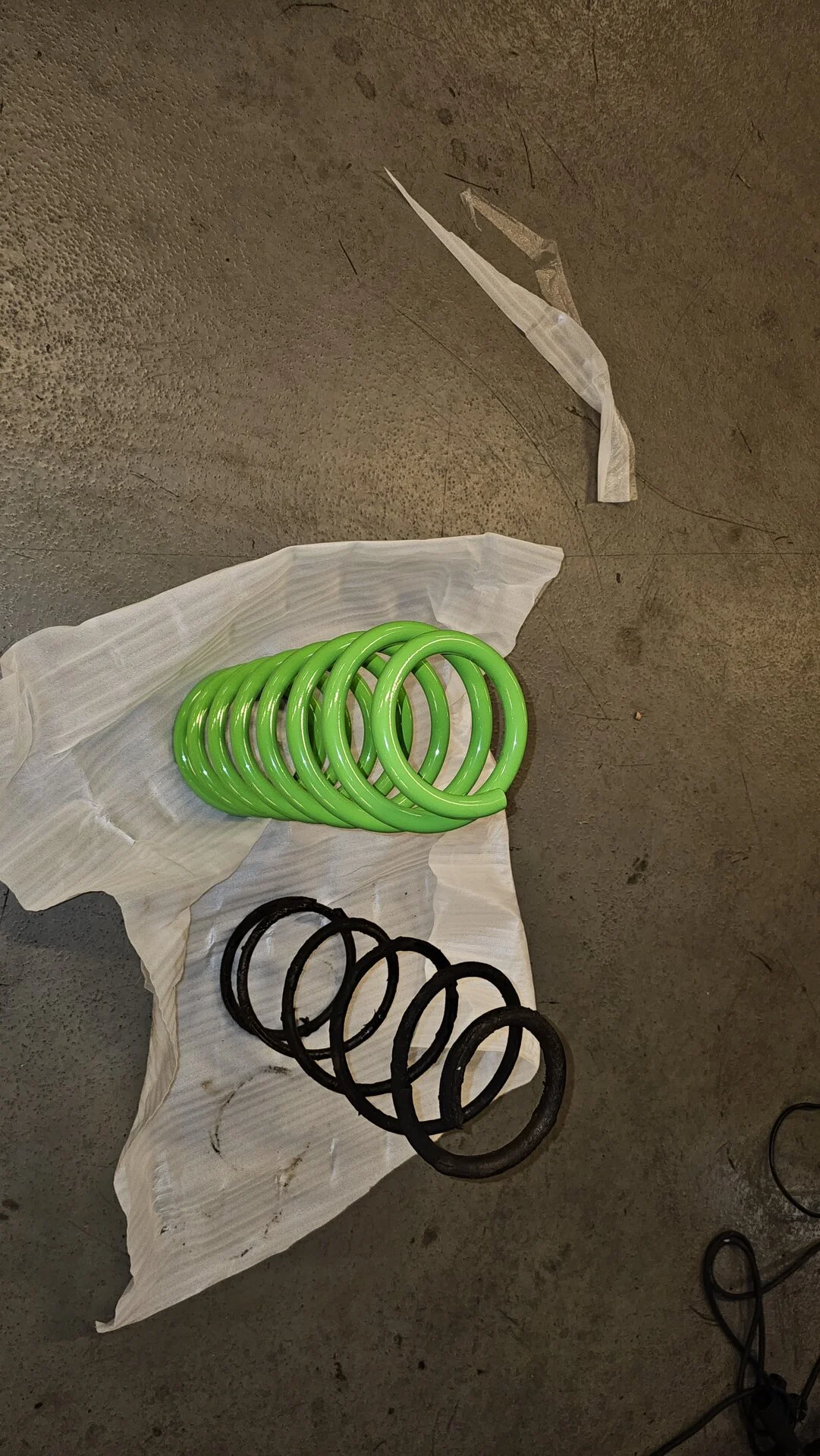

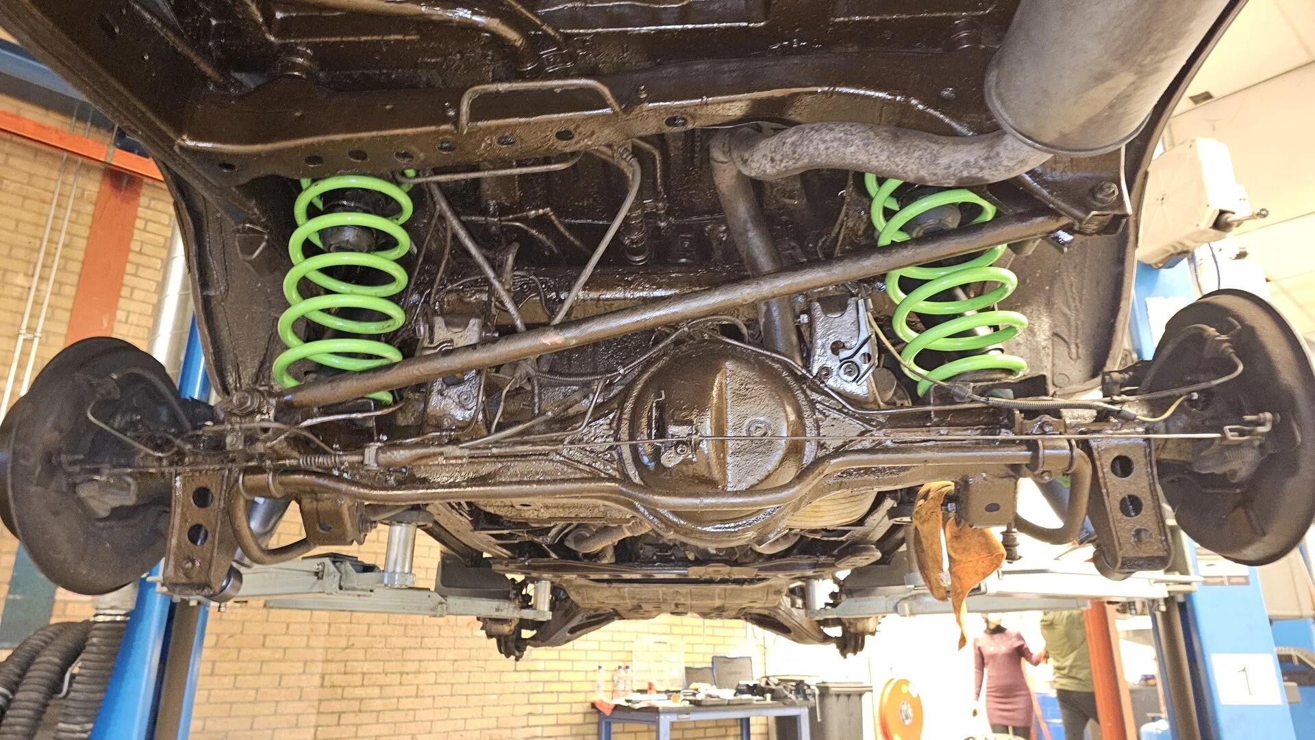

Ironman Sus kit install + out with the active height control.
22 hours labour combined for me and a friend. But yet to do diff drop and replace the torsion bars - that will be next weekend.
QUestion : Does the ironman coils not come with insulators/isolators??

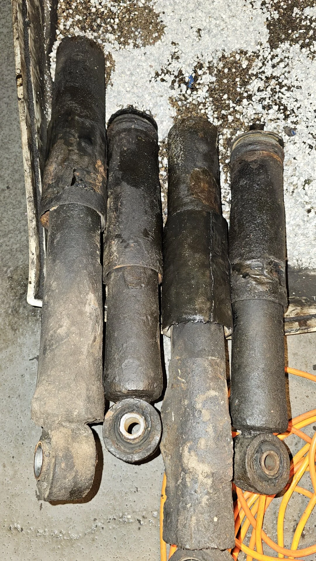

this what 350,000km / 22 years does to a set of shocks.... But again testament to toyota quality that they could last that long - and the AHC still functioned perfectly. Sad to throw out it but at some point we all do, i guess.
for sake good order - new hardware all round.

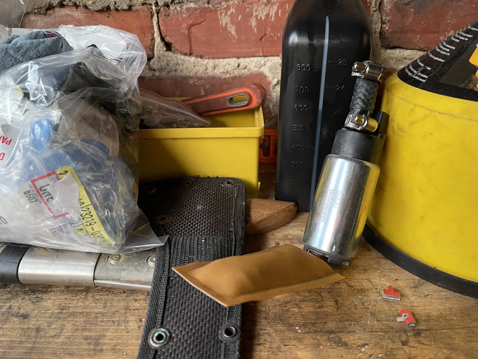

I replaced my fuel pump with OEM Toyota. The old pump was a Delphi, and with 271k miles on this 2000 LC100, I've no idea how long the Delphi was in there. I've been troubleshooting some troublesome starts, so my presumption is the fuel pump is not as efficient as it should be. Peace of mind was felt by replacing the pump, even if it does not resolve my starting issue, which I've not yet experienced since replacing the pump. Here are some pics. Thanks to a YouTube member who posted video on this procedure.

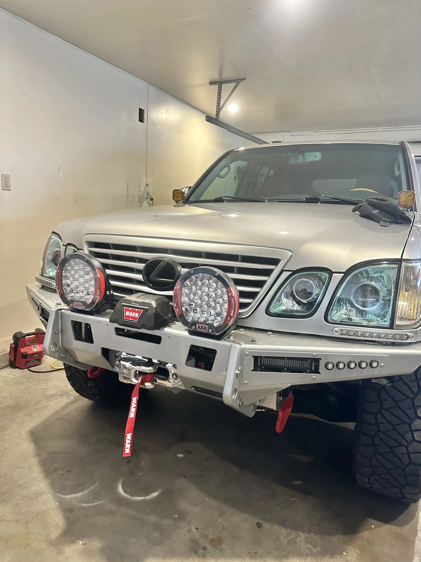

Finally got the time to do the self recovery equipment yesterday, the Winch.
Upgraded straight out to the Warn Epic alum billet hawse fairlead and Warn alum billet Sidewinder hook. I am liking how it looks, it matches Dissent’s stainless fastening bolts and nuts. Just waiting for the red Warn rubber isolator which is in backorder since last month no eta when it will be available.

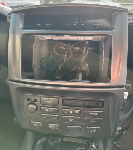

I installed a GROM VLine VL2 in my 2003 LX470 with factory nav yesterday. So far, it is working flawlessly, and it was easy to install. I would have been happy with a Bluetooth input, but my wife was cool enough to allow me to sell her 2022 Kia minivan and replace it with a twenty year old 4x4, the only condition being that the "new" car had to have Carplay. Th VL2 has two camera inputs. It will be nice to have a backup, and possibly a front facing, camera. Installing the camera(s) will be my next project.
The screen resolution is better than you'd expect based on the appearance of the maps when using the factory nav system. For some reason, I can't post a picture. I got it down to 867 KB, and I get a message that it is too large.

Thanks for replying. My problem ended up being an aftermarket fuel pump. I put in new OEM pump, and at 271,000 miles running like a champ again.

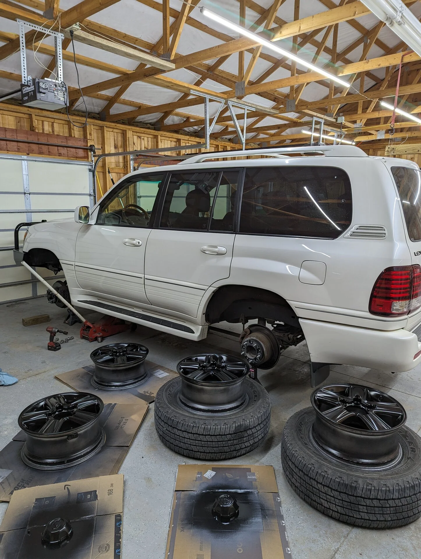

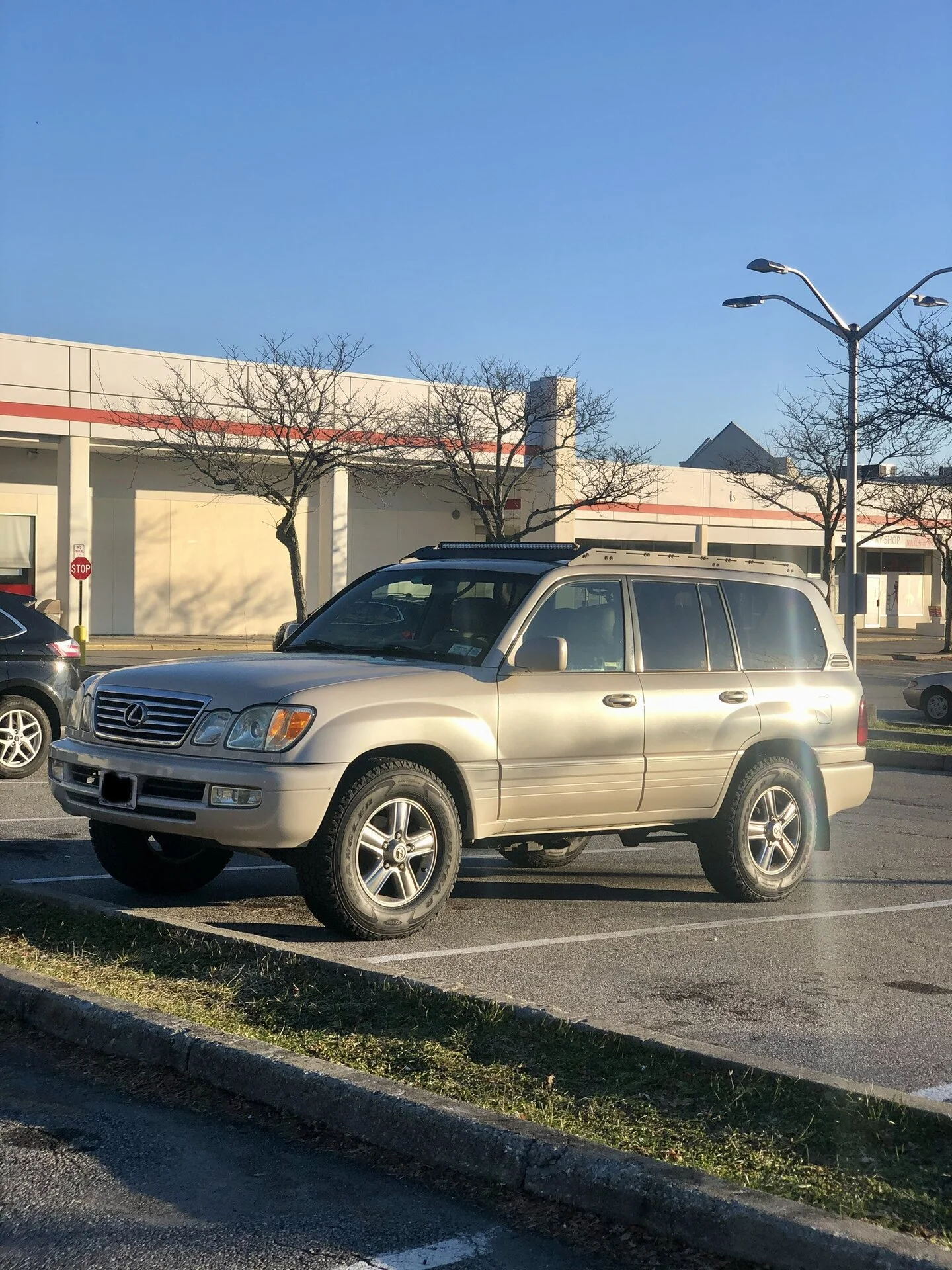

The DD is ready to mall crawl
AHC normal

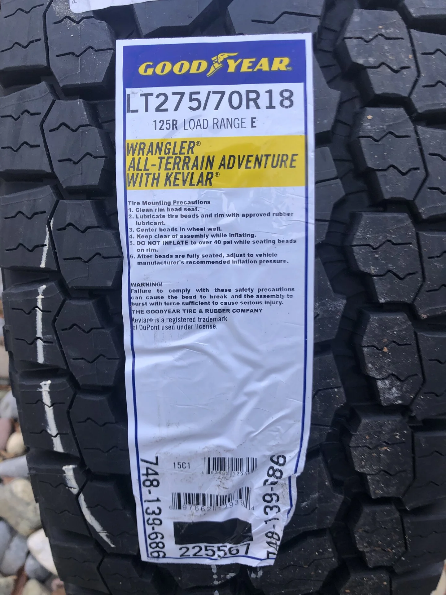

275/70/18 Goodyear Wrangler
Bora 1.25 spacers
Front mud flaps i added do not fit with the 33" otherwise good fit so far.
below AHC high

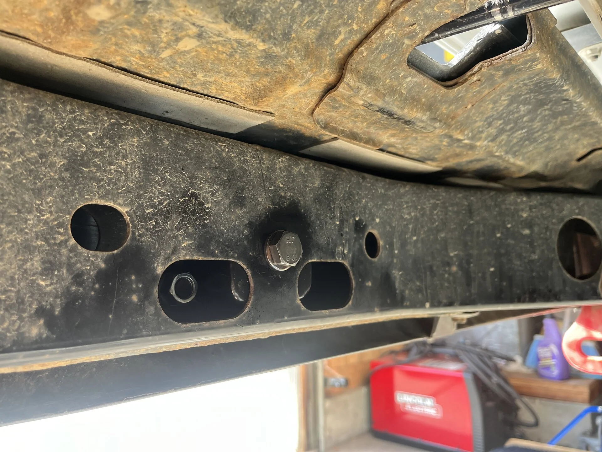

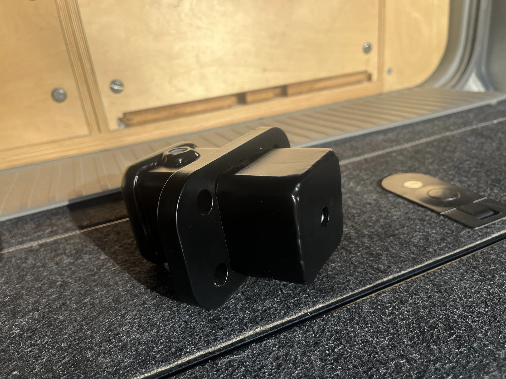

Anyway, likely here is one of the worlds smallest 2” receivers.
To keep it a “bolt in” and still secure it to both sides of the frame:
Finished product complete with OEM hardware.
In hindsight, just welding a 2” receiver straight through the crossmember sounds like a really great idea 😂 It was a fun project though, it’s rock solid and allows me to run a 35” spare in the stock location and a much higher clearance bike rack. The rack doesn’t hinder rear access with or without bikes so it can live on the truck and not be in the way.
