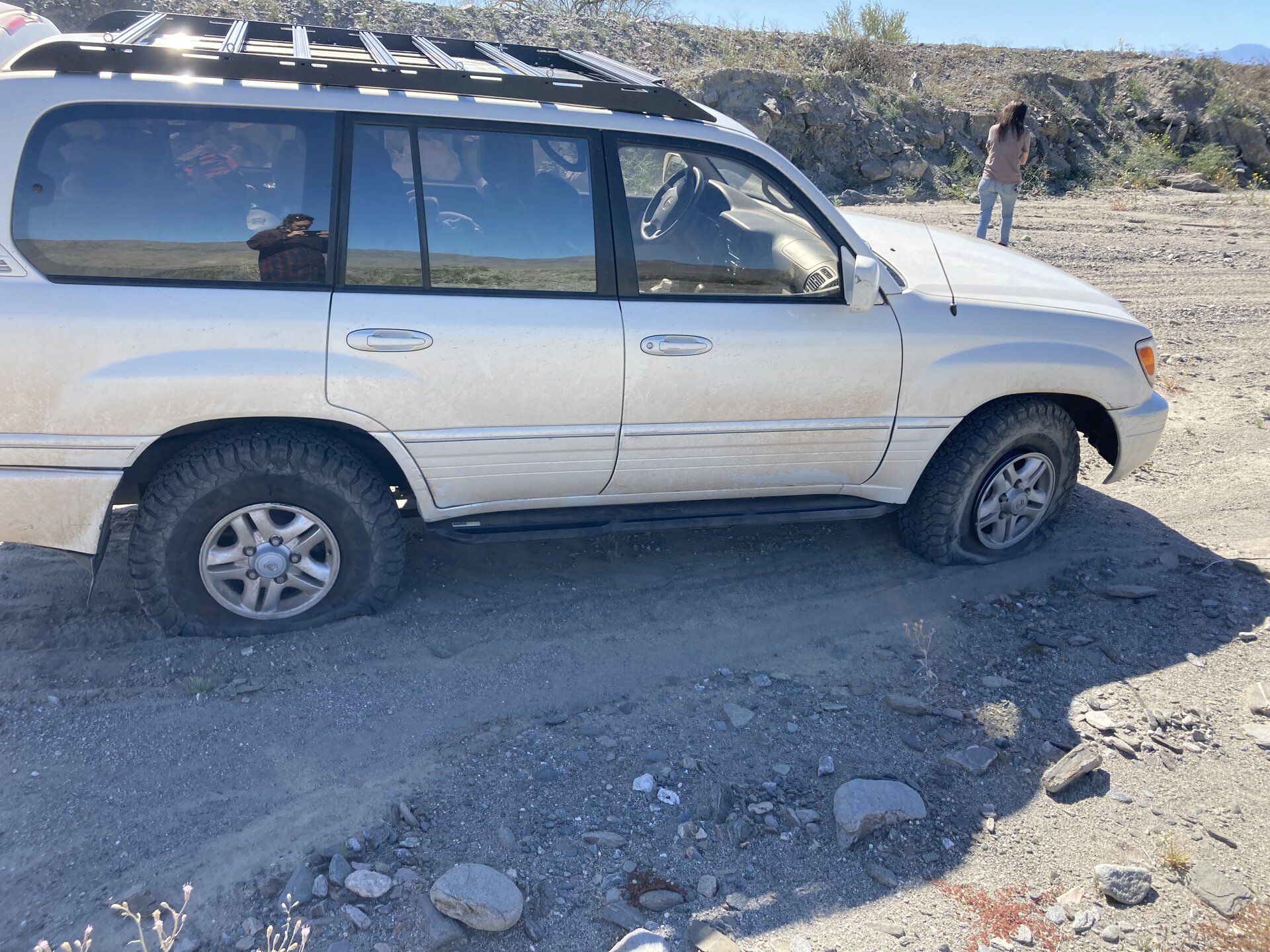

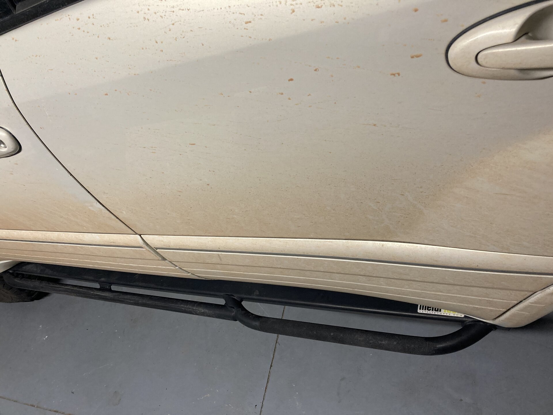

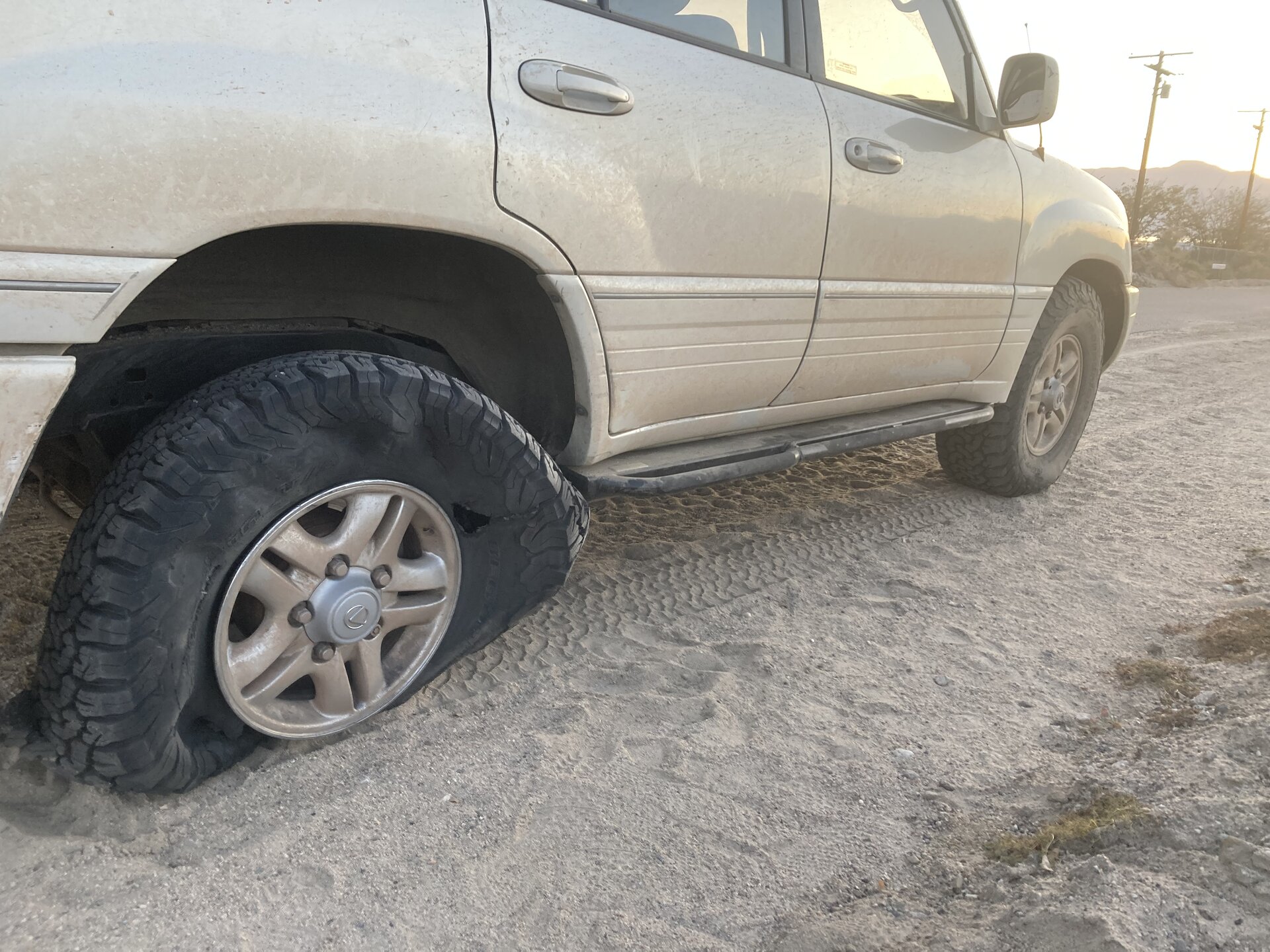

Threw on some used metal tech sliders, installed a full length Raingler interior cargo net, and today experienced the infamous no start today due to the EFI fuse melting and not properly popping.😅 oh and I shredded two tires at once on the passenger side not paying close enough attention on a trail. I guess this was over the past two weeks rather than “this week”

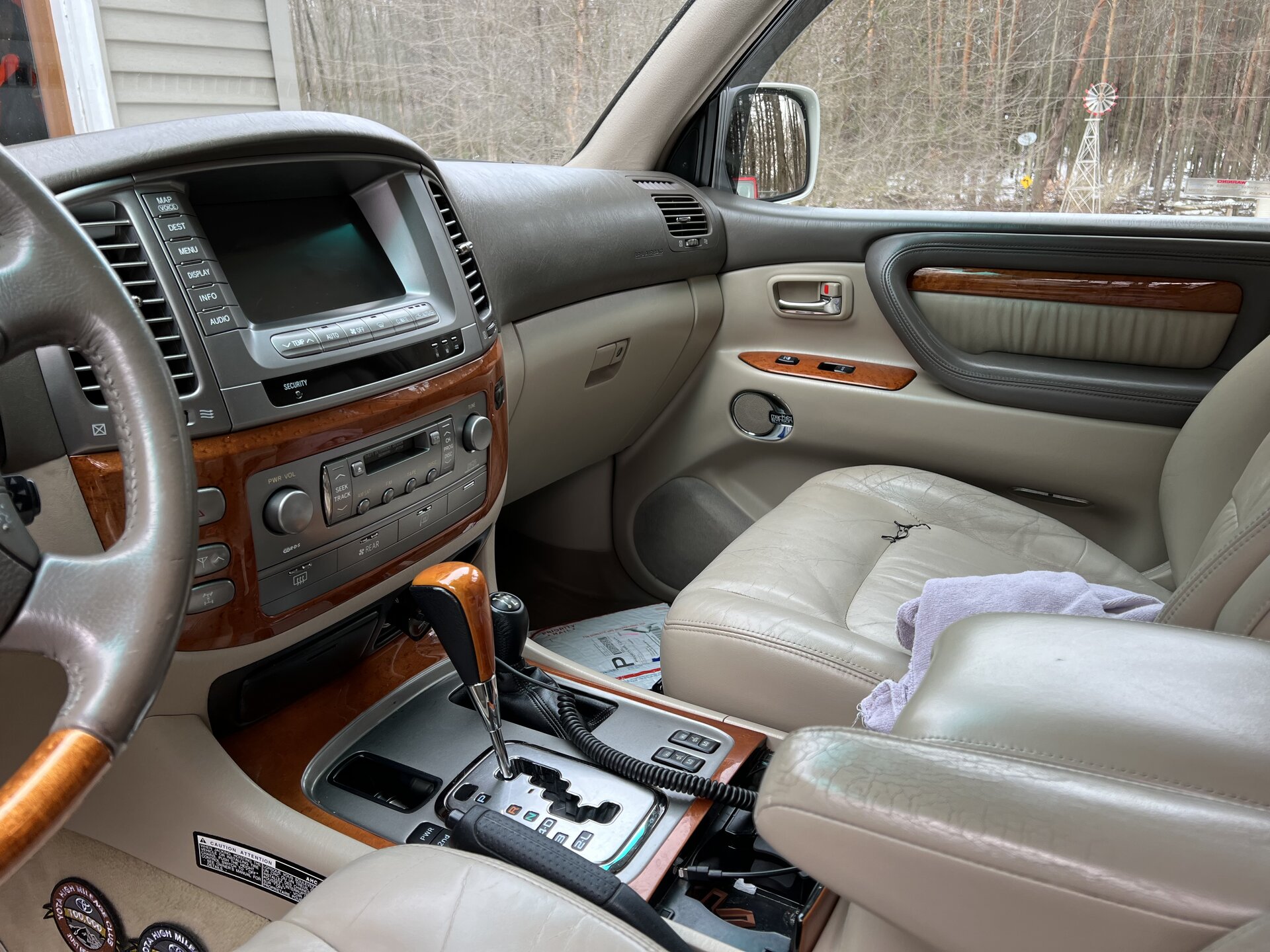

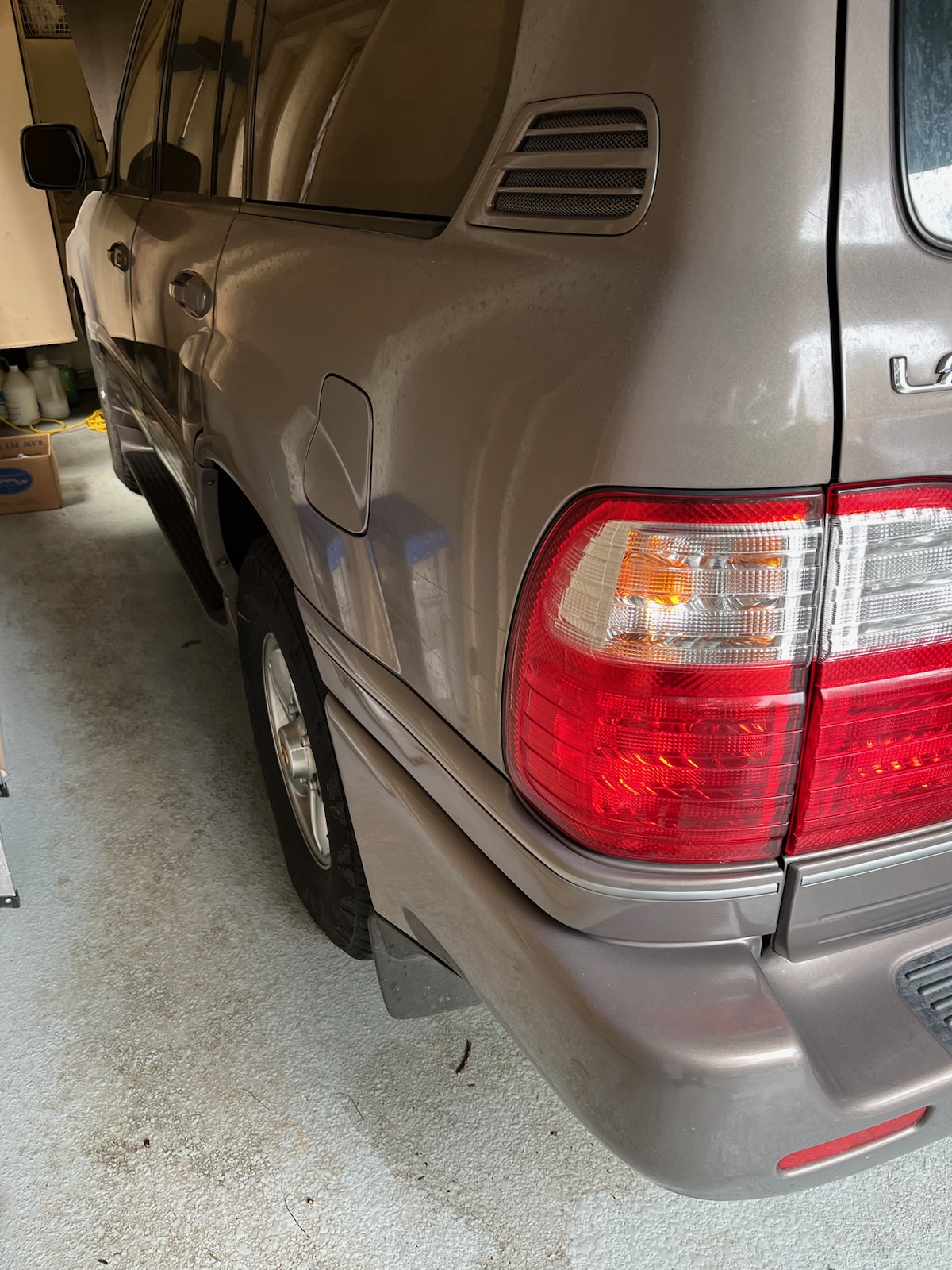

My mechanic and I bought this one from my landlord at the shop. By the time I told a few people we had already sold it and will be adding Trail Tailor armor and a rack for them.
2000 LX470 with 110,000 on the ticker, one owner- 70 year old woman with all the documentation.

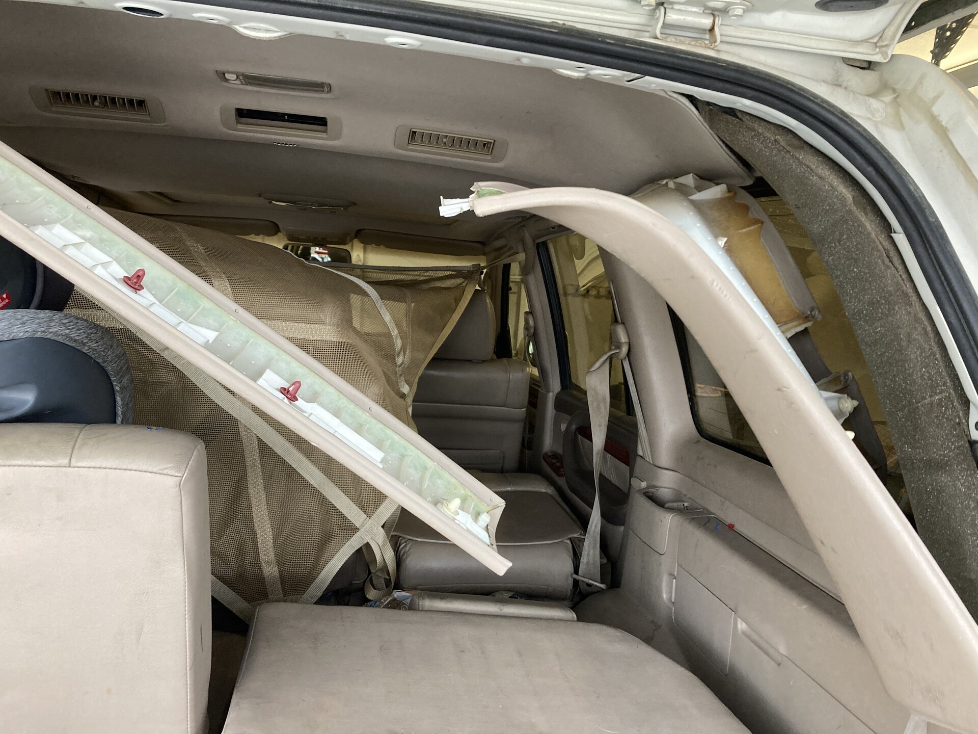

Replaced the 3rd brake light and eliminated the absolute gusher of water that came in during every rain or car wash. A couple of thoughts/tips:
* Do not follow the butyl tape advice advanced by others on this forum. Just get the OEM replacement light. Either your future self or a future LC enthusiast will thank you.
* When you remove the original light there's going to be a ton of adhesive stuck to the body. Patience, Goof Off, and plastic trim removal tools (as scrapers) are your friends. It seems unlikely, but you *can* remove all this gunk for a clean install.

What's your reasoning for not liking the butyl tape that most use to reseal the fixture?
