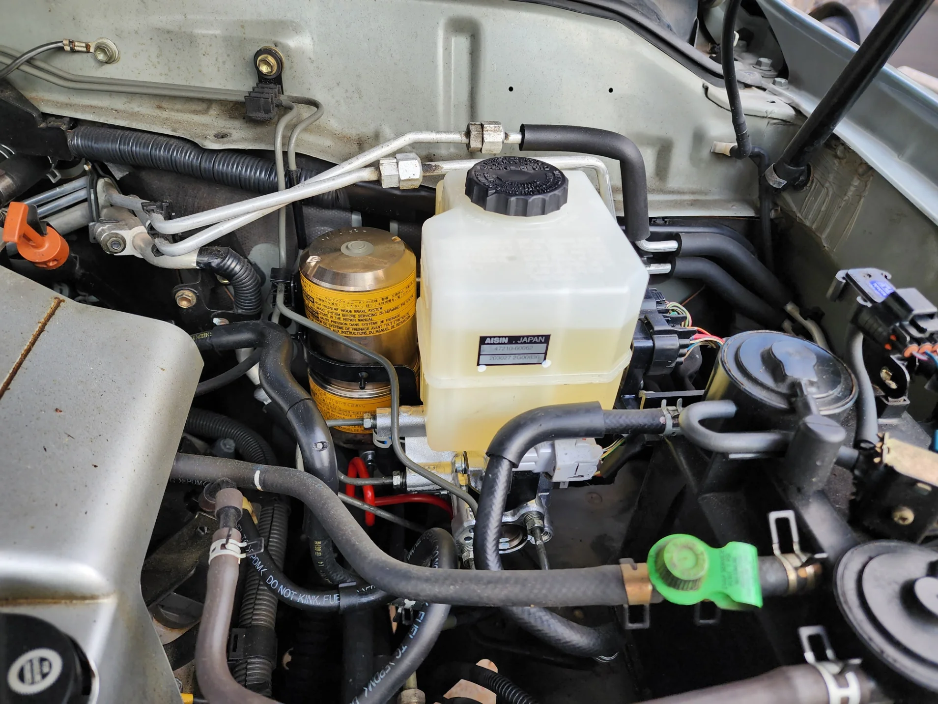

Welp. Won the brake booster failure lottery so that's what got done.

WHY will 100% of 100 series experience brake booster failure around 200,000 miles? What causes this to happen?
These are early generation electric booster systems. An electric motor runs a pump to pressurize the brake fluid in the accumulator. It has multiple advantages over the simpler vacuum operated brake booster that older Cruisers had.
This makes brakes completely independent of engine and you don't lose your brakes if the engine stalls out!!
Unfortunately, the electric motor has a limited life and can wear out with 20 years of service and abt 200k miles.
So if your truck is nearing that mileage, you're on borrowed time. Replace your booster before you buy those chintzy wheels or spend money on other masculine jewelry for your truck.

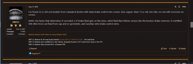

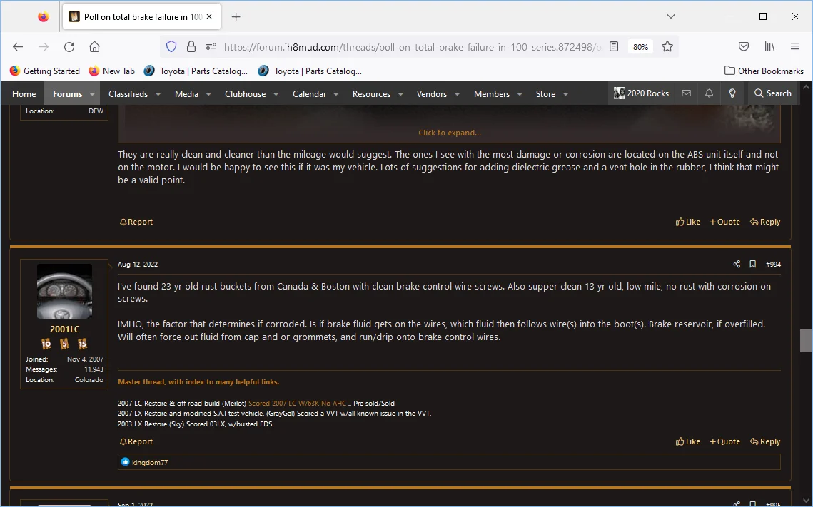

Best educated guess is overfilling break fluid res running down the sides onto the electric bits

I must be winning the lottery at 290k. Rebuilding. Or replacing the motor is on my to do list as a precaution this winter.
Brake booster
Any symptoms leading up to it? ive got 240k on mine and its never been replaced. I rather do it preventatively vs having a failure on the road.
No symptoms, but I got the notification* well before actual brake failure occurred. To be honest, I got two warnings. I just didn't believe the first one because I got it second hand from a mechanic that was working on the AHC. Now in my defense, the battery got run down to zero so I thought it was the usual low battery Christmas tree. Once I had the battery on the charger all the lights went away.
Halfway home for lunch and I got the notification again and made it back to the shop without any failure.
