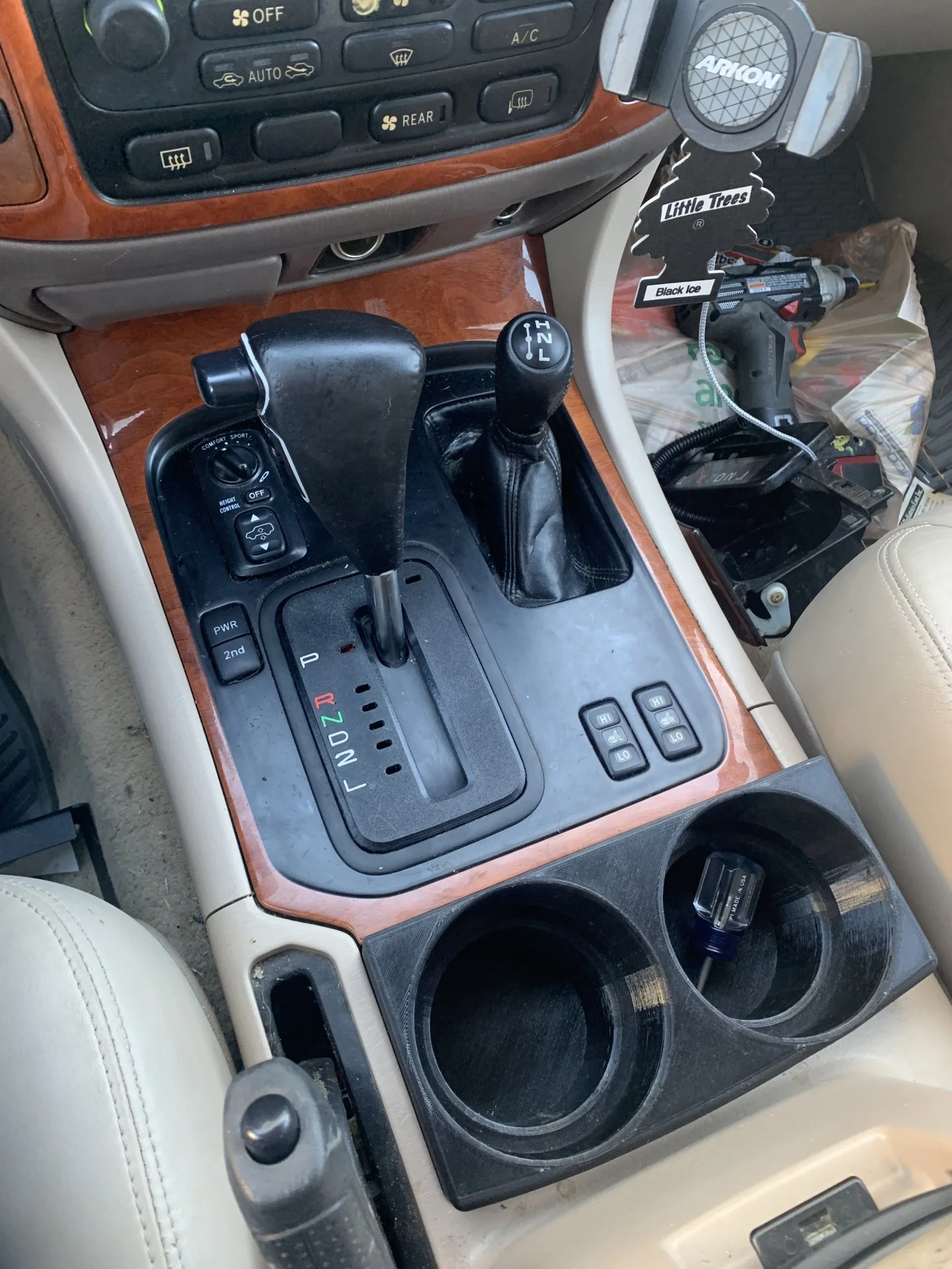

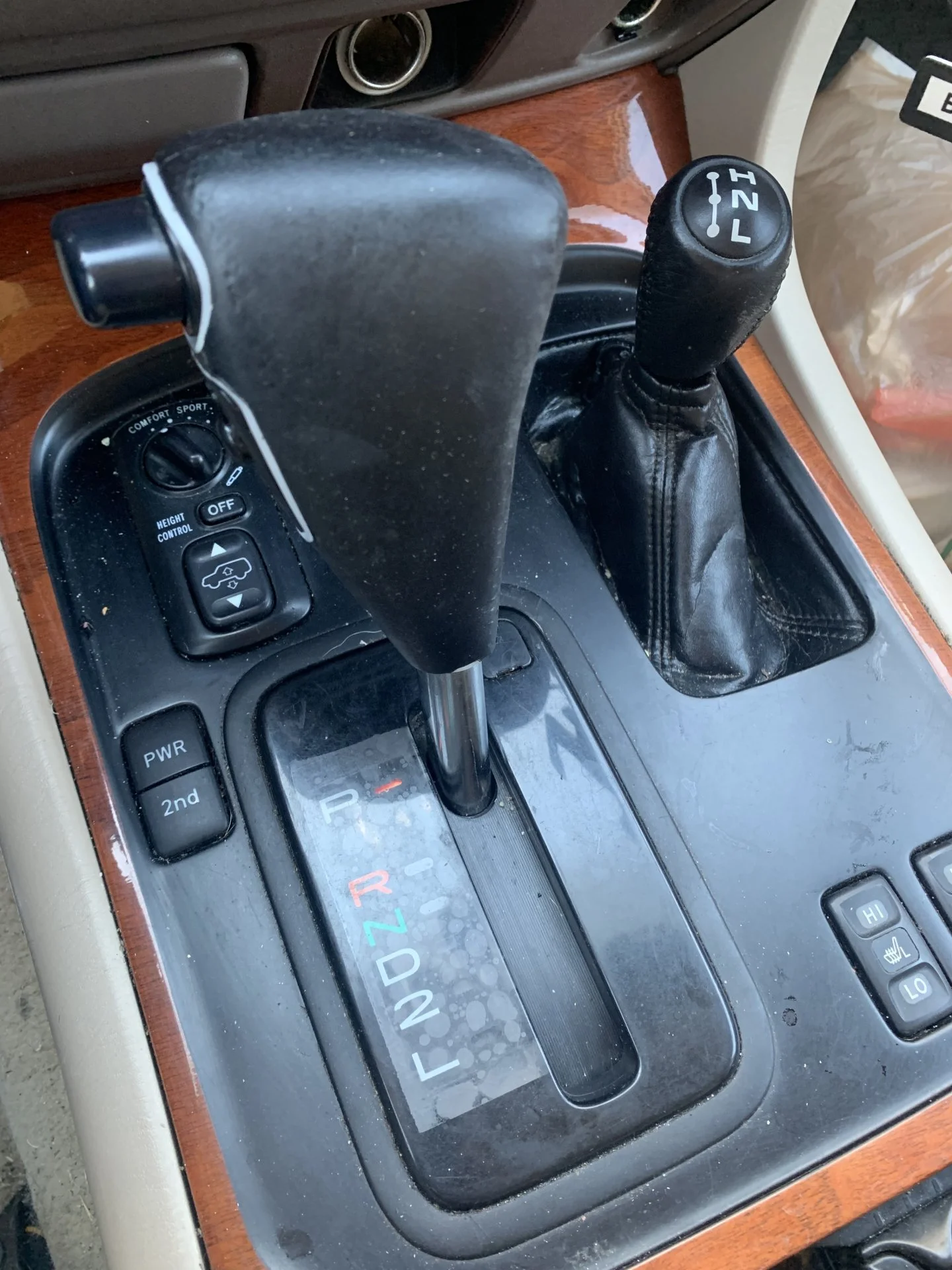

Finally got to the CruiserDM parts that have been riding corner of my desk for weeks.
Old and busted:
New hottness:
Install was pretty easy, though fishing the OD override switch wires was a pain. I actually wound up just cutting and extending those instead of trying to keep it all stock. Crimped, taped, sealed, wire-loomed and zip tied, they’re solid.
My last wrinkle is getting the shifter reattached correctly (the little screws are not threading in yet) so it’ll work 100%, but I’ll get that done soon.
Old and busted:
New hottness:
I am about to do this exact install. How much does that OD job suck? 2 beverages? 4?

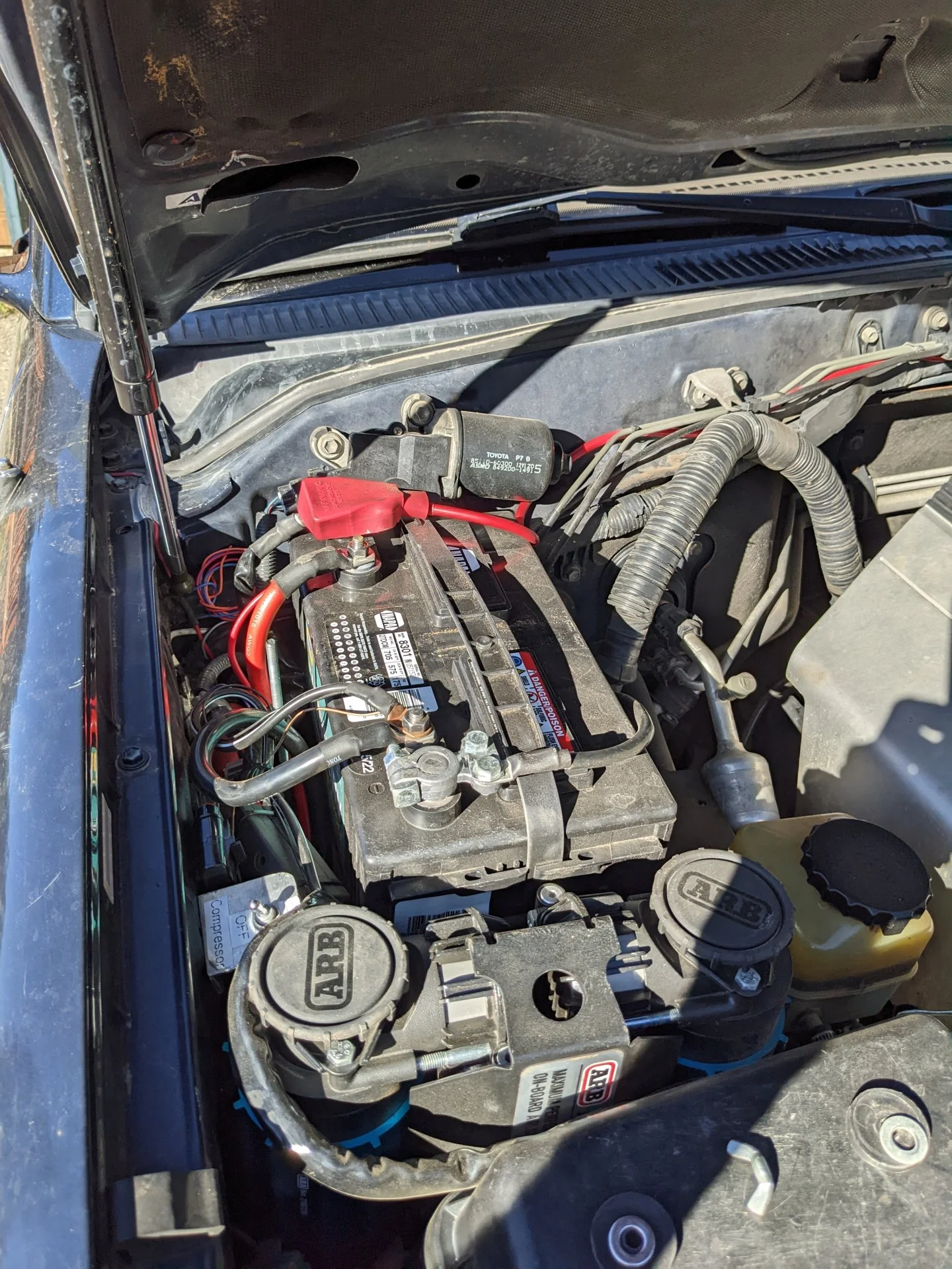

Here’s a list of things I’ve done over the week:
Installed Slee 2nd battery tray, capped of power steering reservoir, tightened clamps on power steering reservoir, installed Optima group 35 yellow top, wired Ironman 4x4 dc to dc charger w/ solar input, installed ARB compressor with swivel fitting (have not finished wiring on ARB compressor), fixed passenger seat bolt threads and installed new seat bolt.
Replaced AC condenser, removed weed baggy my brother in law left in my Land Cruiser from AC fan after I told him not to smoke weed in my car while I let him borrow it, installed new Falken Wildpeak AT3Ws, put RTT back on the roof for camping season this fall.
What’s left to do?
Wire ARB compressor, install Ironman 4x4 Foam Cell Pro 2” lift, install Ironman 4x4 diff drop kit, order and install solar panels (or at least have a quick disconnect wired up to use them), order and install fuse block, install Pure sine inverter after fuse block install.
Go camping.
It's not really that hard, just fiddly. Get yourself some butt connectors and crimpers, snip the wire, reconnect. There's not really a ton of slack, so it's probably easier to do what I did and just use an extension wire and 4 butt connectors instead of two. All that button does is complete a circuit (or interrupt one), so it's not exactly a super-electrical-technical thing.
One thing I did that I think made it easier- while pulling the wires up through the shifter lever, make sure the two white wires pull the black insulation/ covering with. Use tweezers to get that to pull out too if you need to. THAT WAY, when you go to push those wires back down through, its less like pushing rope and more like pushing a cable with some stiffness. I taped the white ends down with electrical tape at the end of the black insulation, and it went through pretty easy.
I'm having trouble in the last stretch though- it's all back in and working good, but I can't for the life of me get the shifter knob to properly seat back up where the button works as intended and the screws in front go back. Any pointers there from the crowd? Right now I have to do a little wigglin and fiddlin to get truck in gear or back into park.
Good to know. I am going to give that a try. Is it possible to relocate the wire break somewhere else? Pull wires down to the rear of the shift plate do the break there and then run them back up to OD?
There's not another spot to do it, really, since that's where the wires are accessible. You gotta get the OD cancel switch out to pull the knob off to put the plate on, and the best way to do that is to snip behind/ below shifter, pull all that out, then swap your parts, fish the wires back down through and reconnect.
There's Will's video! Wow, I feel like an idiot. Haha, things are hard to find when they are in front of my face. Thanks, Broski!

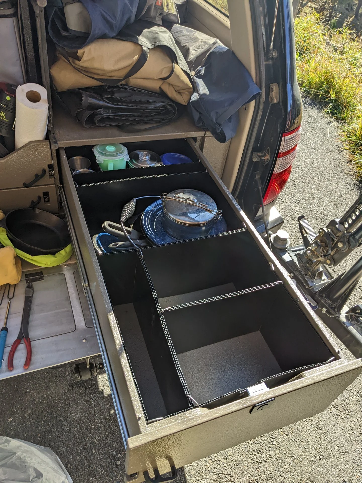

Today I built dividers for my drawer unit, pretty easy and WAY better use of the space, now there is extra room. Got 2 sheets of coroplast, only needed one.

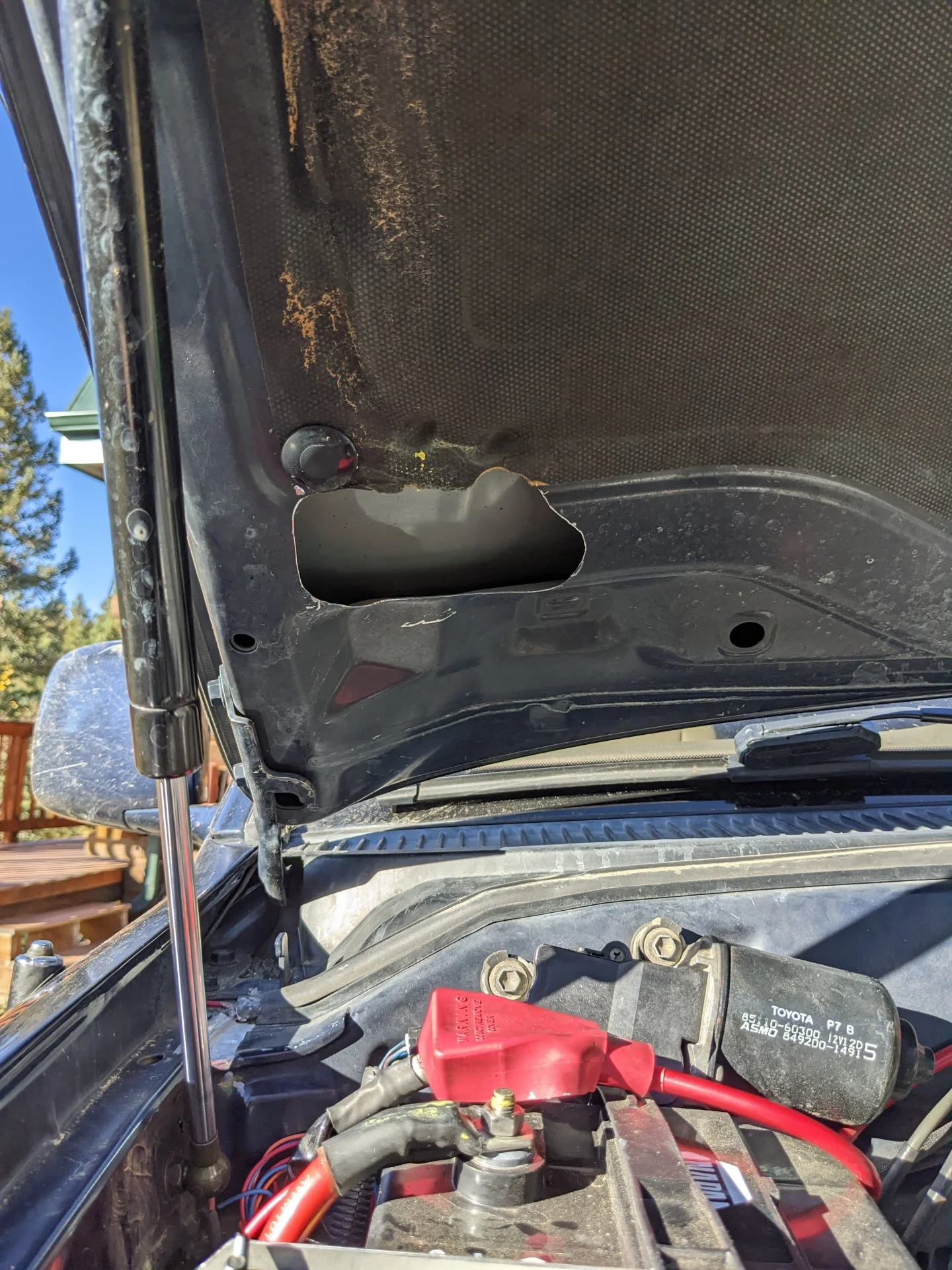

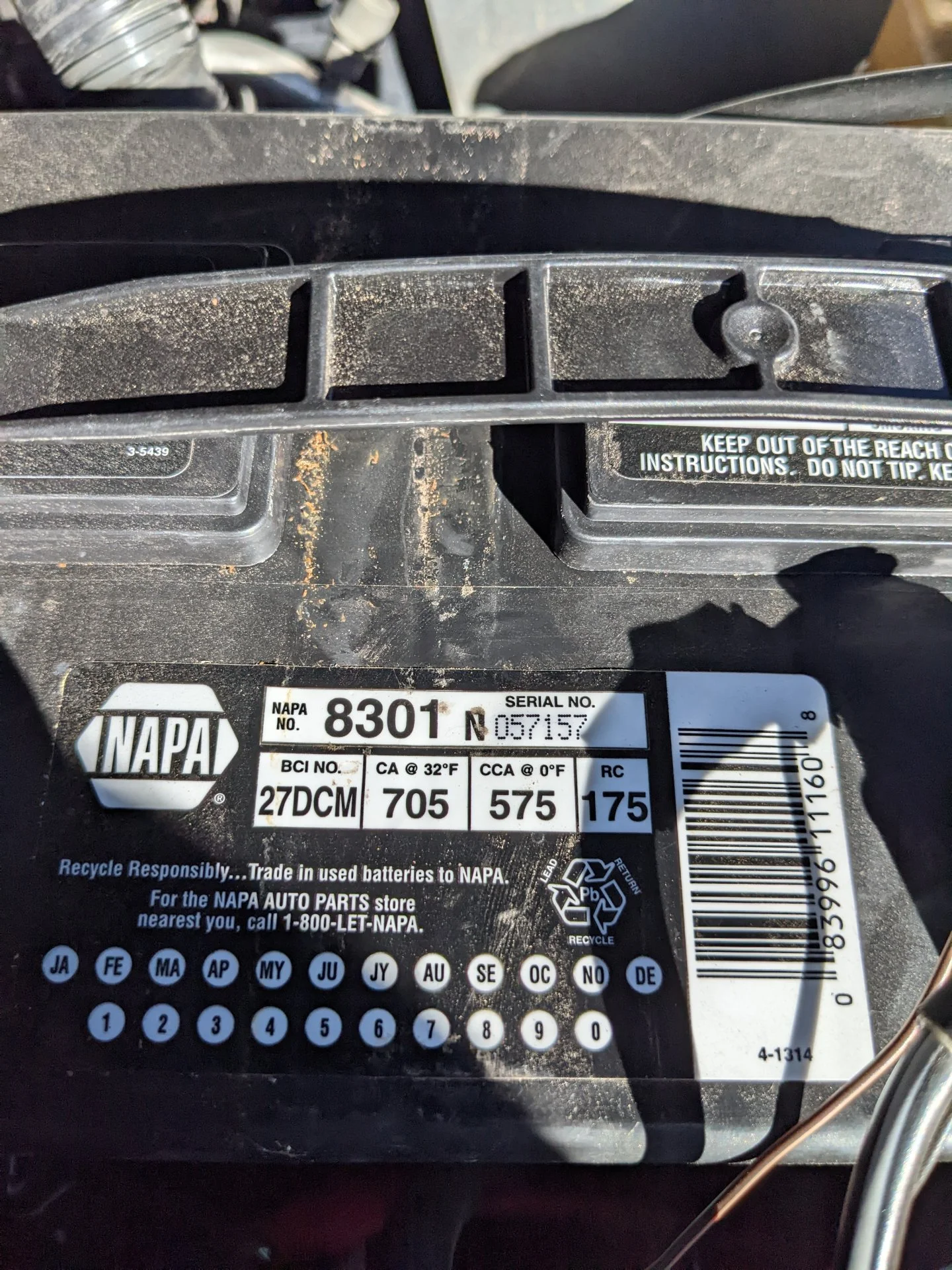

Added a series 27 battery to my 2nd battery tray. Yes it's lots bigger than a 34 series but the extra capacity is welcome and will run my fridge/freezer all night without issue. Had to relieve the underside of the hood slightly to avoid contact with the positive posts, that would be bad obviously. Plan to run tubing on the edges of the relief hole but it's not sharp as it is. The math says this battery will run the fridge for 26 hours, sounds good to me.
