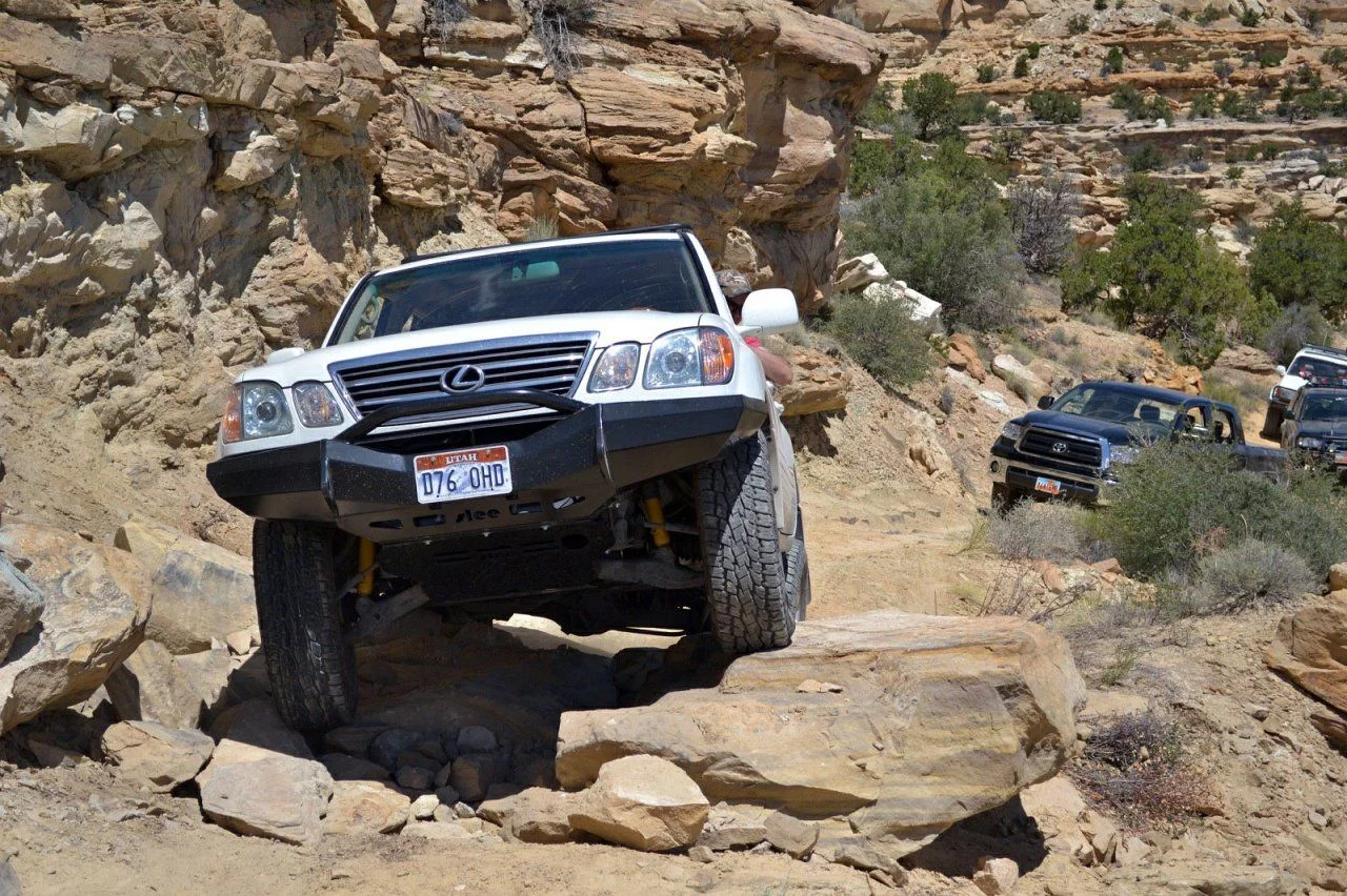

I'm still learning to wheel this beast, and the front end behaves differently than my 80's. Poser pic below shows the extent of front end flex I could get. I'm thinking a quick front end anti-sway disconnect would be nice. Project for the future.

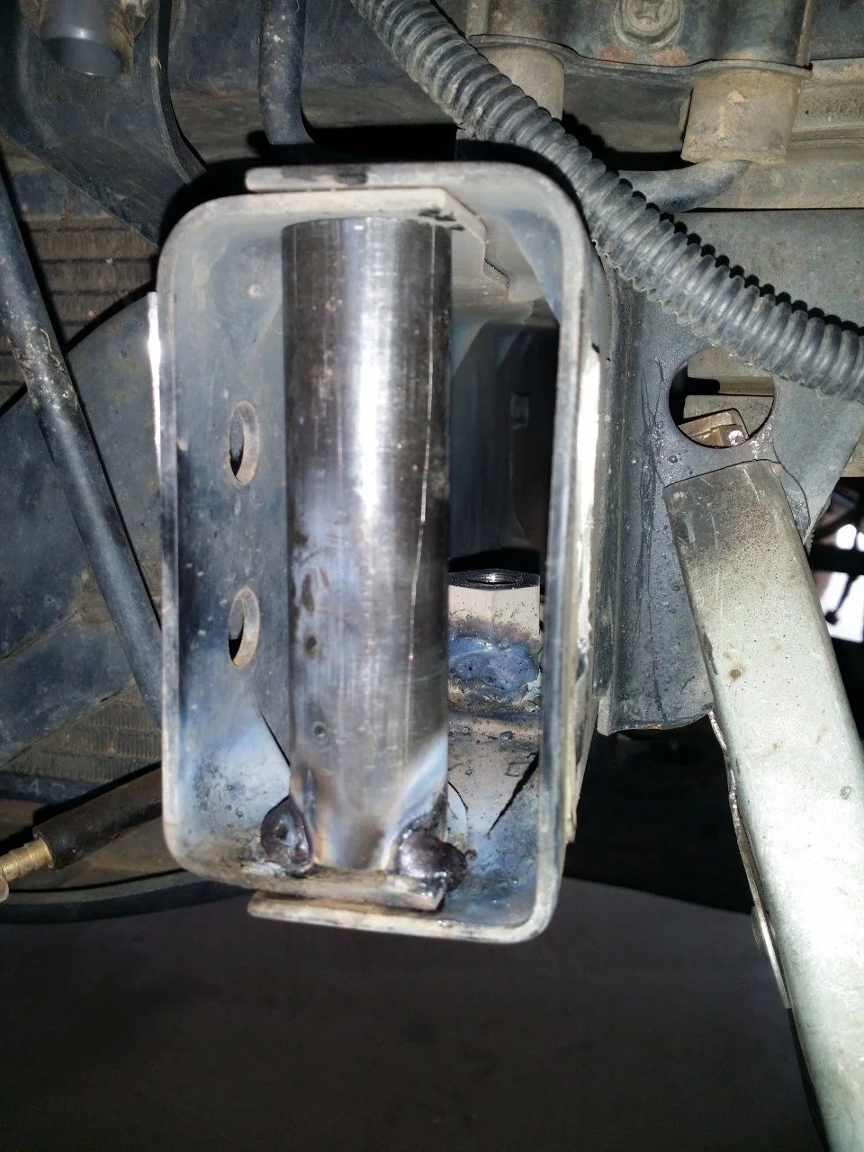

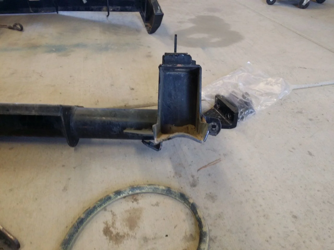

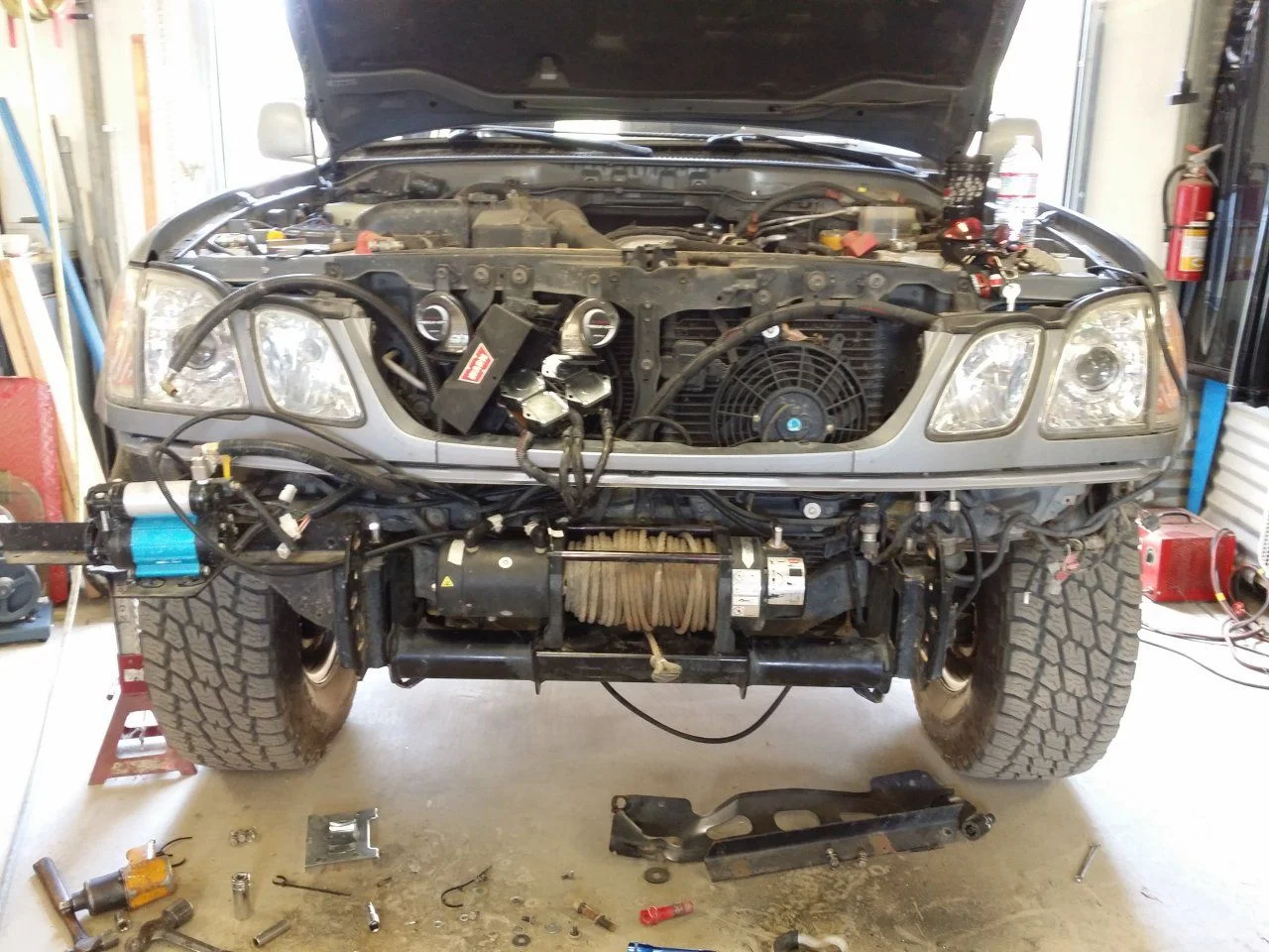

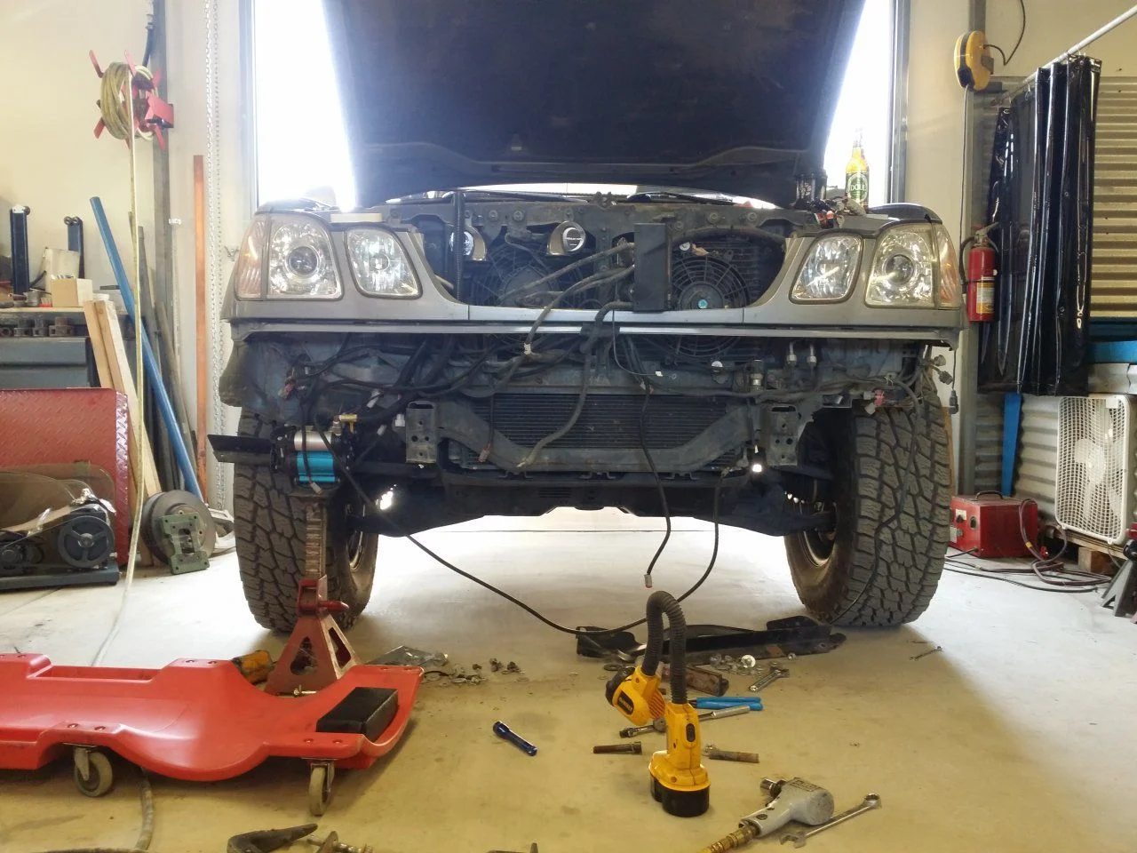

I ripped off my Ironman bumper, winch cradle and my winch to fix a bent winch cradle, stripped captured nut in frame and to reinforce the mounting interface between the winch cradle and the frame. I'm not too happy with the normal IronMan setup. We had to cut the frame horns off of the front of the frame (Slee bumper install style) so we could weld an additional 14mm x 1.5 nut (Same theads as 100 series lugnuts. We actually used an extra oem lugnut and machined both ends off of the lugnut.) on top of the stripped out frame captured nut. We also put a sleeve inside the frame for the front mounting bolt, so that the front most of the three bolts was actually doing something. Lastly, we tossed the u shaped spacers that fill the gap between the winch cradle and the bottom of the frame with 1" x 2" aluminum bar stock drilled for the three mounting holes. When it was all put back together I installed my new 30mm TJM synthetic winch line and a Slee aluminum hawse fairlead.
What is everybody with either a ARB or Ironman combo bar doing about the fact that the fairlead is recessed to far behind the bumper? On a side pull, the line will rub against the bumper edge due to the fact that the fairlead pocket is recessed and designed for a roller fairlead.

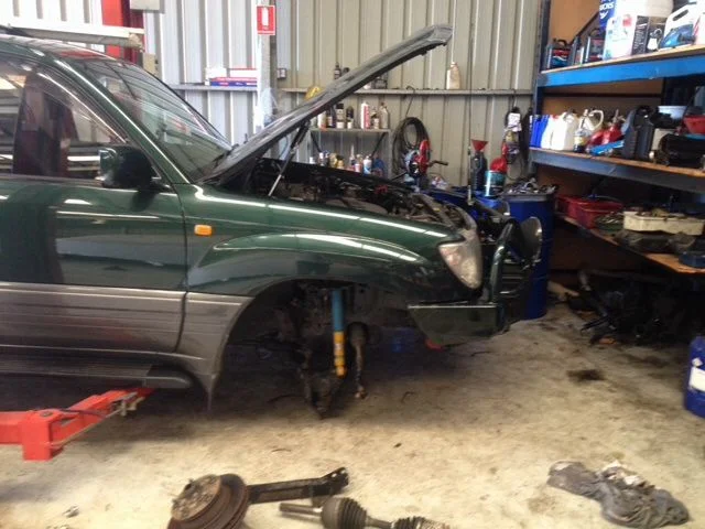

And diff lock time! Managed to borrow a mates hoist for the weekend, so got stuck in to them
...via IH8MUD app
A few pics. The first is the bent winch cradle. The second is the drivers side post reinforcement and repair.
