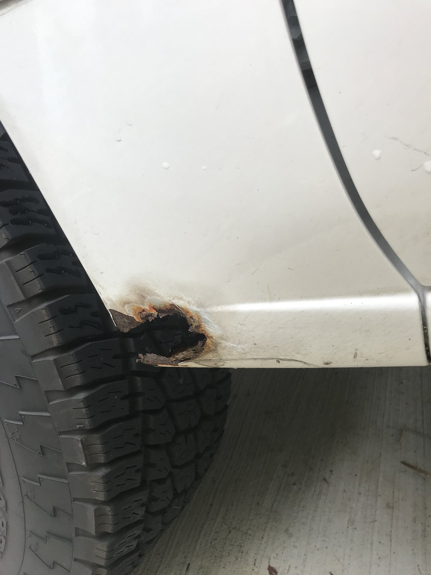

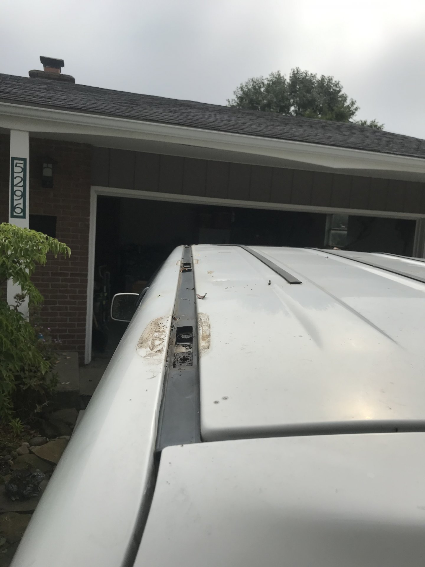

Starting prep to raptor line my truck, removed roof rack last night. Going to start sanding this evening and patch a fender hole. going with Mesa grey…oh and I ordered an airaid intake, my stock intake muffler thing is falling apart with only one mounting tab in tact.
At this point I’m not sure the old fender is worth the time and effort and will probably just replace it. Rot is too bad toward the bottom rocker portion.

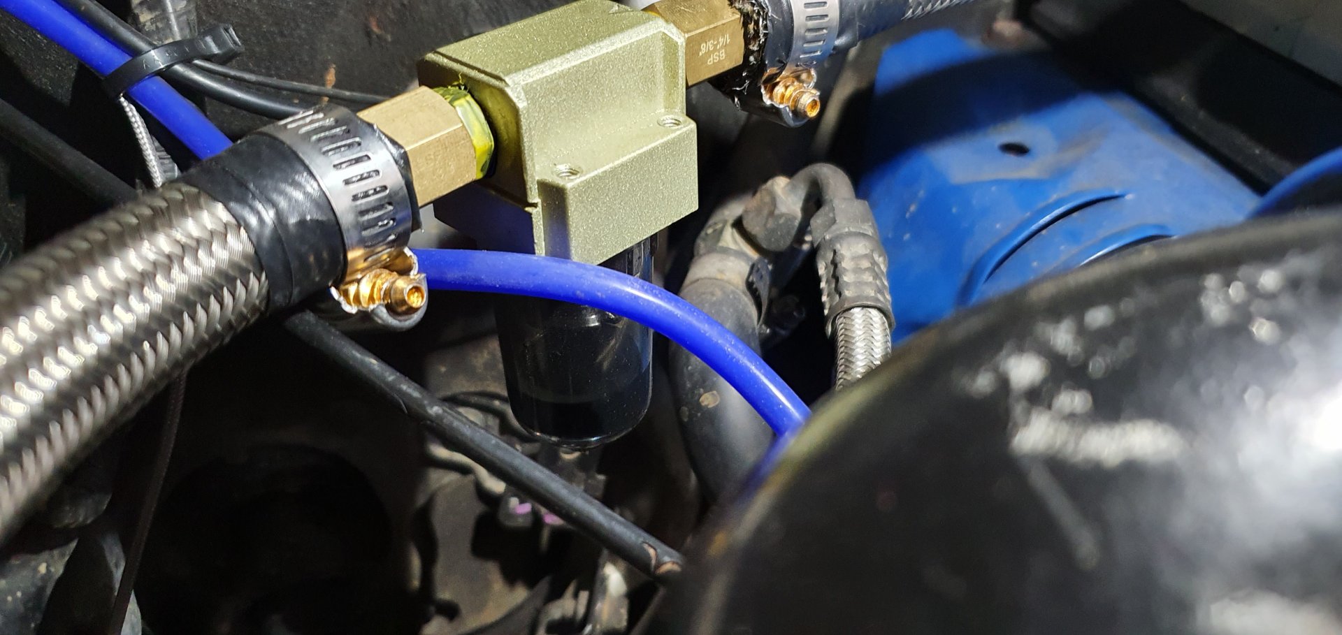

Did you do a post on the catch can
Not a proper one, all I did was order an air/oil seperator off ebay for $15. Similar to the jegs one if that's avaliable for you. I tested the flow by breathing through it and it didn't seem to obstruct flow by much at all lol, I guess it would be better to put steel or copper mesh inside the canister to increase surface area for the oil to get trapped in but the original brass looking filter does it alright
Thanks I'll do a little digging
This one? Earl's CT100ERL: Oil Catch Can Breather Tank | JEGS - https://www.jegs.com/i/Earls/361/CT100ERL/10002/-1

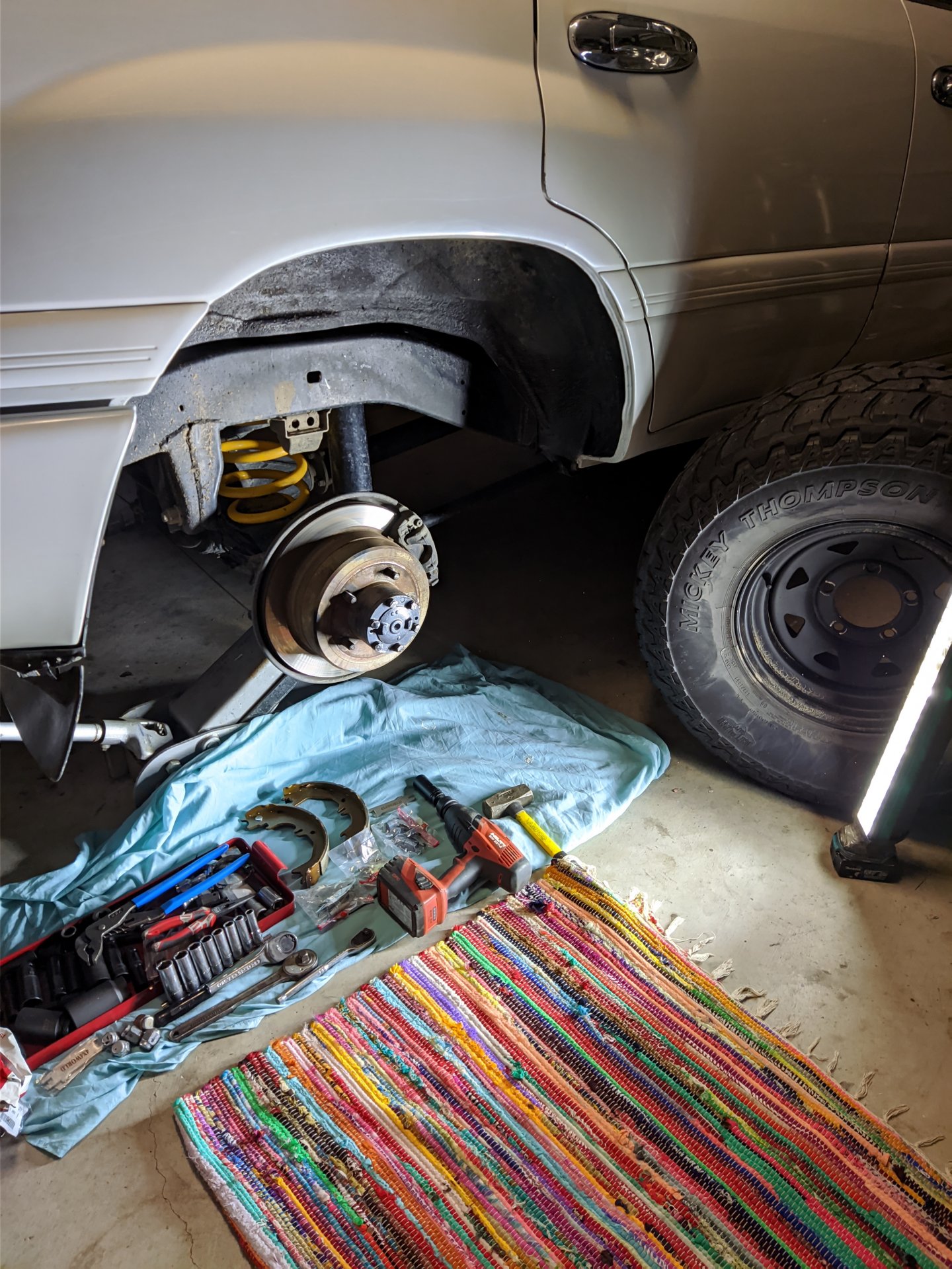

Handbrake job was fairly simple. Biggest pain is that offset pin that you've gotta hold with your 3rd hand to get the spring and retainer on.
This kit I got didn't have any new springs, and one fell out last time I changed rotors
Found a spring close enough, cut it off and it just works.
