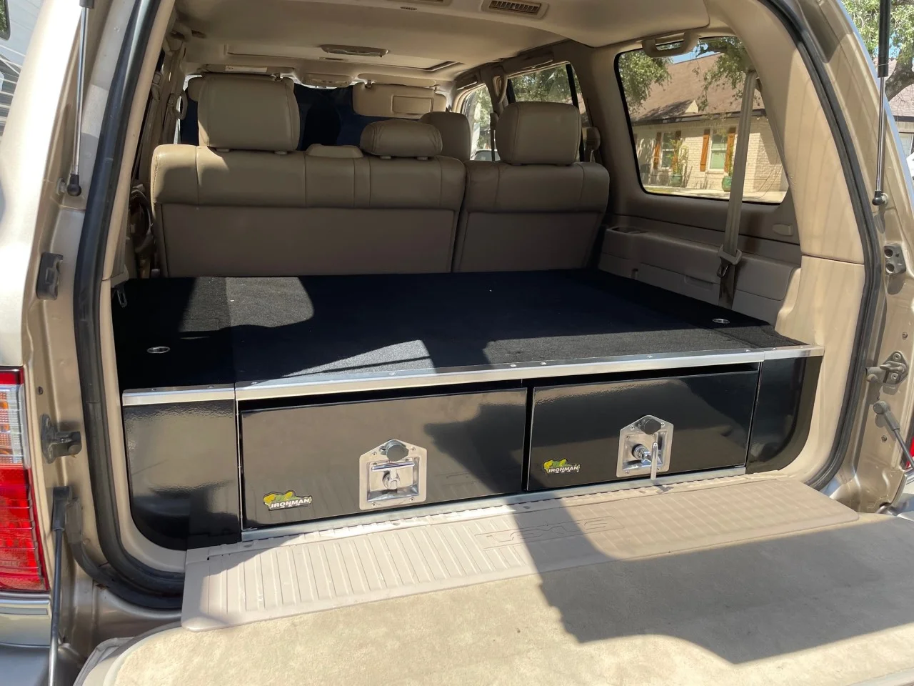

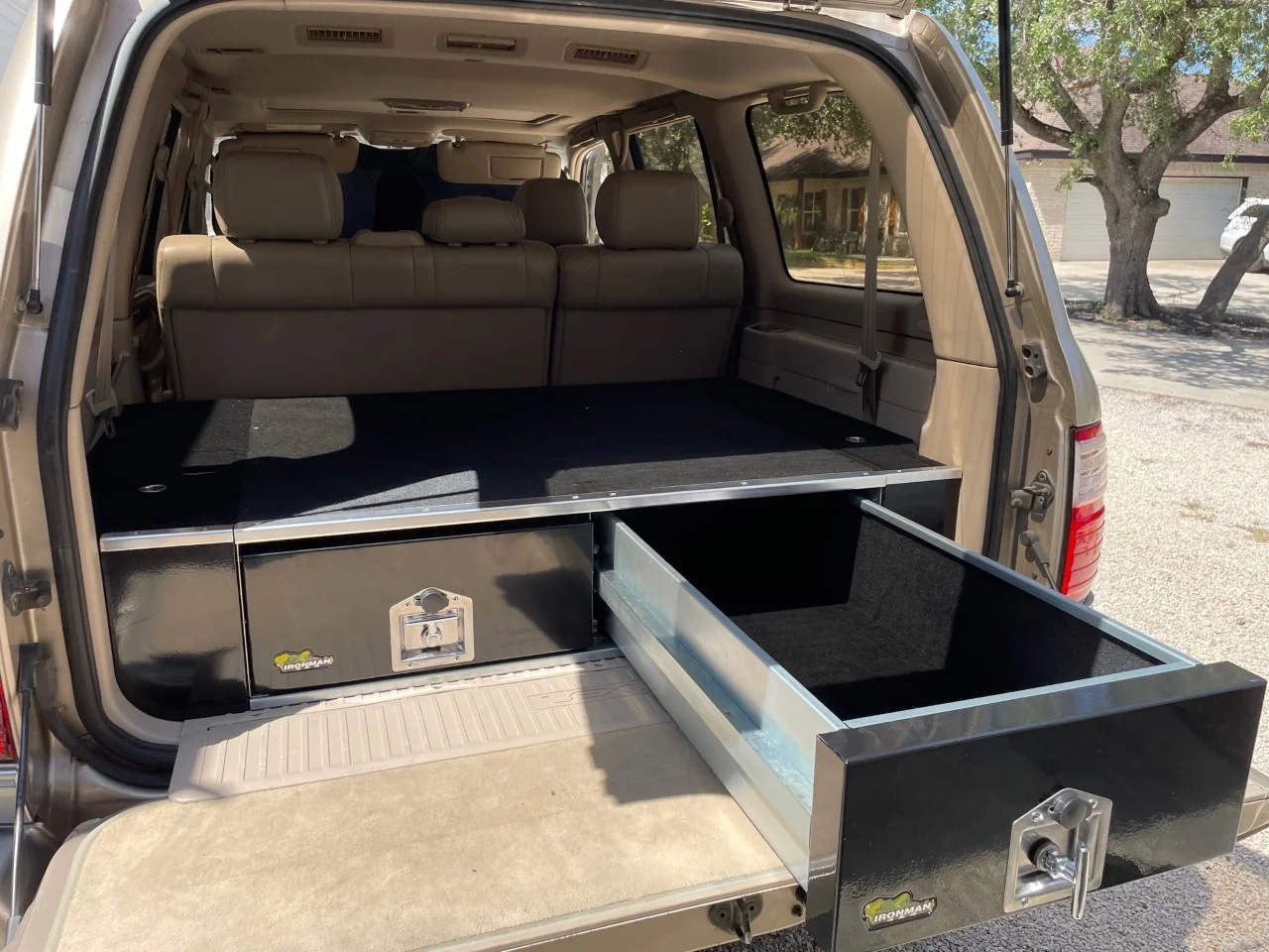

Finished installing the Ironman4X4 drawers and wing kit into my LX470.
What I like about them so far:
1. Cost. I believe it was 920 or so delivered to my business address.
2. Drawers are tall and deep. It will hold A LOT of useless junk that I like to carry around.
3. Easy installation. Once you get the crossbars set to right holes it basically just bolts into place.
4. Twist lock handles with separate keyed drawer locks.
What I don't like about them so far:
1. Drawers and wing kit obviously made in different factories as the carpet shade does not match. Easy fix.

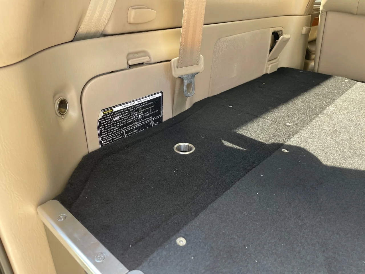

2. The wing kit makes it impossible to open the jack/tool location on the left side of the vehicle and also the small compartment on the right side so you can keep anything in those. I may use these as a template and make my own with a piano hinge or something.

That looks good, i just googled it and got a bunch of different drawers sizes and wings kit is separate, total comes out to a lot more than $920, am i looking at the wrong item? Also any idea how much the whole thing weighs?
1000mm twin drawers, Wing Kit for the 100 series, use code LABORDAY25 at checkout and now it will be less than 900 dollars. No idea on weight but I had no help carrying, installing moving the parts around. I would say less than 100 lbs total.
thanks for the info! do they line up with the rear seats once folded down? wish they list the external dimension for the box, i know the dead space between the wheel arch plastic to plastic is 42", which i made my custom box upon. I'm lazy now and jsut want to buy
Edit, i found the specs. exterior box dimension is 40x40 basically, and weighs 176lbs

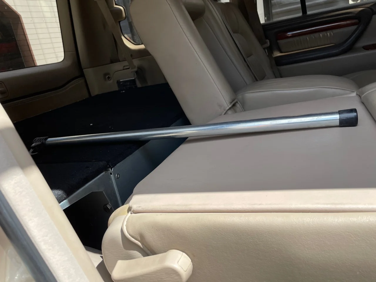

This is how far the rear seats recline. When folded down, the seats is almost flush with the top of the drawers. There is about 4 inches of dead space from the back of the seats to the back of the drawers.
3. The goofy Green Man logo stickers on each drawers. Sure you can remove them but they actually have indentations on the drawers for those to go in.
The Dobinsons wing kits also block the access on either side which has me considering relocating all of the stereo crap in those cavities since I can’t get to them for anything else.
