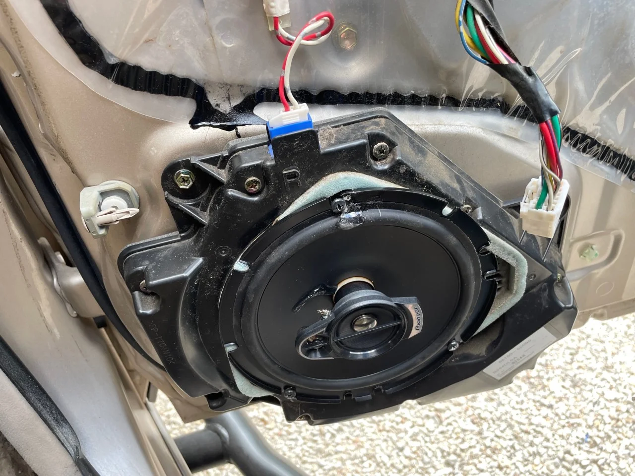

I thought my right rear and left front speakers were blown because they made no sound. Got around to swapping the rears this afternoon and it still didn't work once I swapped it. I started jacking with the door and speaker started magically working. Turns out the wire was broken inside the little rubber boot. I just ran a couple feet of bypass and the speakers are working again. Guess I didn't need the new speakers after all. Anyone else have that happen? The front left speakers also had a broken wire.
