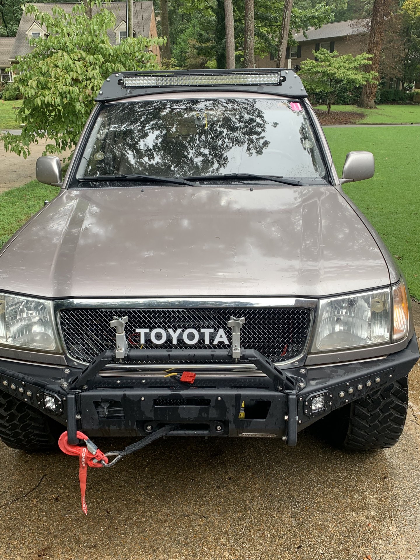

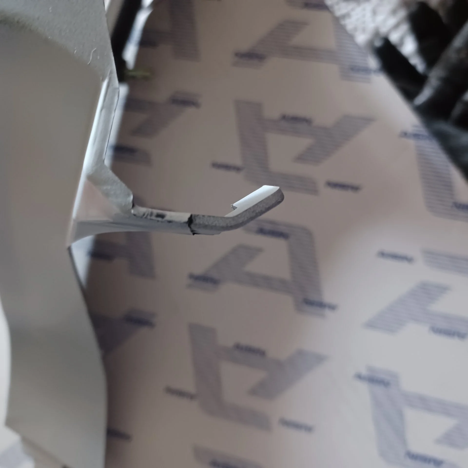

Was bored and bad things happen when you're bored. Scuffed the chrome masked off the grey and laid down adhesion promoter. Then proceeded to lay down gloss black. All went well to the upper right corner started to fish eye. Thought I wiped everything down good but apparently not. I'll wait for it to cure a little more and go back and same that portion down and respray.

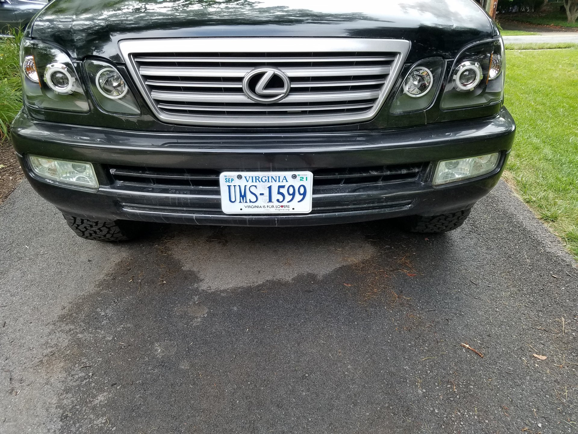

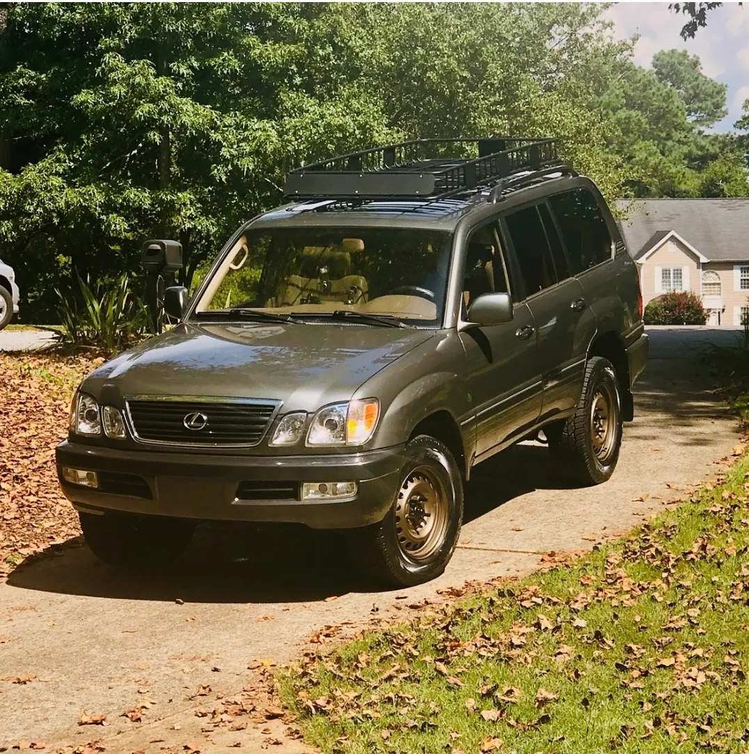

I did the same thing while I was installing the Eagle Eyes. But with graphite.

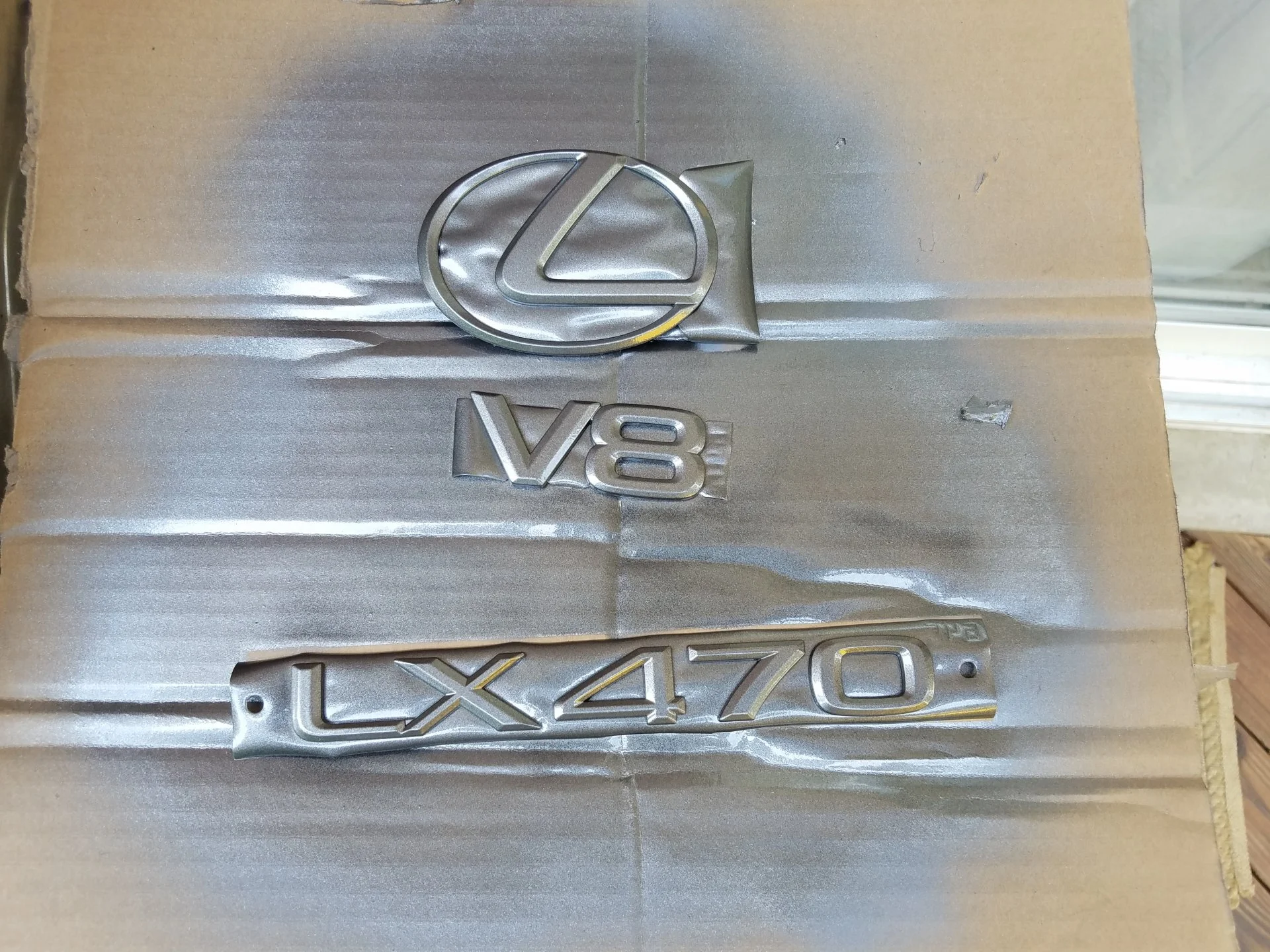

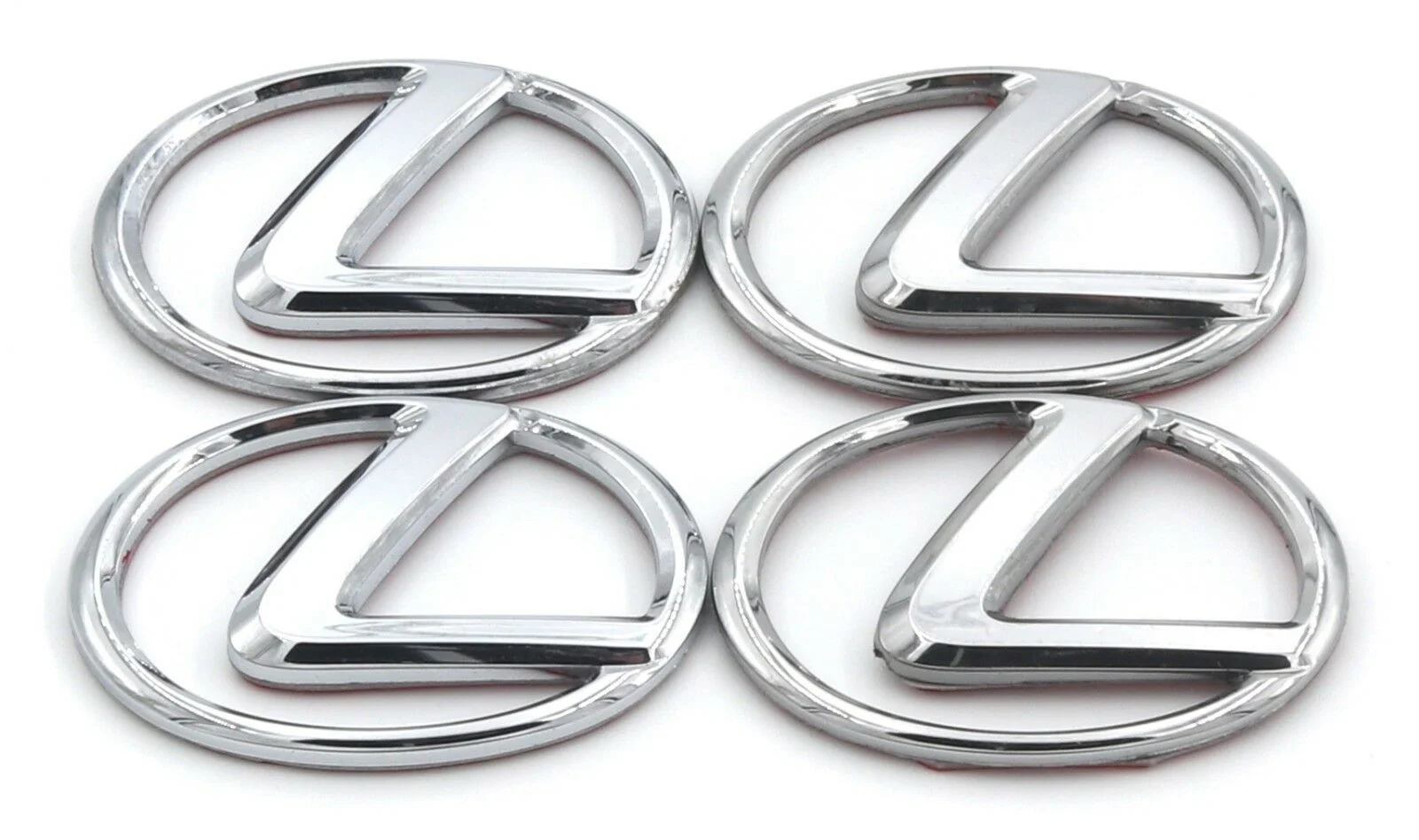

Also did the new badges.
Oh I like that as well. Did your light assembly come blacked out? The grille looks almost like satin finish
Yes. They had two (2) options, blacked out and chrome.
Amazon product ASIN B003ZIO884
I used Duplicolor Grey Engine Primer, then 3 coats of Graphite Wheel Coating and Wheel Clear Coating. Hopefully it won't chip.

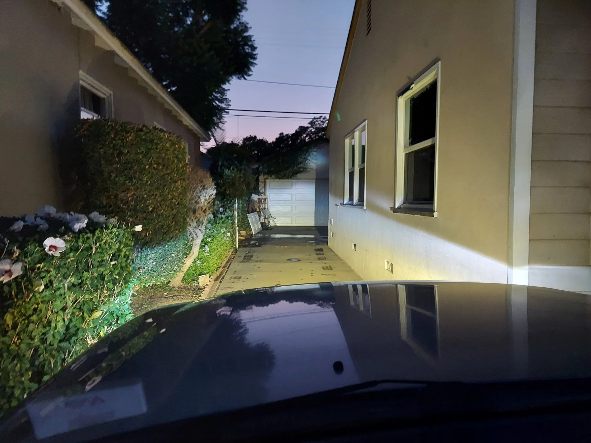

Oh ok The way those photos are shown it seemed like there's not lens in front of the projectors. No I want to pull my lens off and paint in surrounds satin black. Btw did you wire your halos? If so what did your tap into? PO replaced the OEM housing and didn't bother too wire in the halos

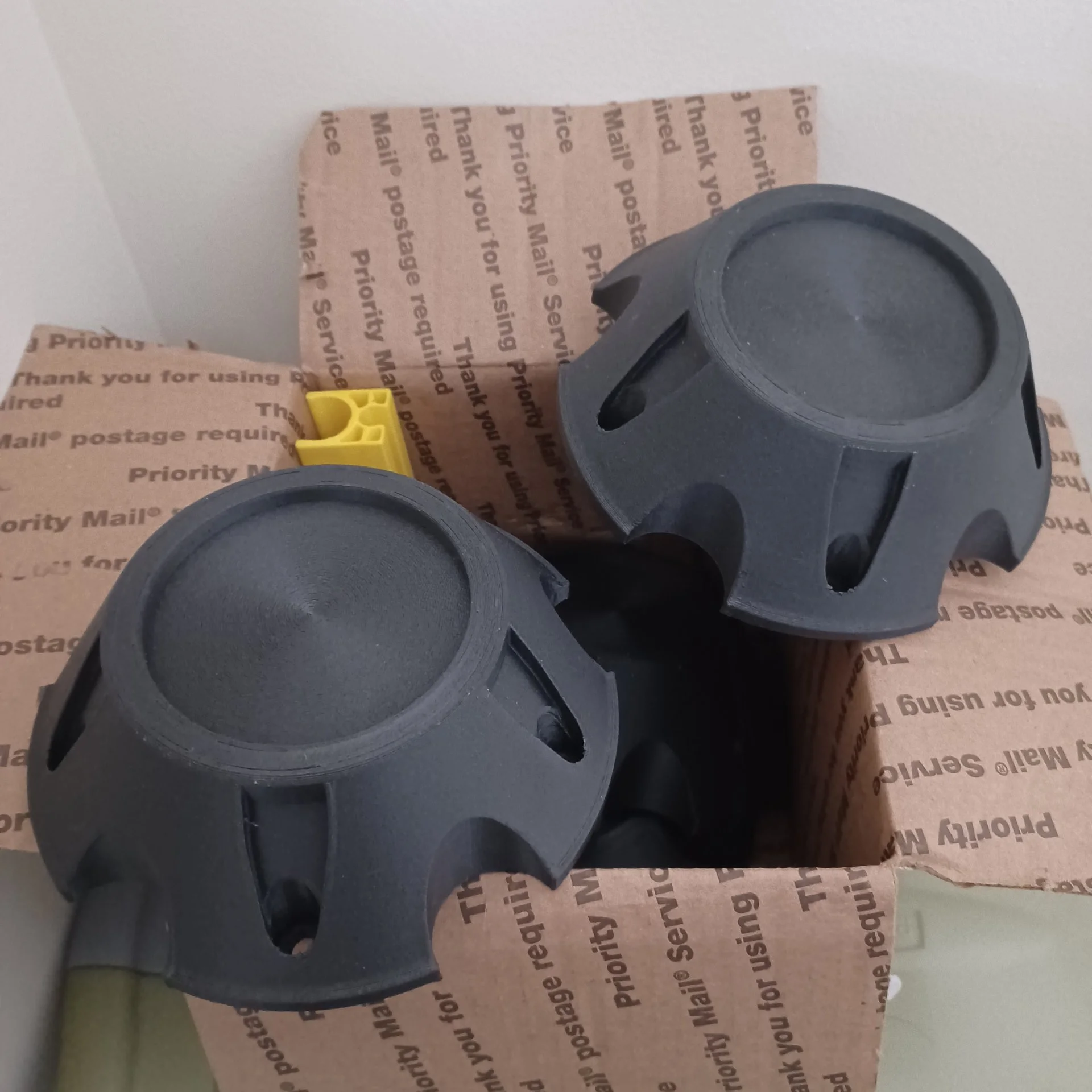

Just got these from Ben... Looking forward to getting them installed.
Not yet. I want to run them as DRL and need to figure how to do it.
I disable the DRL with TechStream thinking it was a POC and turns out the DRL uses the High Beams.

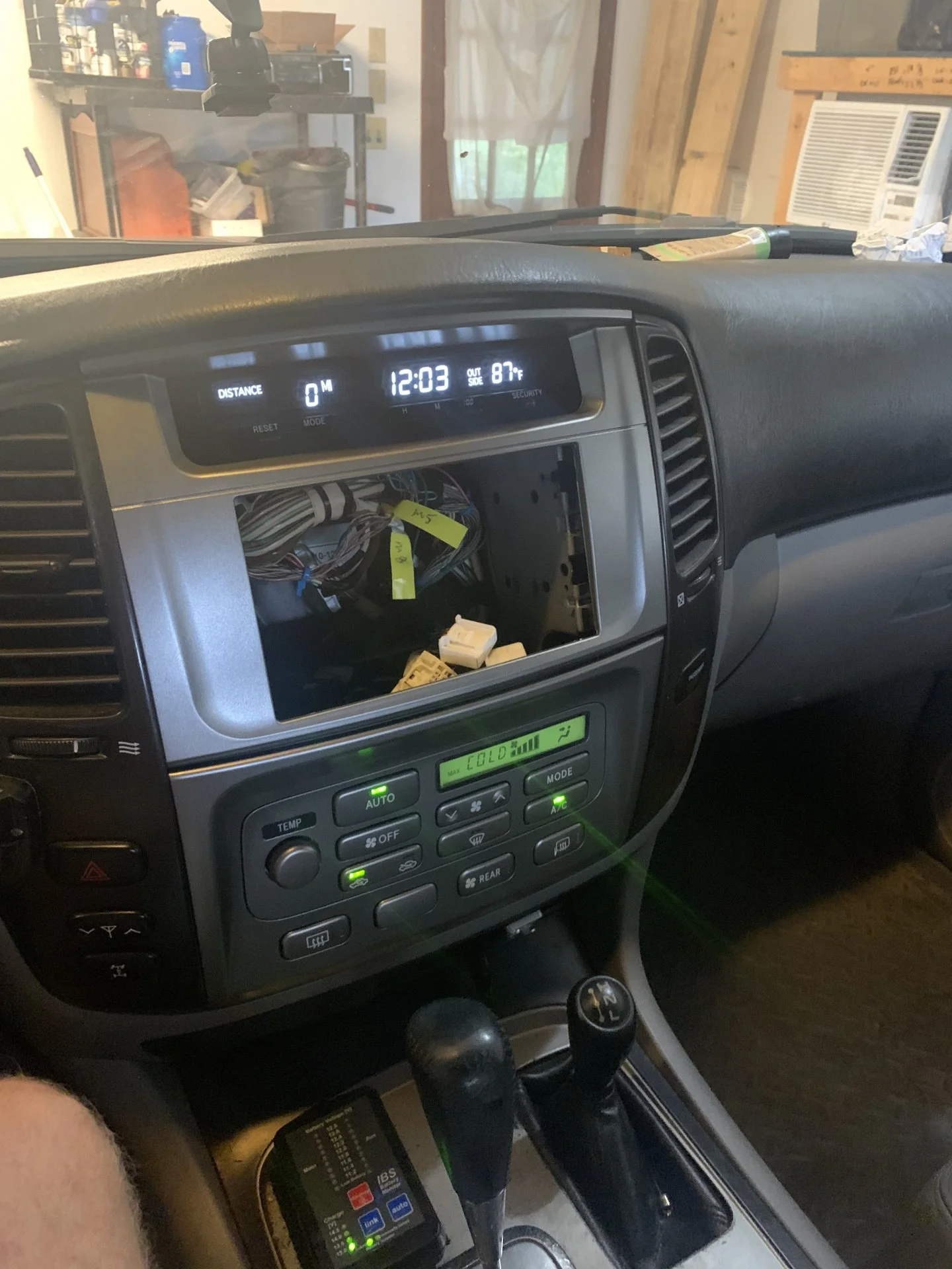

I just installed a new Sony head unit and backup camera. Then I accidentally broke a nipple of my intake while removing it. A new intake is over $400 so I'm going to try building up a layer of epoxy first and if that doesn't work use a brass fitting. Also, it's time to replaces just about all of my vacuum lines.
Let’s see the head unit. Inquiring minds insist.
