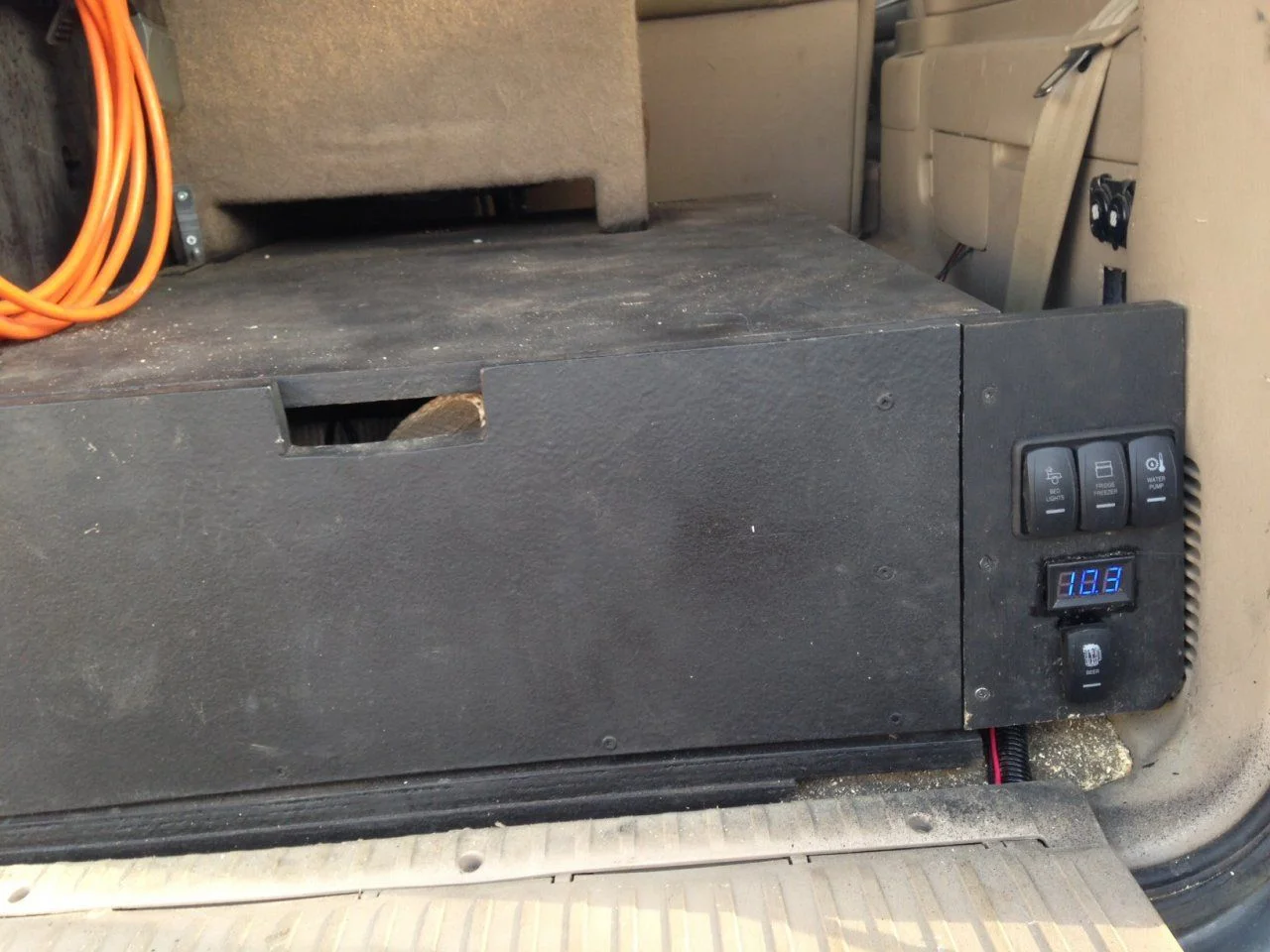

And a bit more progress on my s...l....o....w.... storage drawer build.

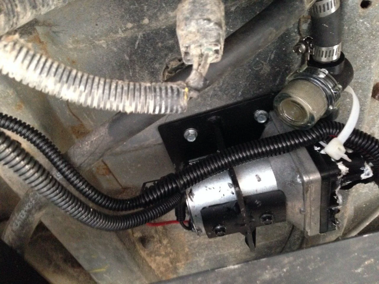

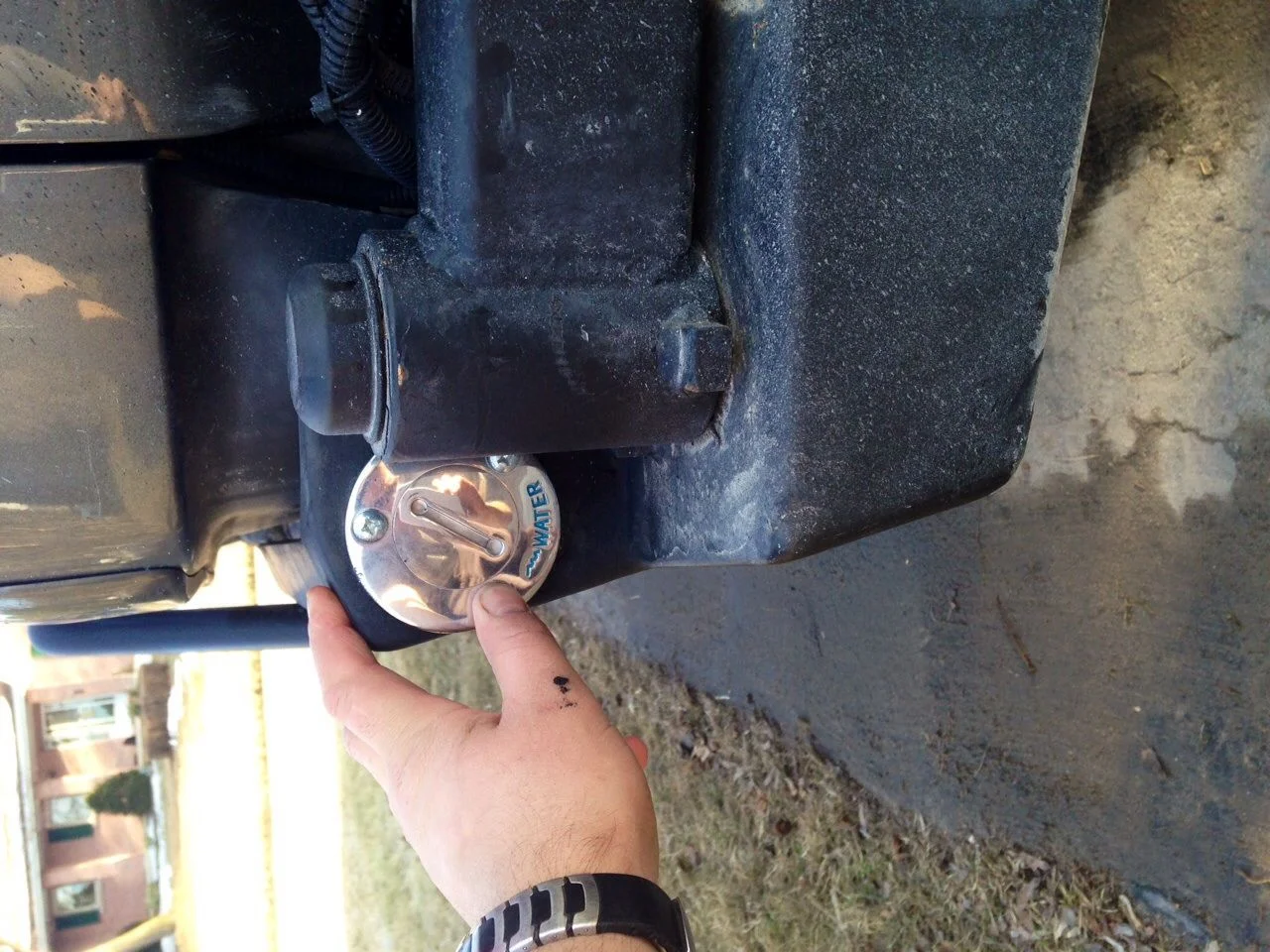

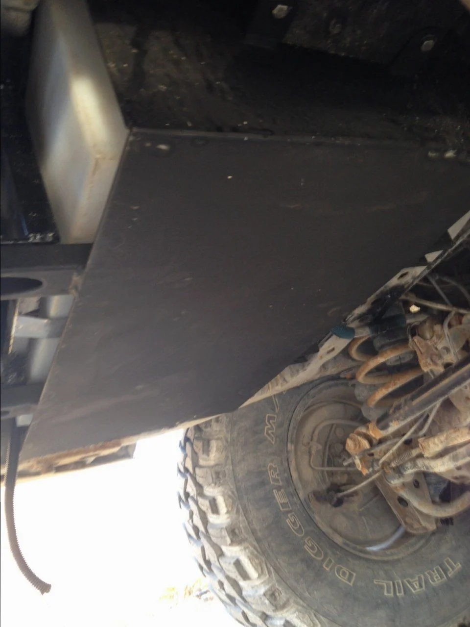

finished up the on board water tank install, with skid plates, custom pump mount and water intake.. it's all plumbed to the heat exchanger and works quite well..

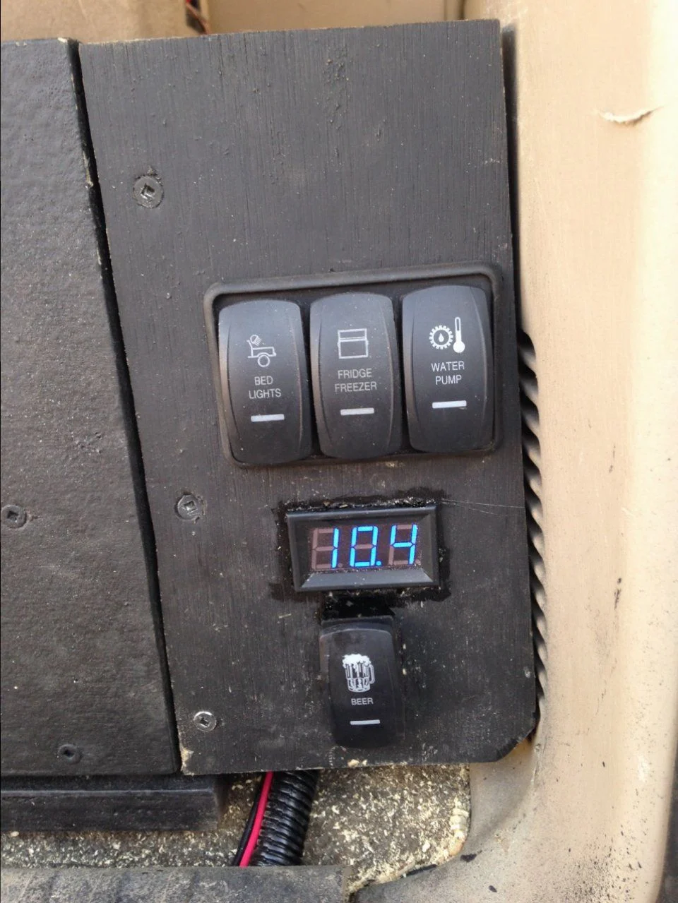

temperature gauge installed as well, straight to the tank and allows me to switch the pump off when the temp is at the right spot. showing celsius, which is what we use this side of the border.

View attachment 883919 View attachment 883920 View attachment 883921 View attachment 883922 View attachment 883923 finished up the on board water tank install, with skid plates, custom pump mount and water intake.. it's all plumbed to the heat exchanger and works quite well..

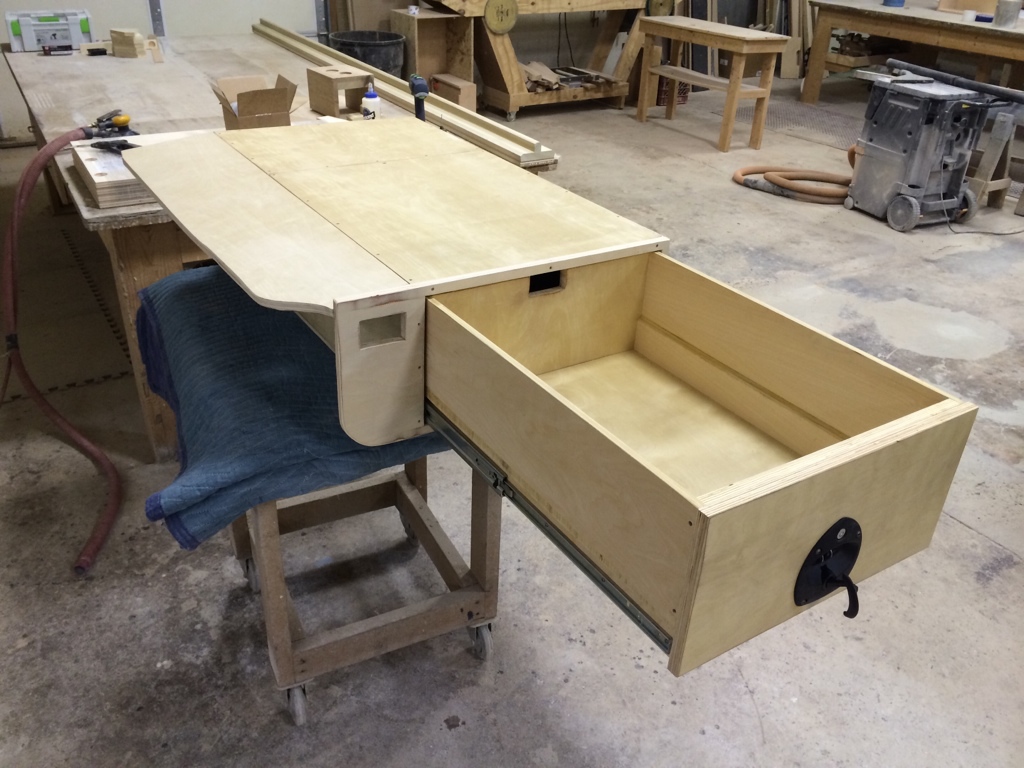

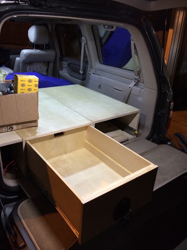

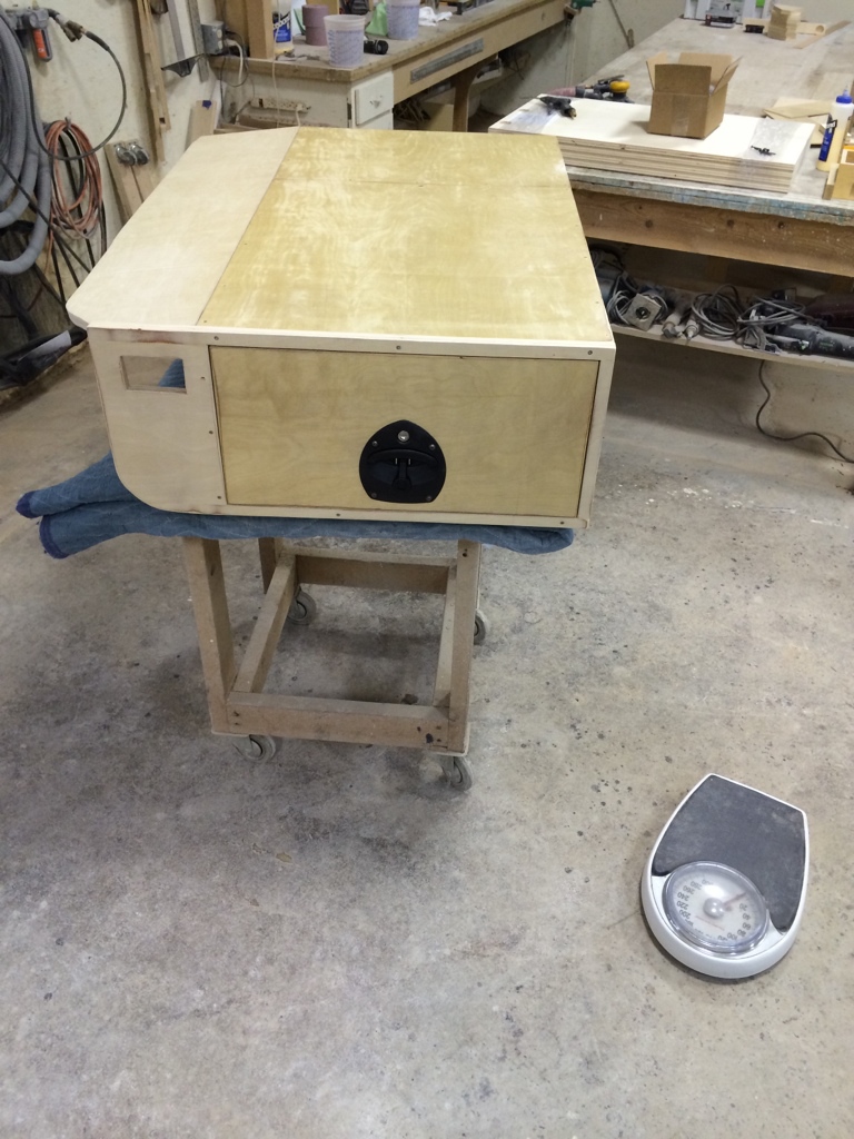

Weighed my cargo drawer box. The driver side setup has a space in the back for 2x8" subs, 24" heavy duty accuride 3607 slides and a 26" drawer. Carcass made of 3/4" 11-ply birch, drawer sides and bottom 1/2". Weight includes wings and front panel as seen in photo. 70#
I didn't have the drawer for the long passenger side box. Same total dimesnions but one long drawer and the super heavy duty 9308 locking slides and a 3/4" drawer. Carcass alone is 50#. I'm guessing the drawer, side wing, front panel, etc will bring total weight to 80#. So total weight of drawer system ~150#. I believe the 3rd row seats weigh 95#. I removed the driver side seatbelt and some extra mounting hardware, so I probably gained a net 50#. Not too bad!
As sturdy as that thing is you could easily reduce the weight by perforating the heck out of it.
BB is 2.6#/sf. That would take a decent amount of holes to amount to any significant weight savings. I was actually pleasantly surprised that is wasn't heavier! They sure feel heavy lugging them around. :)

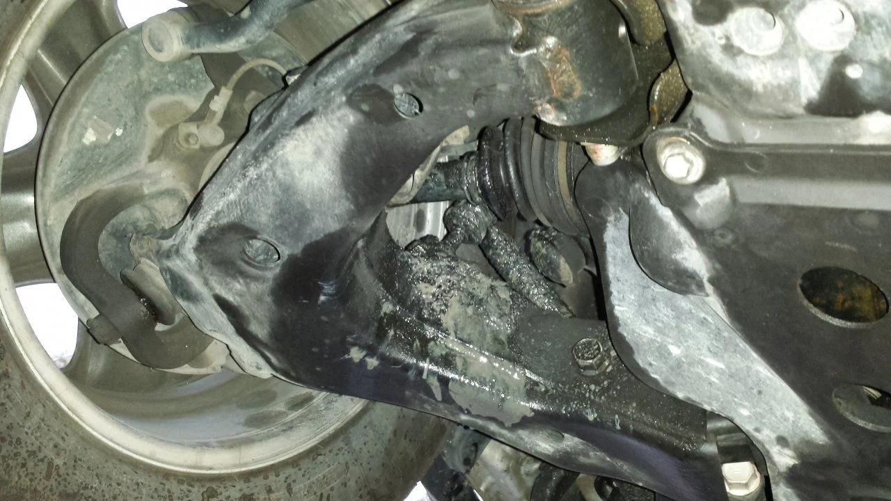

20140402_193629-1.webp Found I had a grimy looking gunk from the axle. If you have this problem, plan on replacing all four boots. Also, I was glad to receive PFran's LED kit. High impact upgrade indeed..
