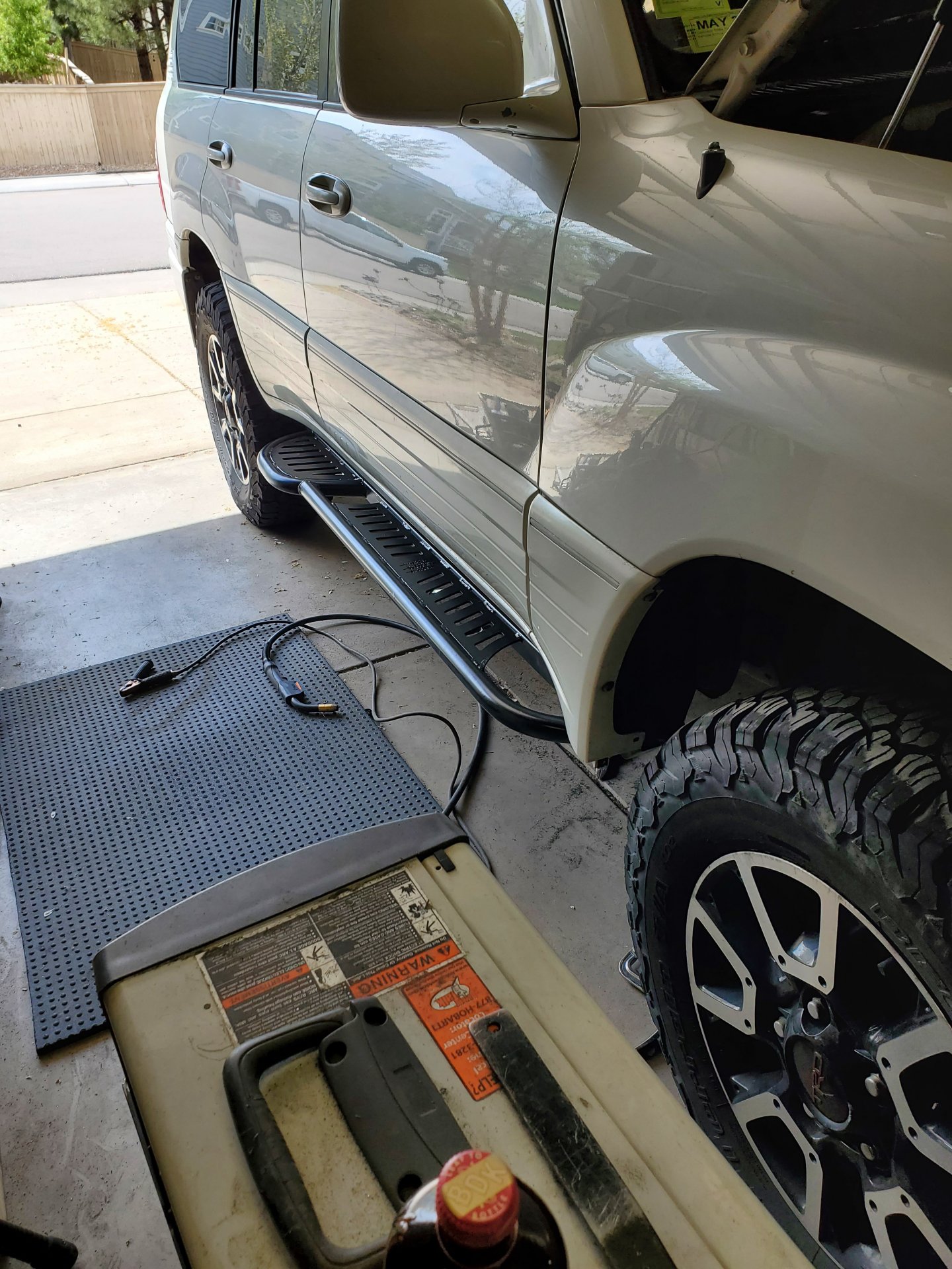

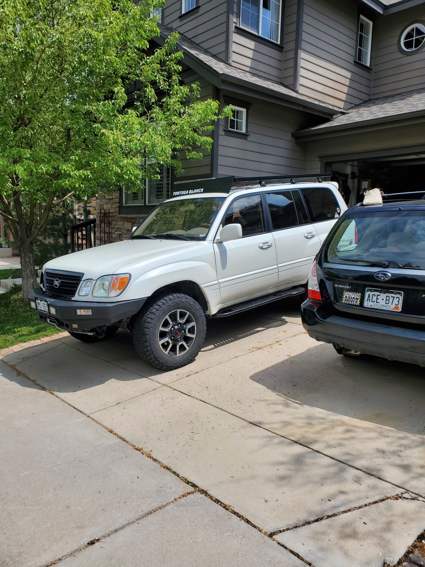

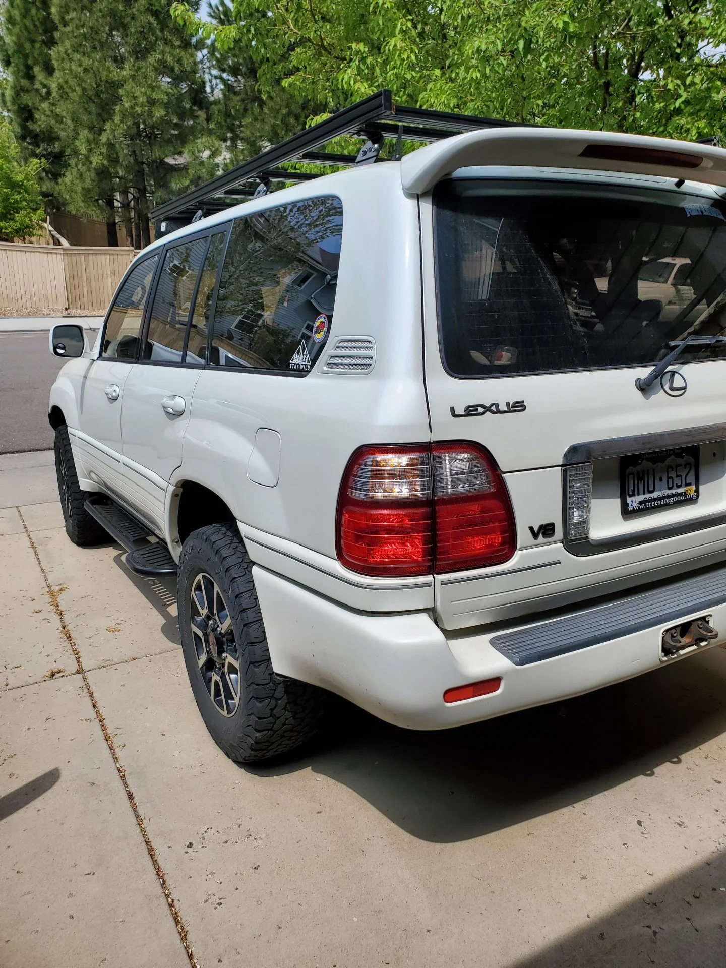

After way too many distractions, and commitments, finally got my Coastal sliders mounted. Nice to have reached this milestone!

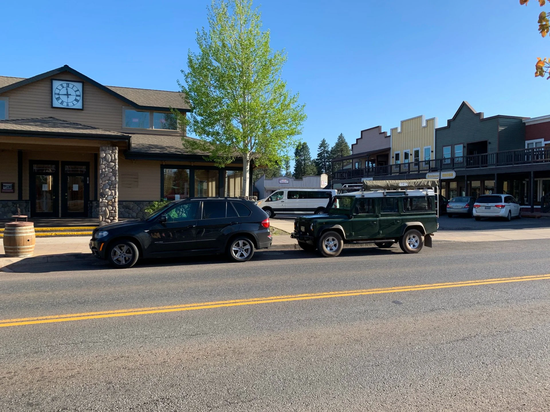

Sorry not a 100 series photo but I stumbled across this gem with the wife while on a day trip to Sisters, OR eating at an old saloon off the main road through town. We left the LC at home since it's quite a trip and we werent planning on doing any trailing that day (needed an alignment after the inner tie rod replacement).
We spotted another Defender earlier that day, but it was a 2 door version, super cool. I love that little town. It's up in the mountains and this is the main road connecting the other towns in the area so you see a lot of cool cars/rigs roll through.

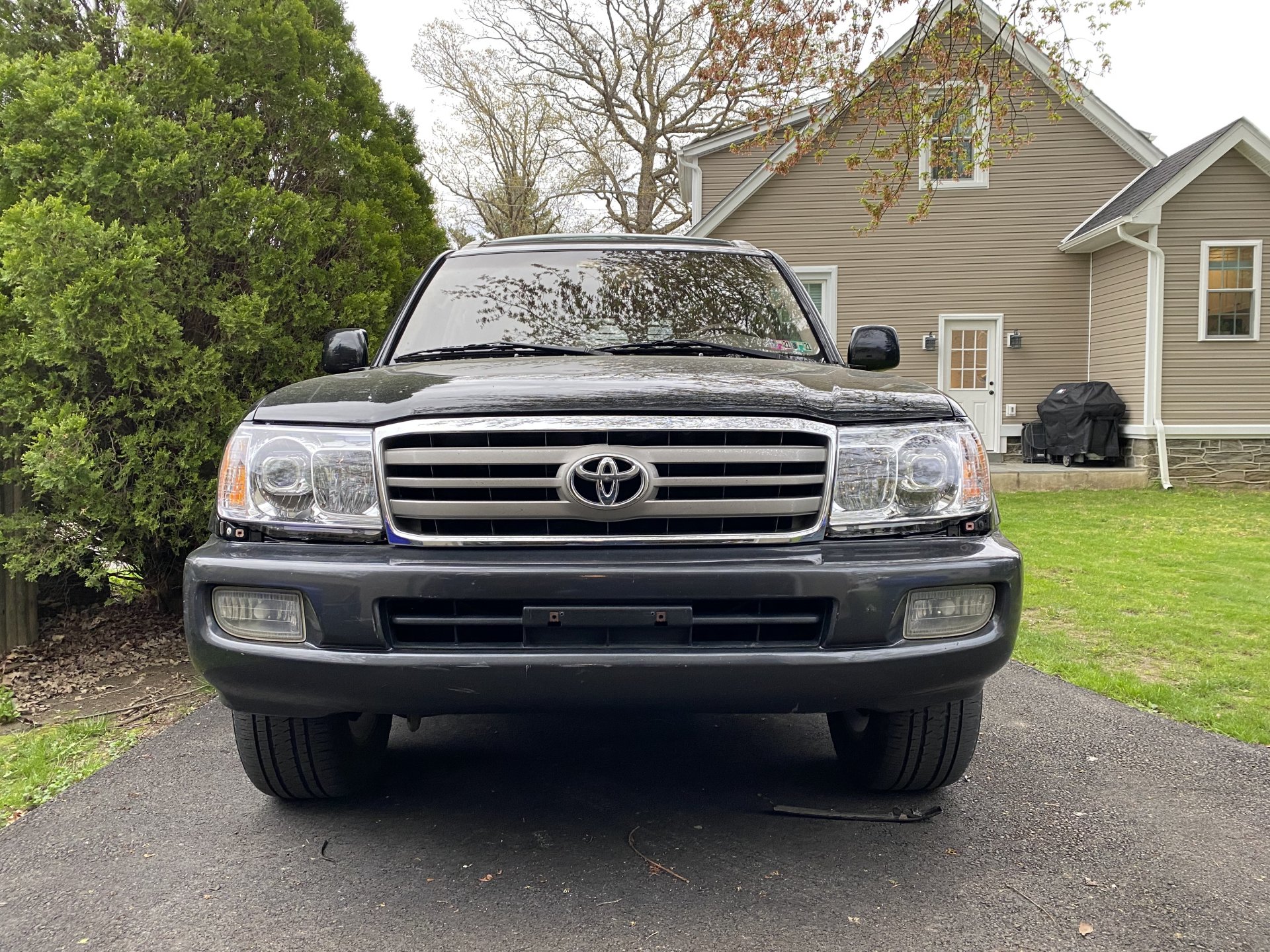

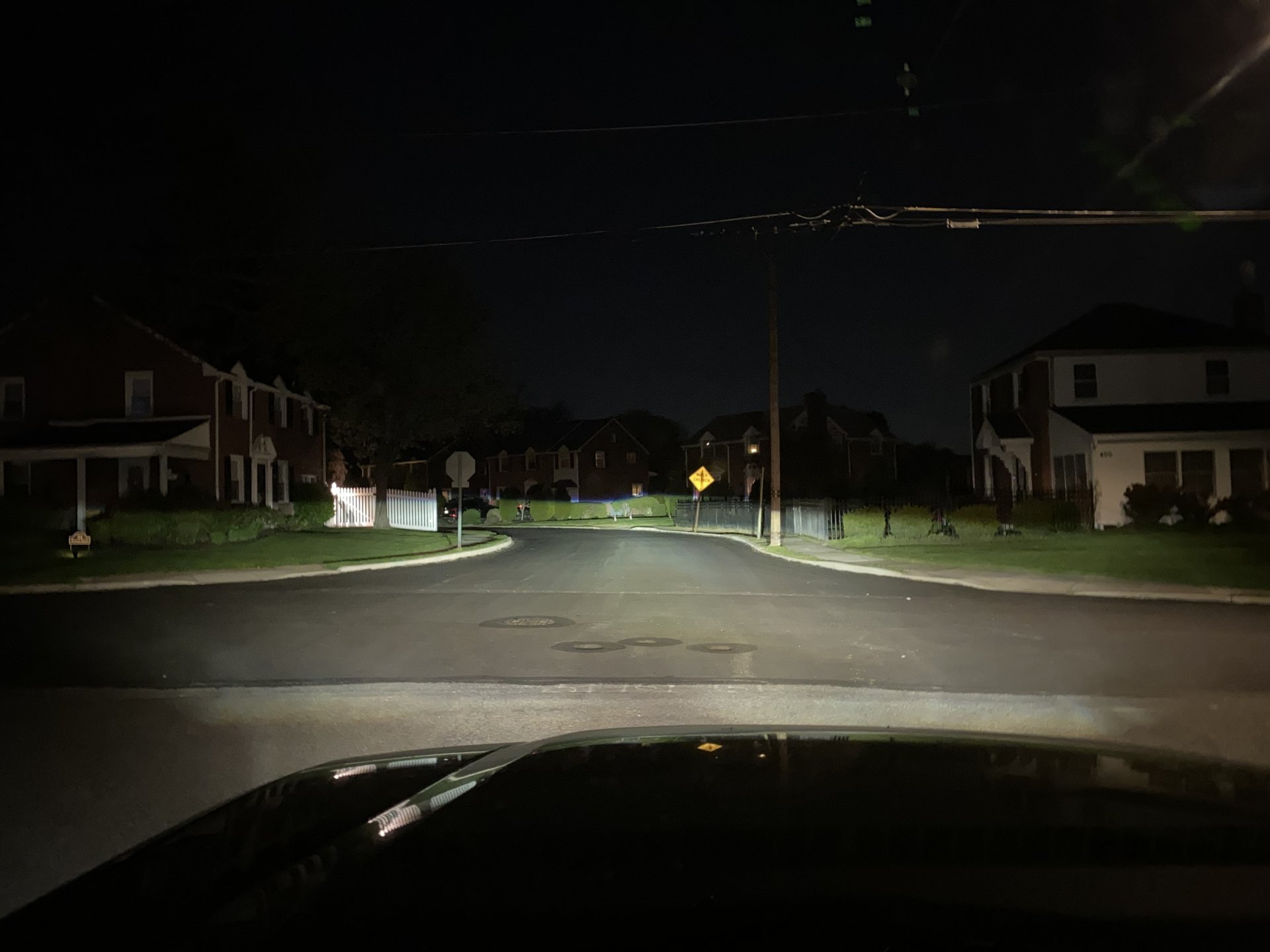

got my retrofit completed and aimed. I went with the Morimoto square lights. Looks a little different than most and I’m assuming a wider spread. Results are awesome, can see so well at night now. I have the high beam splitters so the high beams are full projector + halogen high beam which is a lot

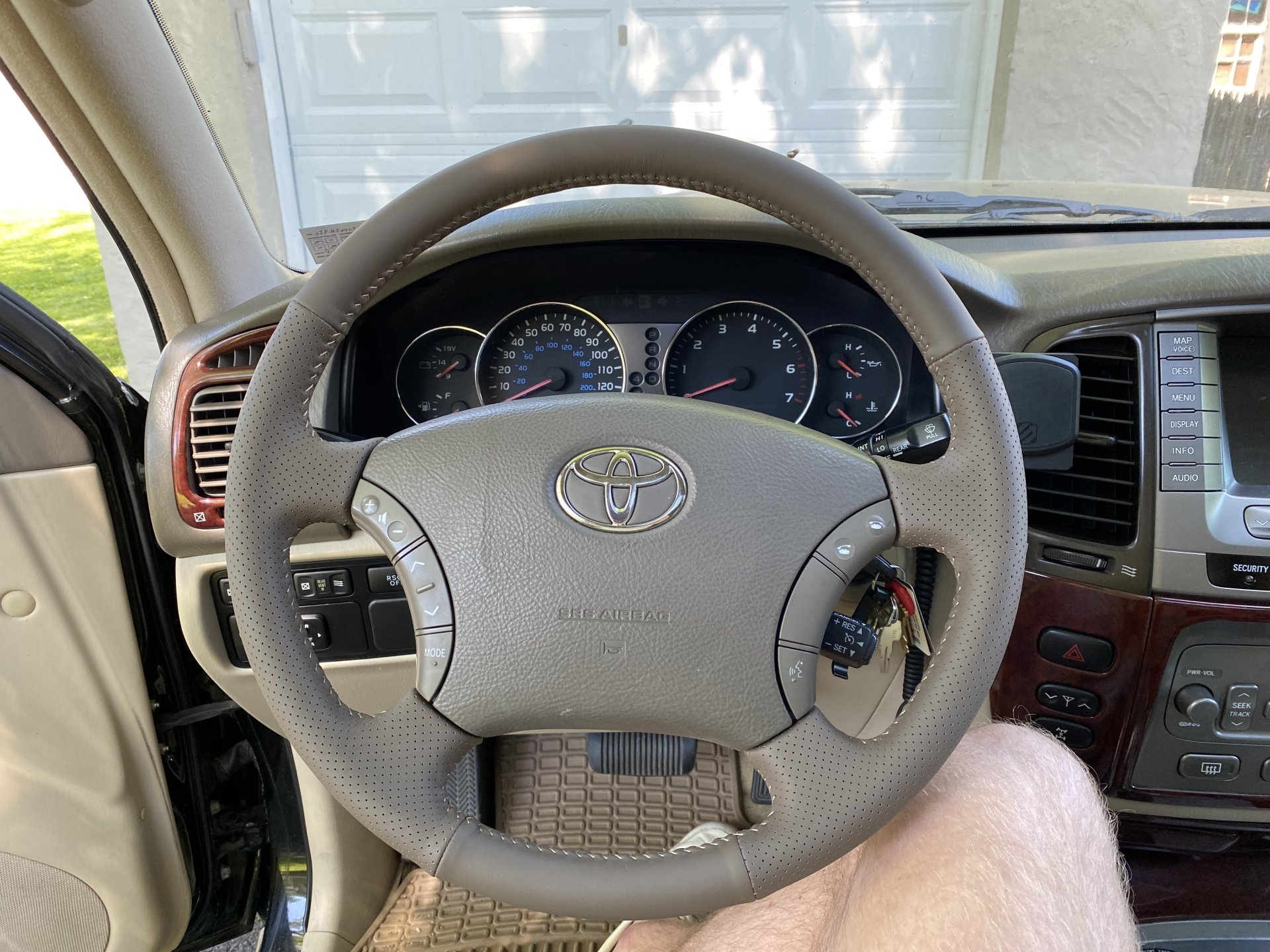

I also got my steering wheel re wrapped by craft customs:

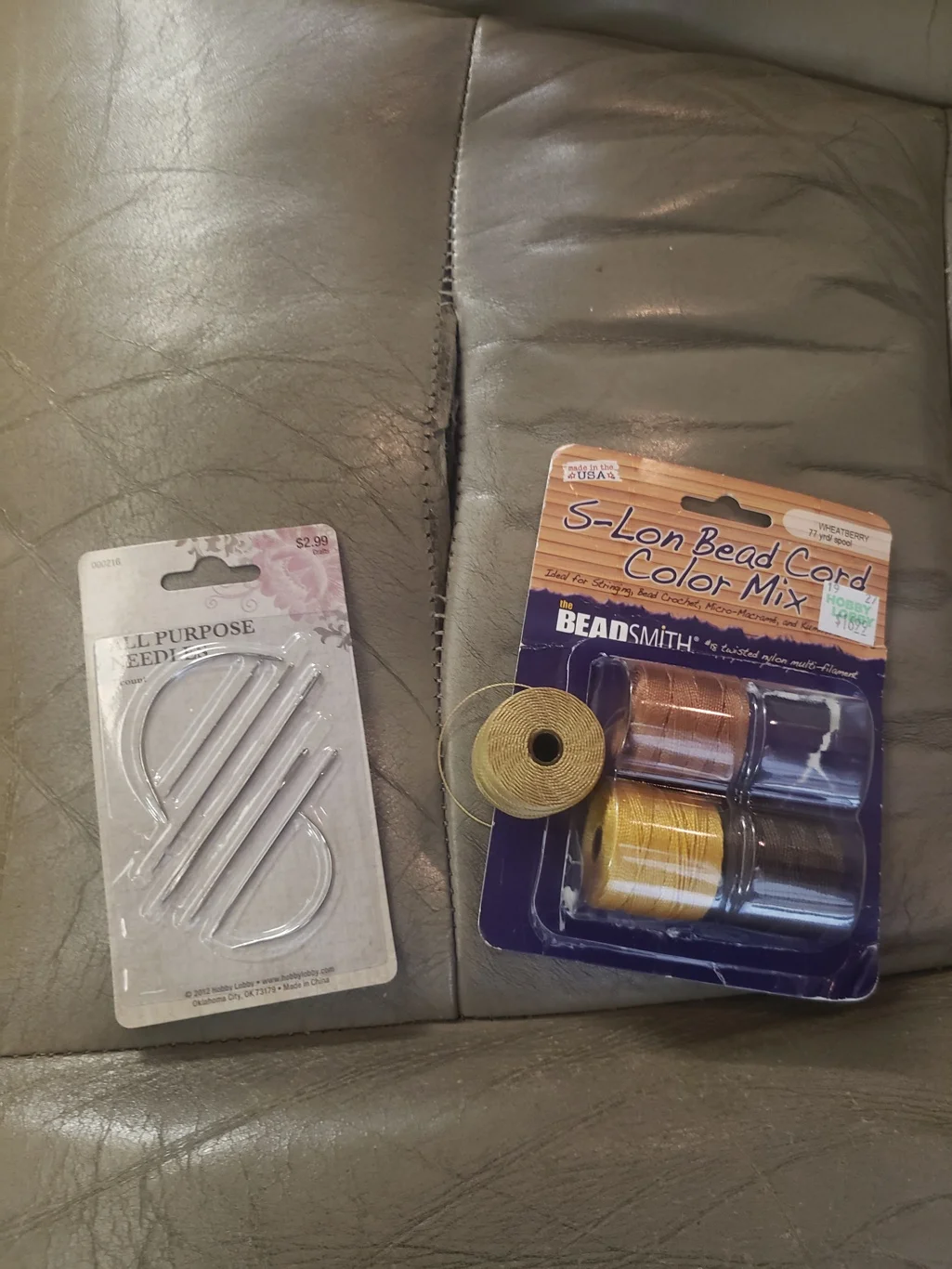

I’ve been wanting to do this as well. Did you take the seat and leather off? (Assuming so LOL)
Nope. Stitched it in place. I used the curvy needle to get behind the holes. Plenty of room to work but gets a little tight at the end so i couldn't get it perfectly. But plenty good enough!

Looks great. Can you share the parts list for the light upgrade?

I love old Rovers, but Defenders weren't made for tall people or comfort at all. My grandfather's old '83 60 series was more comfortable than my uncle's Defender 90. I think if I ever had the time and money to own an old Rover, a Range Rover Classic would be on my short list...but then again, if I had the time and money I'd probably have a 40 or 60 series. 😁

For sure. Maybe I'll do a write up as well.
Retrofit Source
  • BI-XENON: MORIMOTO MINI D2S STAGE III
    1. 2 × Bi-xenon: Morimoto Mini D2S 5.0: (Square Lens/LHD)
    2. HID BALLASTS: 2 × 35w / D2S: Morimoto XB Ballast
    3. D2S HID BULBS: 1 × D2S: XB 4300K 35w HID Bulbs (Pair)
    4. WIRE HARNESS: 1 × HD Relay: 9005/9006/9012/H10
    5. HOUSING SEALANT: 1 × Butyl: RetroRubber (Black) (says its optional but definitely needed)
  • Panasquare Projector Shrouds
  • 2x High Beam Splitters 9005M > 9005F / 9006F
  • Morimoto Seal Splitter tool (Pry tool which really helps to get the light housing apart)
DEPO Headlights for 2006
Other stuff
  • Dielectric Grease
  • Dremel Tool with cutting blade
  • Shop-vac to blow away cutting powder from your lungs and eyes, and for clean up!

There are like 2 or 3 threads about retrofitting headlights and a lot of the posts are for the glass-type headlights (98-05) LCs so you should have plenty of info.
Not as many posts about mounting in 06-07 headlights. I took lots of photos and screwed up a couple times along the way so I am planning on posting about it.
Looking forward to the write up since I have an 06.

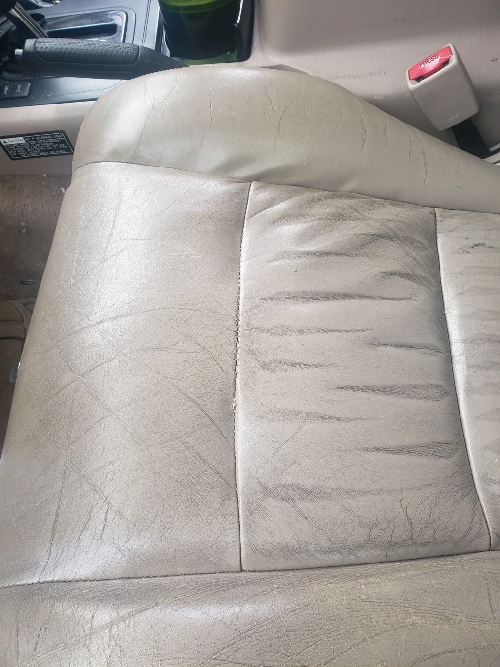

Right on. My interior is in decent condition aside from the tear in the driver seat. Think this will be my next fix lol.
