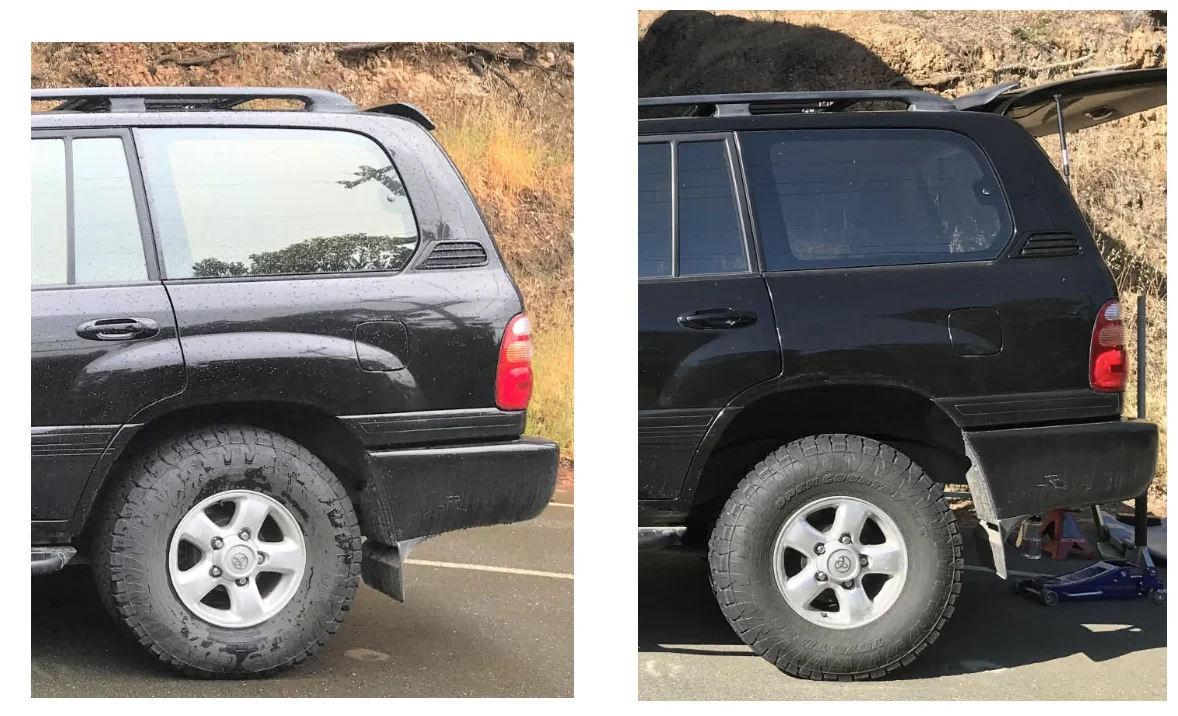

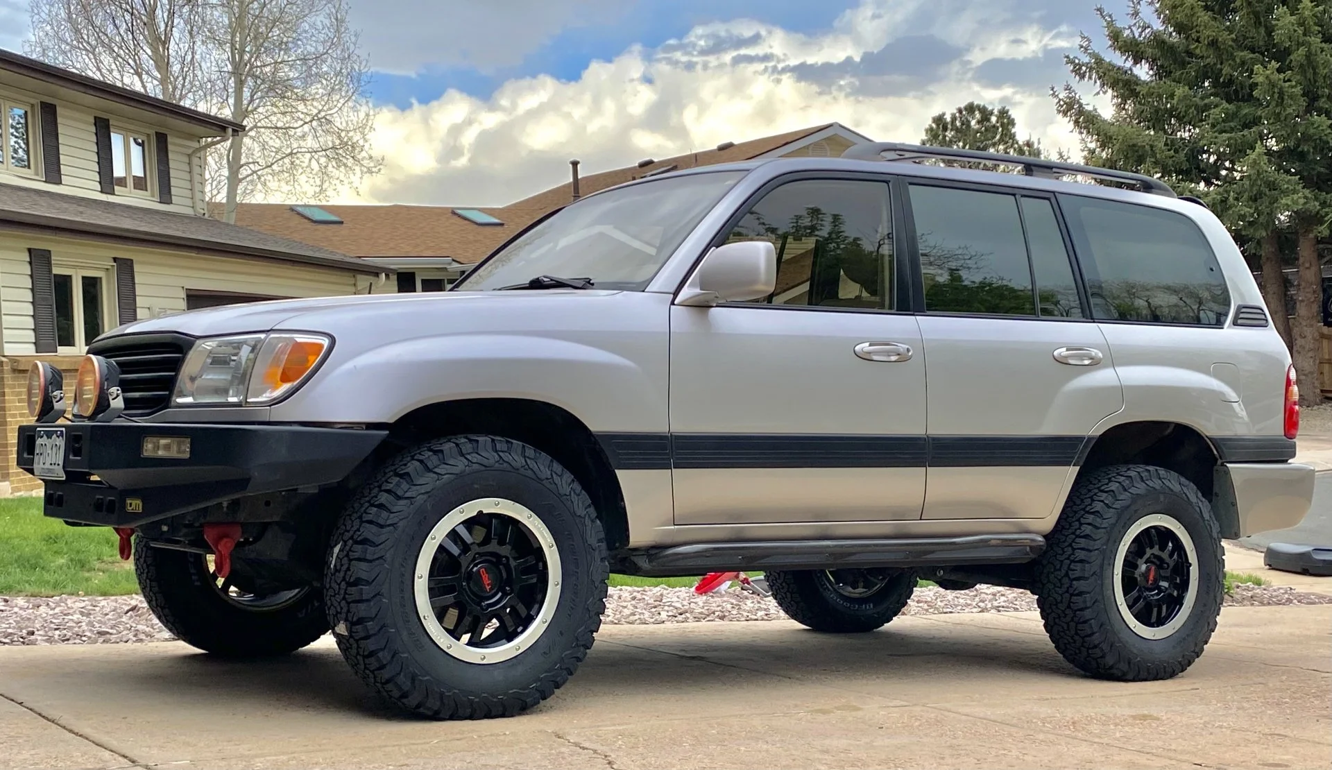

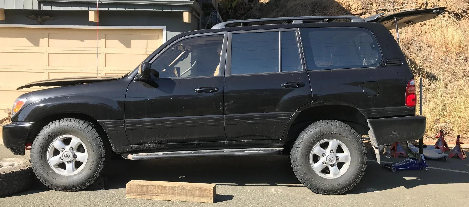

Cranked the torsion bars after they settled about an inch from adding the metal bumper. I was expecting my inner tie rods to arrive today but apparently FedEx is running late. After I get those on it's off for alignment. Is there logical reason for the terror I felt cranking up the torsion bars? LOL...
Oh, I also greased up the DS.

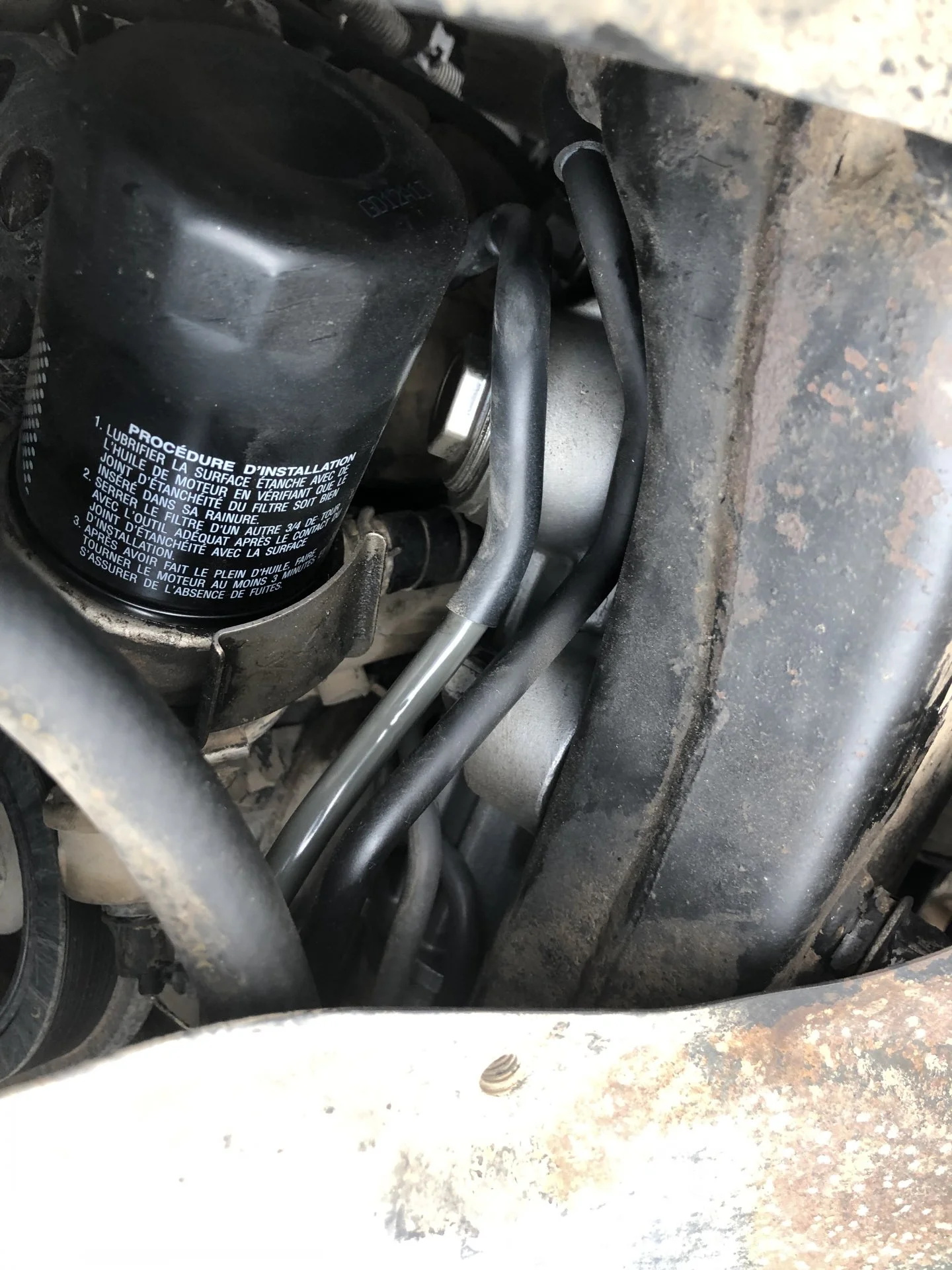

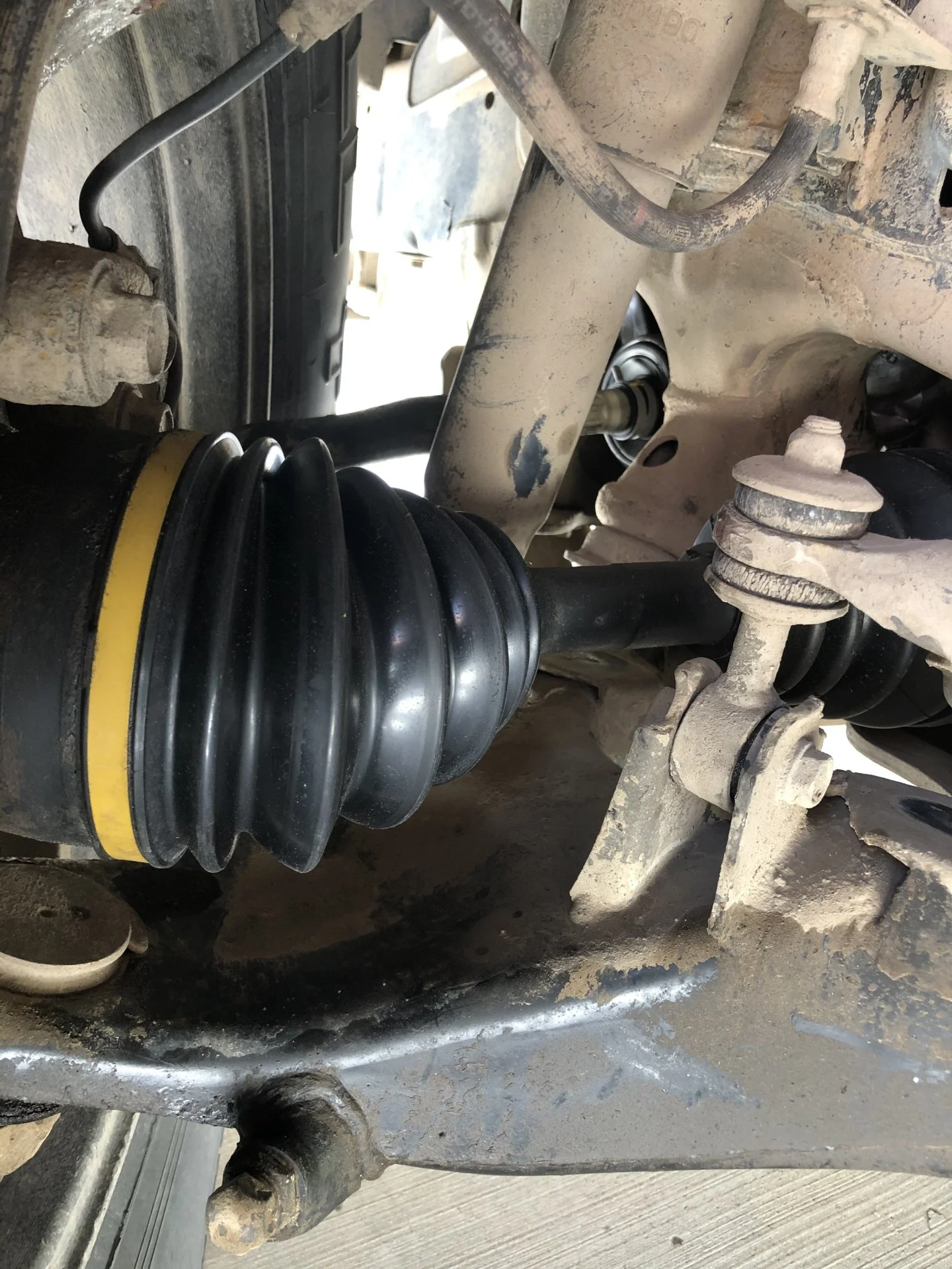

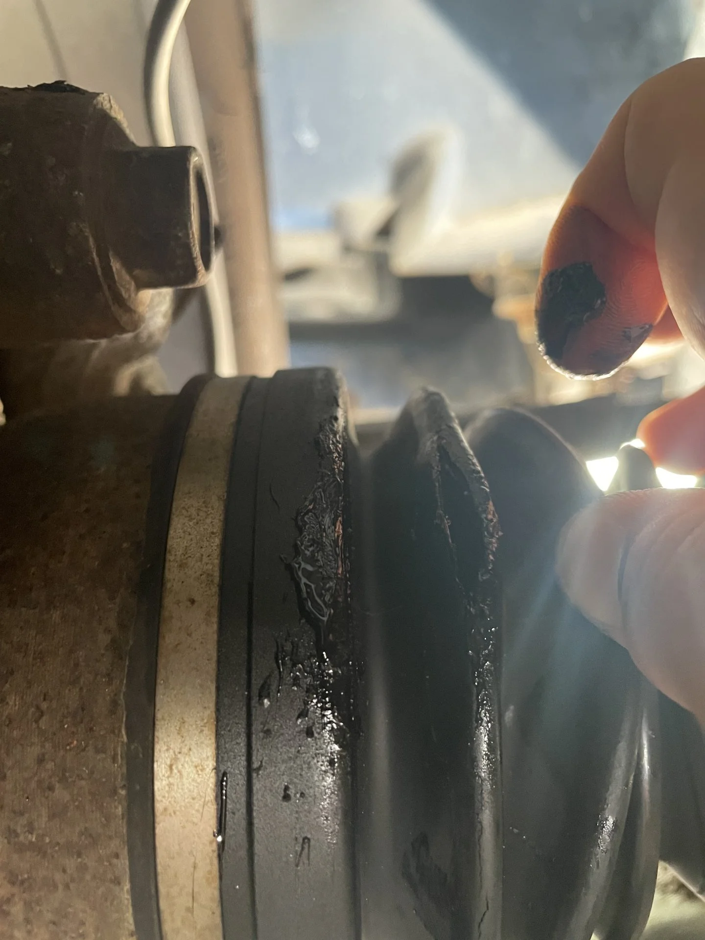

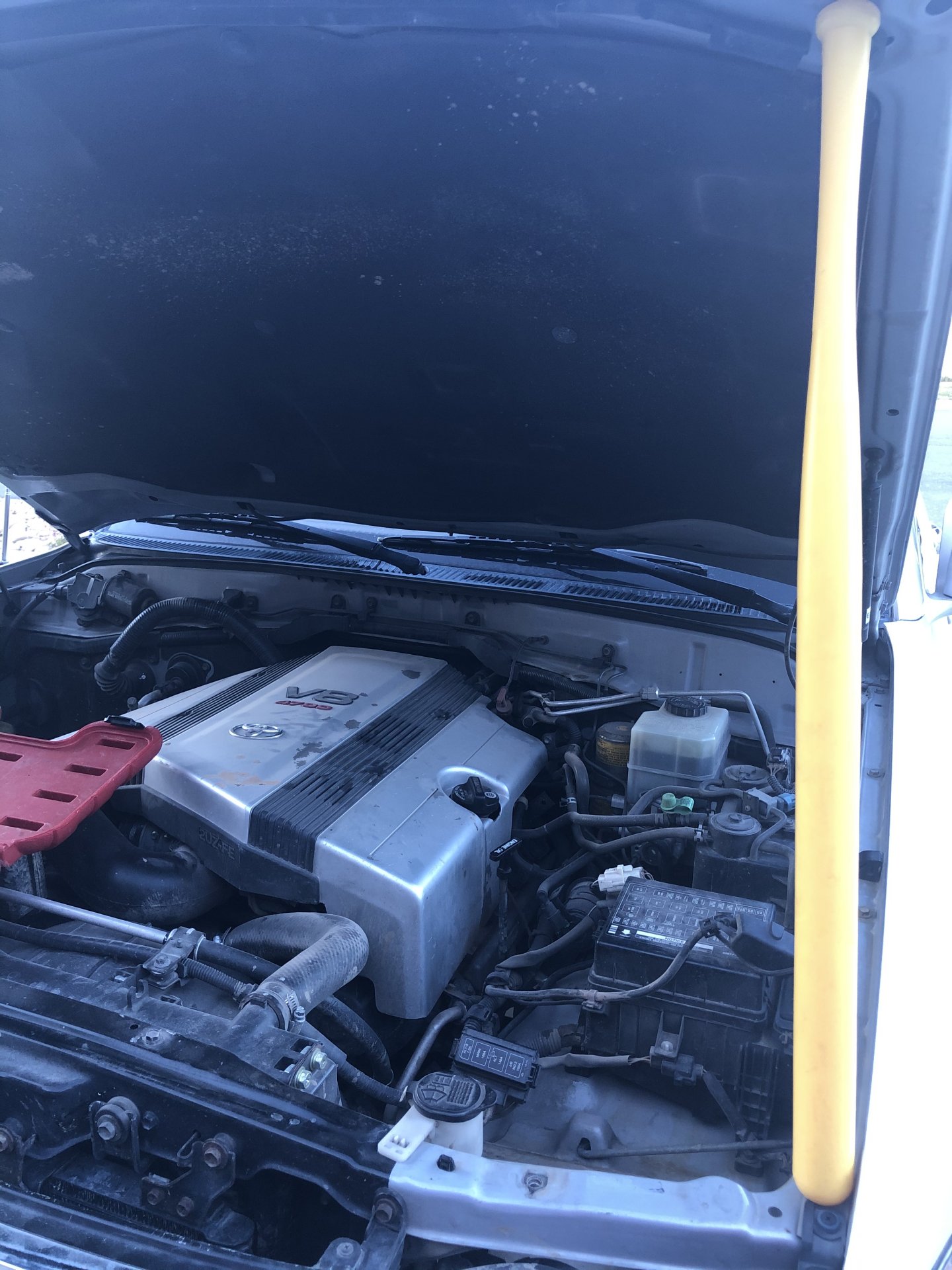

New steering rack and all new hoses. New booties, innies and outies. New brake pads and rotors. Oil change. Took it for a spin in the hills. Got it home, battery is dead and the hood needs a wiffle ball bat to stand at attention. Guess I’ll order the rear hatch arms too. Still need to replace the antenna and the OEM shocks and airbags for towing that have been hanging around for 60+ days. There went the moolah I saved for sliders. Hope that battery bounces back. 3 stream crossings today, glad it made it home!View attachment 2673592View attachment 2673594View attachment 2673595View attachment 2673596View attachment 2673598
All that work will get you home more reliably than the sliders. A+ on prioritization. The hood struts are a nice upgrade and piece of mind for keeping hood off your head.

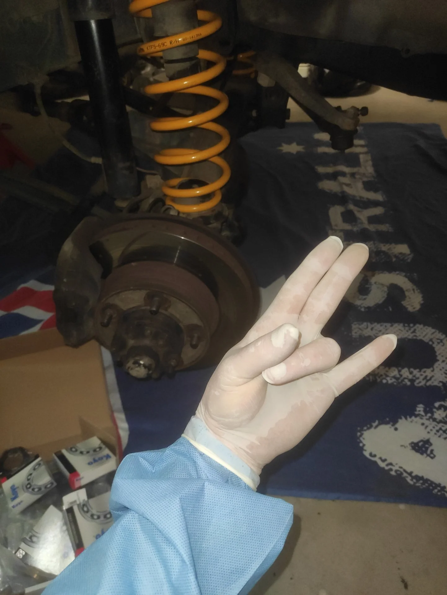

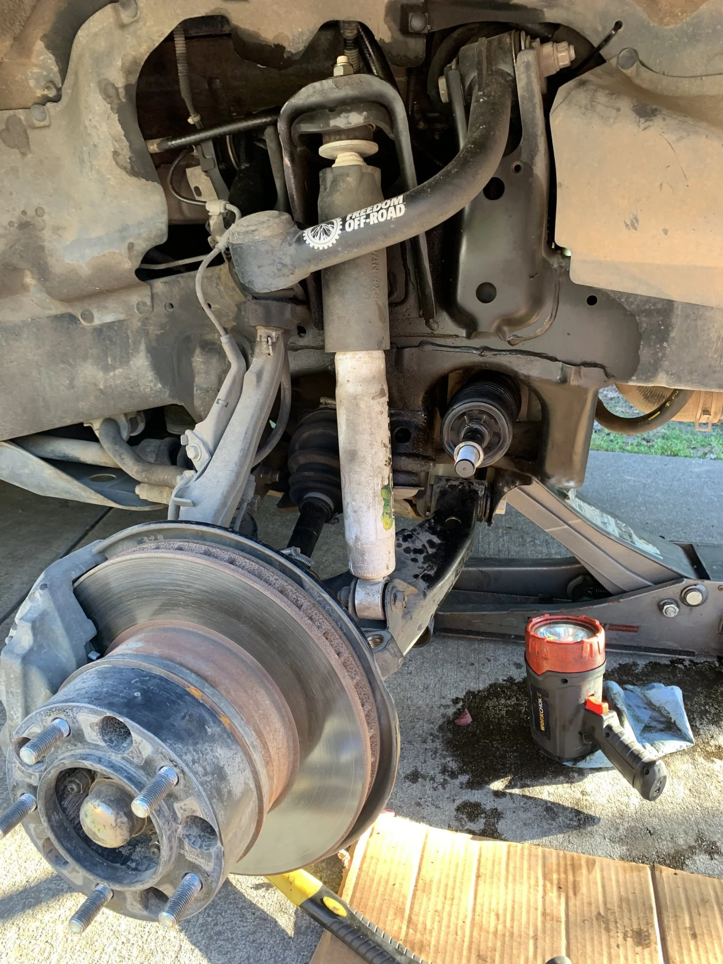

Going in deep, wish me luck

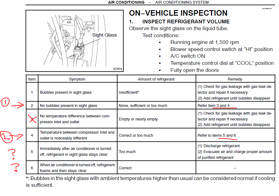

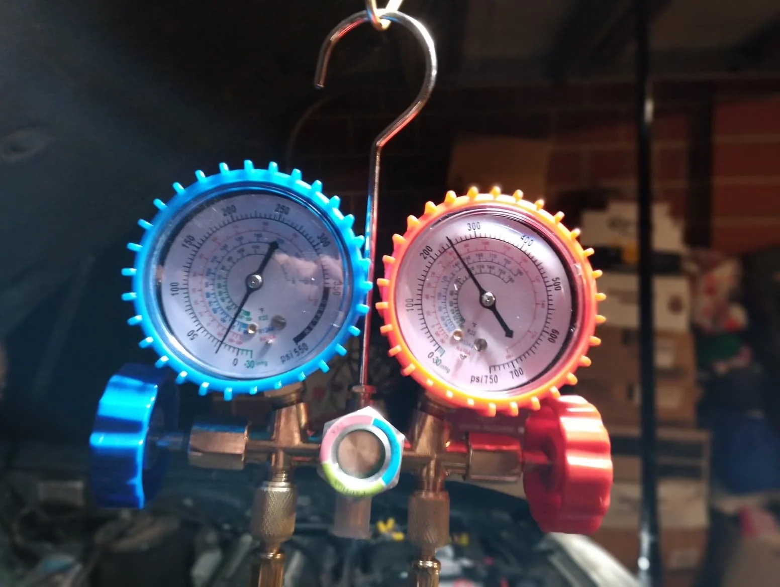

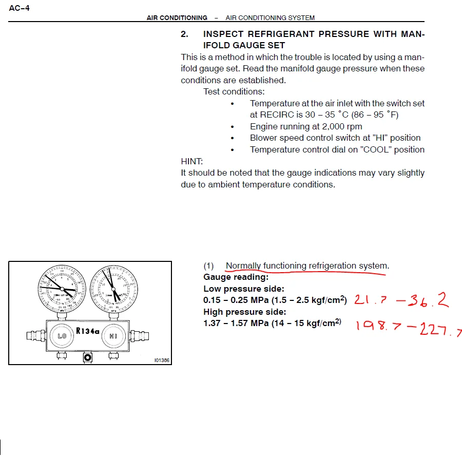

Did an A/C 'on vehicle inspection'.
Compressor has been replaced recently (6 months ago) , system was charged then. All other parts original so 23 years old.
I think this points to condenser/evap underperforming. Set to replace them both, plus thermistor sensor . expansion valve. pressure switch

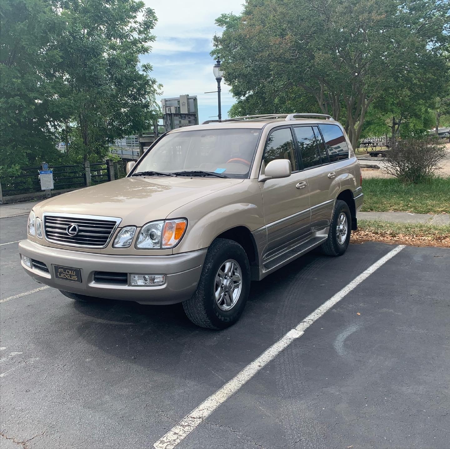

I’ve only had it a week, but I have done few things already to my 2001 LX470. The first thing I did was add a Yakima Mega Warrior I picked up from a guy who took it off of a 2021 4Runner. It works until I figure out what I want/need on top. Second thing done was to remove the running boards. Next was replacing the bald Michelins with BF Goodrich AT K03s. I read and reread a 100 posts and finally decided against the 33s for now and stuck with the stock size. I got a 2 inch file of the last 20 years of maintenance and there was no record of a spark plug change. I pulled one and they had been recently changed so all good there. Next up is to fix the 2 or 3 blown speakers. View attachment 2671698
Meant to ask this when I posted it- I’m thinking of tossing the running boards. I’ll never put them back on and I don’t plan on selling it. Will I regret tossing them?
I'd see if anyone here wants them rather than tossing them.

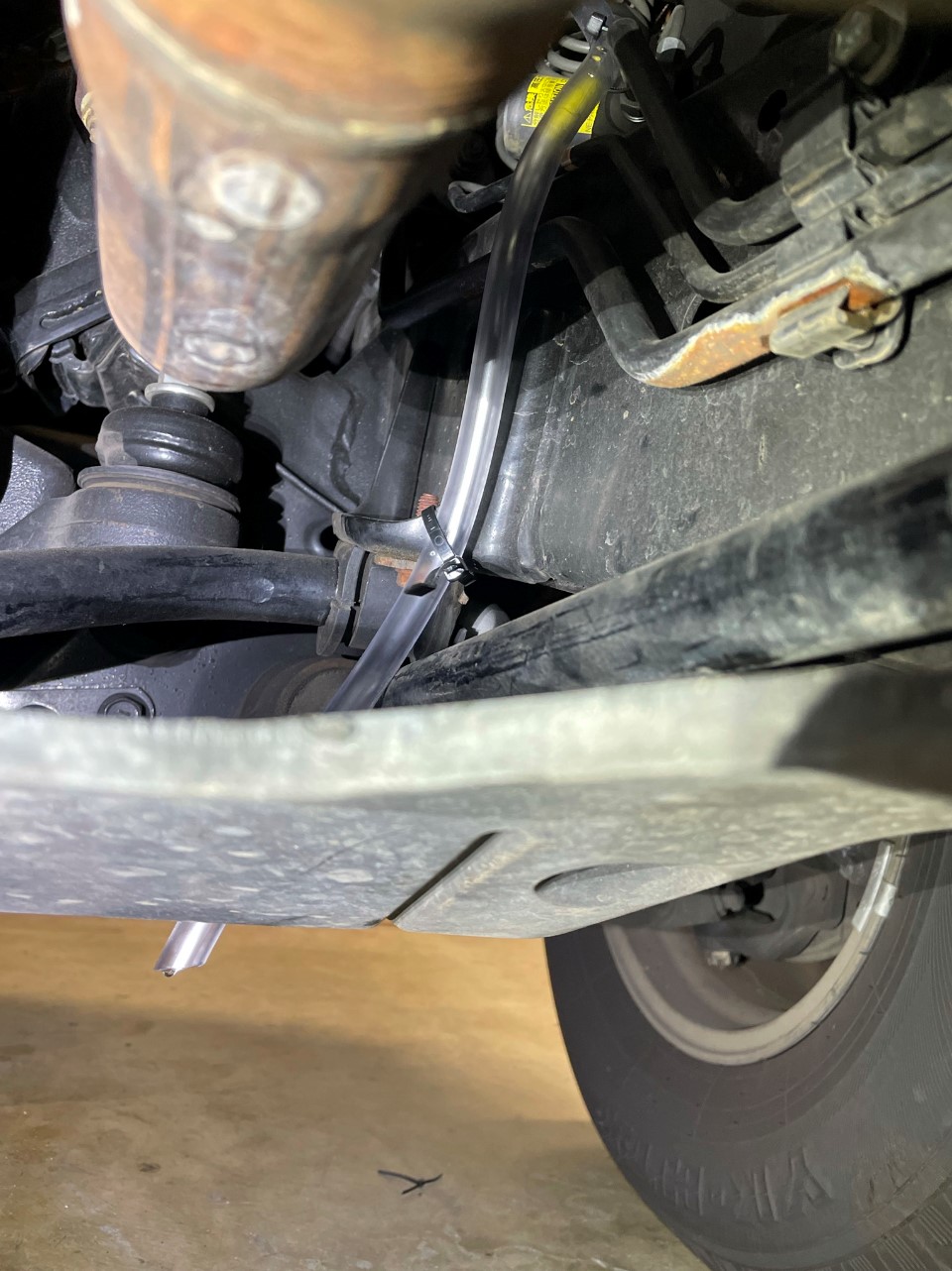

Added an ac condensate drain tube extension (with custom flared tip... +5hp) Now what to do about the rust on the AHC lines?
Mine looks exactly the same as yours, scuffed it with 400 grit sand paper, used black enamel paint and 1” paint brush and called it the day.

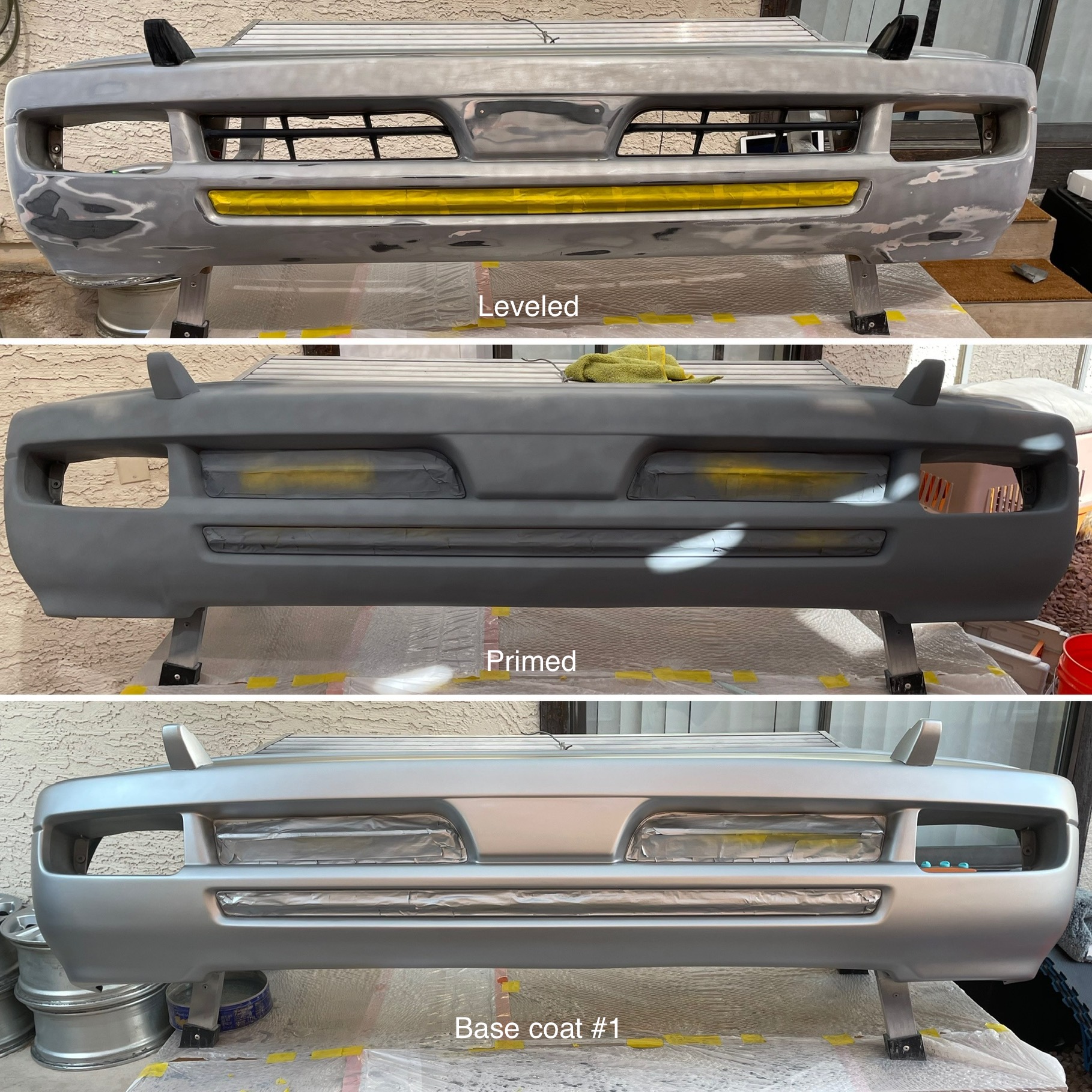

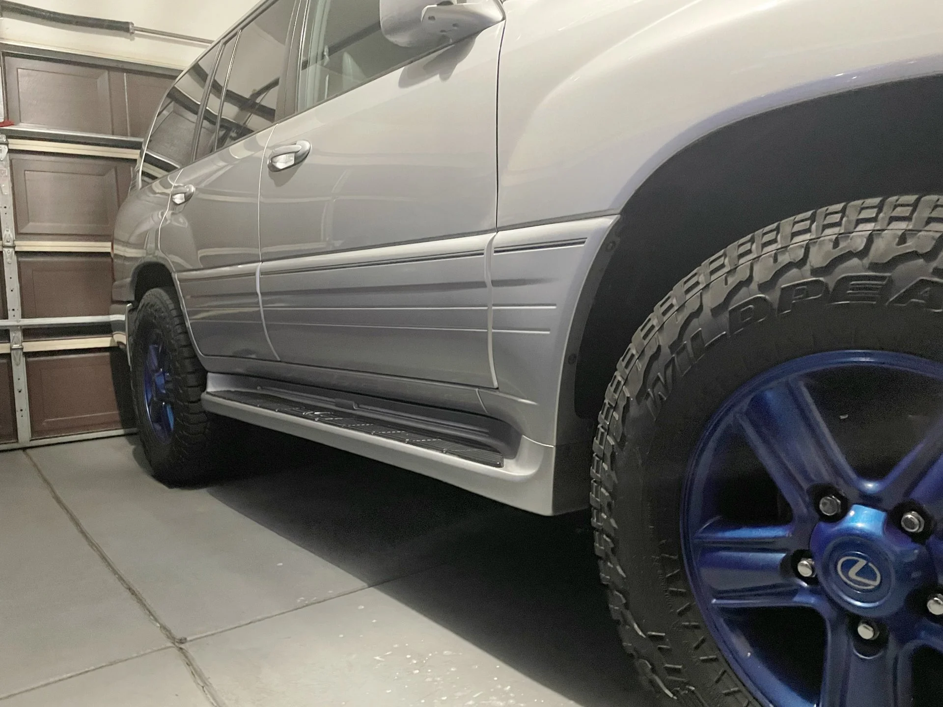

One thing I noticed with single-stage paint method (which was the method used on our 100s) on plastic components is that they don’t hold up very well, they tend to oxidize and fade prematurely than the metal body panels or maybe the chemicals used I really dont know. That said, it was the front bumper after the side claddings:
allowing the 2k clear to fully cure, next is mild cut and gloss using DA polisher then ceramic coat.
Front bumper rehab:
will check again for surface imperfections and if need be filler/primer will be done again. Plan to use at least two coats of base since the front always takes the beating.

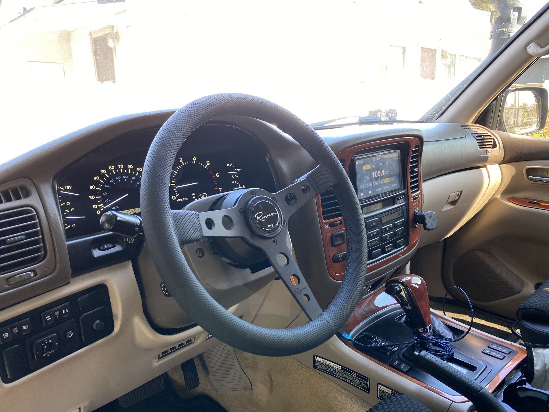

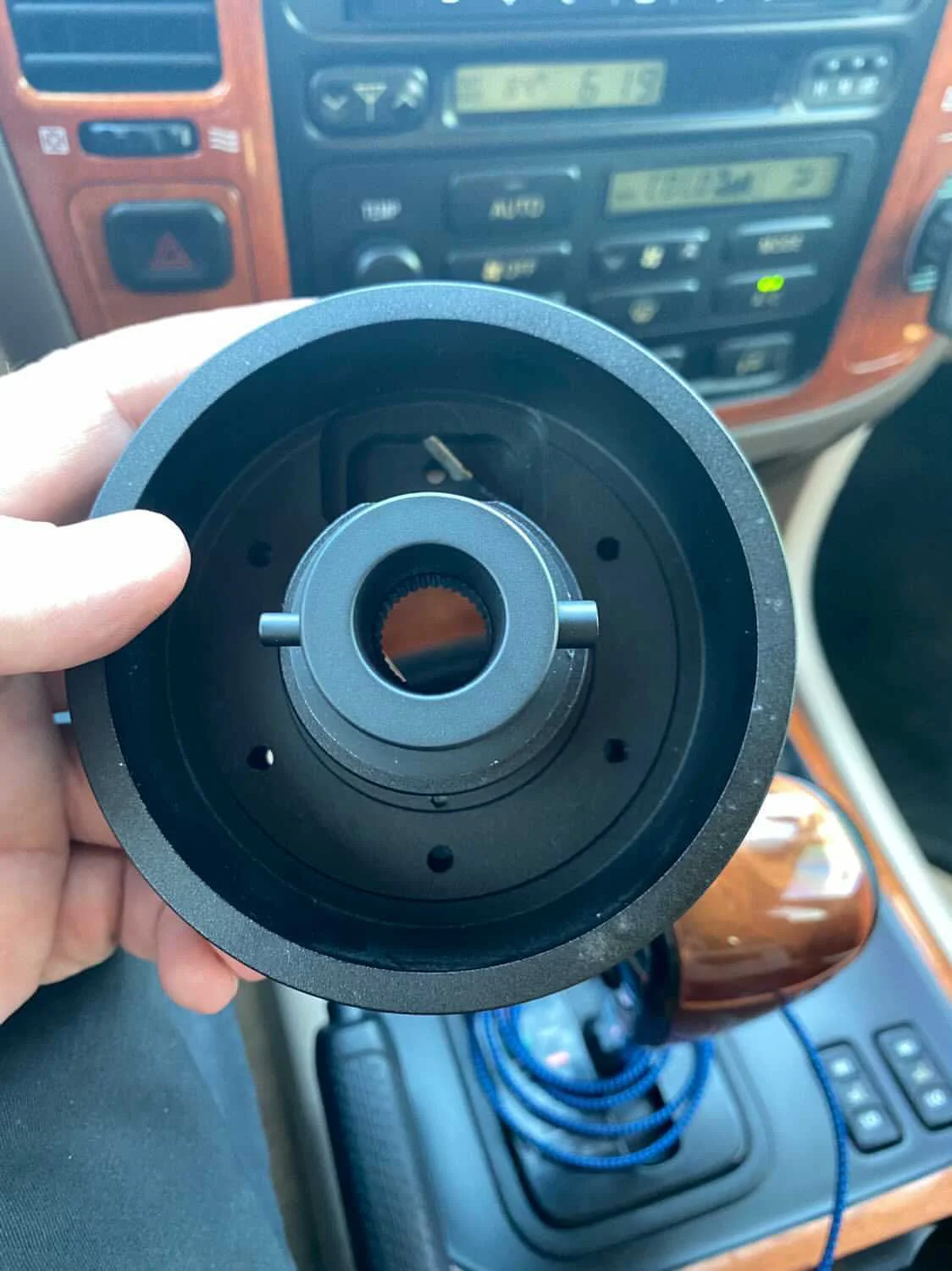

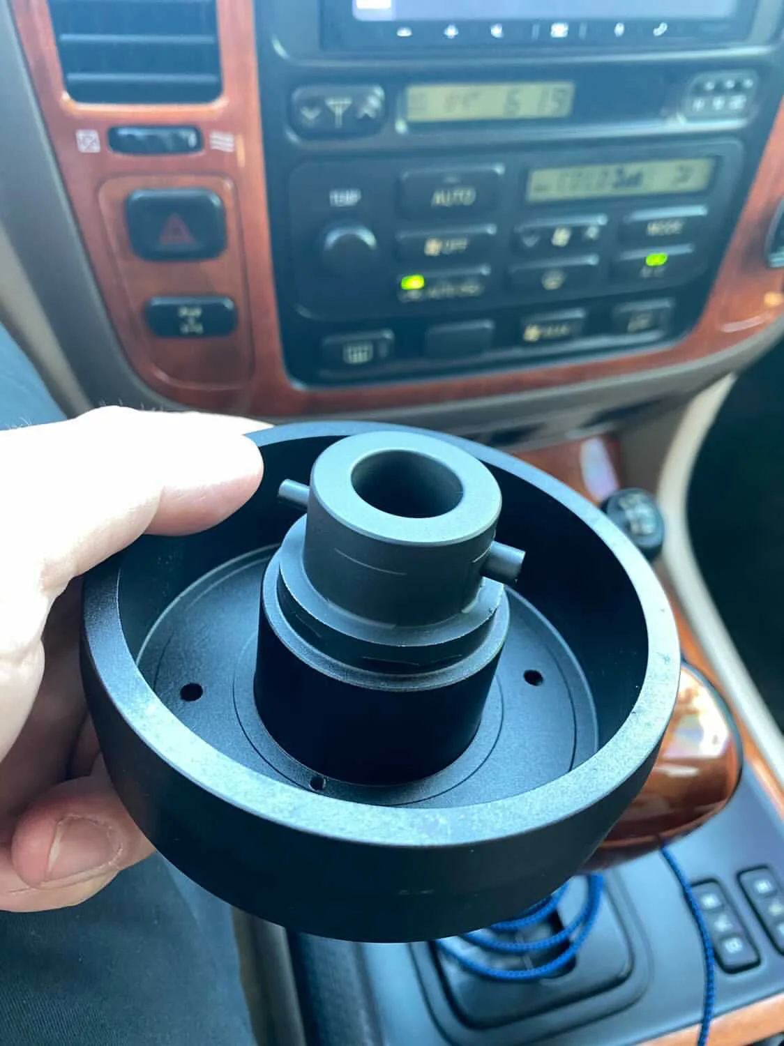

got the steering wheel back on, and no vcs freak out with the roll pinned hub however after putting it all together no start. took it back apart and tried to start with no wheel on and fired up. put it back together and all fine. started a few times and all good. no idea there.
shaved the wings off the nrg hub and roll pinned it
have another vintage momo on the way while i decide what i’m gonna do
What did you do with your old steering wheel? And why did you replace it?
