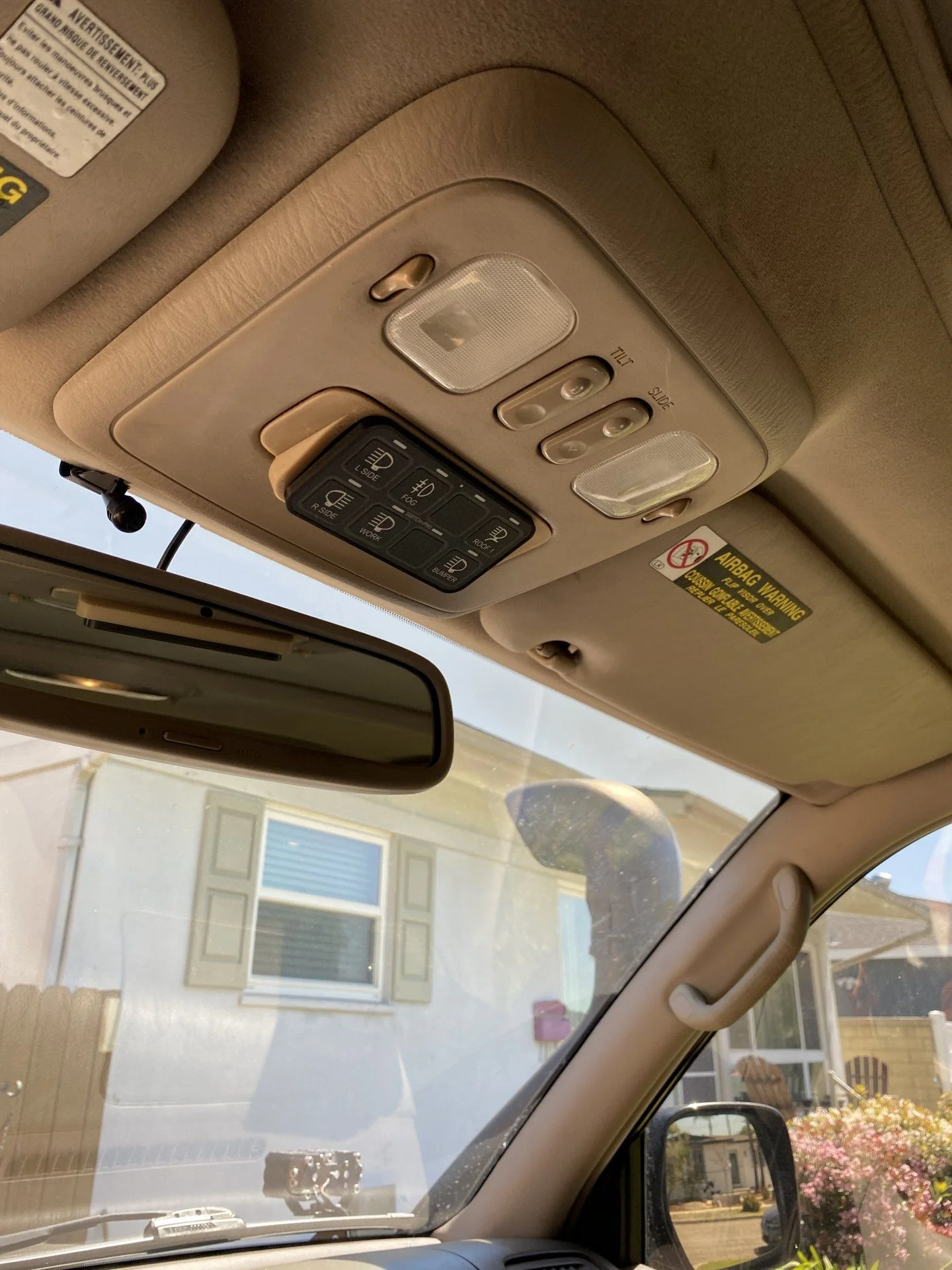

jimahajer did my timing belt and finished routing my switchpro harness.

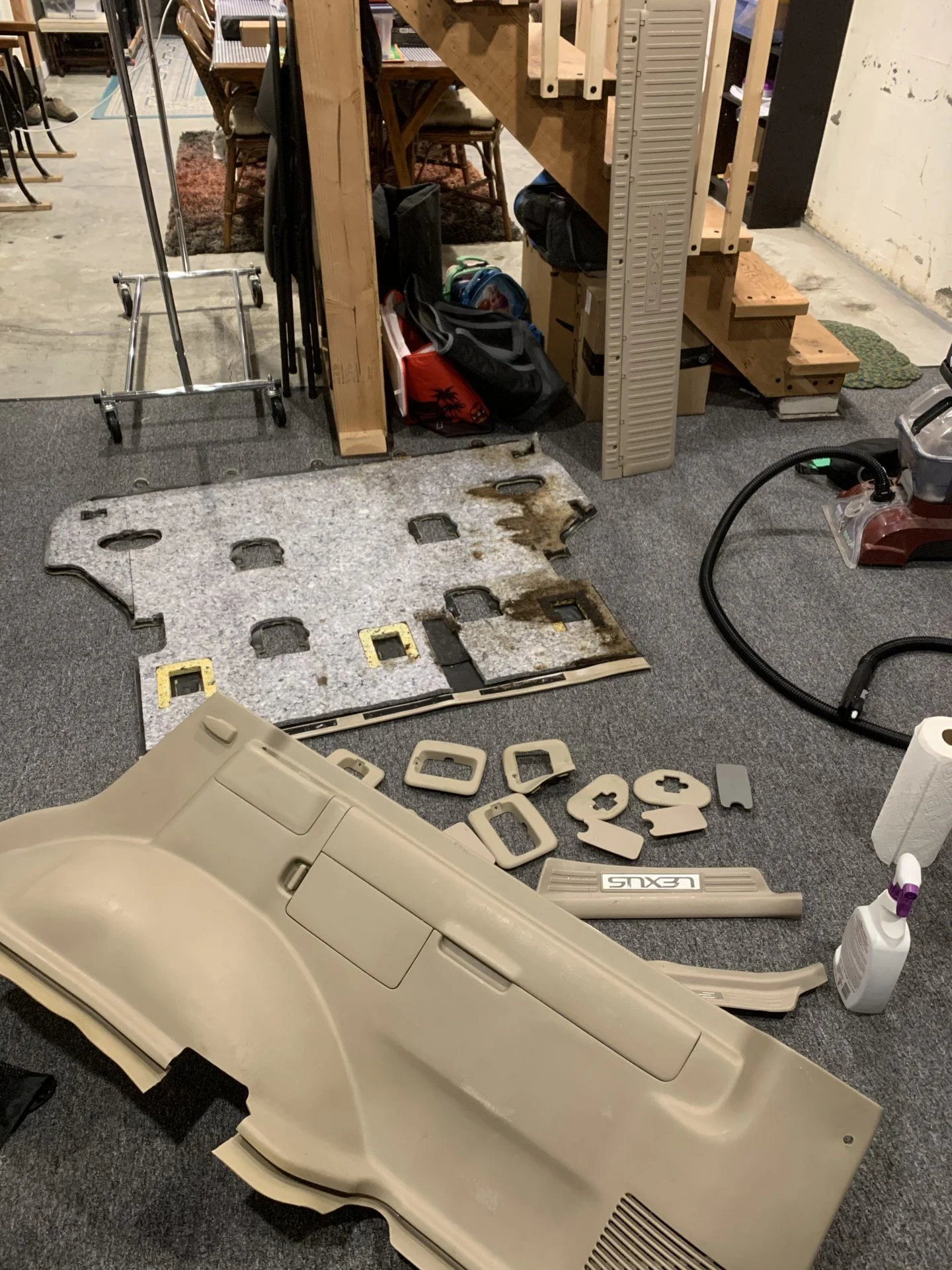

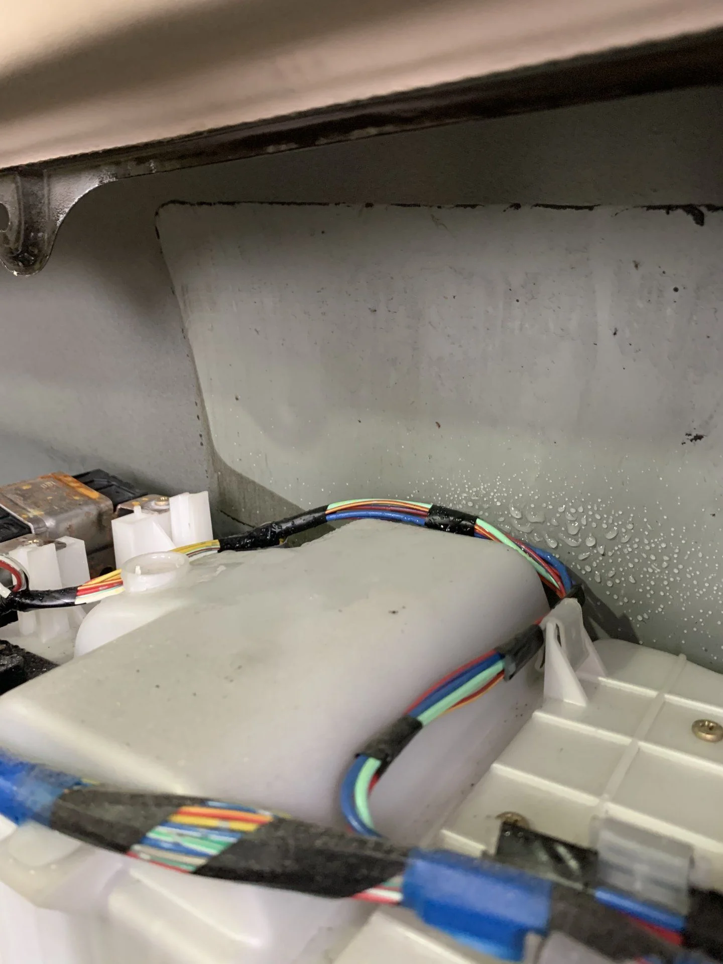

After spending 3wks at Torfab for a bunch of maintenance things I don't have time or talent to handle, yesterday I accidentally discovered water underneath rear carpet ... now I'm pulling trim from around the side window and trying to figure out why water is dripping down this little plastic trim fastener. Maybe the weatherstripping is failing? Have new carpet padding ordered for rear carpet, and going to try out the Amazon Basics sound proofing pad on the bare metal back there, particularly around the wheel wells.

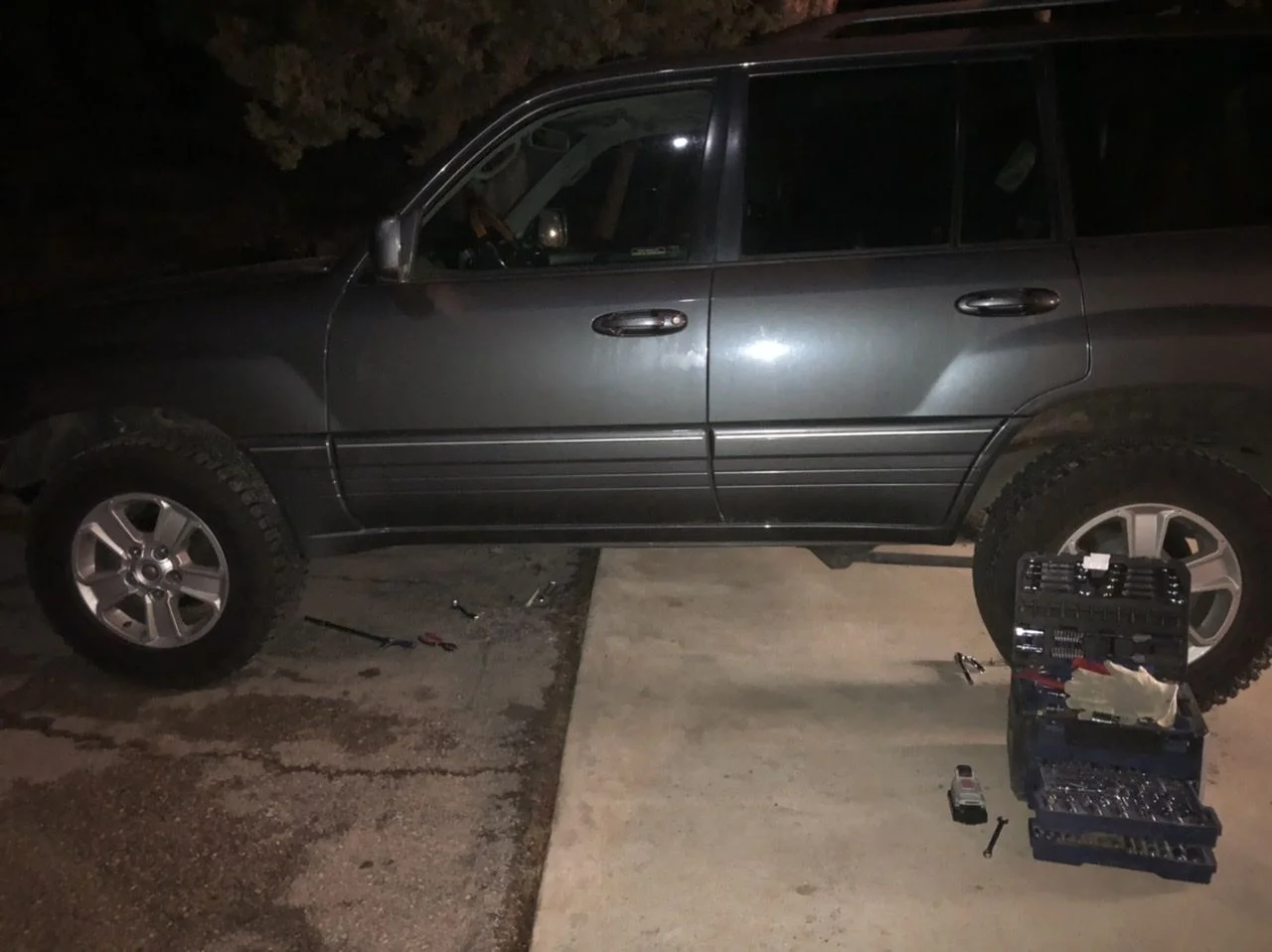

2. Removed the running boards. Only sheared 4 bolts.
3. Removed factory roof rack and installed the @Ironman4x4Bubba 100 series feet kit. More on the feet kit later in my build thread. Had to modify the front most brackets to fit the LX470.

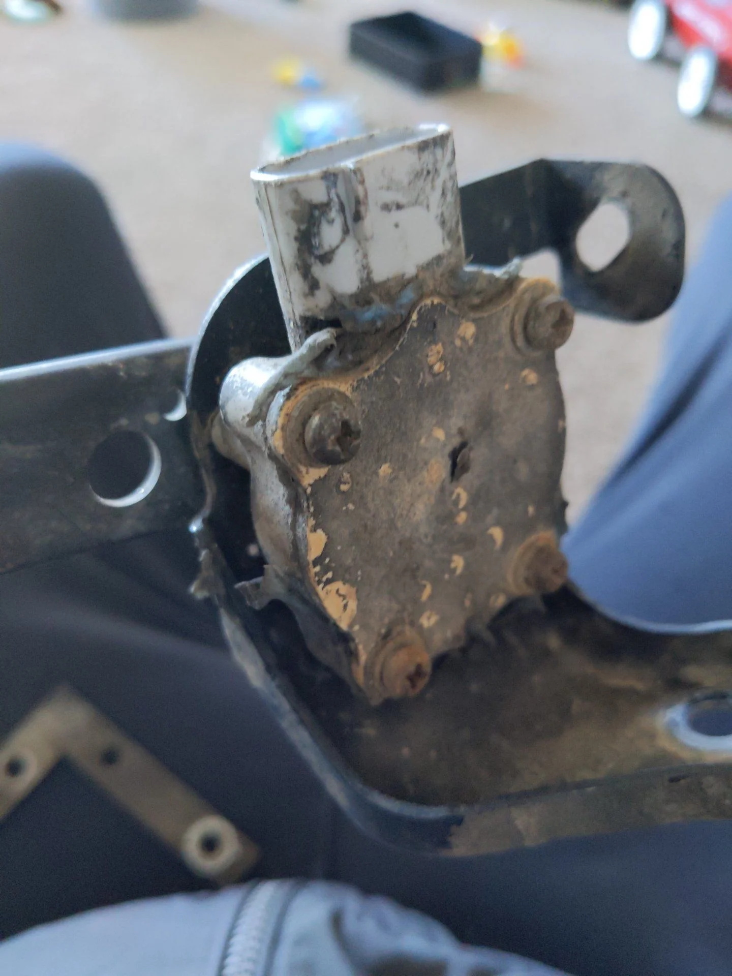

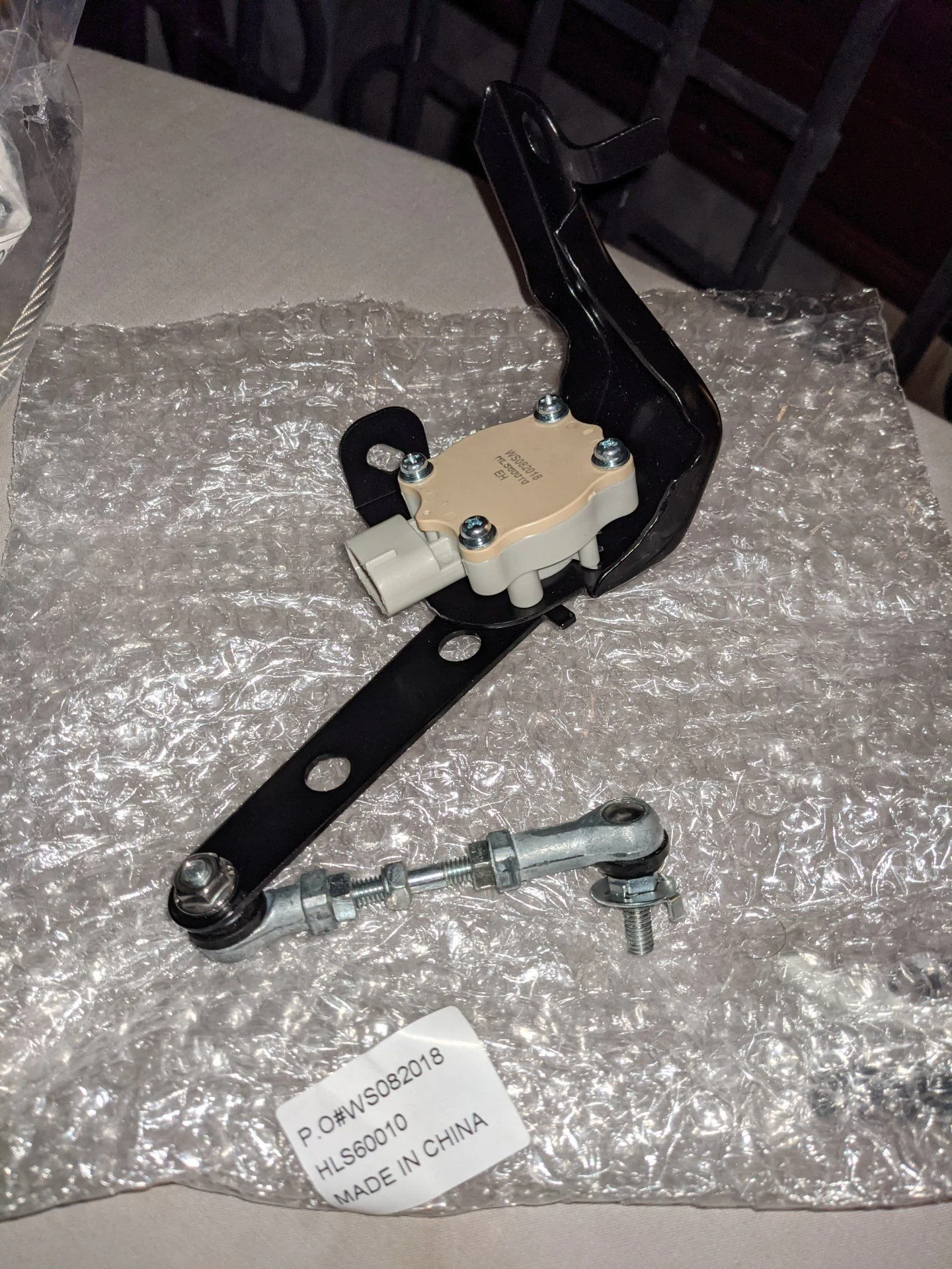

so the plot thickens. PO had an extra bracket installed to lengthen the arm? Sensor lift? Replacing the sensor it now sits perfect at neutral but fails to raise or lower AHC off blinks while driving

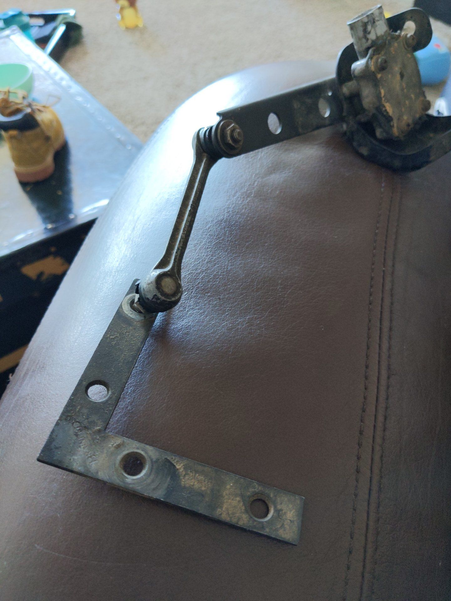

View attachment 2629945so the plot thickens. PO had an extra bracket installed to lengthen the arm? Sensor lift? Replacing the sensor it now sits perfect at neutral but fails to raise or lower AHC off blinks while driving View attachment 2629947
The scissor portion of the sensor was bending the wrong way. AHC high n low works like a dream. I am a genius.

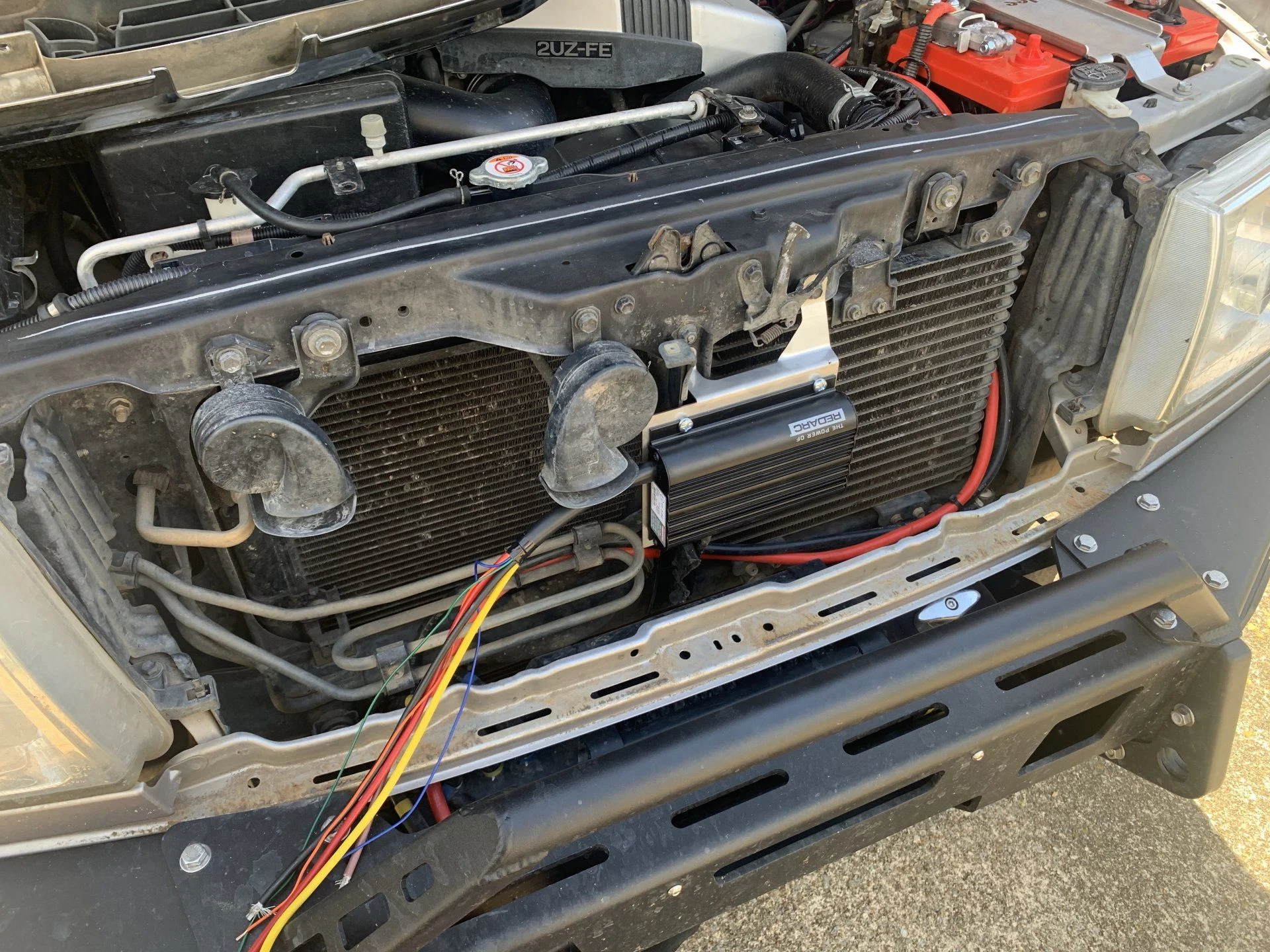

Finished up install of RedArc BCDC1225D, awaiting Anderson SB50 amp connector to connect solar panel! Oh yeah, got a 200W solar blanket ready to go
Love this electronic battery isolating solution from a solid company. Was stoked they came out with the mounting bracket as well. You'll enjoy it.
