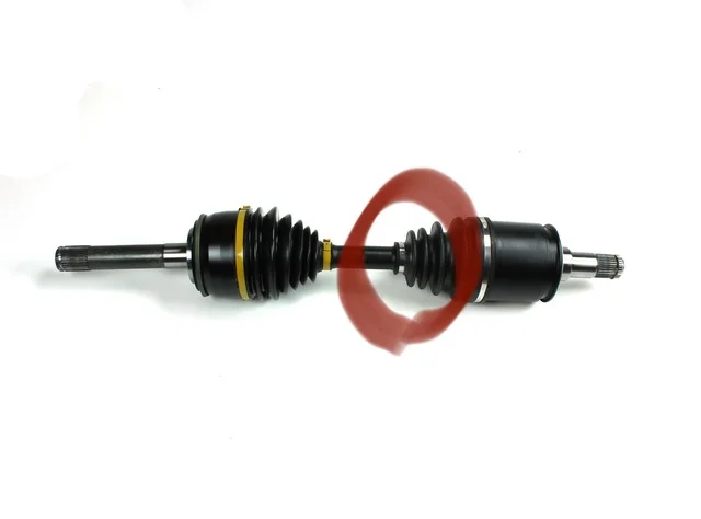

Question: anyone have the cv boot clamps, I’m spitting grease. Also how many banana job

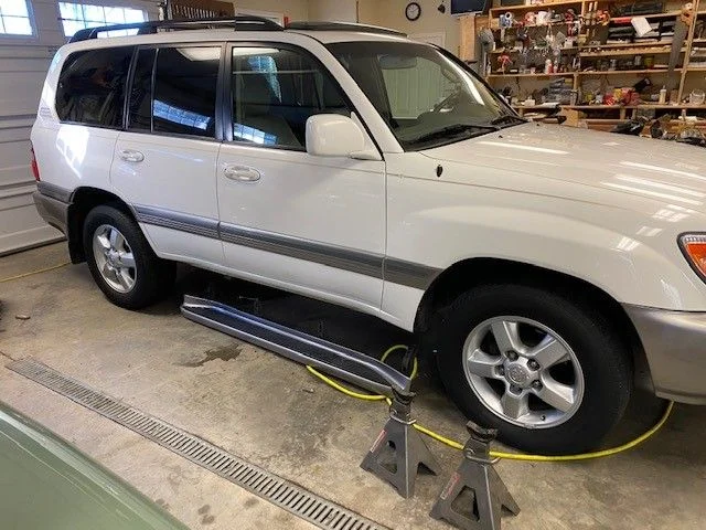

Thanks to 1428Mike I added a few goodies to my new to me 04LC.

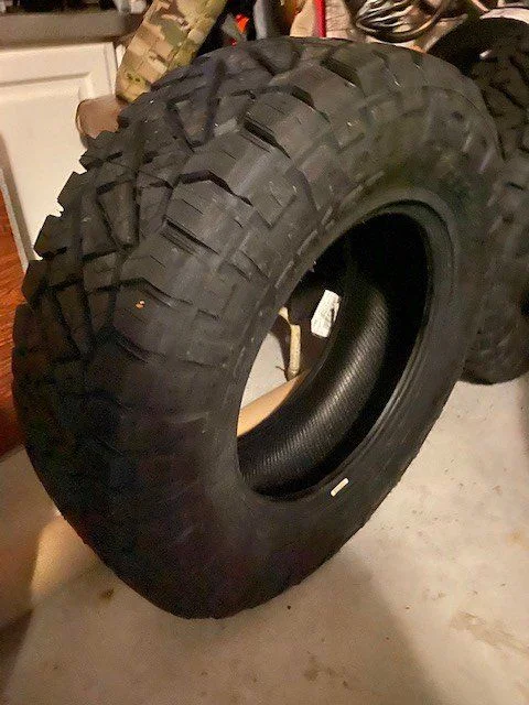

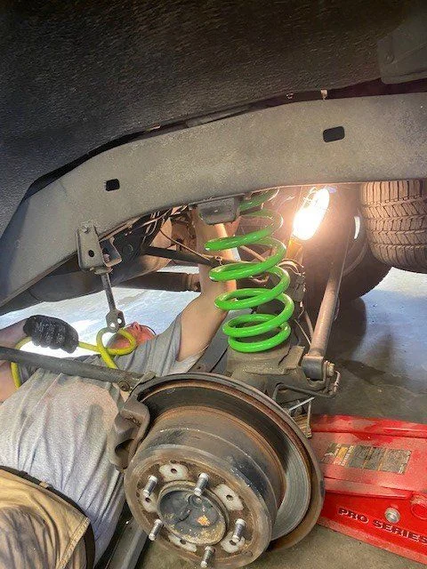

Installed new Ironman heavy springs, shocks, and torsion bars. Had to reindex TB's to get the front where it needed to be (for the moment anyway). my Ridge Grapplers have been delivered and will be on early this week. Final pic once I get my new shoes on (LT275/70R18). Thanks Mike for your more than generous help.

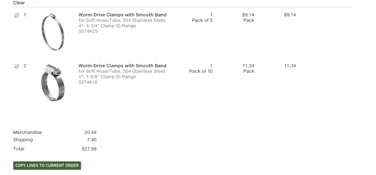

I gave my extras to @Bisho but you can buy them from McMaster-Carr. It’s a 0.25 banana job...

I think I have a few extra clamps too.
That is NOT the process for just replacing clamps. @Pucker5 disregard that video unless you want to reboot your CVs.
Oh sorry, thought we were talking about rebooting.
@Pucker5 i found it easier to put the front end on stands, e brake on and t-case in neutral. crawl under there and simply move the wheel or axle until the pinch tabs on the band is staring at you. I use a small flat head screwdriver and some patience to slowly pry up the tabs on the band. once they are up, the band will open up and give you plenty of room to take some snips to it.
