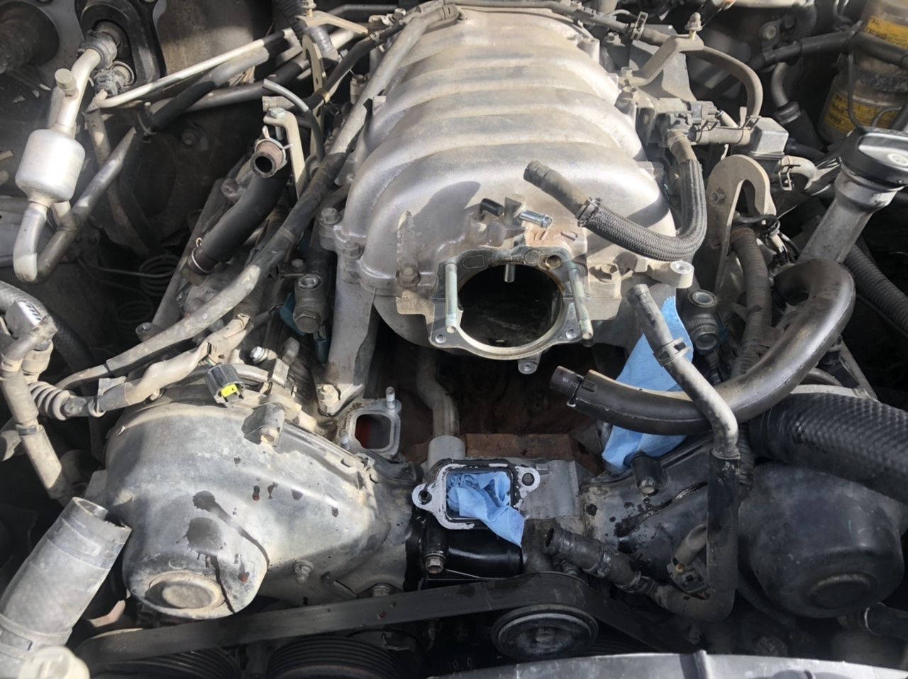

Changes the front water bypass seals, left side was leaking slightly but would only show wet if I didn’t drive it a lot. Process was actually pretty easy with removing the front fuel rail crossover. Though I did run into one of the throttle body bolts cross threaded and three hoses needing replacement. So should be done when the dealer gets those in.

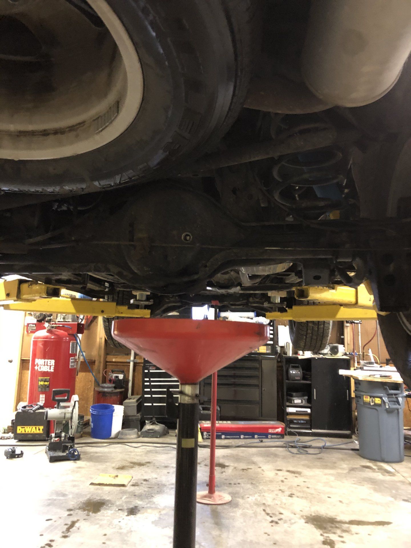

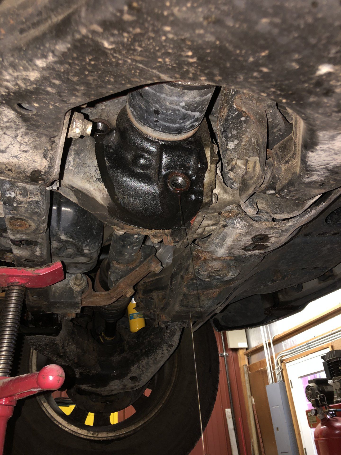

Did three things today:
Front differential drain and fill.
Rear differential drain and fill.
Thanks to whoever did the parts list and write up on the differential maintenance 🙏.

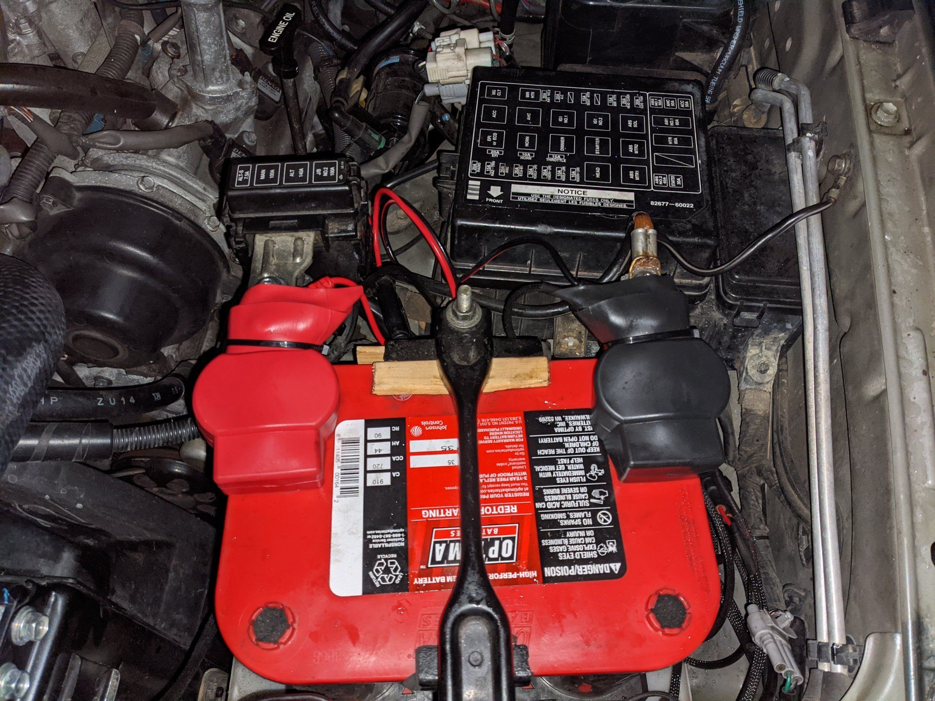

Also installed Slee battery terminals and some terminal covers. I bought what I though would fit, but couldn't get everything pushed through the back of the covers, so split them in the back with a razor and zip tied them on until I can find a better solution. Don't mind my hunk of wooden molding battery hold down.
