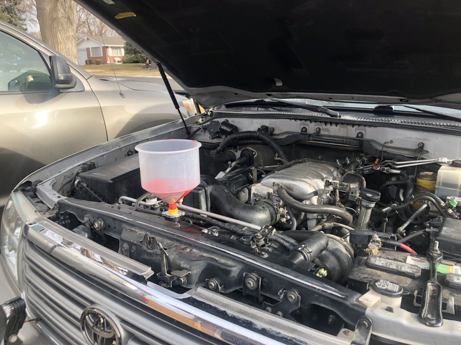

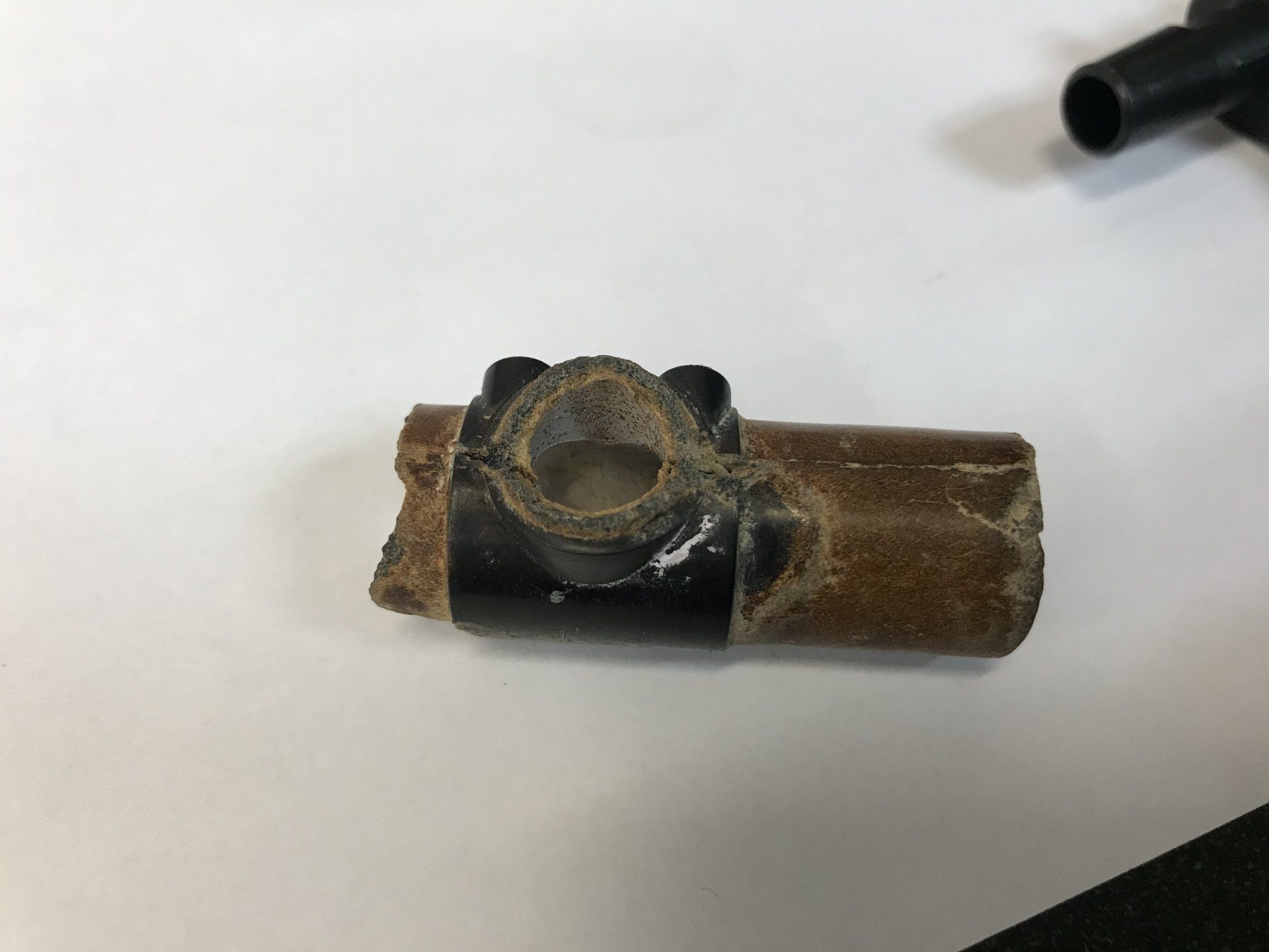

Installed a new fuse box cover seal and burped the cooling system from changing the leaking front bypass seal, and some hoses.

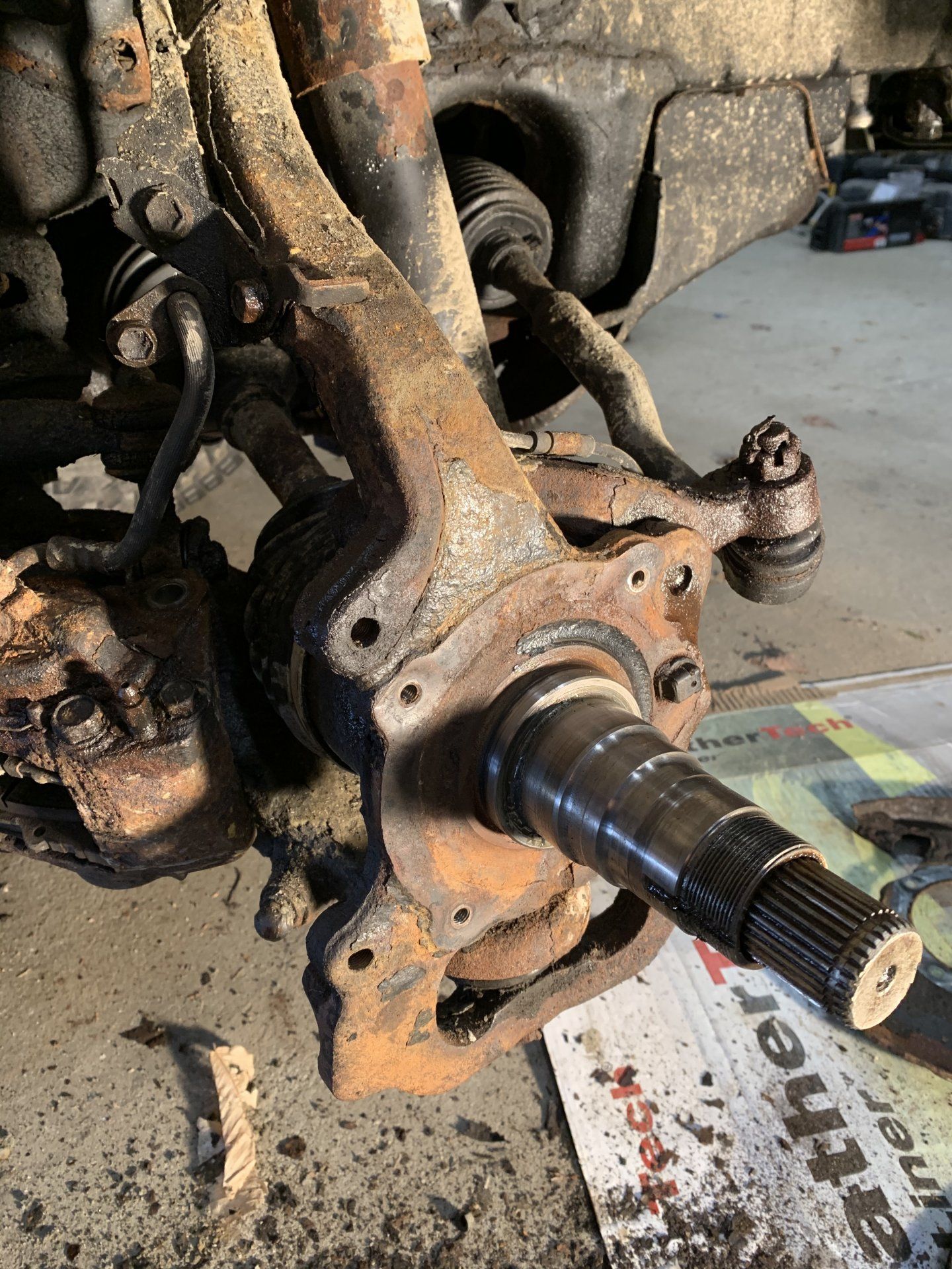

Stripped down passenger front hub to repack bearings. Some barbarian used gasket goop to seal the flange, which squidged up into the cone washers, so the whole thing was an ordeal. Thanks for the tips in various threads, @2001LC! The hub itself is pretty rusty, with all the coating flaked off. Is it worth disassembling and coating with POR15 to prevent further rust? Also, the bearings look in decent shape but are clearly not OEM - stamp says SKF/China. Worth replacing with Timken, or leave it if they’re in ok shape? I have a feeling my slop was due to improper preload/ clip spacing.
I'd suggest the following:
1. Yes, replace the bearings and races at the same time. Keep them as matched pairs.
2. If your hub is rusty, be very careful about applying any coating. It may be best to simply use a wire brush and/or "weak" grinding tool to get rid of the surface rust. If you choose to apply a coating, ensure that it doesn't enter the hub cavity at all costs. It will make reinstalling races a complete PITA.
3. If you can, it may be worth it to remove the castle nuts and completely remove the spindle at the same time for inspection and cleaning. Pay attention to the seals and spindle bearing; if those look old and the bearing has any signs of wear, replace them. You may struggle with the ABS sensor removal - most of us do, and patience is the key for removal and reinstallation due to the gunk and potential rust build up.
4. Don't forget to get some fresh grease in the spindle itself so that the needle bearing has a happy life of service.
5. New cone washers and a fresh hub flange makes removal and reinstallation so much easier the next few times. Your brass hammer will be very grateful.
6. It is also a great opportunity to replace wheel/hub flange studs if any of them are questionable.

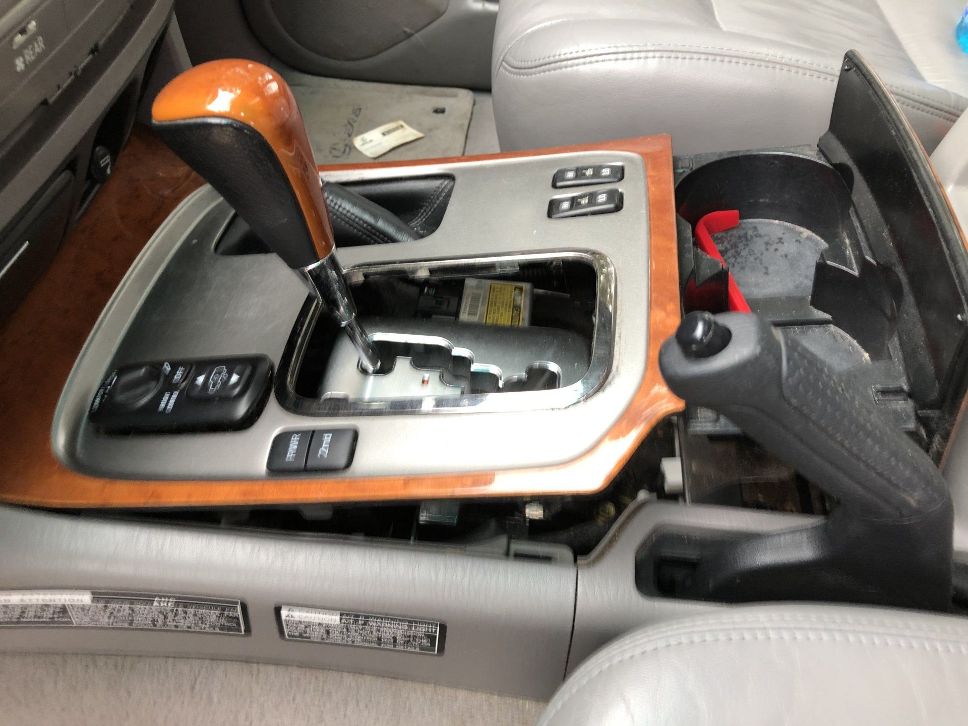

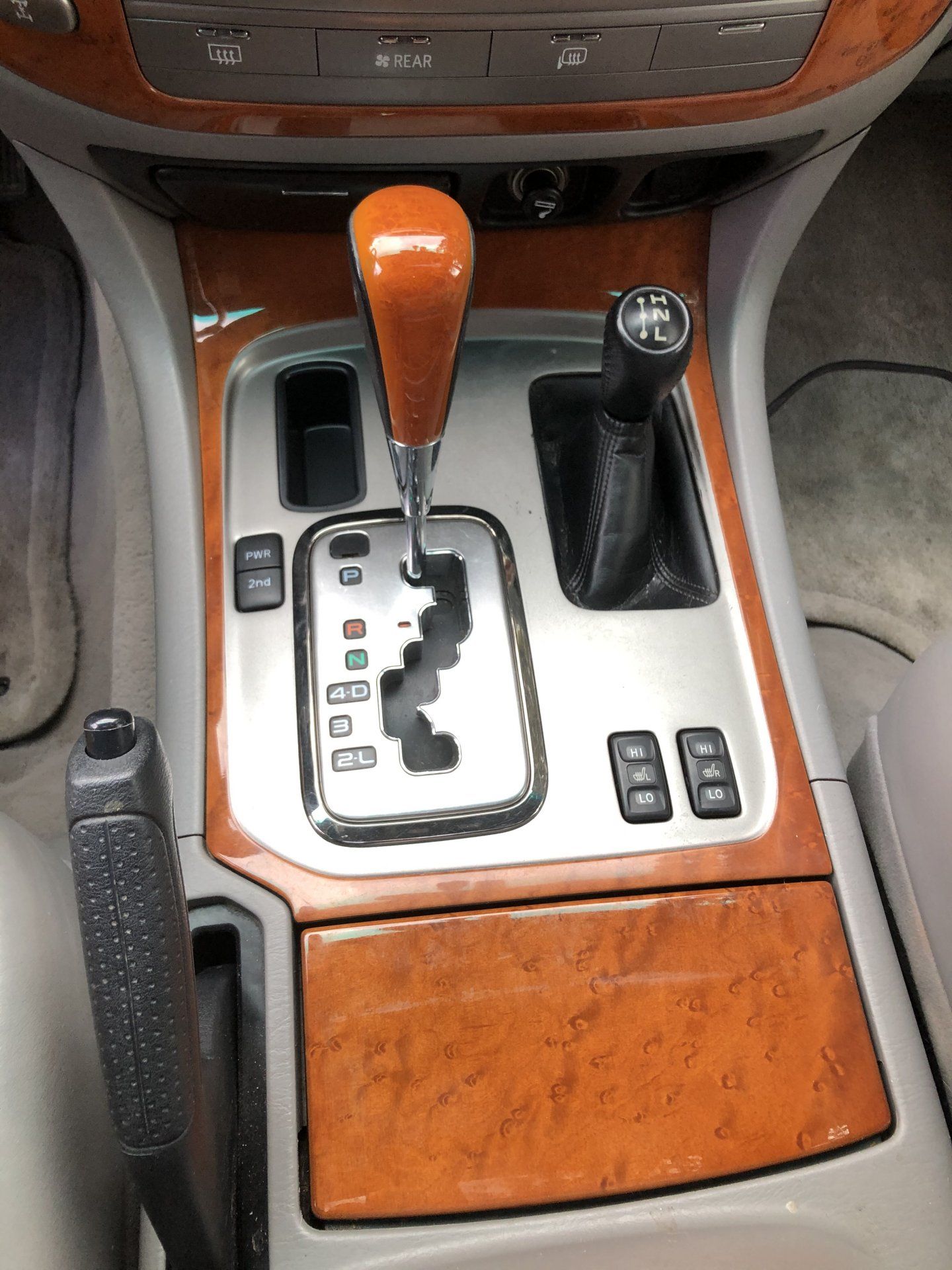

Removed and replaced AHC switch with a new lil dirt catcher thing. While I was in there I removed the seat heater switches, shifter bezel, and PWR/2nd switches AND cleaned out 15 years of crumbs and crap that accumulated.
Looks like a decent respectable console area now.
