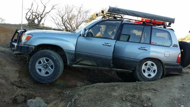

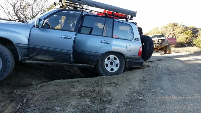

Wheeled it hard. Well not as hard as some, but hard enough to break the rear sway bar frame bracket. That and stuff the heck out of these 35's and lift 1.8 tires off the ground.
That looks like a lot of fun. My kind of wheeling. Not into boulders. Where is this?

Thanks, it was! We had a ball.
Cleveland National Forest in SoCal.

Said rear sway bar frame bracket.
Time to call C-Dan. Might as well do the bushings, end links and drivers side frame bracket while I am in there. Also need 15 mm worth of OME trim packers on the drivers side with 10 mm on the pass side.
Said rear sway bar frame bracket. Time to call C-Dan. Might as well do the bushings, end links and drivers side frame bracket while I am in there. Also need 15 mm worth of OME trim packers on the drivers side with 10 mm on the pass side.
Extend the rear links.
I thought about it, but I am still running AHC so my links are the right length for N mode. I'd prefer a quick disconnect solution, but I haven't looked into it yet.
