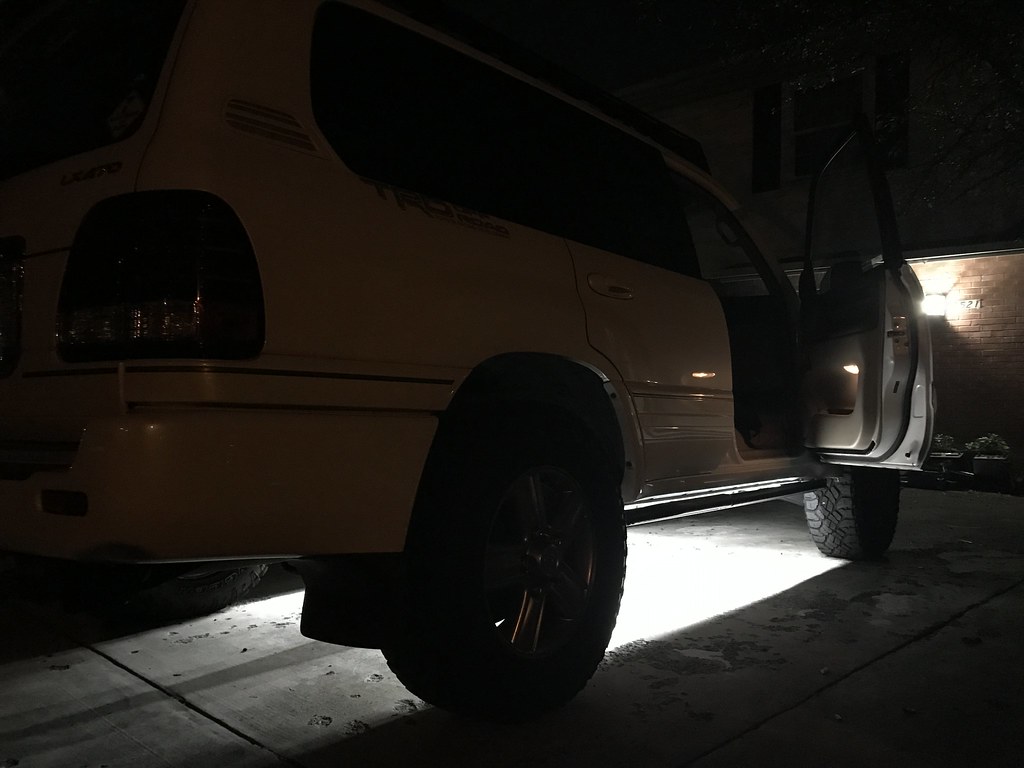

The last puddle light setup i had up was a fail, it only lit up the front of the door area so i scrapped that, i bought a 60" LED strip that ran the entire body of the truck and it's much more bright and even now. Love it, but it might be too bright?

Loooks mint! did you just wire that led strip into the lx's original puddle lights or did you wire up your own harness?
I just wired it into the stock LX's puddle lights, these will dim and gradually get brighter as well. Very easy mod to do for those that took off their running boards.
Looking to delete my running boards soon. How complicated is this install? Do they just plug and play? (Assuming no)

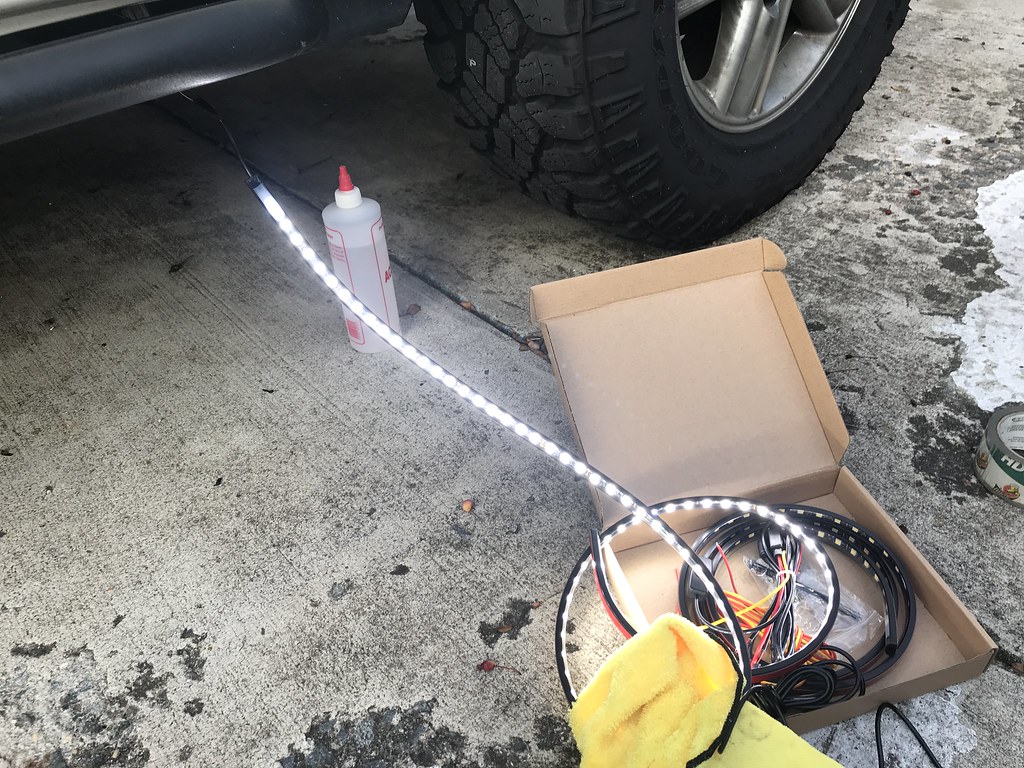

Cut the pigtail of the running board's connector off, put that towards the LED strip pictured, and then plug it up. Very simple, hardest part was cleaning the underside enough for the double side tape to stick.
That gray connector is from the runningboard, just splice the wires like this and tape it off
