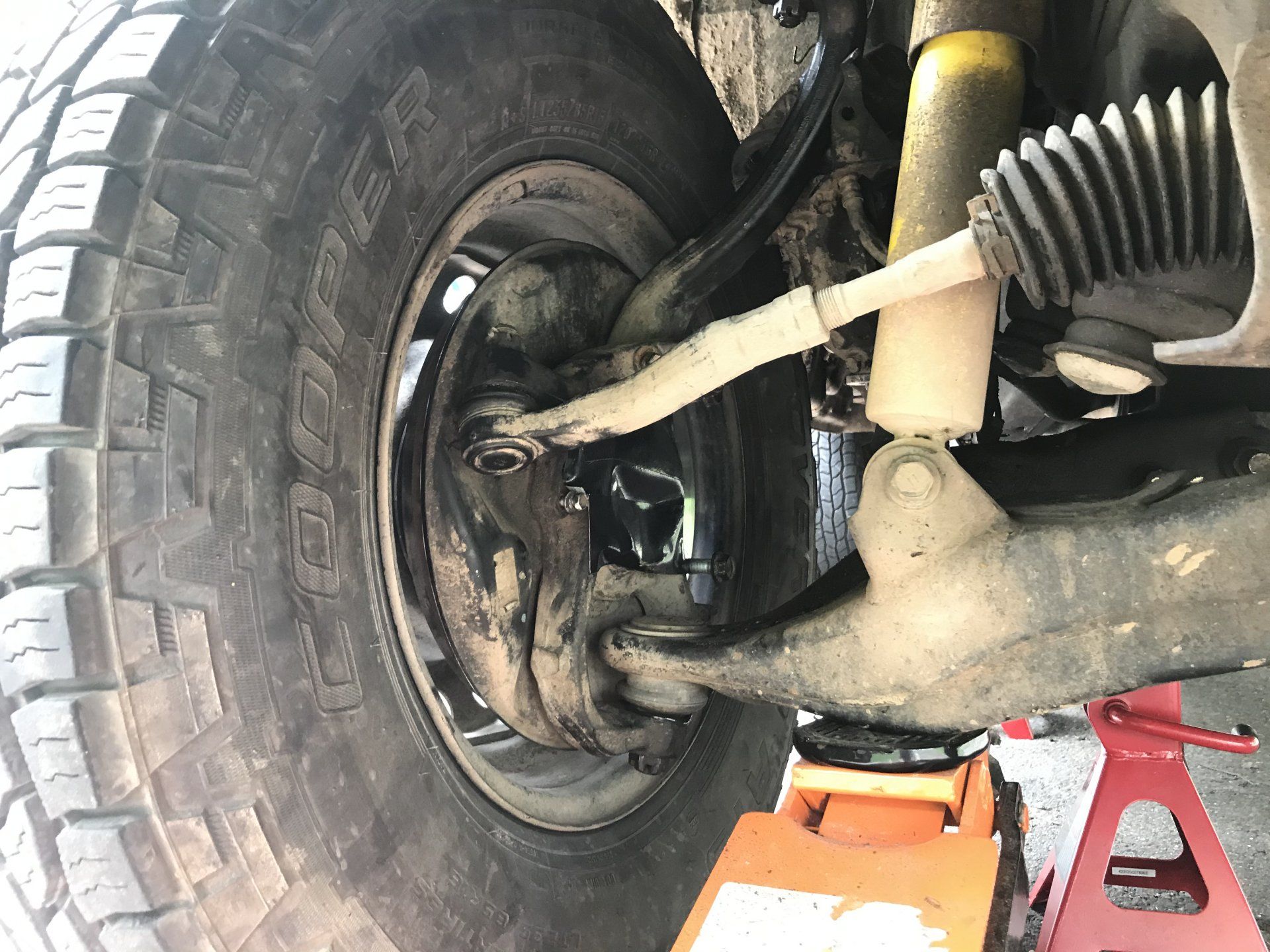

Perpetrating a fraud. No garage, and want to avoid being the talk of the neighborhood, so can’t leave it up on axle stands for two weeks while I get my blown front diff redone....
Pulled CVs and diff, taped over the axle hole in the steering knuckle, reconnected all ball joints, and put the wheels back on—gives passers by the impression that our vehicles all work....
And, yes, that ring gear is missing a tooth....

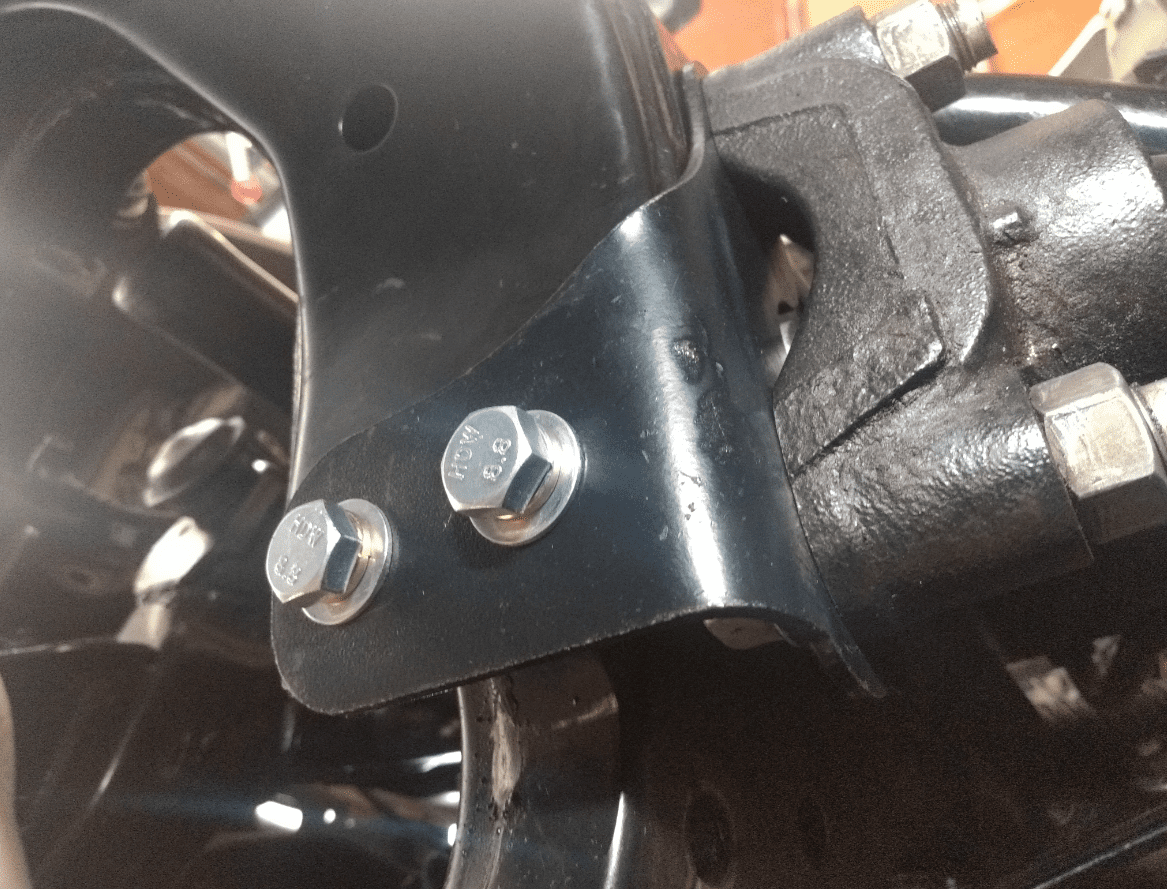

Started installing LCA reinforcements.
