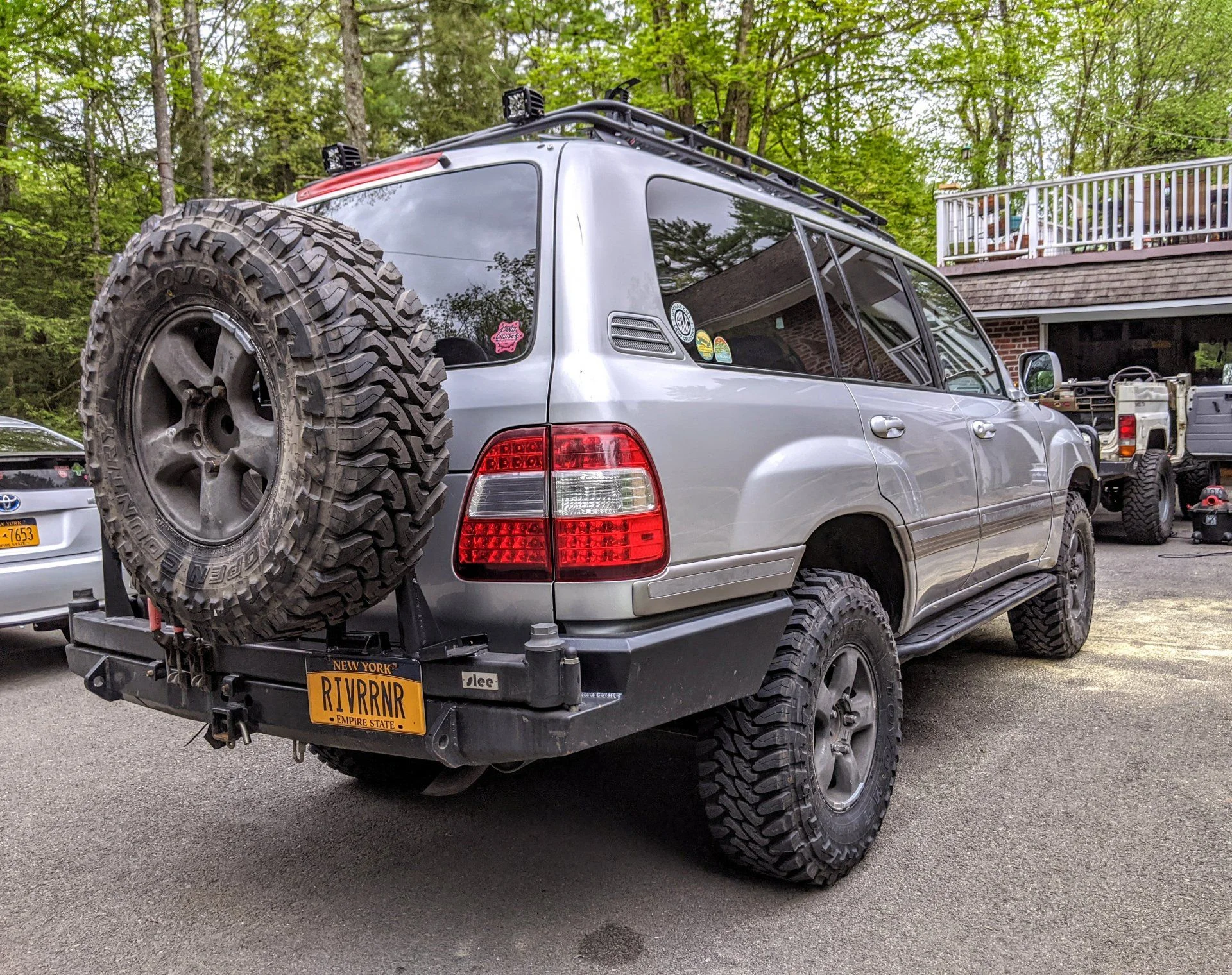

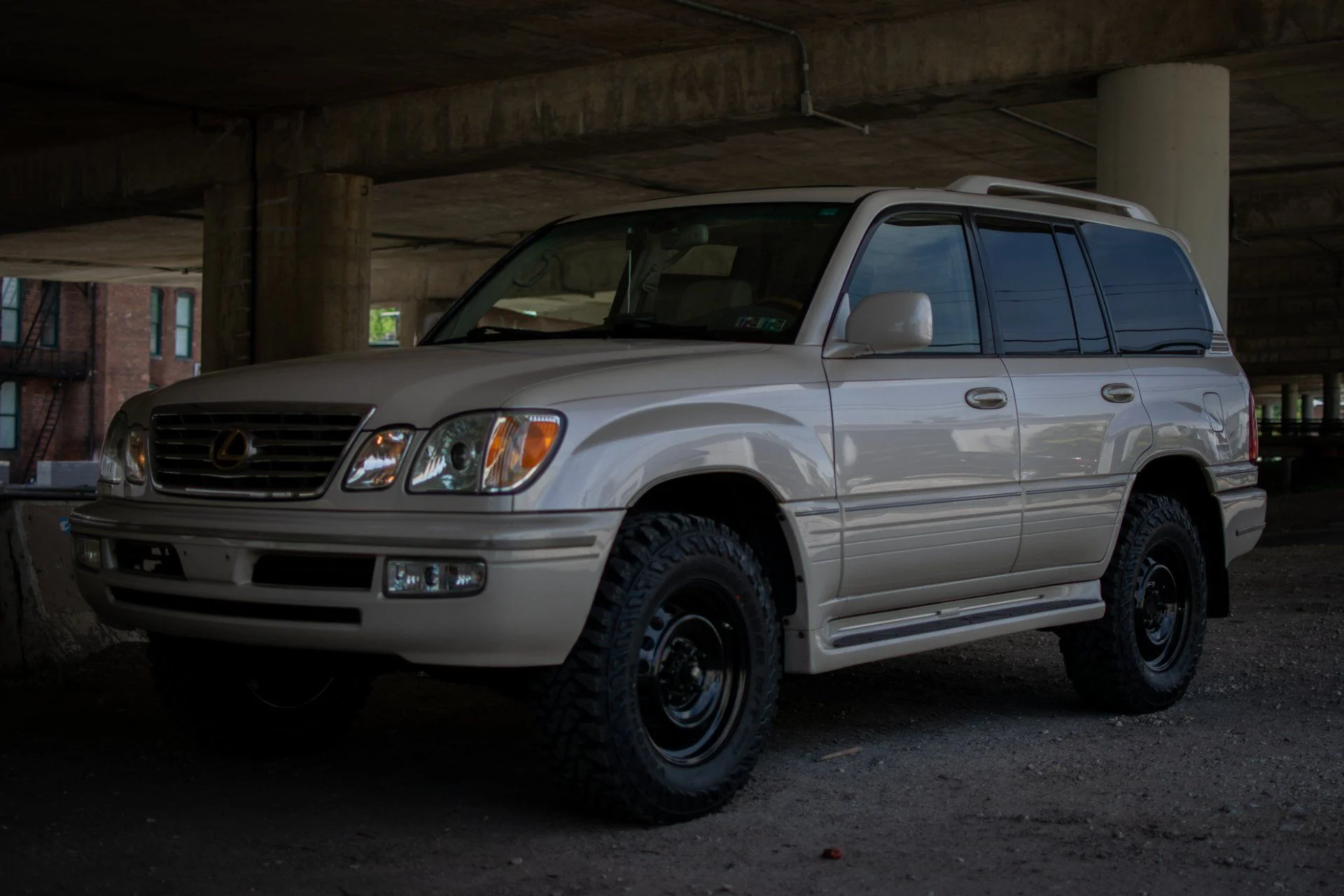

I'm in love. Had I known that the ride was this smooth I would have opted for MTs years ago. View attachment 2311004
But I guess my husband heard me a mile away. 😂
Wait until after they're worn down a little, woh woh woh woh woh woh woh woh woh. Looks good though, love the aggressiveness look of M/T's

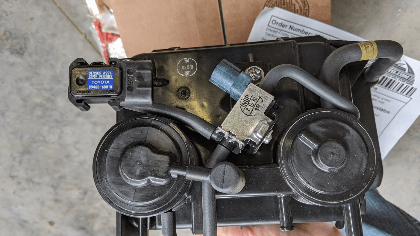

Since I have always had excessive fuel vapor and pressure with the 100, I decided to replace the Charcoal Canister. I opted for the the cheapest option RockAuto had since it was the cheapest option I could find anywhere. What I received seemed like an OEM Denso replacement. It even has the Toyota sensor on top.
The old 334k mile canister was twice as heavy as the new one. I speculate the charcoal was saturated with gas.

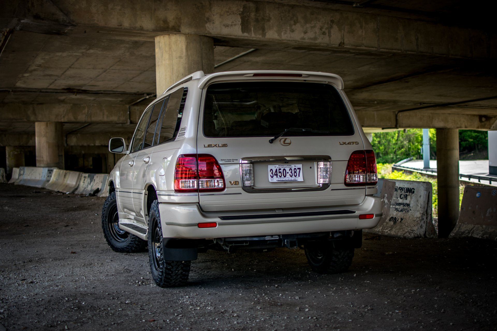

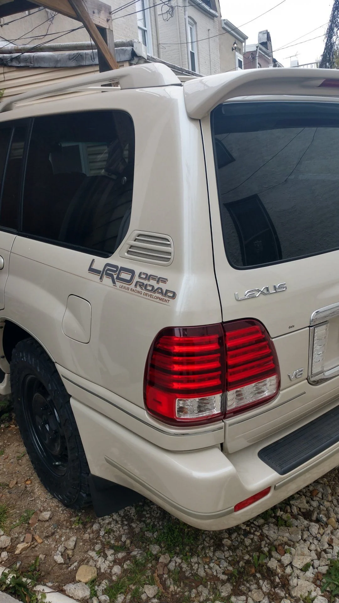

I also upgraded the tail lights. I picked up a like new set of later model tail lights from @Gdub216 last year and finally finished the install. I needed amber bulbs 90981-15011 and the harness 81555-60680. The tailgate lights were done a few weeks ago when I installed the Huracan storage lid. These are a huge improvement from my stock faded, cracked and scratched tail lights.

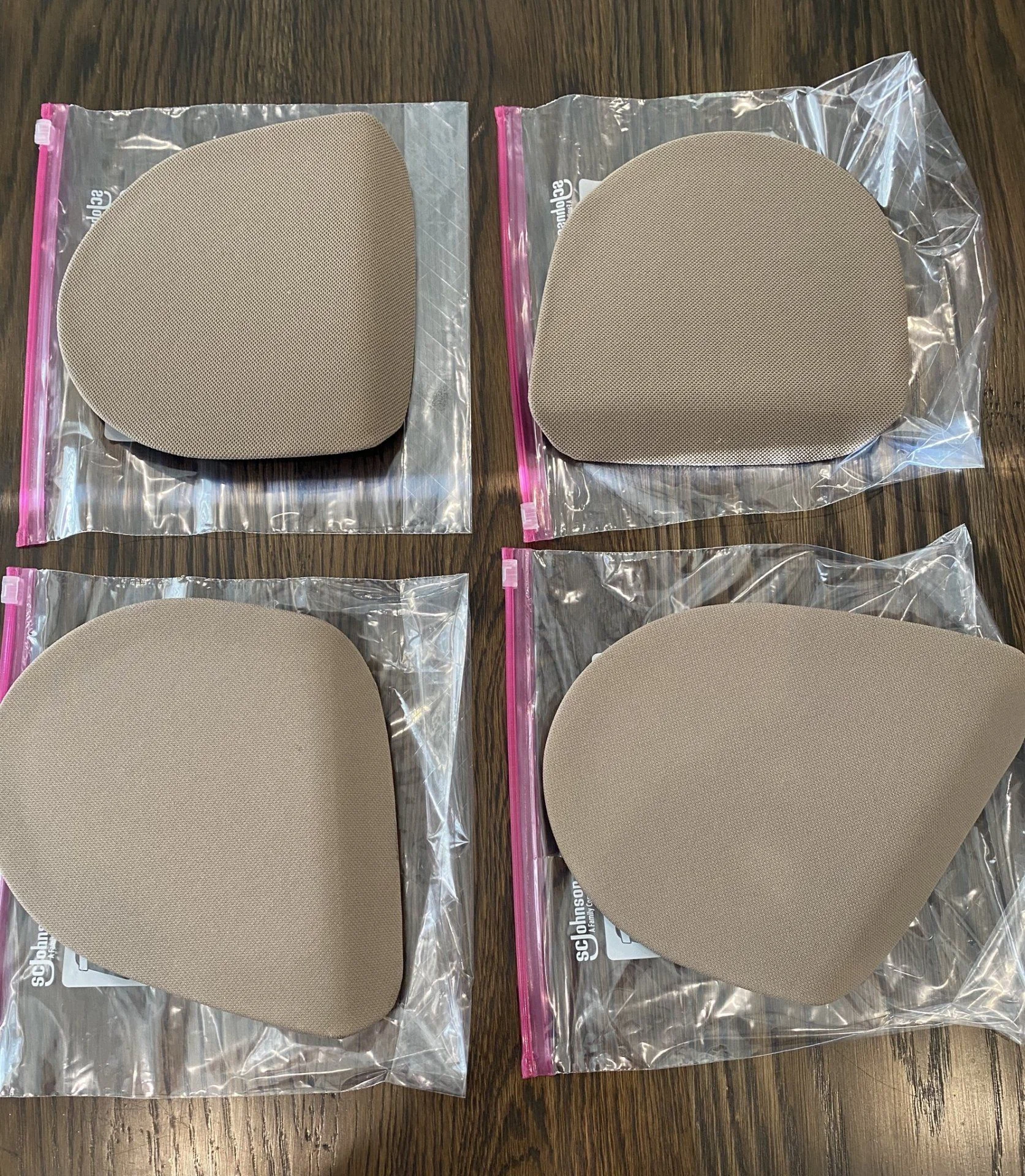

Lastly, I plugged the holes in the rear trim where the 3rd row seatbelts used to be. Used amber LED trailer clearance lights on a switch in the back. These put off a light glow which will be great for illuminating my cargo when camping without wrecking night vision.
Very nice, any improvement yet on the fuel vapor?
i get some whiffs of gas when climbing hills sometimes as well.

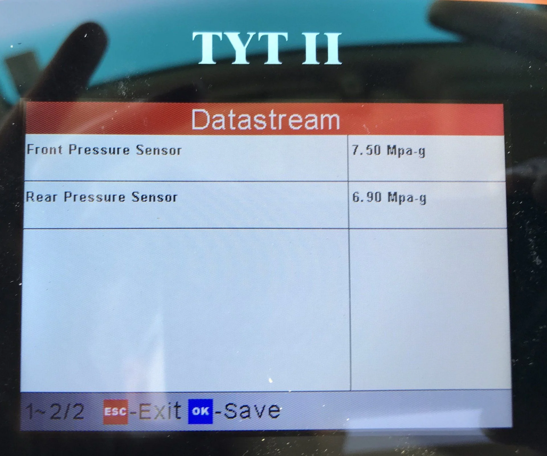

I finally adjusted my Torsion bars and think I got my neutral pressures back to spec.
Took me a while to figure out where the bolt for the adjustment was...just behind the front doors is where that 30mm guy lives...staring at you.
did 3 full turns on passenger side and 4 on drivers. Before and after hub to fender heights were :
driver 19 and 8/16 inches and after 4 turns =19 and 12/16 inches
Passenger 19 7/16 inches and after 3 turns =19 11/16 inches
Neutral pressures before adjustement:

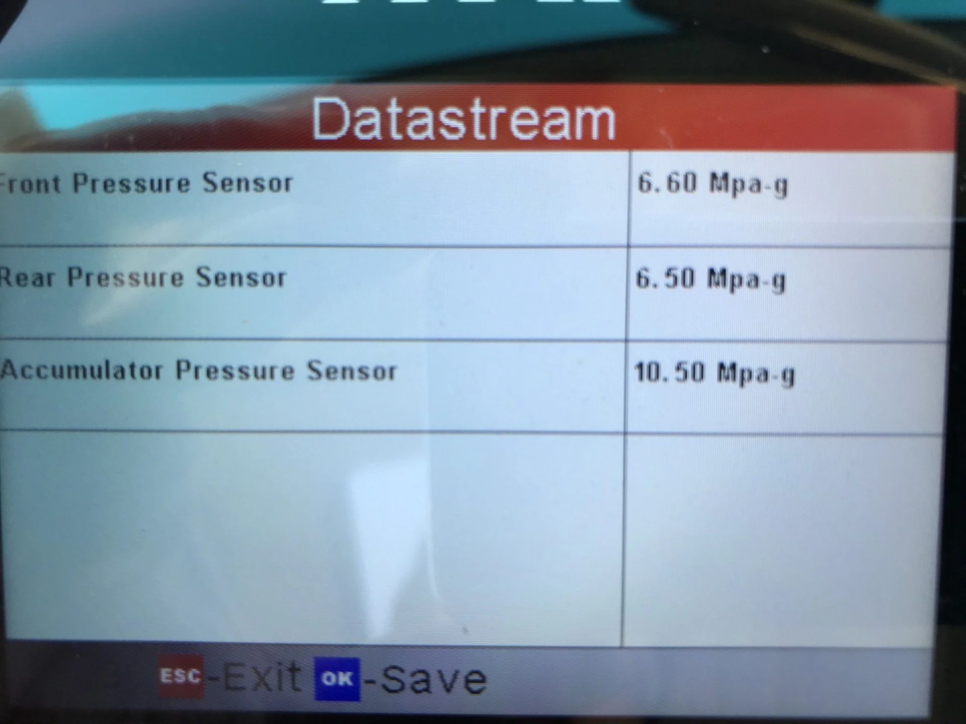

After adjustment:
Ride does feels nicer 👍🏻

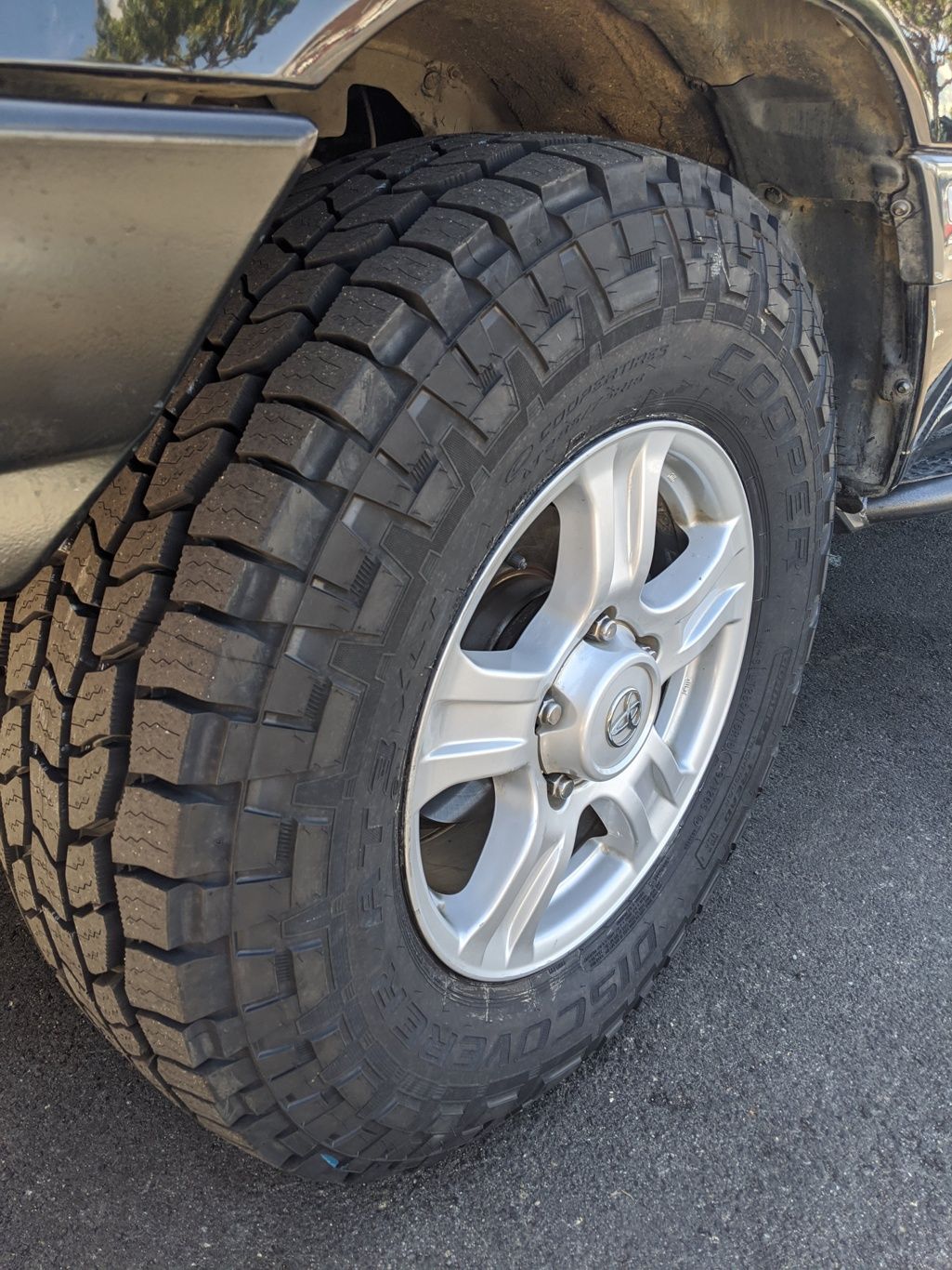

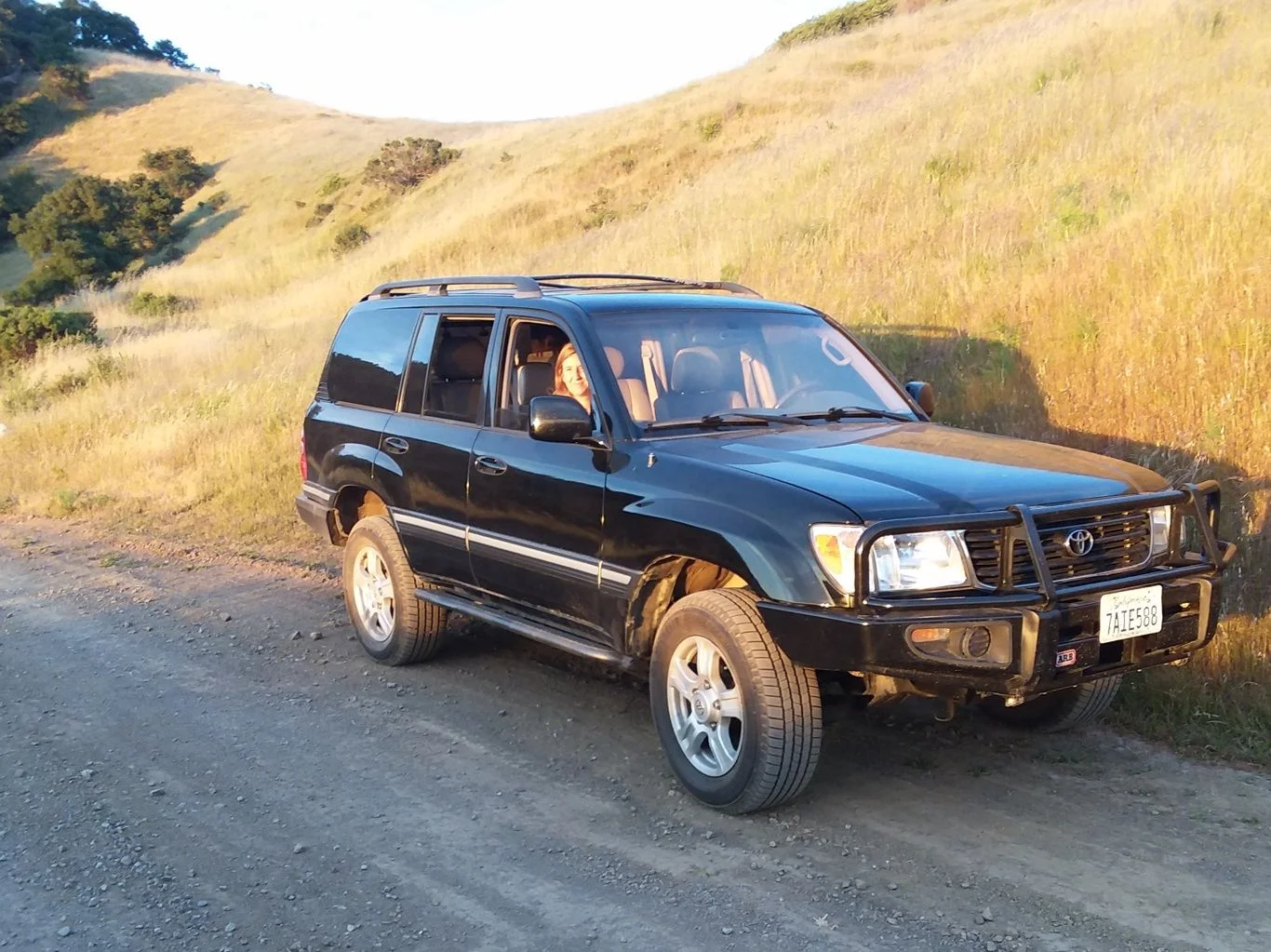

Finally put on a set of tires! Went from this...

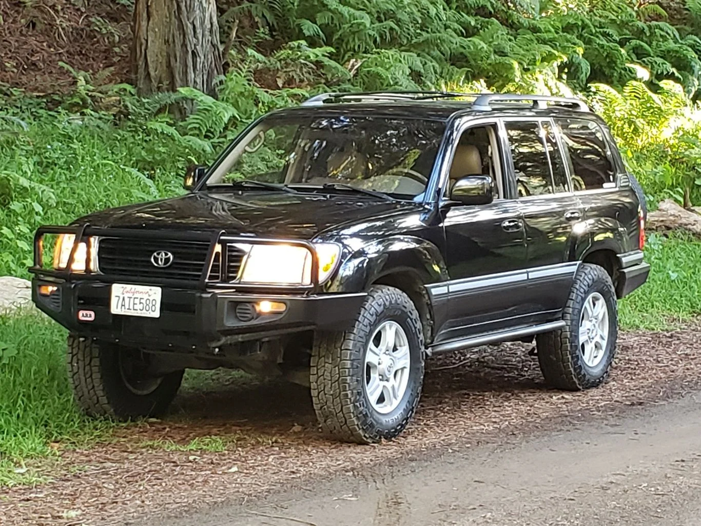

To this!
Cooper discoverer AT3 XLT 285/75R18
Stock UCA, Ironman 2" foam cell pro, massaged pinch weld. No spacers. Looks even better in person. :cool:
